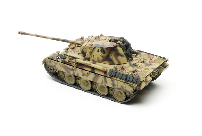

To my way of thinking, the Panther was a sexy beast! Arguably the best tank of World War II based on firepower, armor, and mobility, it was hindered by poor mechanical reliability and complexity which limited production.
Tamiya’s Panther Ausf D is its first all-new 1/35 scale Panzer V since the release of the Panther G more than 20 years ago. Seeing this kit brought back fond memories of Tamiya’s first 1/35 scale Panther A, which I built as a teenager in 1969!
Perfectly molded in dark yellow plastic, the kit features two figures, one-piece vinyl tracks, and separate hatches. Tamiya has also released three “Detail-Up” sets for the kit, including photoetched-metal engine grilles, a metal gun barrel, and separate track links. I used all three sets in building this model of review.

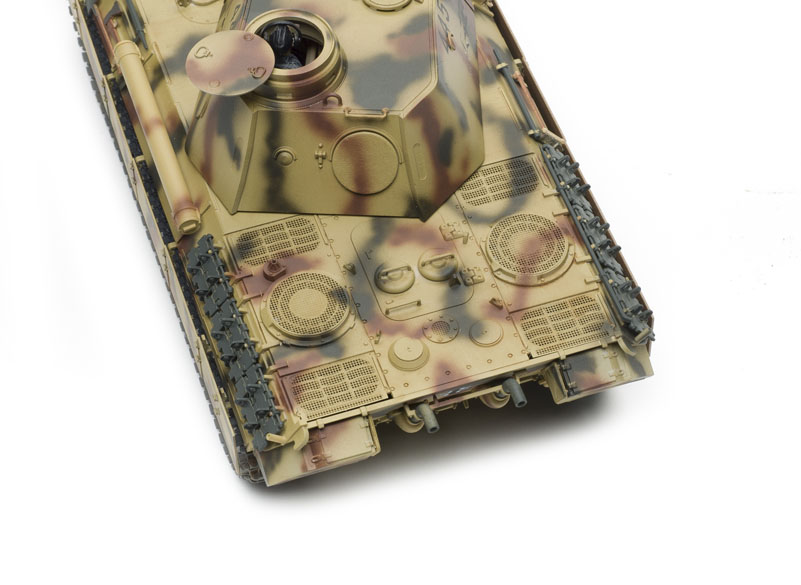

The kit provides radiator and fan inserts to fill the space behind the open engine vents. I attached the photoetched-metal grilles from the Detail-Up set, taking care to ensure they were lined up just right at the corners. This set really enhances the appearance of the engine deck, because operational Panthers always had the engine screens.

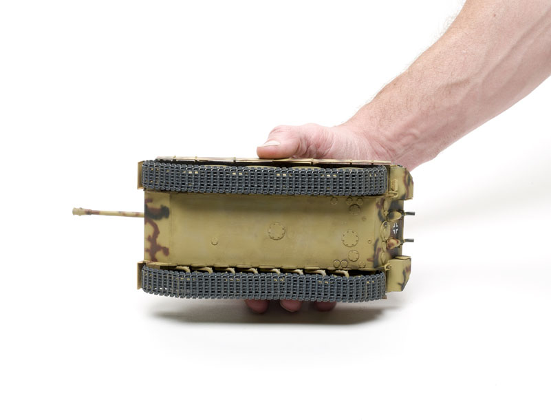

The one-piece vinyl tracks in the basic kit are well molded with sharp-looking fronts and backs. I replaced them with Tamiya’s Separate Track-Link set for the model. Molded in ABS plastic with excellent detail, each link consists of a main body and an inner part for the guide horns that are glued together. The completed links click together to form workable, neatly articulated track runs.

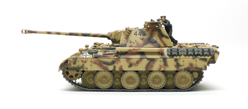

I painted the Panther using Tamiya acrylics suggested in the instructions.
Decals provide markings for three tanks at the 1943 Battle of Kursk, the Panther’s baptism of fire. They laid down well over a semigloss base with a little decal solution.

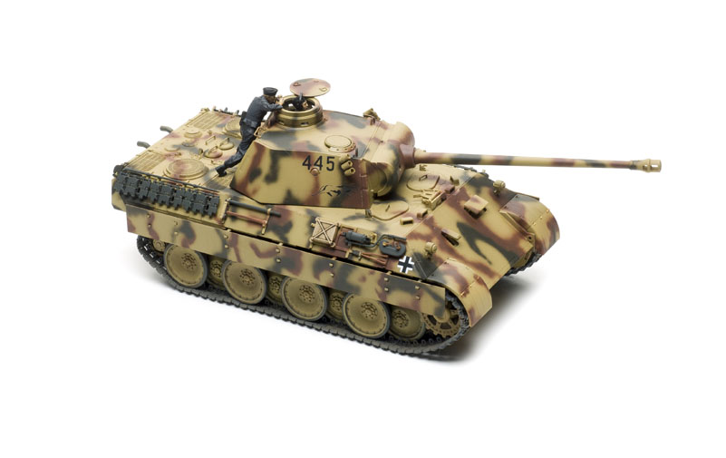

The kit shapes up well against plans and photos, but the detail-conscious builder will note some of the kit features, such as the armored fan covers, may not be appropriate for all of the marking options in the kit.
I completed my Panther D in 38 fun hours and the finished model met my expectations. The base kit will fit modelers of all skill levels, while the Detail-Up sets provide options for more-experienced builders. I definitely recommend Tamiya’s model to Panther enthusiasts and German armor modelers.
