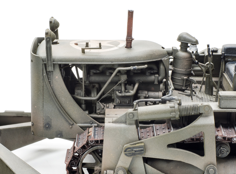

The engine is so detailed, I looked in the box for the 1/35 scale socket set to put it together. The only things missing are electrical wiring and fuel lines.

It may seem strange to attach the radiator to the engine before adding the parts to the frame, but follow the instructions. It is especially important to add the plumbing when shown in the instructions, as things can quickly get in your way if you try to add it later.

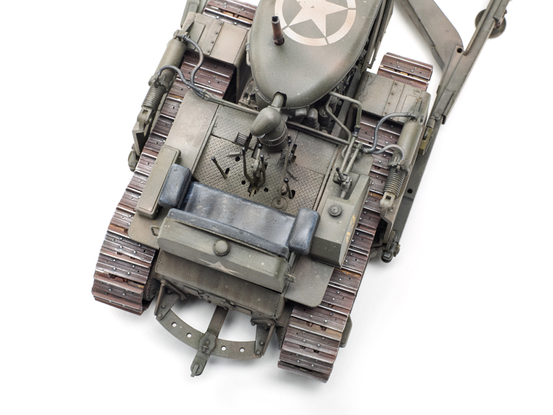

I spent a lot of time fixing the control linkages in Step 23 after they broke into several parts. As it turns out, I could have saved myself a lot of trouble because all of that detail gets covered by the floor, never to be seen again.
The only area that needed filler was the fuel tank behind the seat. Otherwise, a little Mr. Surfacer 500 eliminated any seams.
I left the seat cushions and armrests off the model until major painting was finished.

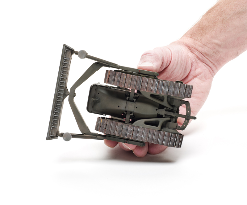

I found assembling the tracks challenging. If I properly understand the instructions, you are supposed to put all of the links together without glue, then glue the track pads in place. Trying this with two of the links showed it wouldn’t work.
I built one sprue of links at a time, first attaching one link side (Dc3) to each pad. Then, I glued a pin to the wide end of each link. Once these were dry I added the other link side (Dc2) to the first pad, slipped the pin of the next link through the narrow side of the link, then added the other side, carefully gluing it to the track pad. It sounds complicated but it worked well. I built a jig with sheet styrene to align the links during assembly. You’ll need 36 links per side, and MiniArt gives you just enough links — there’s not one extra. I installed the tracks after painting. Despite all the work to make the tracks workable, I suggest that they be glued in place once they are on the model.
