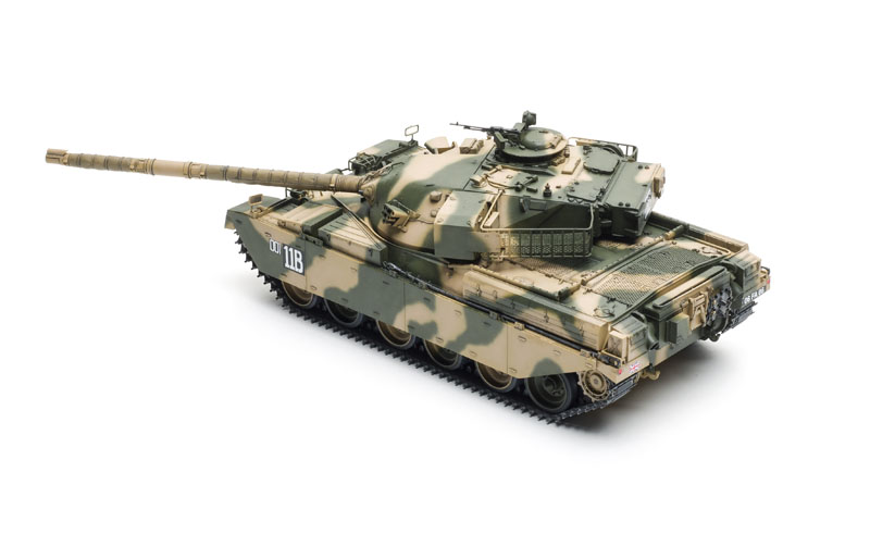

Detailing the upper hull went smoothly. The driver’s hatch can be posed open or closed through the use of optional parts. The photo-etched (PE) engine grilles fit perfectly. Advanced modelers might choose to replace the lift handles for the engine hatches with fine wire, but the PE ones look OK.
Adding the PE braces (TP4,TP6) between the headlight brush guards and the diverter plate (TP7) was challenging.
Turret assembly proceeded quickly. The main gun mount uses poly caps to make the barrel movable. But I found that the beautifully molded vinyl mantlet cover pretty much fixed the gun in a level position.
I filled small gaps around Part H4 (beneath the mantlet) with stretched sprue. Sanding blended it into the turret.
The three-part main gun fit well and needed no filler.
With care, both turret hatches can be built to operate.

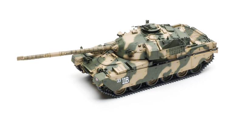

To paint my Chieftain as a BATUS (British Army Training Unit Suffield) Mk.5, I mixed Tamiya paints to match the suggested colors. The side and top views of the camouflage don’t align, so I adjusted the sides to match the top. A coat of Vallejo clear gloss sealed the finish.
The decals worked fine over flat areas, but the large number on the rear of the turret cracked in several places across the turret bin, even before I applied solvent. Once the decal dried, I touched up the fractures with paint. A flat black enamel pinwash made the molded detail pop before I applied clear flat.

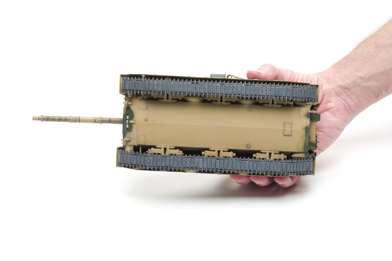

Chieftain tracks don’t sag, so I built link-and-length tracks from the individual links. The instructions indicate 94 links per side, but I used 98.
I added the side-skirt supports when I installed the suspension units near the beginning of the build and had trouble aligning them. If I build another Chieftain I will wait and add them when installing the skirts to simplify alignment.
