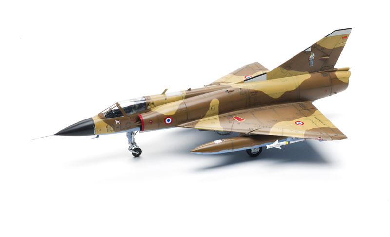

I finished my Mirage as a desert camouflaged French fighter in Djibouti in 1980. The decals went on without problems.
