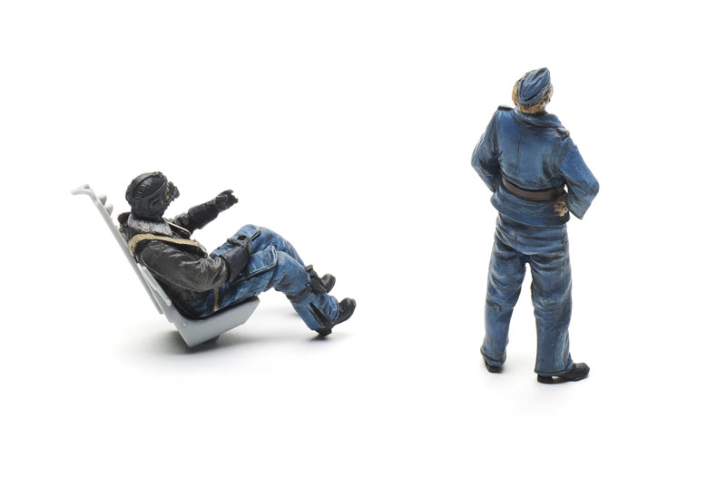

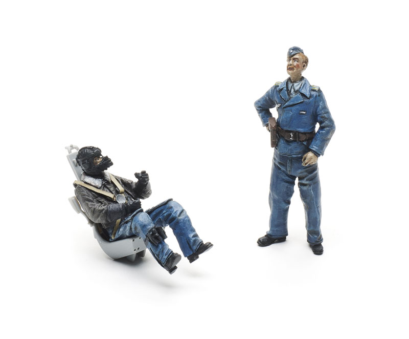

The engines, weapons bay, and nose gun compartment are detailed and the separate panels can be left open. This special edition includes two nicely sculpted resin figures, one seated and one looking up at the cockpit from the ground.
Step 1 forces a decision about the pilot that’s not clear in the instructions. If you wish to crew the plane, delete the seat cushion (part M20) and PE seat belts. (The armrests molded to the seat should be lowered in this case as well, but that will require surgery.)

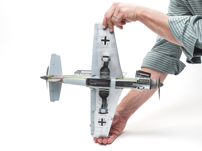

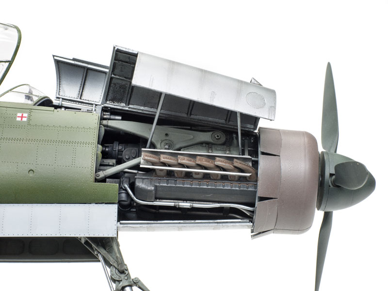

The engines include many details, but make sure you track which engine you are building. Several parts are the same front to rear, but there are also differences, including fitting the other cast weight inside the forward engine. HK indicates holes to open on each engine to attach the correct accessories — make sure you open them up before you glue the halves together!
Everything fits well, except for one pipe (part O14) that needed to be trimmed to fit the bulkhead.
To align the interior subassemblies, I placed them into a fuselage half. Everything fit until I dry-fitted the upper deck; it would not clear the rear engine’s aft bulkhead. I’m pretty sure all of the parts are exactly where they should be as per the instructions, so I’m still scratching my head about the cause. I trimmed the bulkhead until the deck fit.
The separate engine, gear, and weapon doors fit even when modified to be attached closed.

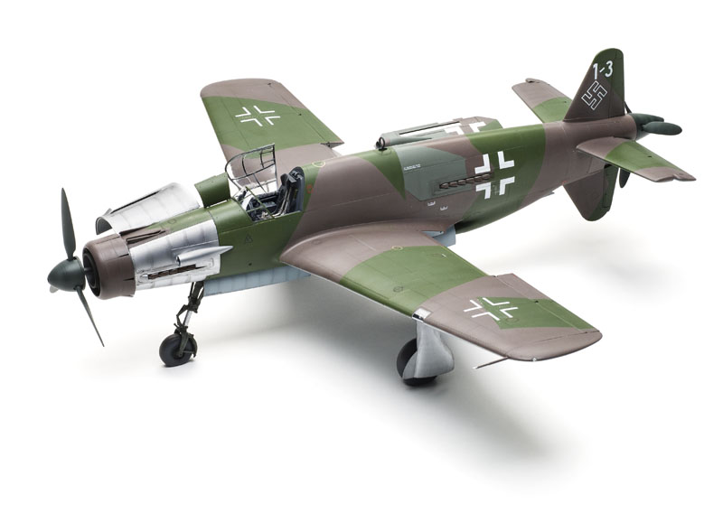

The wings and tail were a breeze. Separate control surfaces fit without glue, and the leading-edge inserts needed just a smear of filler under the wing. The instructions omit the landing lights (parts N12), although they are shown in the drawings.
I assembled the landing gear off the model for painting. Be careful attaching the nose wheel to the strut — it is handed because the strut is mounted at an angle.
The decals responded well to setting solutions and laid nicely over clear gloss.  Helpfully, HK supplied the fuselage crosses separated for use on the open panels.
HK has created a wonderful, easy-to-build kit. I was impressed with the fit (except for the mysterious rear bulkhead) and the detail is outstanding. I spent a little less than 60 hours on this kit and five more finishing the figures.
