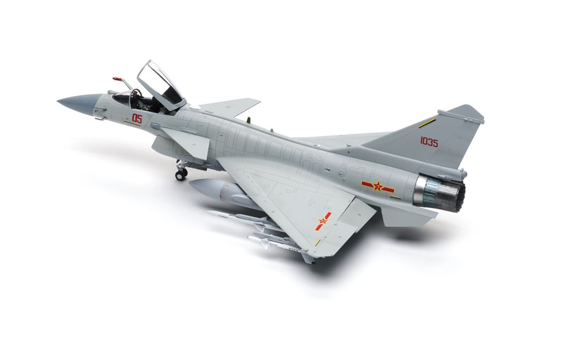

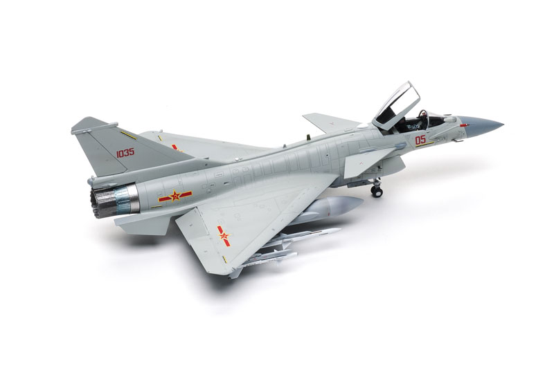

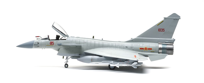

Construction follows the traditional format, with work beginning on the cockpit. Trim the instrument decals closely and section them for better fit. As with other Trumpeter fighters I’ve built, construction moves along quickly and fit is very good. This kit is no exception. I did modify some of the building steps.
After installing the nose wheel bay and cockpit, I glued the fuselage together and inserted the intake trunk through the bottom opening where the wings attach. This ensured the intake precisely matched the separate intake lip.
Be careful when joining the wings to the fuselage, and be sure the wing meets its outline on the fuselage. I was only half careful and had to do some tricky sanding and scraping to eliminate a raised joint along the fuselage. Speaking of seams, there is one at the top of the canopy. The actual aircraft has a dark line there, from the rear edge of the canopy to just short of the front edge. I used a decal to simulate this feature.
Trumpeter has you install the landing gear later in the build, which is good. However, it requires some care to ensure correct alignment. Also, the tires are weighted, with keyed wheels and axles to keep the flat surfaces down. On my model, the wheel holes were too small for the axles — and when I expanded the diameter, the keys were eliminated. Not a big deal, but it complicates positioning the wheels flat on the ground. Other small parts had similar fit issues.
On the painting guide, note the upper surface color should be GSI Creos H61 (INJ Gray), not the H16 indicated. That color is green. The decals worked very well. Stencils abound on the aircraft as well as the missiles, so be prepared to devote some time to them. I spent about 25 hours on the kit, with a couple of those on the decals.
