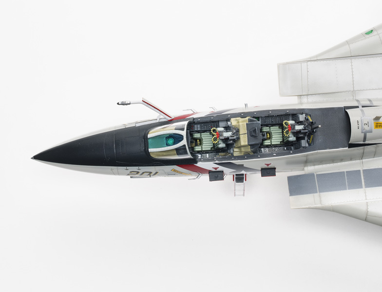

The wonderful cockpit features accurate, cleanly molded, and easy-to-paint detail. Decals are included for several of the screens on the instrument panels that would be appropriate for a jet that is powered-up and manned.

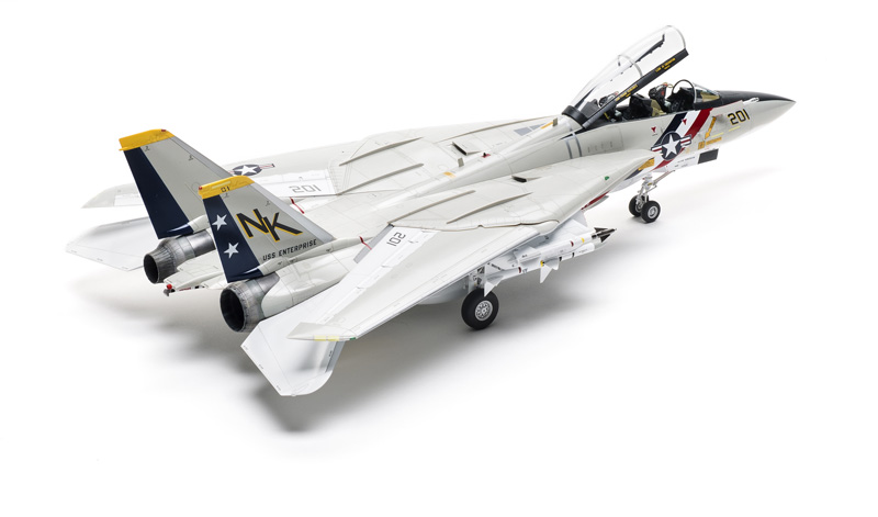

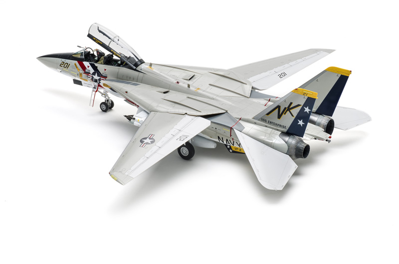

The completed wings slip over a sturdy, functional wing-sweeping mechanism, so they can be installed after painting. The wing-glove bladder and finger seals (under and over the wings, respectively) can be left unglued and replaced with the appropriate parts if the wings are either forward or swept. Tamiya even included extra decal stripes for both wing-bladder seals to properly mark both options.
