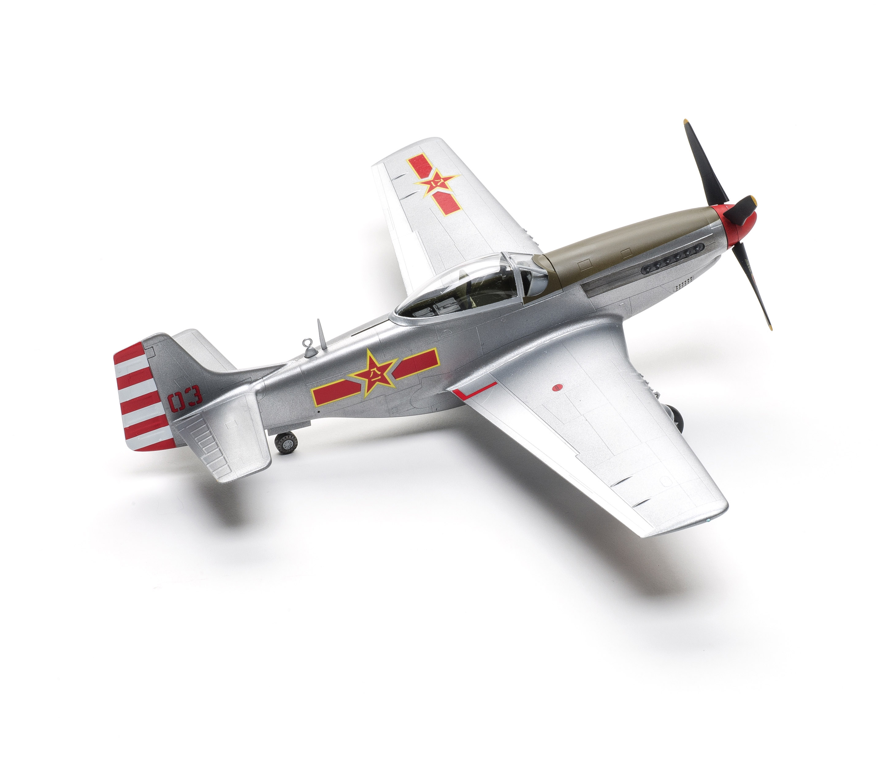

The fit of the wings to fuselage was good, with a crisp join at the wing roots.
Surface detail is restrained on the fuselage and wings, which feature lightly recessed panel lines, but molded details on the rudder and horizontal stabilizers are somewhat exaggerated.

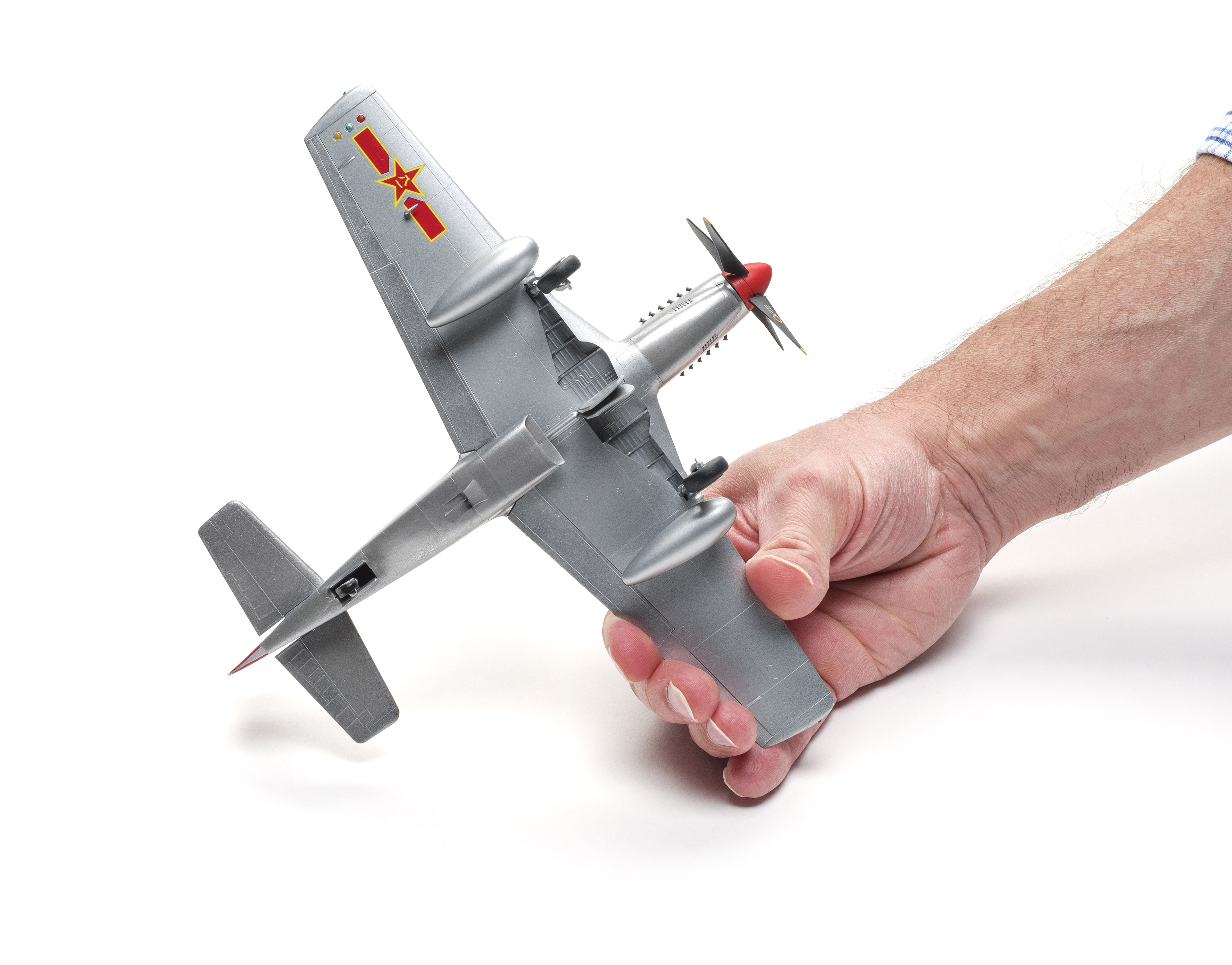

One thing I did not catch until I was in the final phase of construction was a major error with the landing-gear legs. The oleo scissors are molded facing forward — they should be trailing! As the gear legs are keyed for left and right assembly, correcting this will require some work. You could carefully cut off the scissor links and relocate them correctly. Otherwise, cutting off the locating pins and creating new ones could be another option.

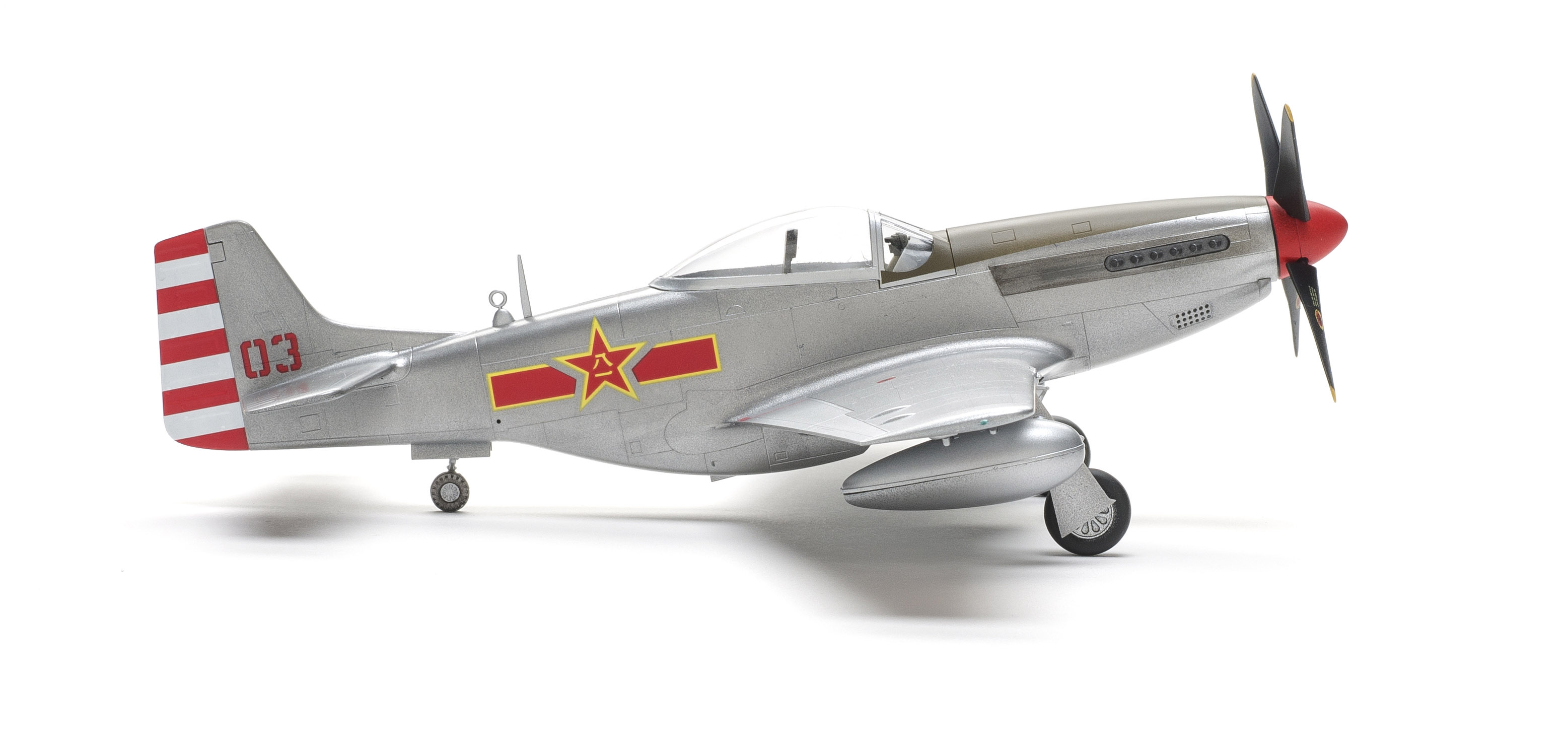

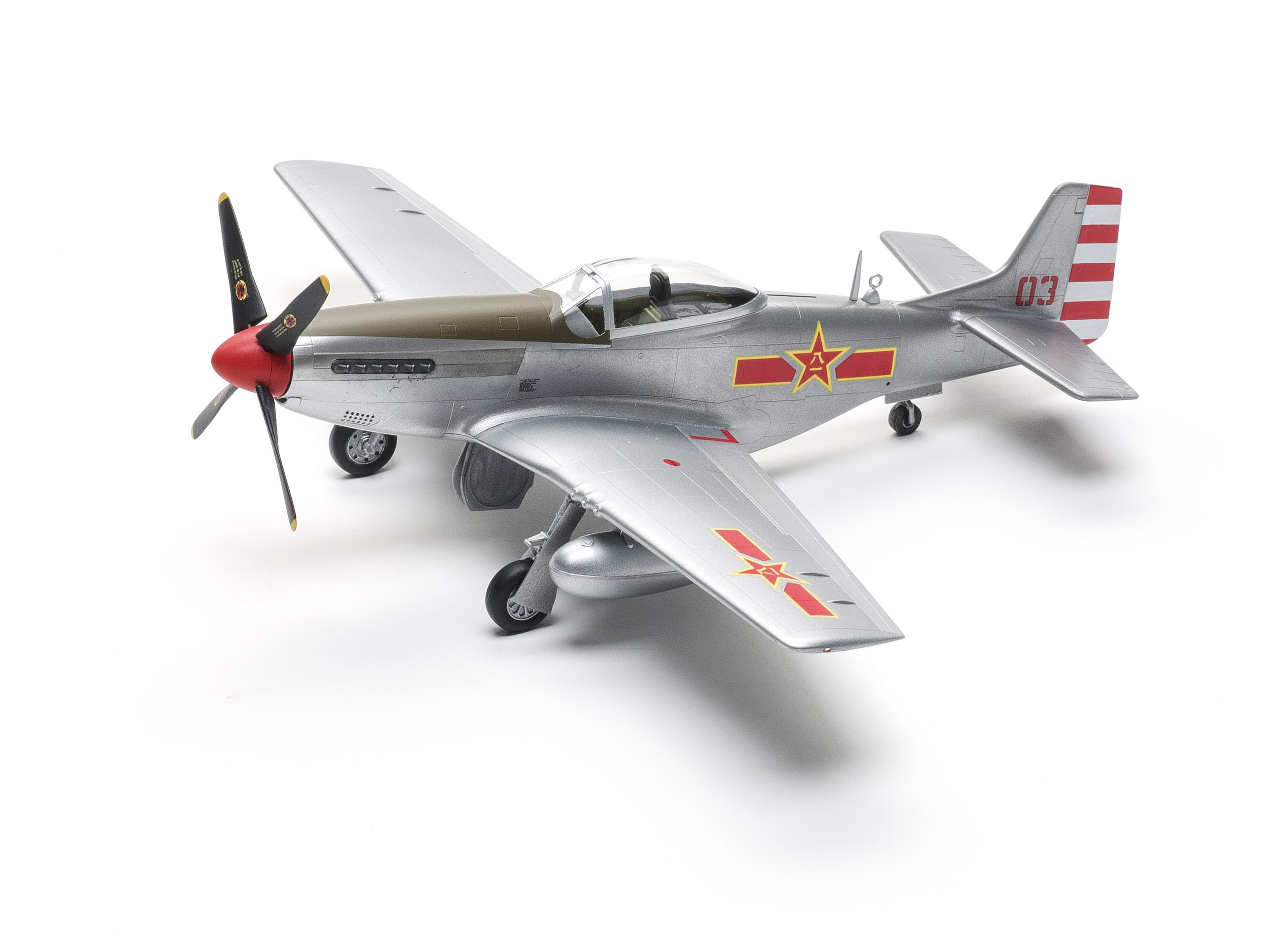

I painted my Mustang with a combination of Vallejo acrylic metal color paint and Tamiya spray paint.
Decals cover two PLAAF aircraft; a selection of generic numbers is provided. The decals behaved well on the metallic paint surface.

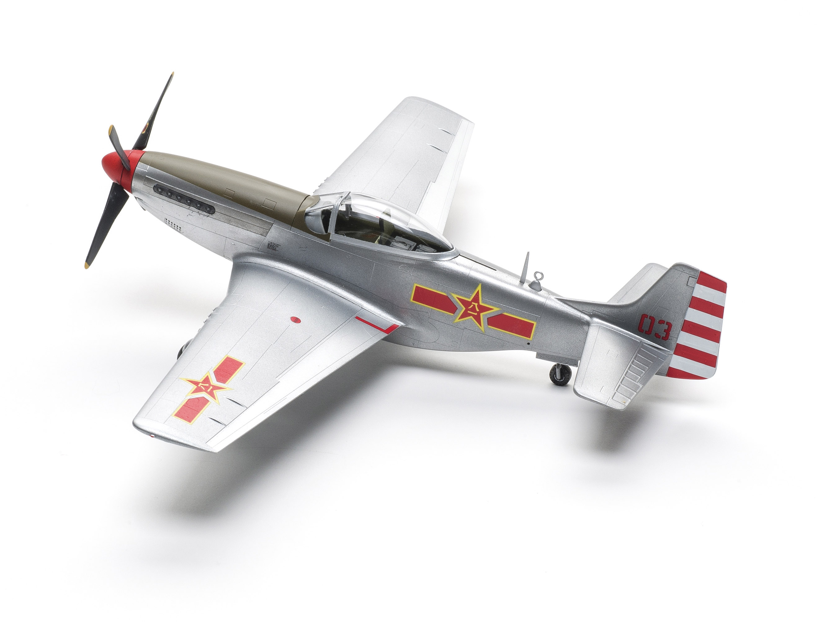

My primary reference was North American P-51D Mustang by Robert Pęczkowski (MMP Books, ISBN 978-83-65281-23-4), although I also found a few photos of PLAAF Mustangs on the internet. North American P-51D Mustang: B/C/D/K Models by Mariusz Lukasik (Kagero, ISBN 978-83-61220-06-0) also was useful. Judging by those sources, the kit’s dimensions and shapes are relatively good, though there are perhaps some shape issues at the lower cowling and below the canopy.
I completed my Mustang in a quick 10 hours, and it was a fun build. This is a great kit for beginners or occasional modelers who want a classic P-51 Mustang in their collection.
