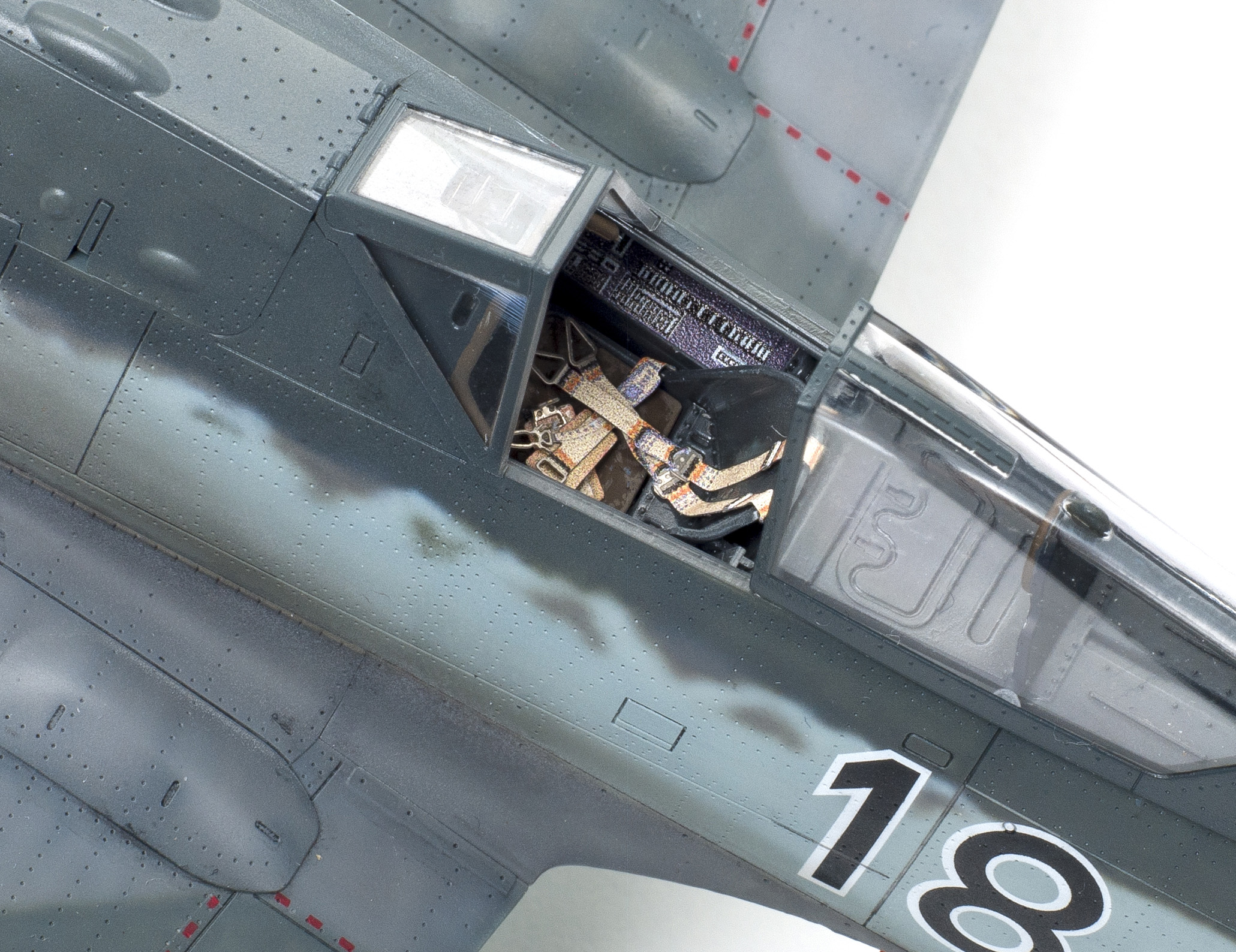

Surface detail is absolutely beautiful, with fine rivets and sharp, clean, well-defined panel lines. Cockpit detail also is wonderful, with Eduard presenting three options for representing the main instrument and side-panel details: prepainted photo-etch (PE) panels on a flat underlying part; a decal (again on a flat panel); or you may paint a panel with raised, molded detail. There are pluses and minuses in each option; I chose the PE parts as they give a quick, relatively easy yet good-looking result.
I found the PE belts tricky to bend and drape realistically. It may be possible to anneal them with a lighted match, but there would be a high risk of destroying the prepainted surface. For my future builds, I will use either a resin seat with molded-on belts or another type of aftermarket belt that is more malleable and forgiving.

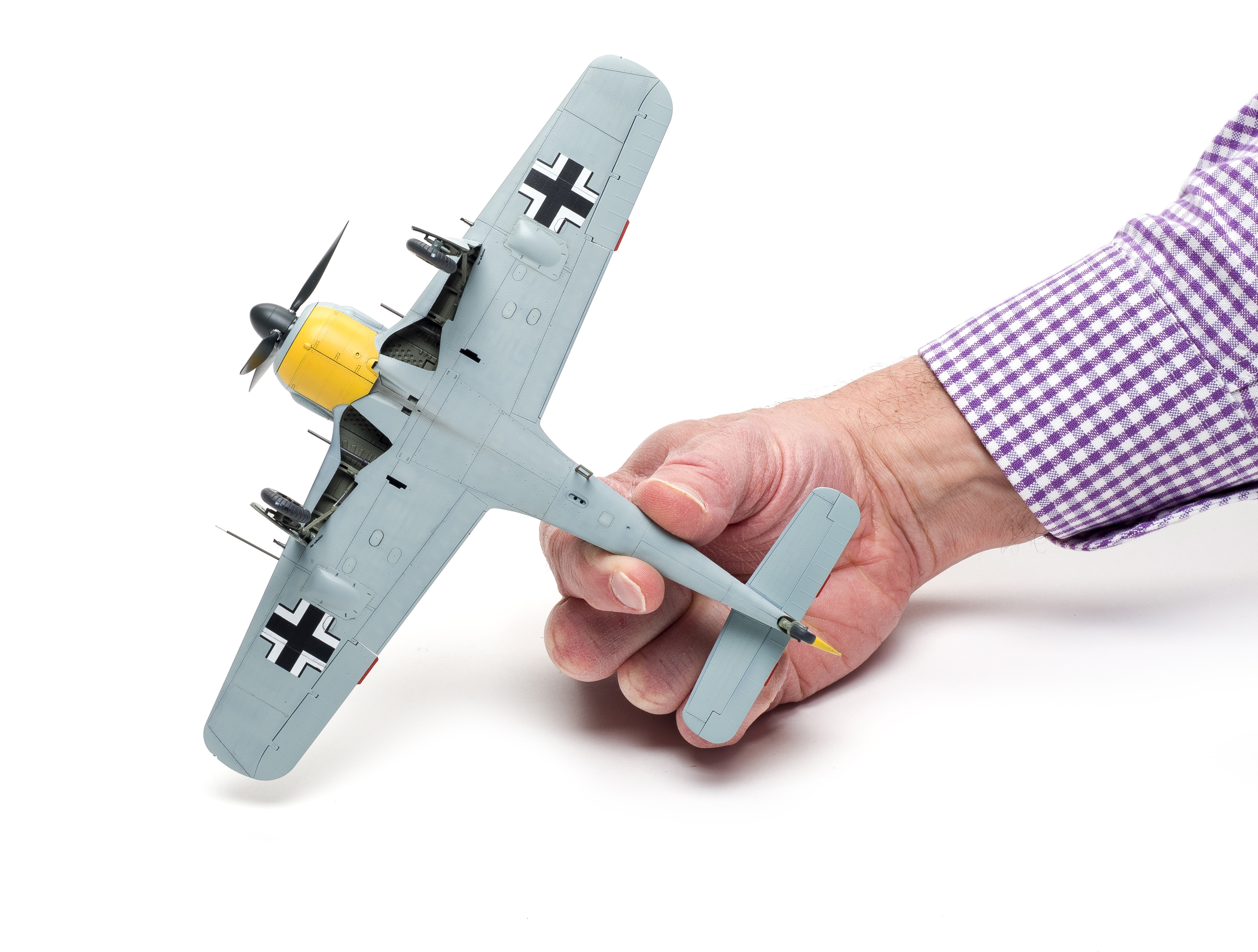

The fit of the wings to the fuselage is perfect. This is probably the biggest departure from the previous 190s kitted by Eduard. Earlier kits featured separate wing-root gun-bay doors, which can be tricky to align and install. Of course that makes displaying an open gun bay much easier, but if you don’t do that it creates more work. In the instance of this new 190A-4, Eduard sells a separate set of wing-root gun bays in its Brassin line. This makes sense to me, as there are many modelers who would rather have their model “buttoned up” with closed access hatches. (Eduard also offers a slew of other Brassin and PE sets should you wish to “go to town” and detail your model beyond what is in the box.)
The mounting of the main undercarriage legs is very clever and ensures a solid, strong, correctly aligned assembly. The wheels, on the other hand, are a little ambiguous in their attachment; care must be taken to ensure they are straight and vertical once installed.

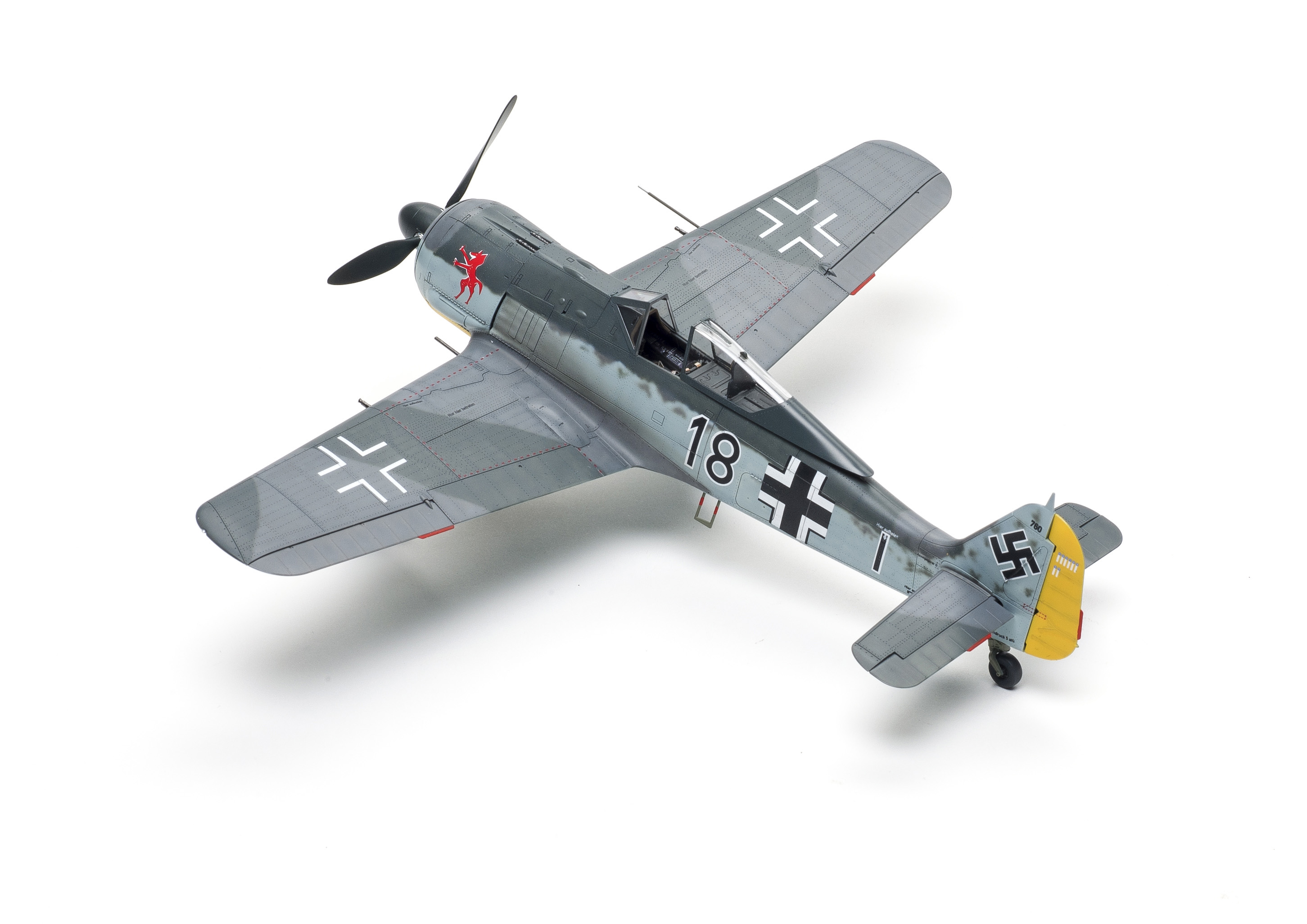

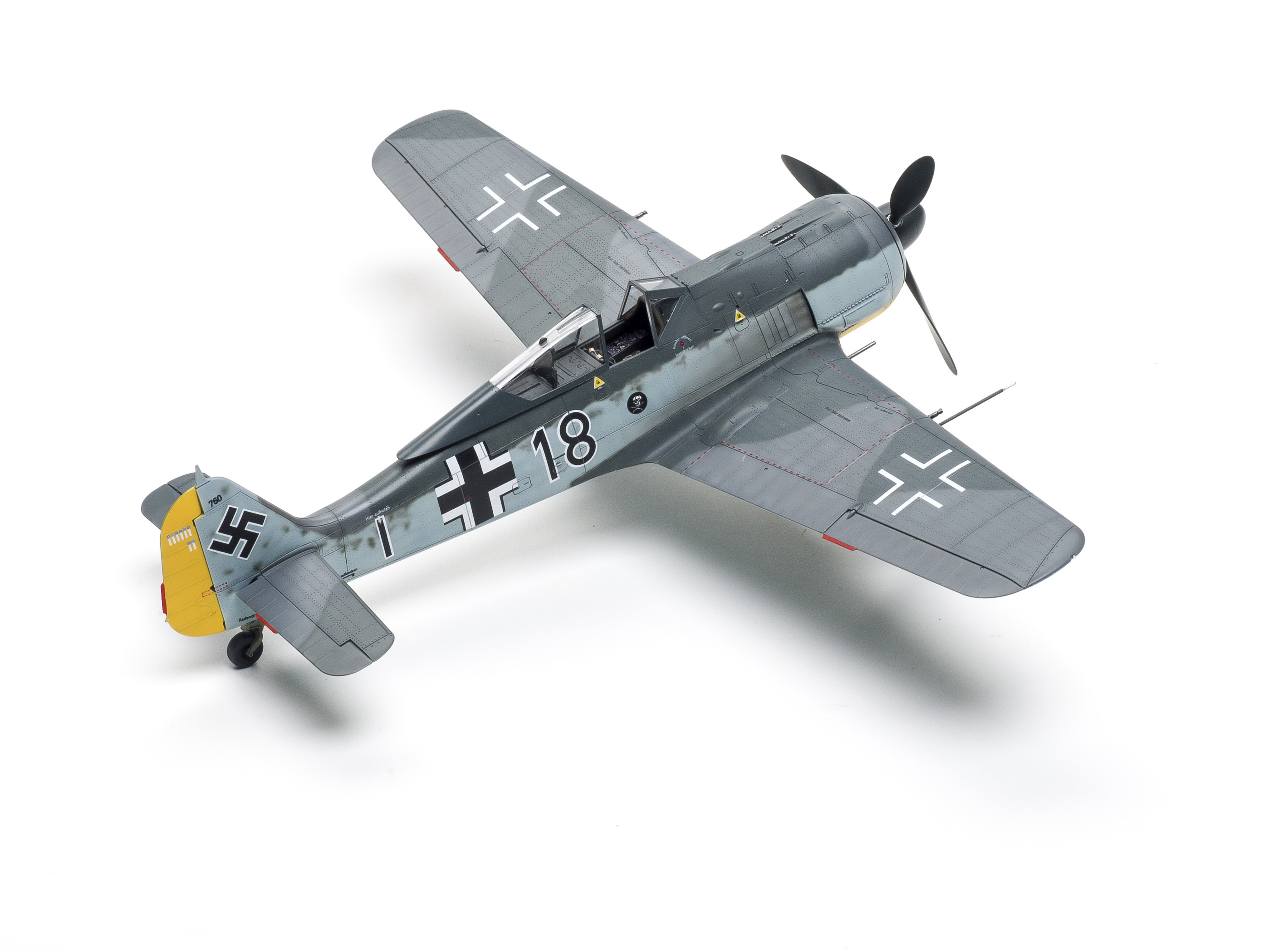

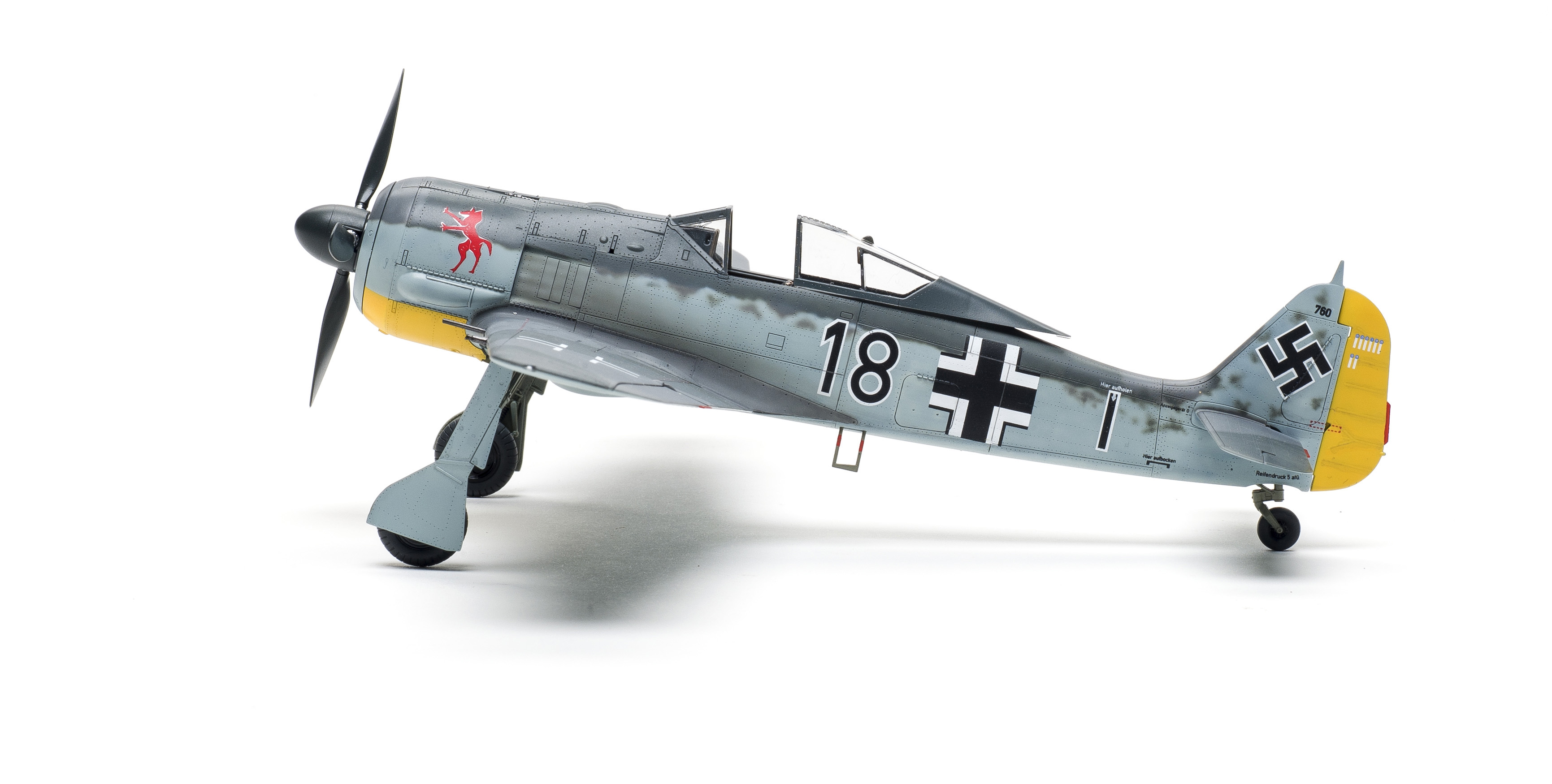

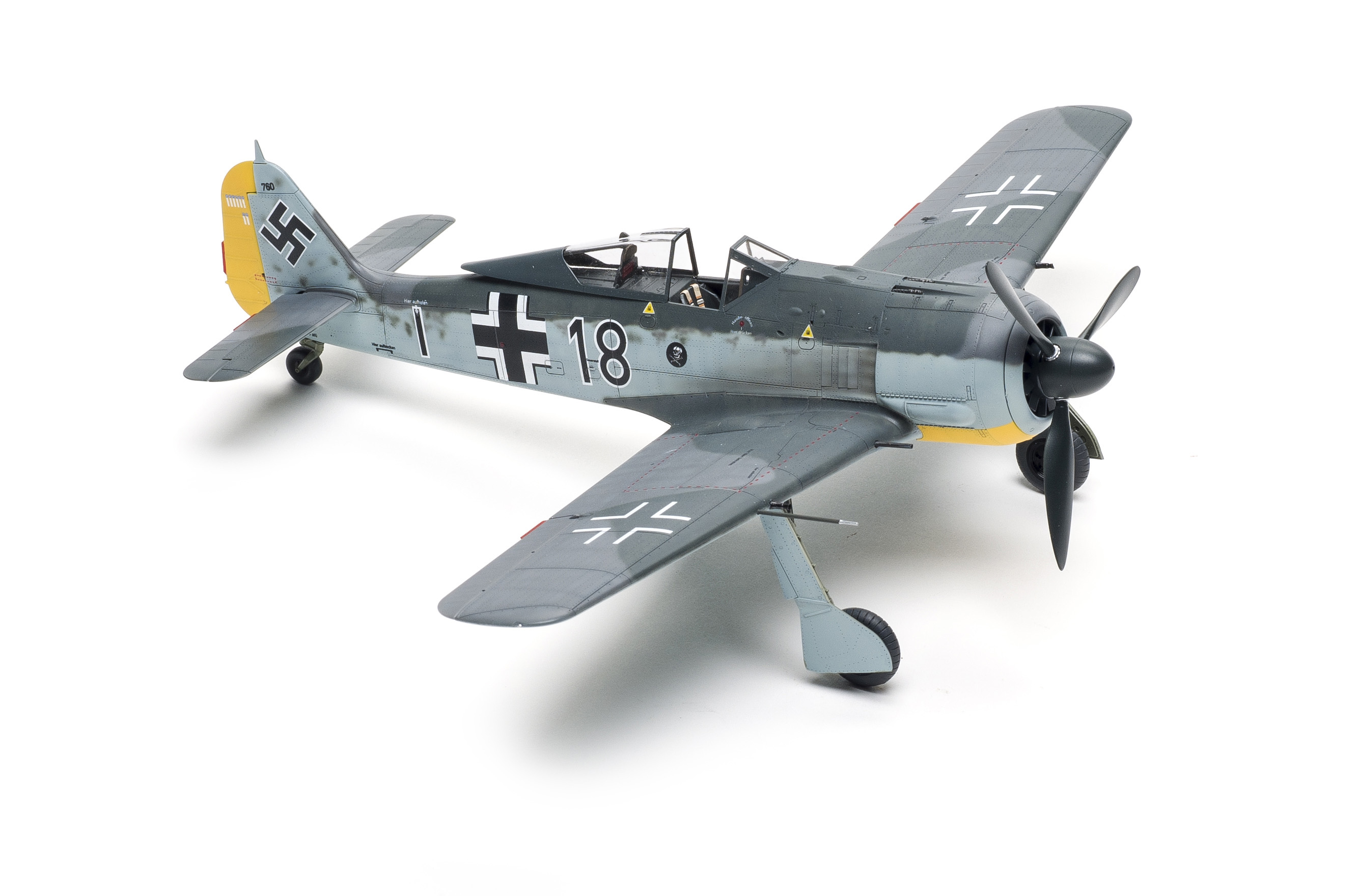

There are five marking options provided in the kit. I chose to build the aircraft flown by Rudolf Eisele of 8/JG 2 in France, 1943. These aircraft were the pride of the Luftwaffe at this time and were very well kept — some were even waxed to gain 1 or 2 more kilometers per hour in flight — so I used fairly restrained weathering, just a light panel-line wash and exhaust stains. The decals performed very well, settling into the recessed details to reveal the underlying surface textures. But they do look more flat in finish than the surrounding paint, even though they were sealed with clear gloss before the overall semigloss clear.
