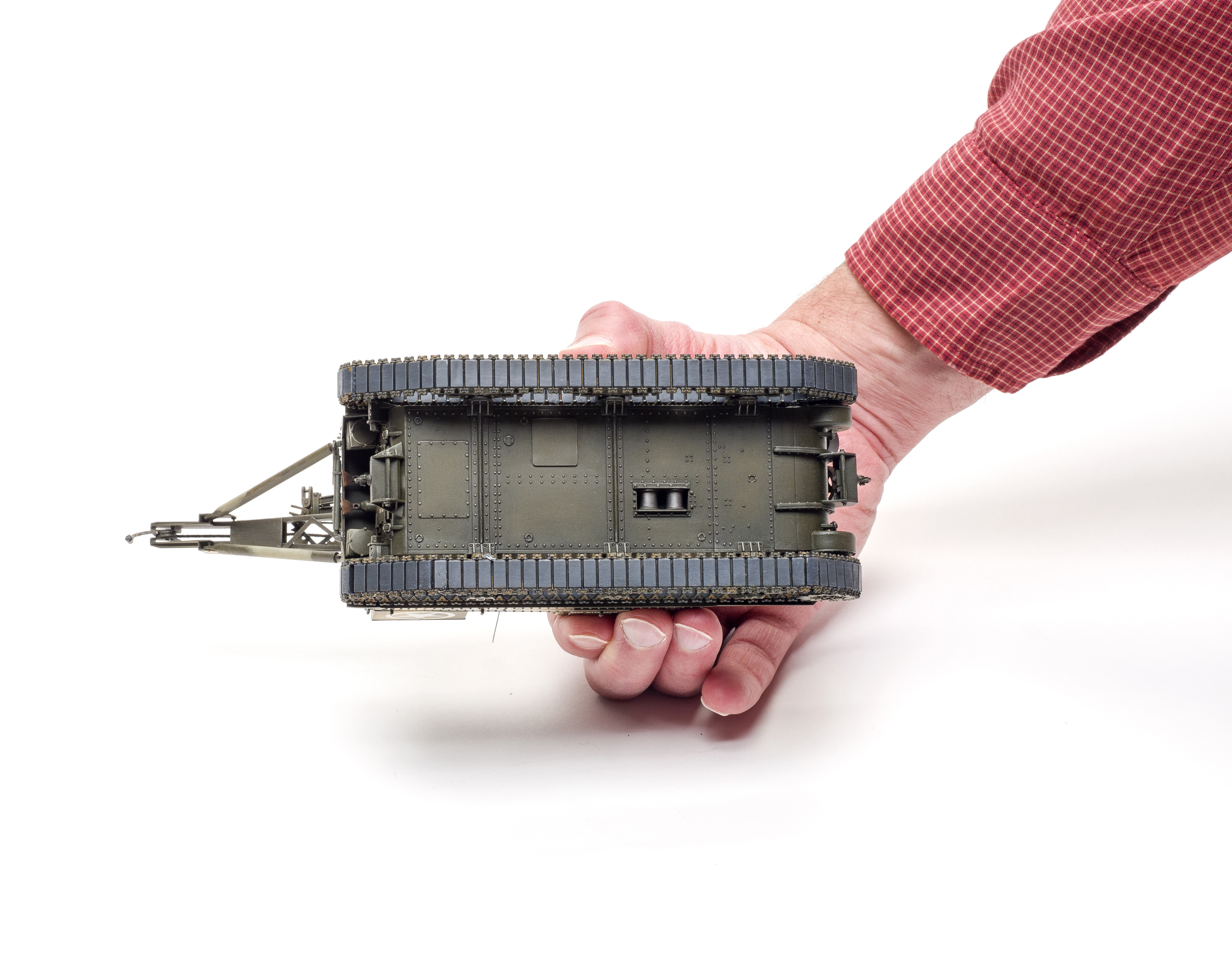

The lower hull is a one-piece tub. I mounted the winch rollers and their mount after the model was painted. Be sure to paint the hull interior black; you can see through the photo-etch (PE) engine-deck screen directly to the hull bottom.
If you are careful with the glue, the bogies will work. But the set sag of link-and-length tracks make this a moot point. Follow the directions and you will end up one link short — but there are four extras on the D sprue. The kit supplies a form that can be used on the upper run to get the proper angle from the first return roller to the drive sprocket.

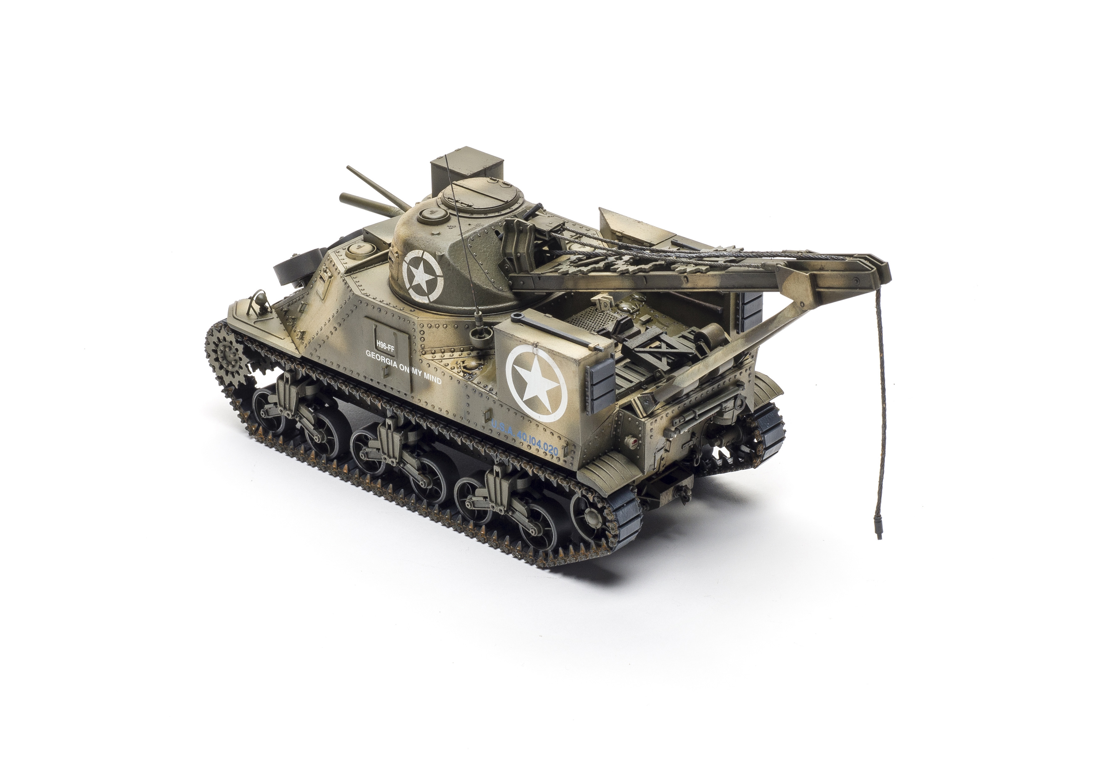

Assembly of the crane can be a little tricky. If you glue the two plates J2-25 on the top and bottom of the crane first, you’ll have a more-stable surface to allow you to glue the pins (J2-7, J2-13) and the pulley.
When assembling the tow bar, ensure J2-19 has the bolt facing up (mine’s upside down). With the crane mounted to the turret the whole assembly is kind of flimsy. So I mounted the roller assembly (Step 21) to the turret and left the crane off, snapping it into place after painting. The kit’s cable is oversized; I replaced it with thread. The cable is also too thick to fit the roller that enters the turret; I had to raise it a little to fit it as shown. There is no hook for the winch cable.

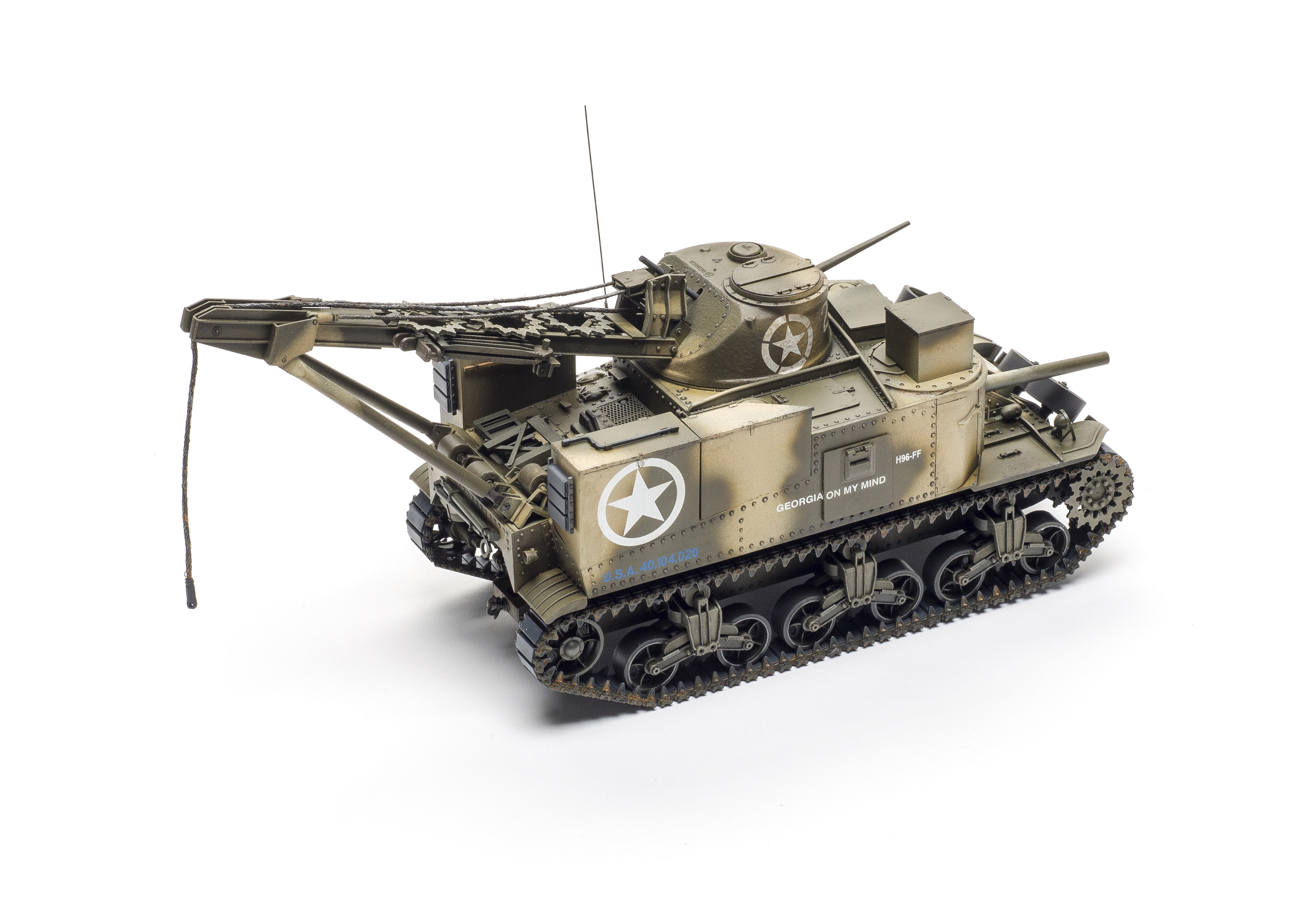

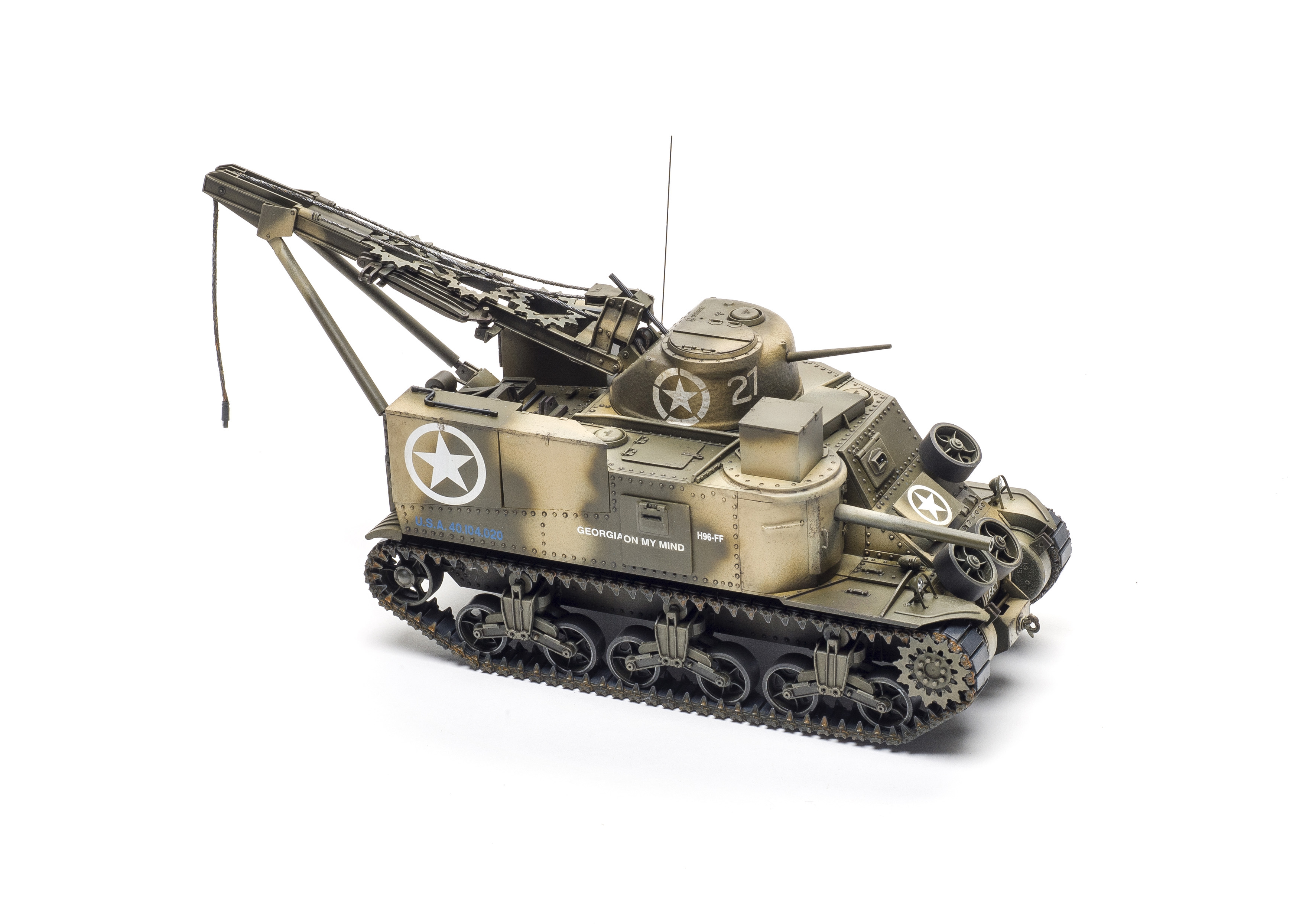

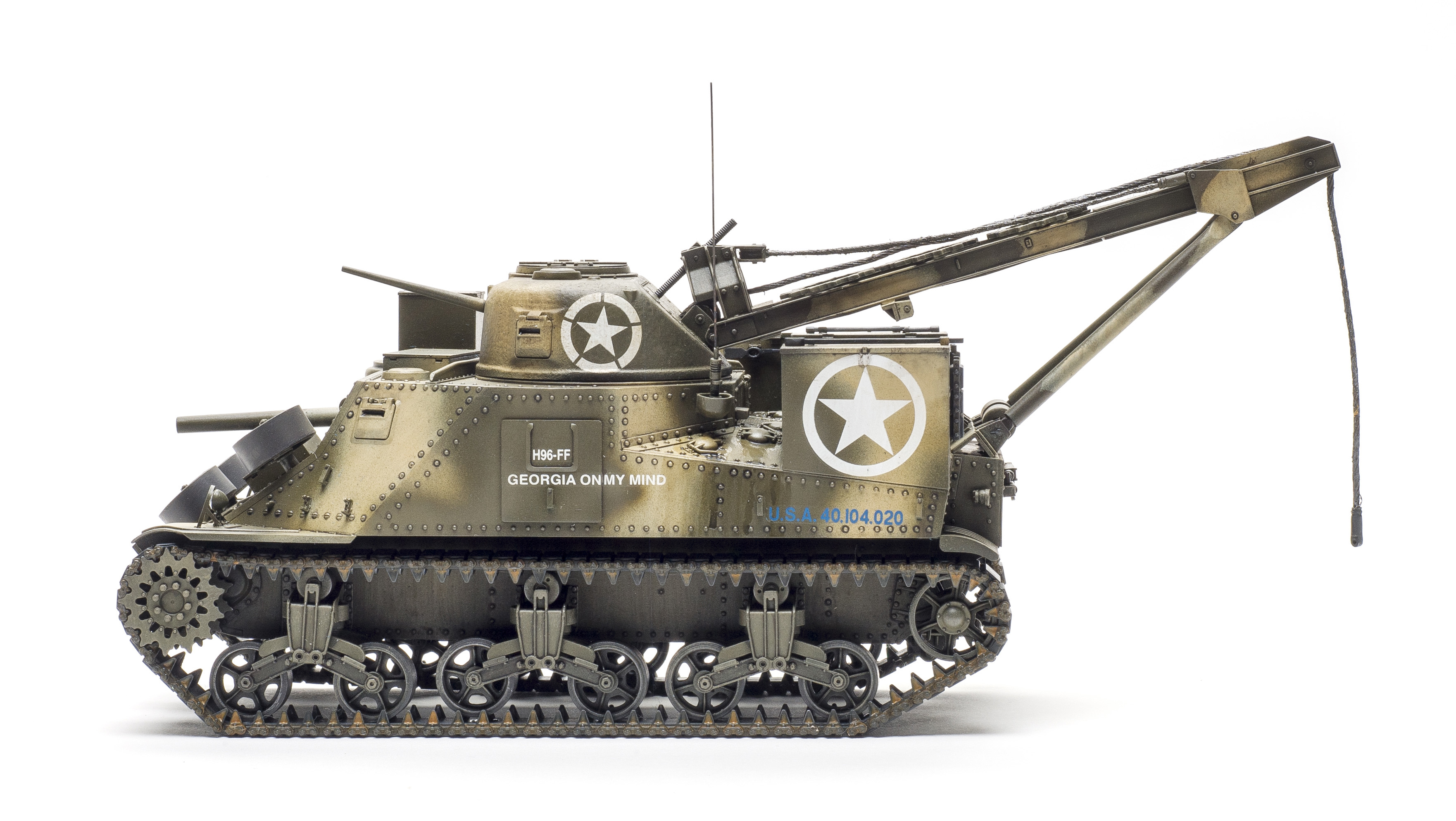

I modeled a vehicle of the 2nd Armored in Sicily. After base-coating with Tamiya olive drab (XF-62), I varied the finish with shades of olive drab from Ammo, LifeColor, and Vallejo Model Air, and used Vallejo sand yellow (71.028) for the tan portion of camouflage.
I had a little trouble getting the decals to release from the backing paper and had to soak them longer than usual. Several coats of Tamiya Mark Fit settled them with no silvering.
Modelers used to seek conversion kits or scratchbuild to make an M31, but Takom has come to the rescue with a model that looks complex yet is easy enough for most modelers. Mine took 52 hours to complete, mostly for painting and weathering.
According to published plans, the model is a little tall and wide but measures out to about the right length. Photos show these vehicles laden with tools and caked in mud — easy things to add to make this model your own.
