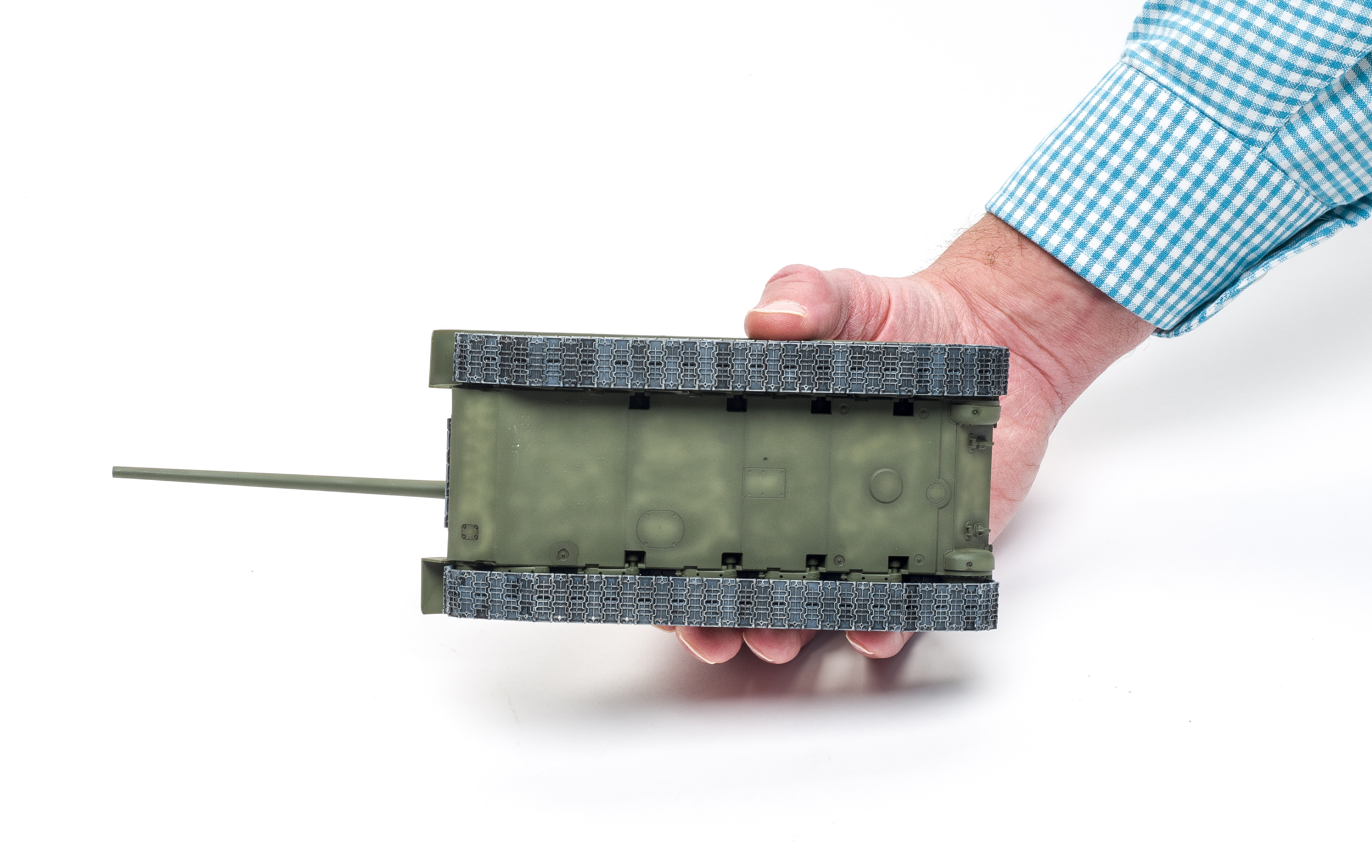

Molded in dark green plastic, the parts show nice surface detail free of sink or ejector-pin marks. The tracks are link-and-length and a jig is included to fit individual links around the drive sprockets and idlers. Clear parts are provided for the headlight lens, periscopes, and driver’s vision block.
The suspension arms are fixed in position so the road wheels won’t be misaligned. I left off the running gear and tracks until after painting.

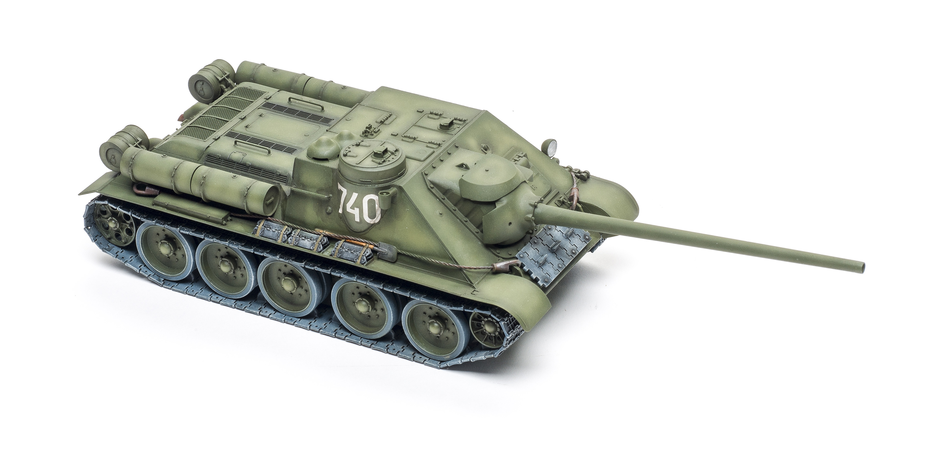

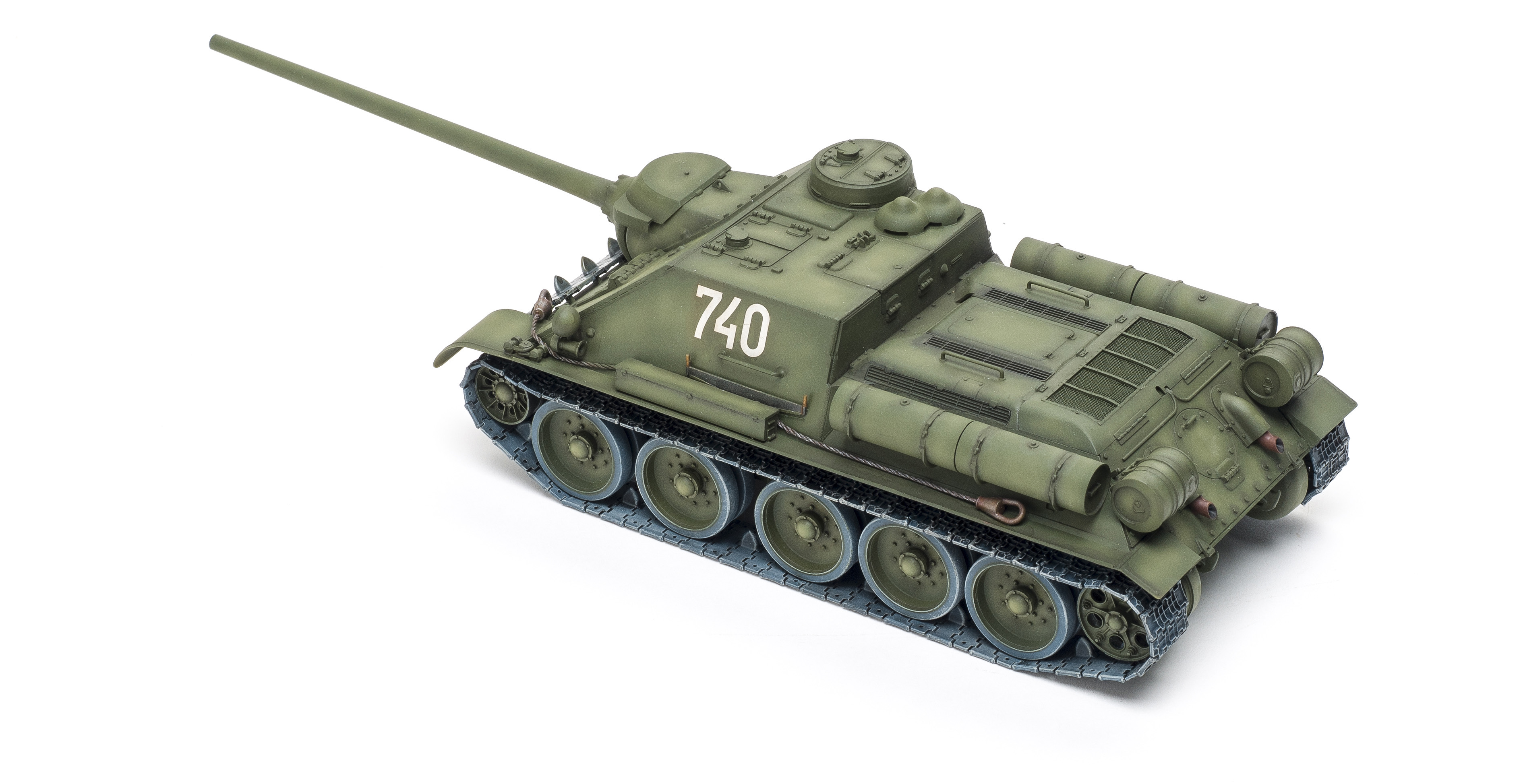

Leaving off the tools, tow cables, headlight lens, and spare tracks, I painted the model. The instructions suggest Tamiya dark green (XF-61), but that seemed too dark to me. I used olive green (XF-58) as a base color.
Decals were added over a coat of Tamiya clear and responded well to Microscale decal solutions. I originally applied markings for the 3rd Guards tank on the sheet, but the diagram for the left side of the casemate has the hull number in the wrong place and there was no room for the slogan. The 23 should be placed lower on the side with the slogan above as seen on the back of the box. Unfortunately, it was too late for me to move the decals, so I painted over them and applied the other set of markings.

The track jig worked perfectly and produced a perfect fit to the running gear.
Zvezda’s SU-100 matched the dimension in my references almost perfectly with the only discrepancy being the height which was about 1/8-inch short.
I spent 16 hours on my SU-100 and it was a refreshing change from the high-part-count kits I’ve built recently. While it is a quick, easy build, the detail and appearance of the finished model is impressive. Any modeler with a couple of years experience should be able to handle it.
