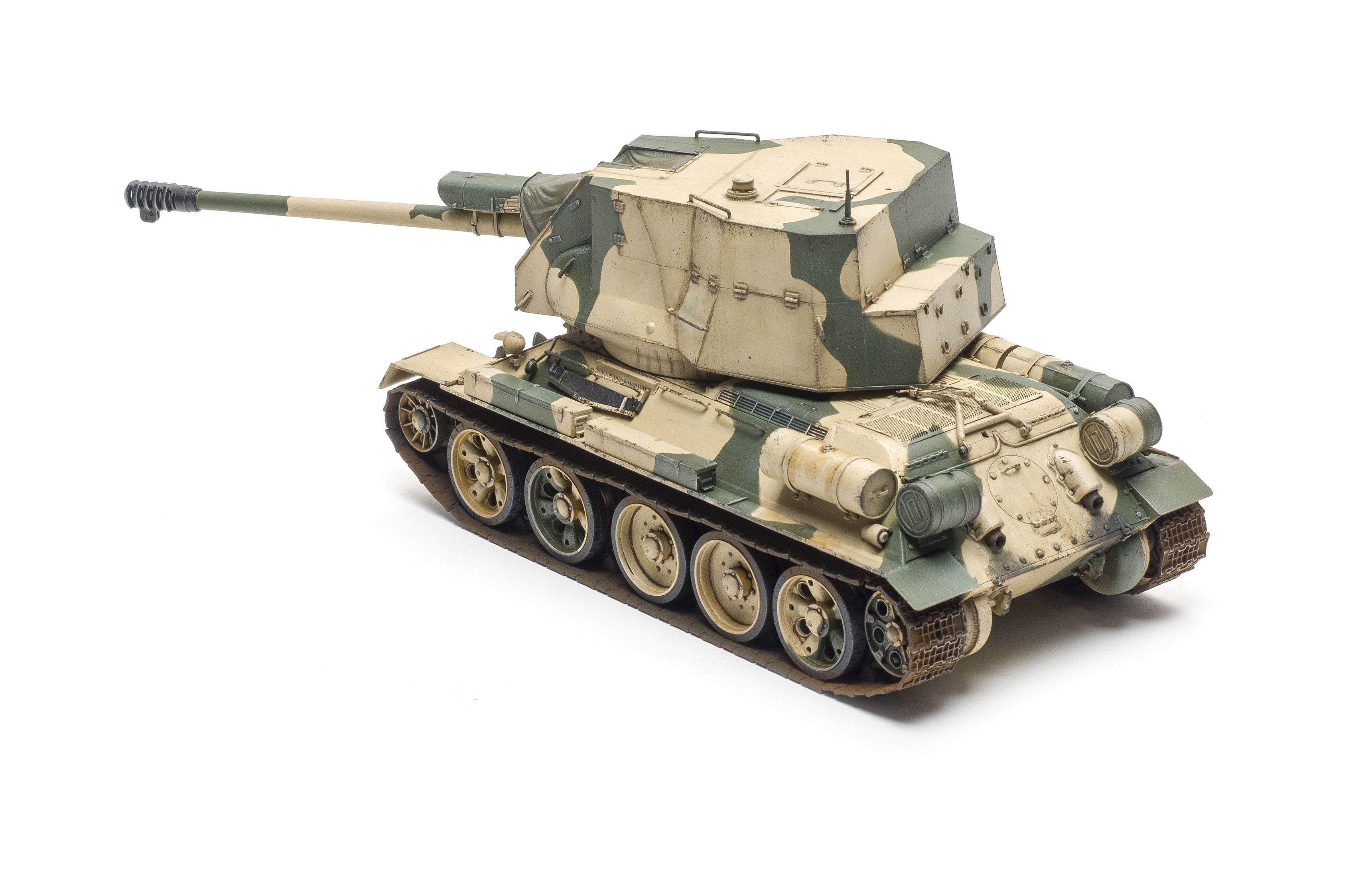

A pair of smoke units on the rear hull proved the most complicated aspect of the build. Instructions for bending the PE brackets are vague but, thankfully, the PE is strong enough to be bent a couple of times. Deviating from the instructions, I glued the brackets to the hull and attached Part C23 to the bracket; use caution as these pieces are fragile, and I damaged one. Then, I glued the mounting straps to the tank before gluing the cylindrical generators to the bracket.

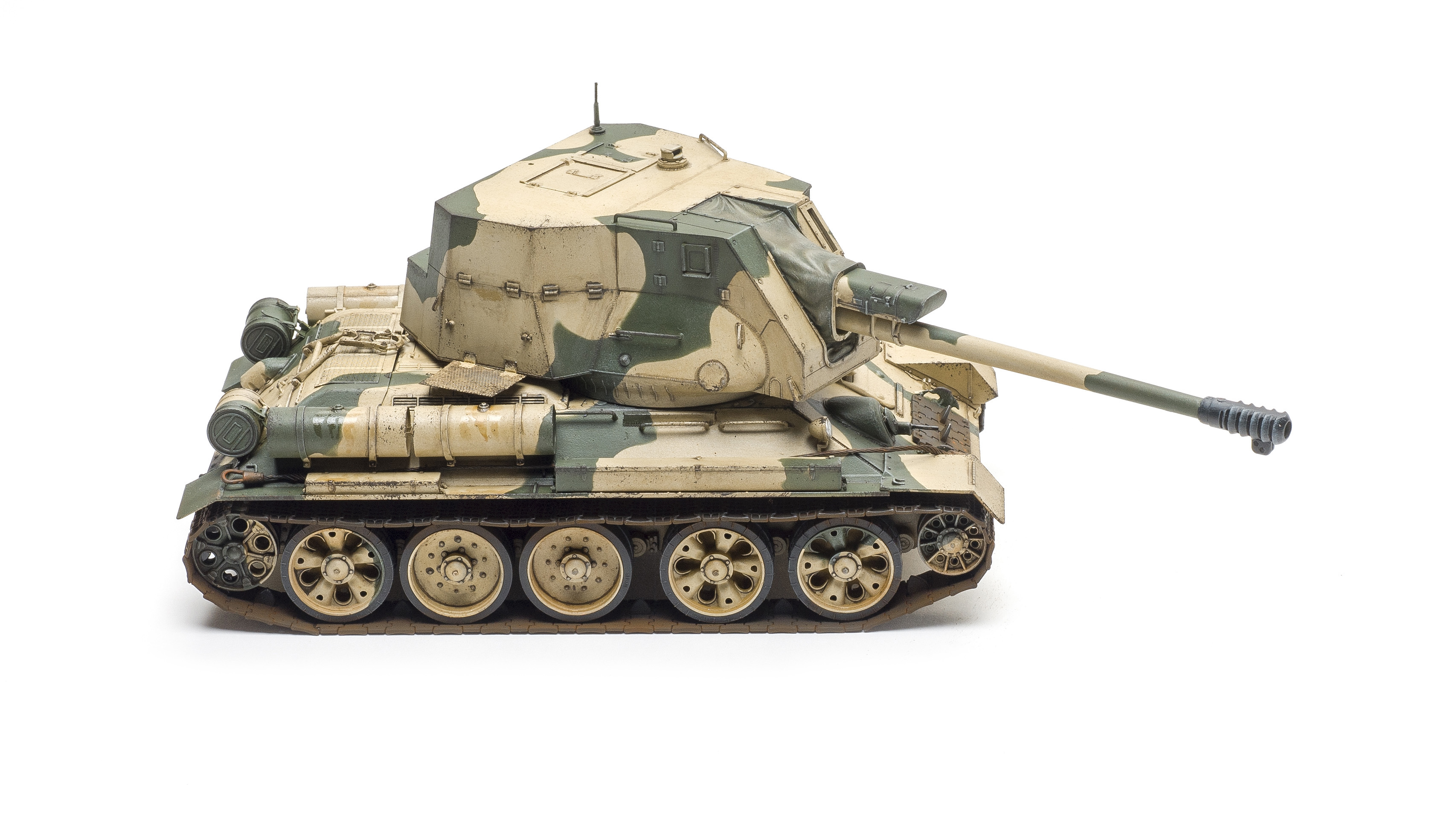

The main gun barrel is molded in halves, a disappointment since slide molding was used elsewhere in the kit. Two muzzle brakes are provided, but only one is shown used in the directions. Mount the muzzle brake after the gun is in place in the turret to get the proper alignment. The breech and cradle are nicely detailed; this assembly mounts on the lower turret piece.
The rest of the turret assembly was straightforward, except for the vinyl dust cover. It was crushed in my kit, so wouldn’t conform to the separate turret front. Instead, I attached the forward plate to the turret body, then attached the vinyl cover by gluing it a little at a time. Once the cover was in place, I anchored it with scrap strip styrene glued inside the turret.
Assembly of the two halves of the turret was problematic. The directions state to “strongly” push the gun through the dust cover’s opening. They aren’t kidding. I broke cradle and many small details trying to get the gun into place. Instead, attach the cradle to the lower turret half without the gun. After pushing the barrel through the vinyl cover, secure it to the cradle.
The actual tank has numerous hatches, but only the commander’s is separate in the kit and it has no detail inside.

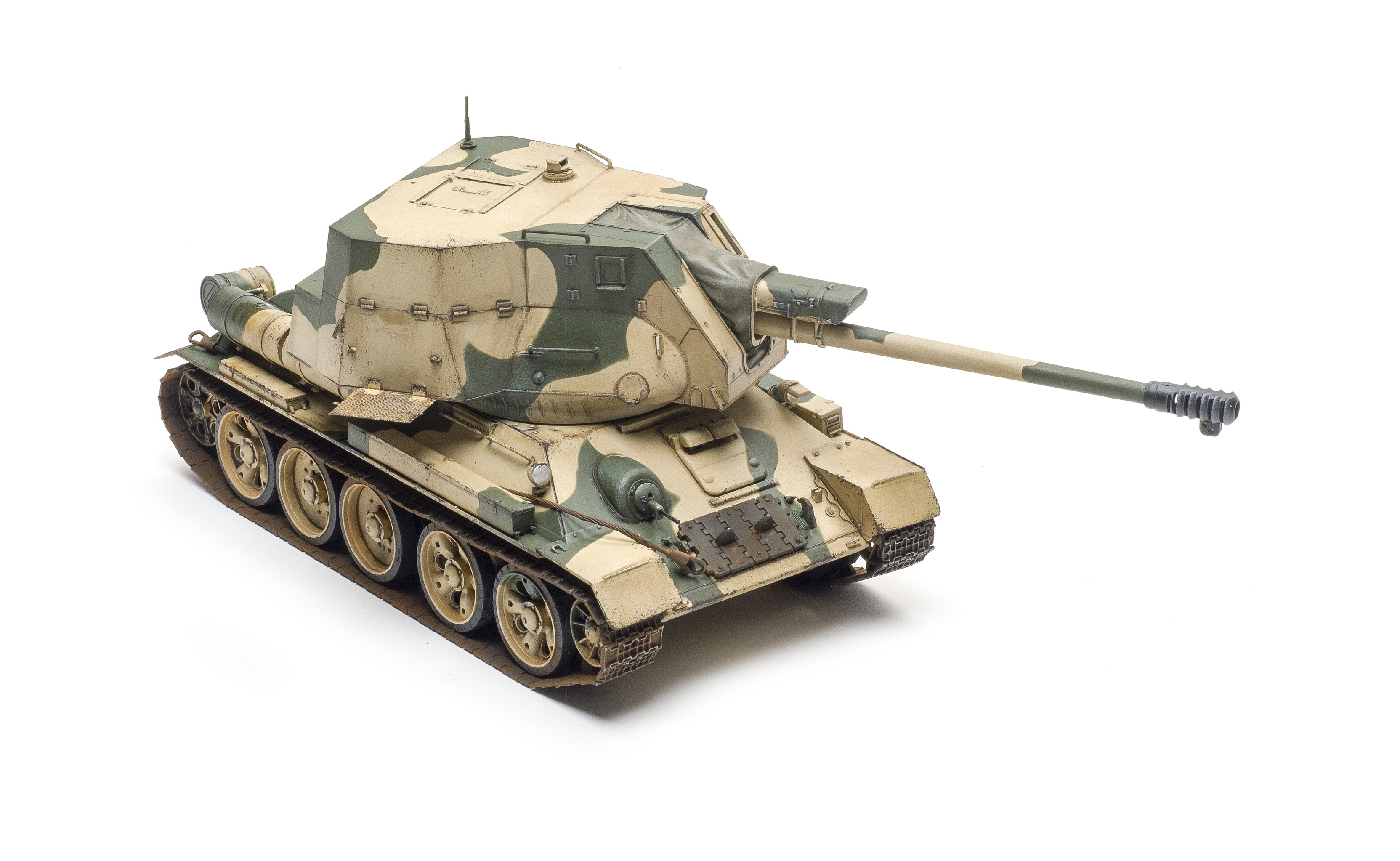

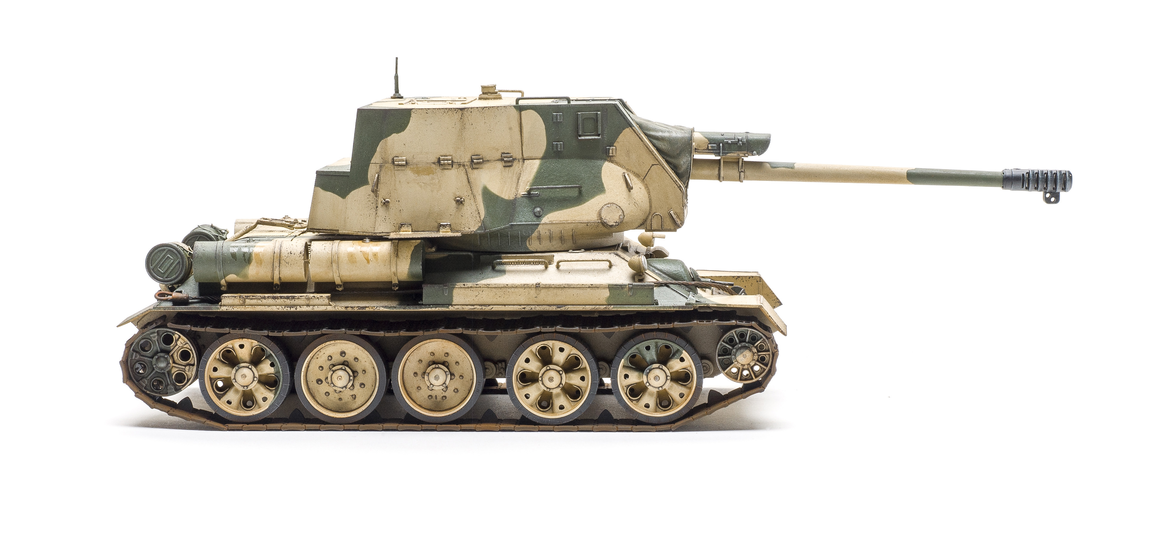

Choosing a two-tone camouflage from the color diagrams, I painted the model with Ammo and Vallejo acrylics over Tamiya base coats. No decals are provided, so weathering is where you give the model its personality.
Considering the detail, I was surprised to find that it only took me 34 hours to complete the T-34/122. If not for the complexity of the rear smoke tanks and tracks, I would recommend this model for most modelers.
The completed build demonstrates the top-heavy appearance of the vehicle. Unused parts point to Ryefield following up with a Syrian open-top T-34/122 and it would be great to see an Egyptian T-100 antitank gun.
