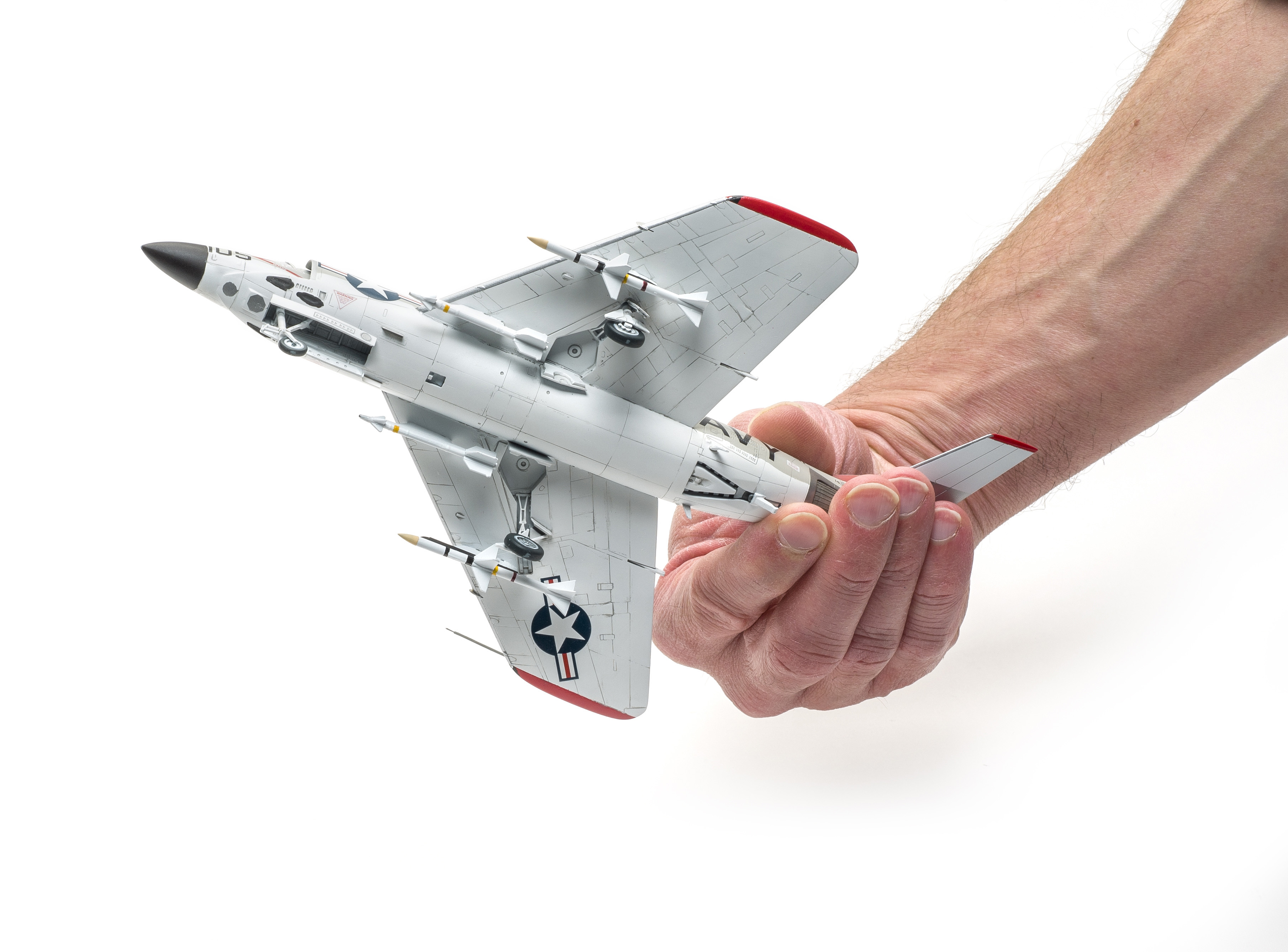

The kit comes with a pair of Sidewinders, but they look like a later type than the Demon carried. I rounded off the noses to partially correct them. You also get a pair of Sparrow I test missiles and a pair of Sparrow III production missiles. The tiny pins on the missile pylons and shallow holes in the wings make attaching the weapons stores difficult. Also, the diagrams show the shorter pylons being attached outboard, while photos show they should be inboard. I left off the drop tanks as they were rarely carried.

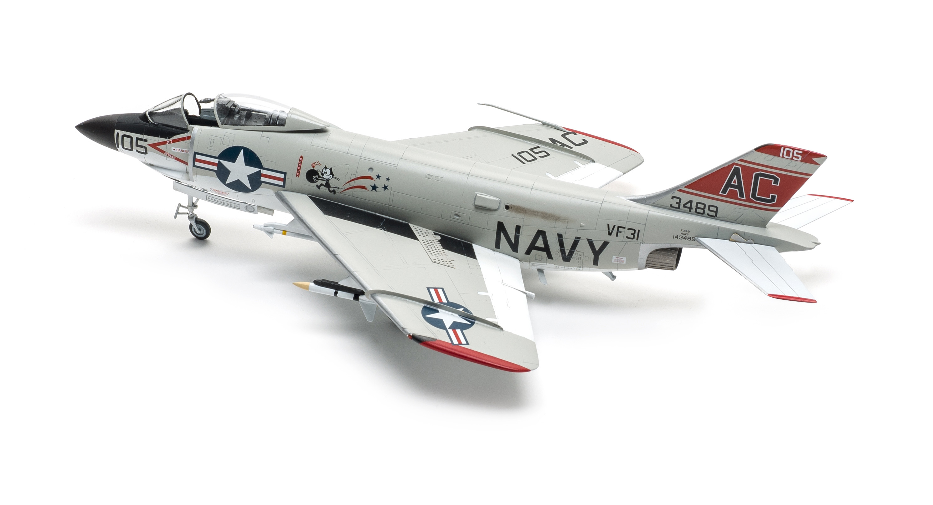

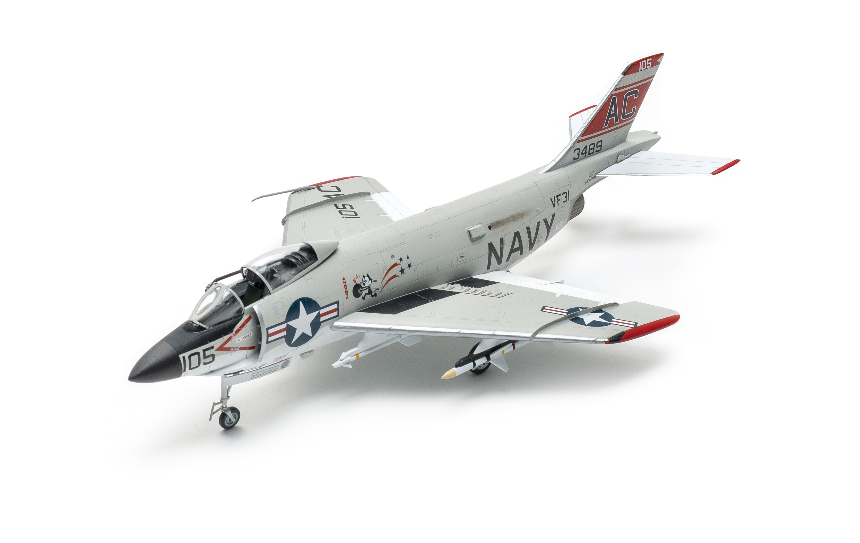

I painted with Mr. Color lacquers and kit decals seemed thicker than previous Sword releases and were easier to handle. The model looks fine despite missing bits.
I put 19 hours into my Demon. When I build another, I’ll redo the nose gear strut to better represent its unique structure.
