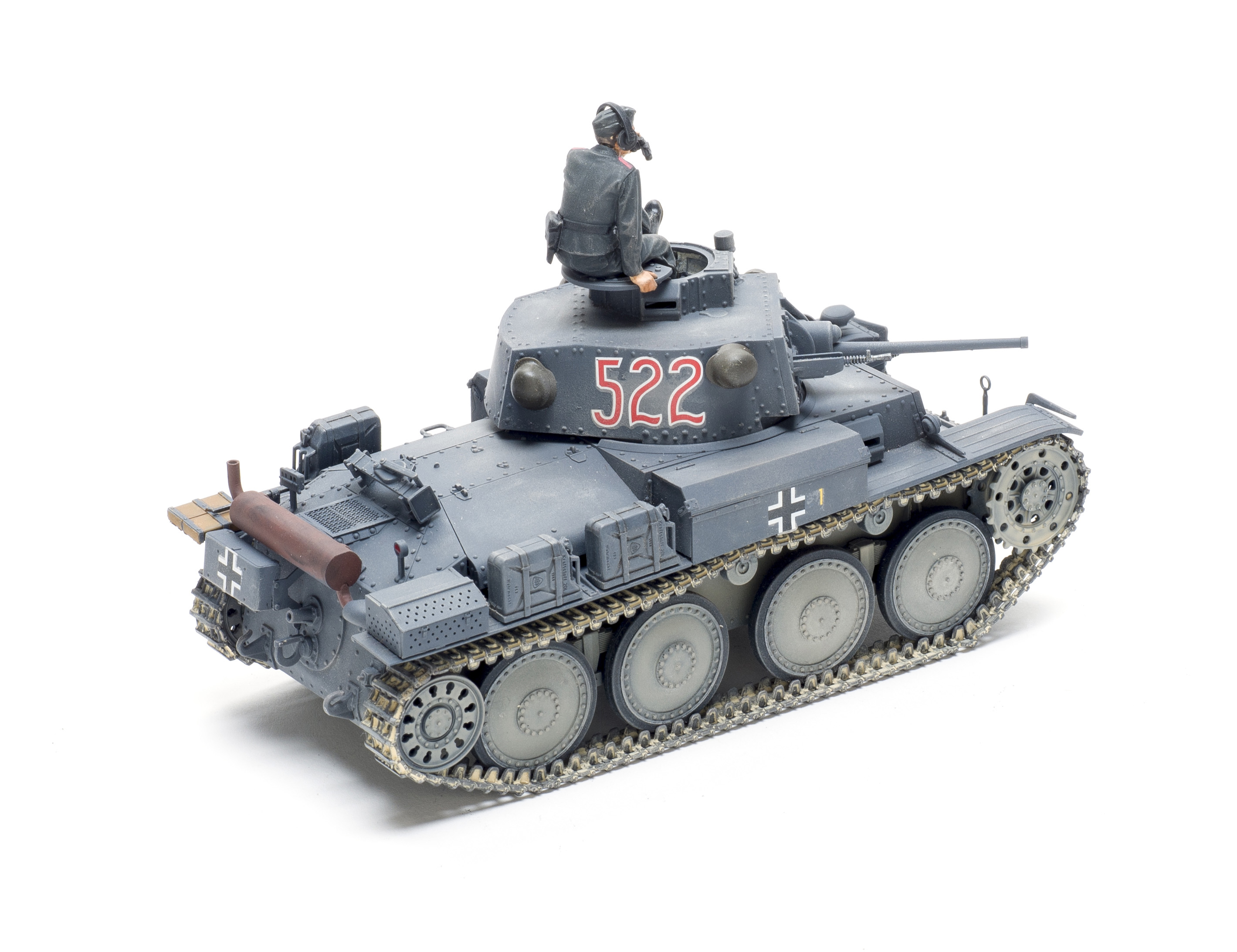

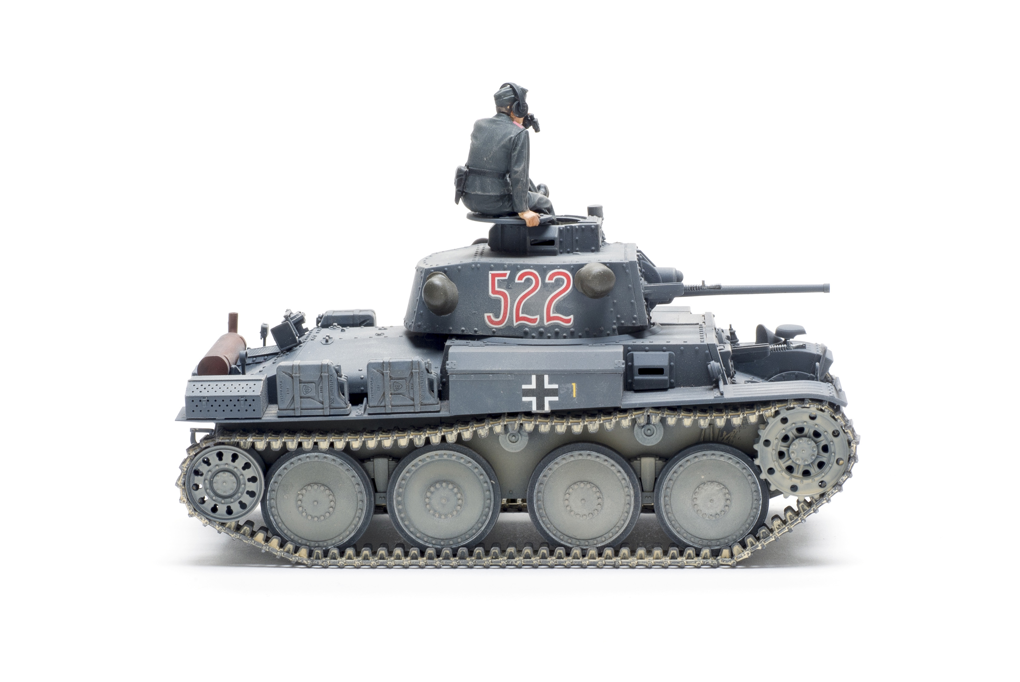

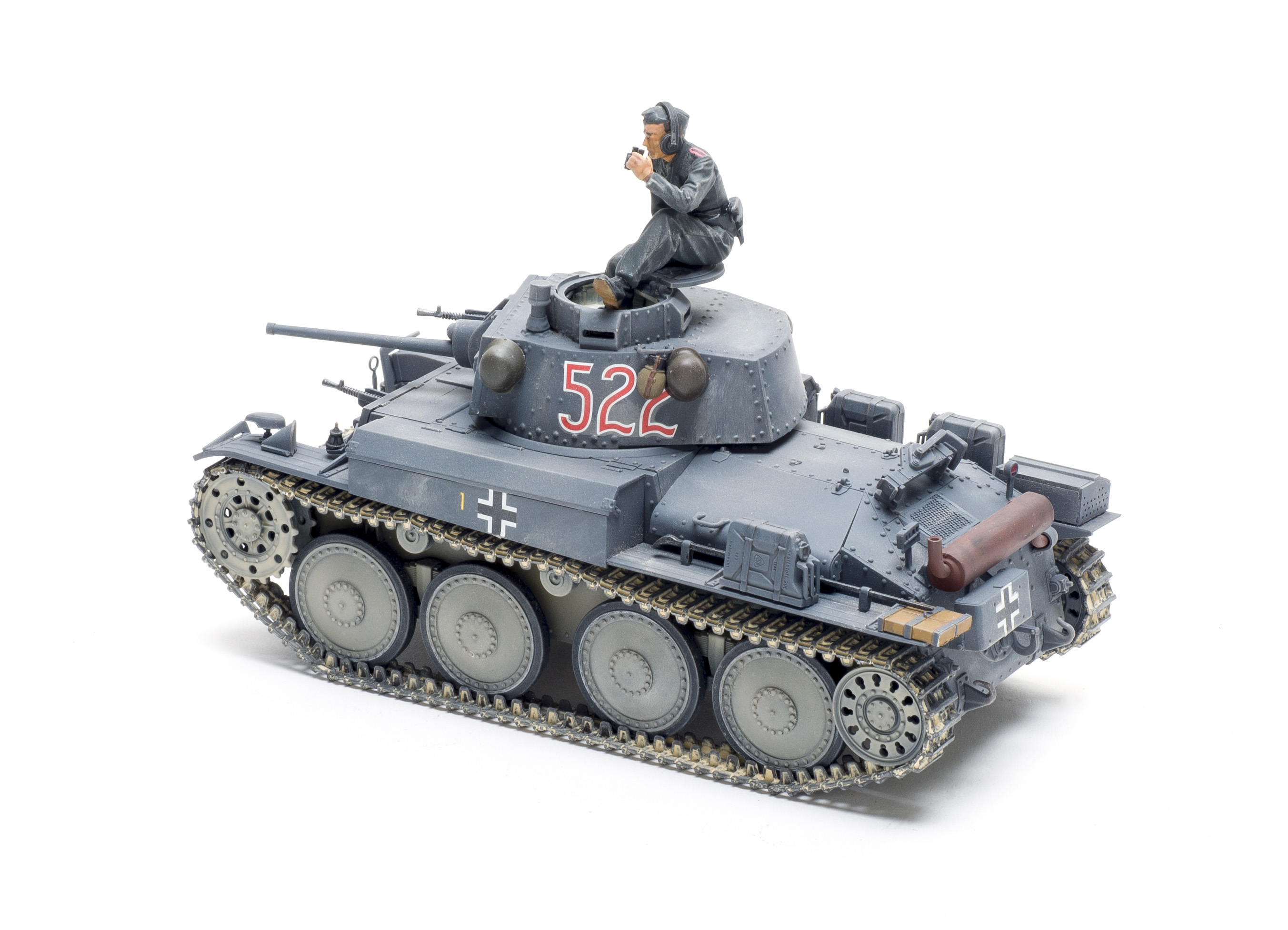

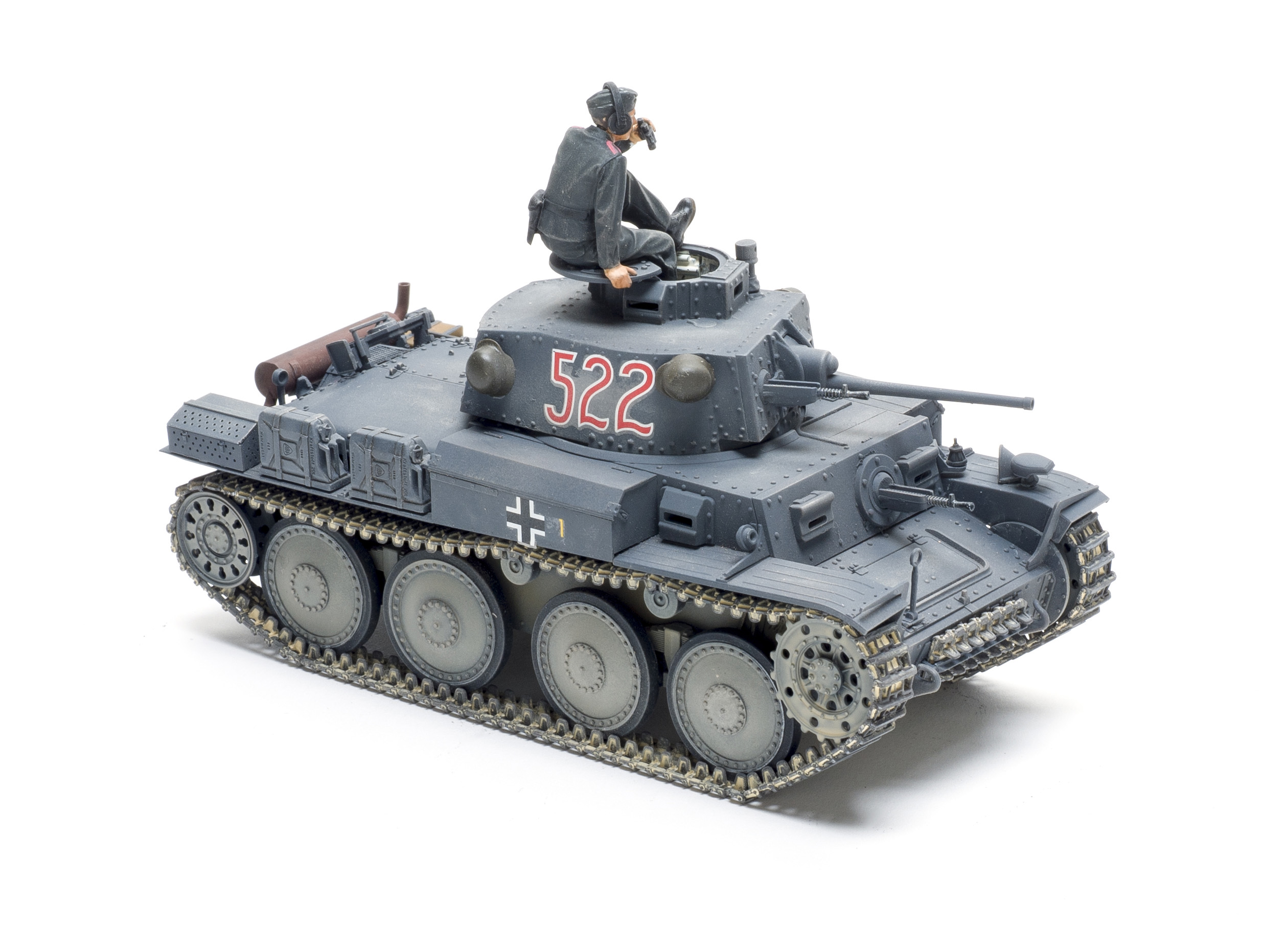

The lower hull consists of five parts with the instructions indicating the correct order of assembly. The upper hull parts, including the transmission cover and turret ring, fit perfectly. Superglue spread with a toothpick secured the PE engine grille.

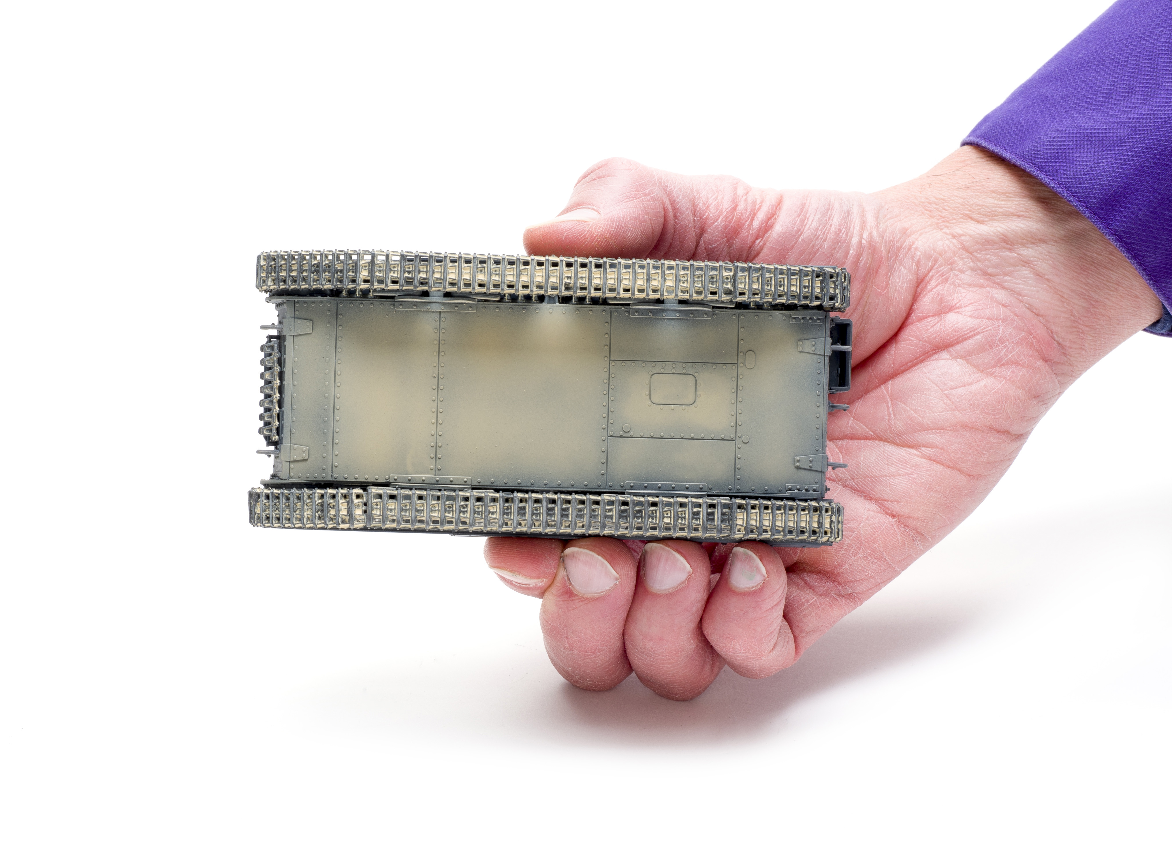

The suspension comprises leaf springs and separate suspension arms. After painting and weathering the lower hull, suspension, and road wheels, I installed the link-and-length tracks in the indicated order using Tamiya Extra Thin Cement, which provided enough working time to allow for adjustments.
I fit the fenders and engine hatches next. Pay attention to the marking option you are building as one of the tanks omits the bow machine gun and has a blanking plate in its place. I bored out the hull machine gun muzzle with the tip of a No. 11 blade to improve realism.
After fitting external fuel cans and toolboxes, I painted the upper hull.
Since I planned on leaving the commander’s hatch open, I painted the inside of the turret and part of the cannon flat white. Before assembling the turret, I painted the gun’s breech and machine gun gunmetal. The turret sides, mantle, and top were added at this time. Take care when building the commander’s cupola. After painting the turret I added helmets and canteens to the top edge as seen in wartime photos.
Choosing the marking for a 19th Panzer Division, I applied the decals which went down nicely without solvent.
After painting the figure, I placed him in the cupola and called the little tank done.
