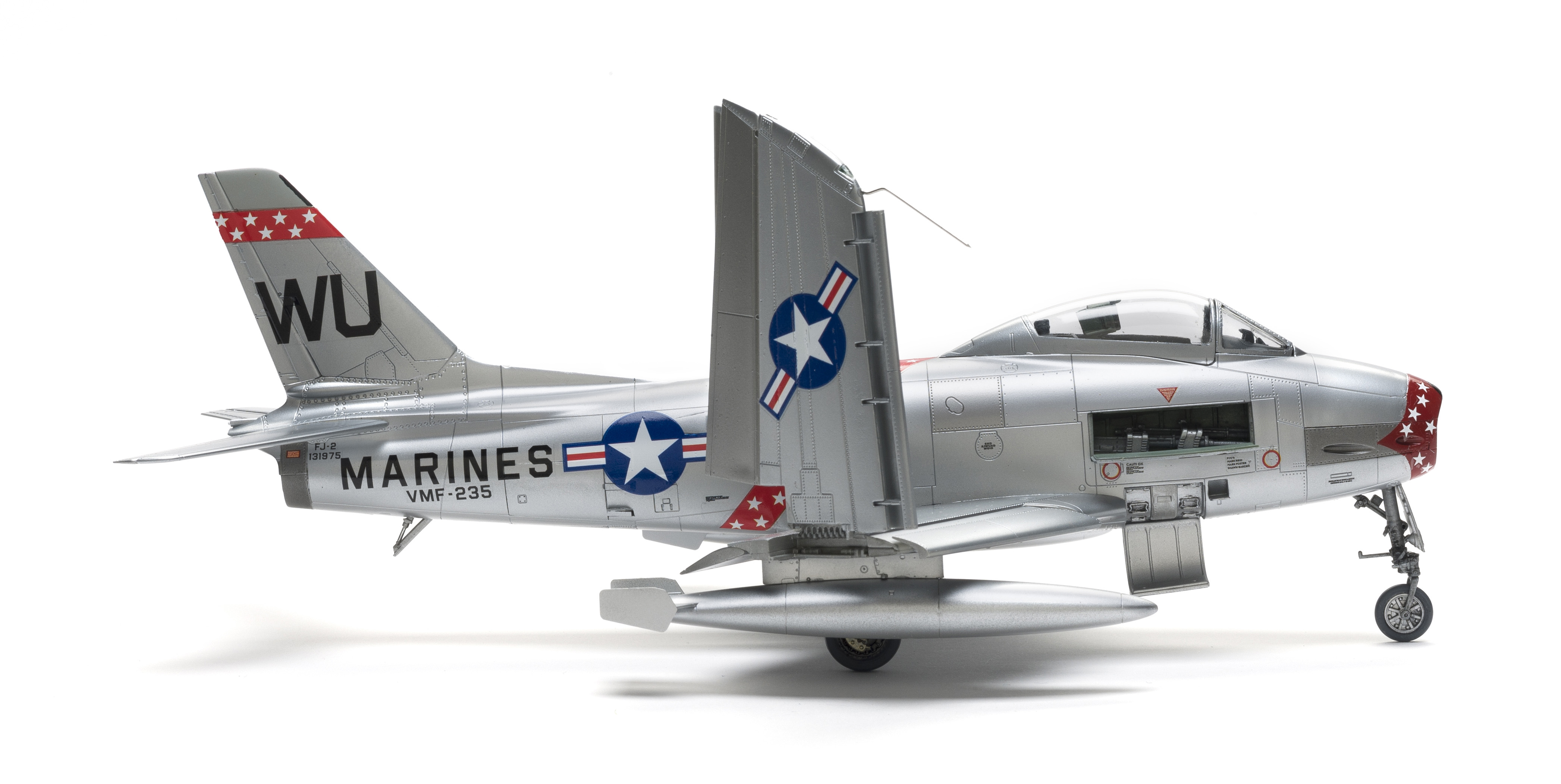

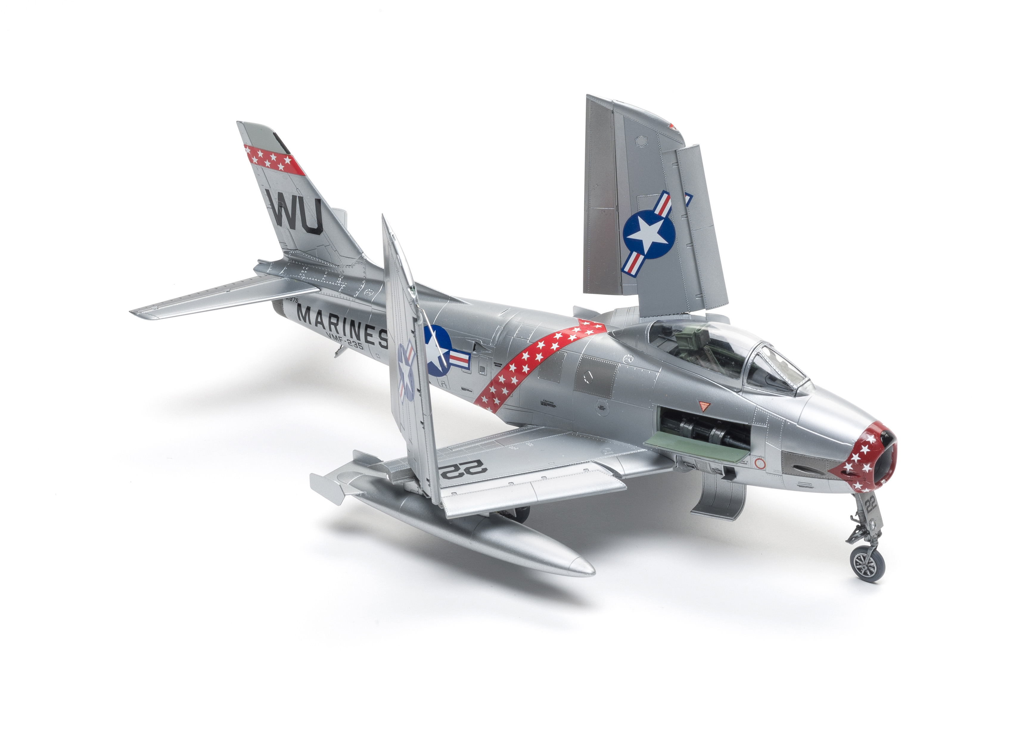

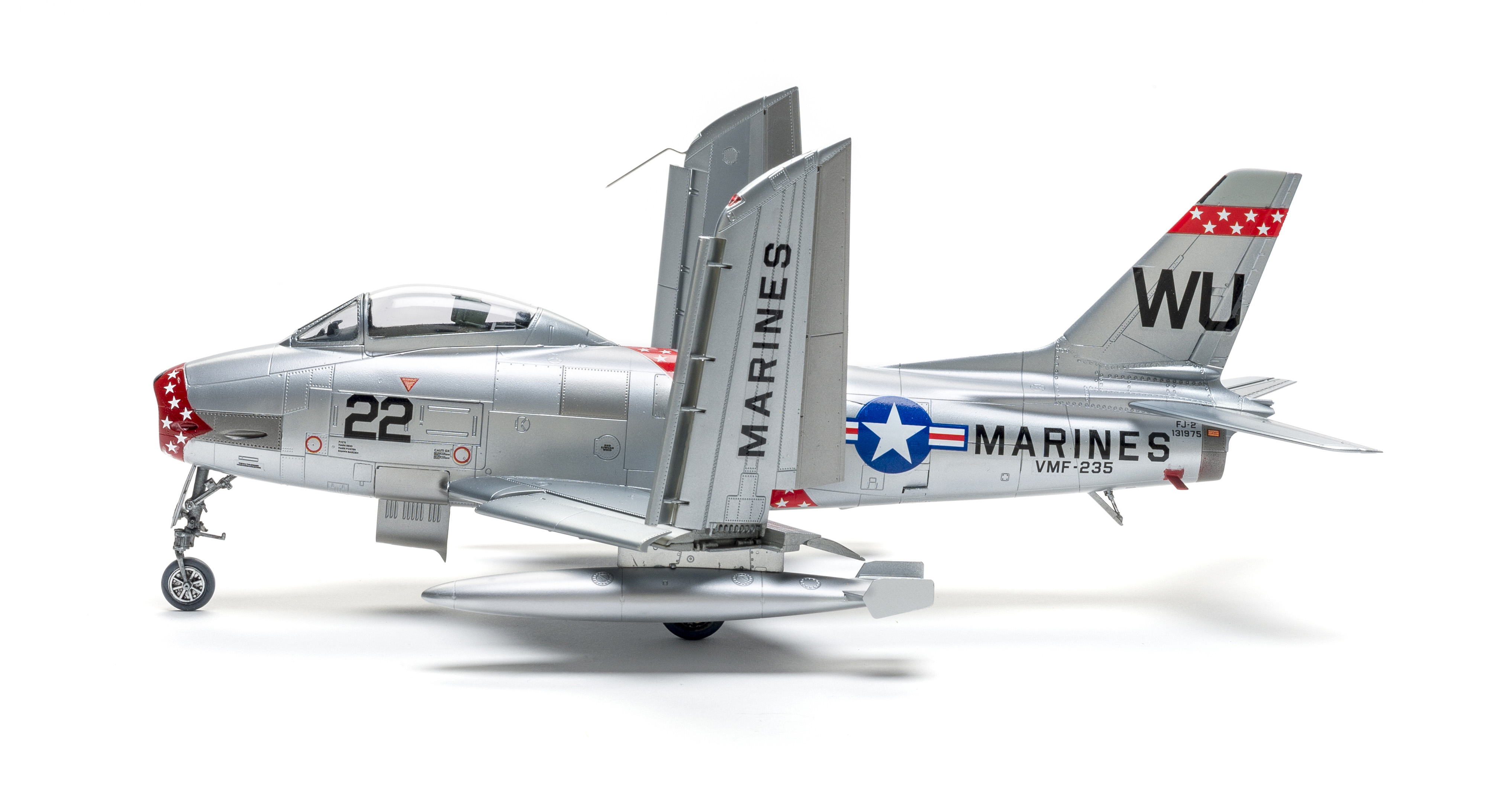

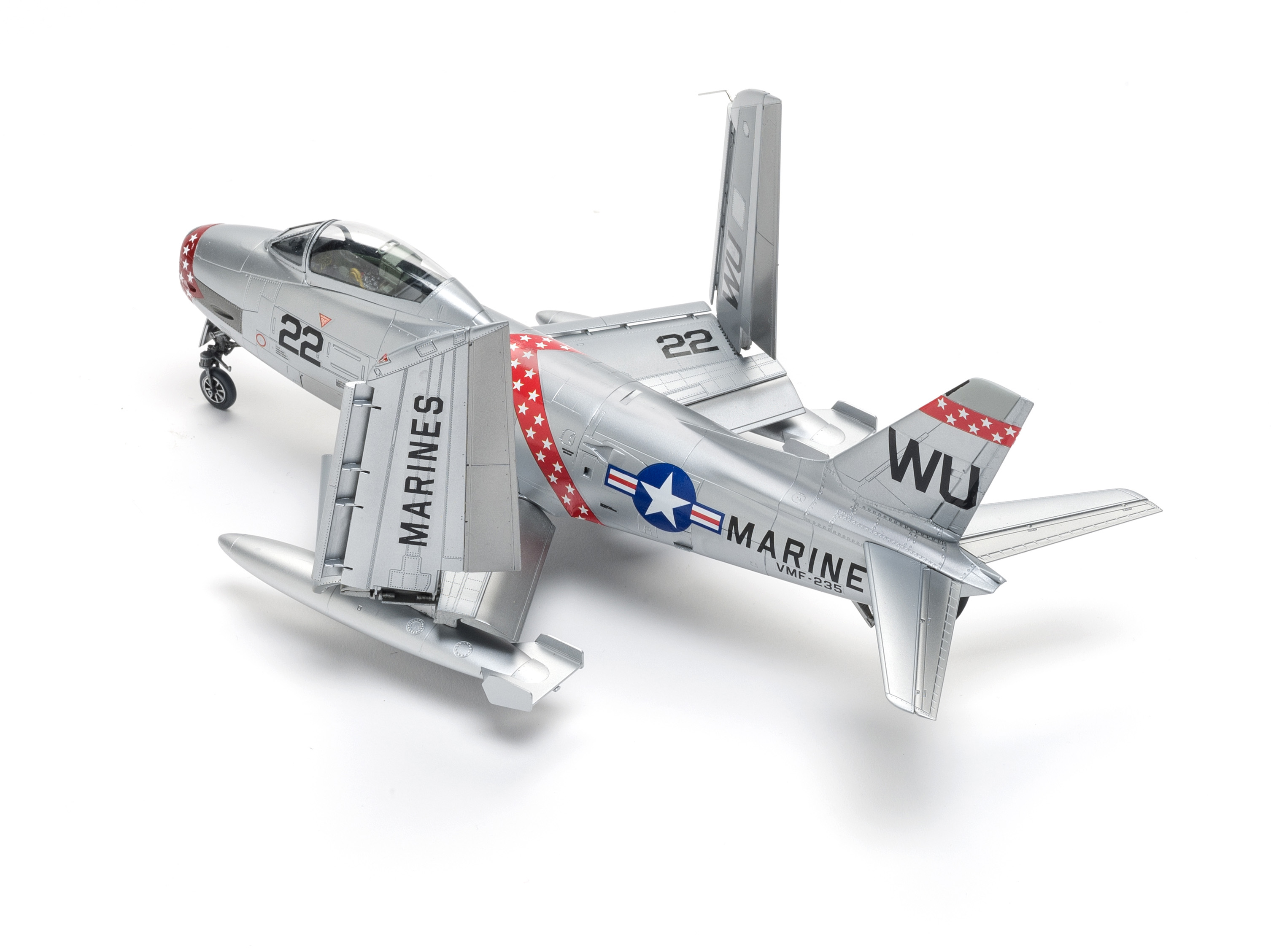

The good news is that Kitty Hawk nails the wings, including leading-edge slats and trailing flaps, and they fit perfectly folded or spread. (I chose the former so it didn’t look like another Sabre!)
Fill the holes in the wings intended for the Sidewinders. Frustratingly, no mounting features of any kind are included for the drop tank pylons.
When mounting the wings to the fuselage, I found that the tab that engages the lower portion of the engine interfered with the fit. So I removed it. Place the ammo bay (Part A1) prior to mounting the wing or the fit will be extremely tight.
I used Alclad II for the natural-metal finish. The center section of each wing panel was sprayed with a mix of Alclad gray primer and Alclad aluminum to get the “silvery-grey” color.
The decals are a mixed bag. They went on nicely, but have a number of frustrating errors in font, size, and length along with inaccuracies in the size and number of stars compared to photos. The blue in the national insignia seems too bright to me as well. However, once corrected as much as possible and on the model, the markings look fine to all but a Fury fanatic.
I spent about 33 hours on my Fury, a little more than I expected. Purists will want to replace the decals, but in the end, it is a beautiful rendition of the FJ-2.
