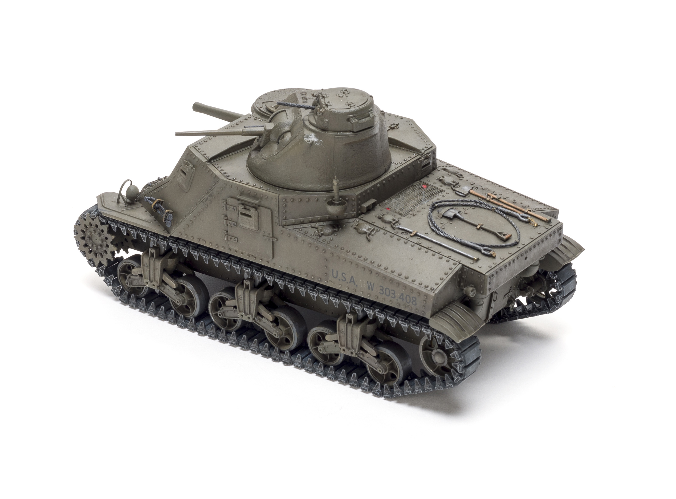

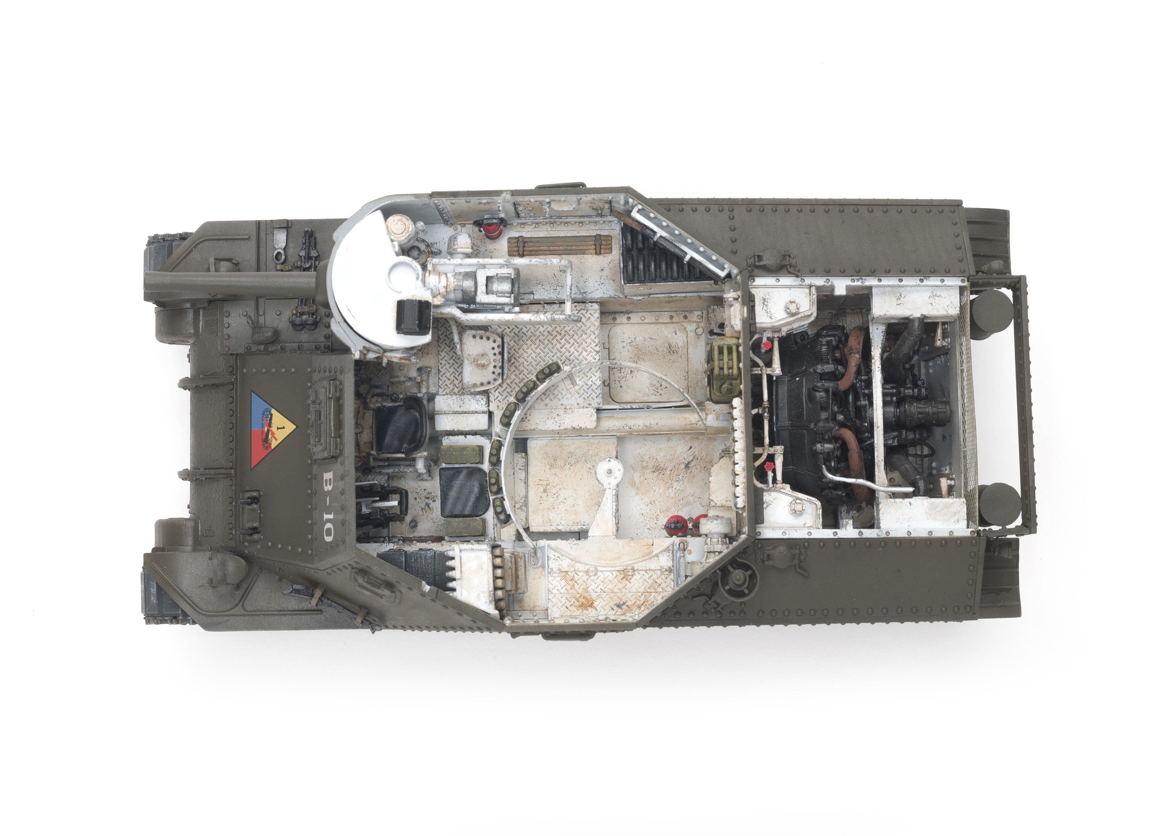

The hull bottom builds from three parts (probably to accommodate different versions) that lock together. I accidentally removed locating tabs from the bottom of the final drive (Part B26) and it ended up too far to the left and I had to trim it to fit the left side.
I held off adding the sides until most of the interior was assembled and painted. Fortunately, those details fit perfectly. The engine was quite detailed, but most of it disappeared under the engine shroud.
I left off the motor mount (Fa13) and any parts that mount over it because its fit on the engine was vague. Once the engine was in place and aligned properly, I added the mount and remaining parts.

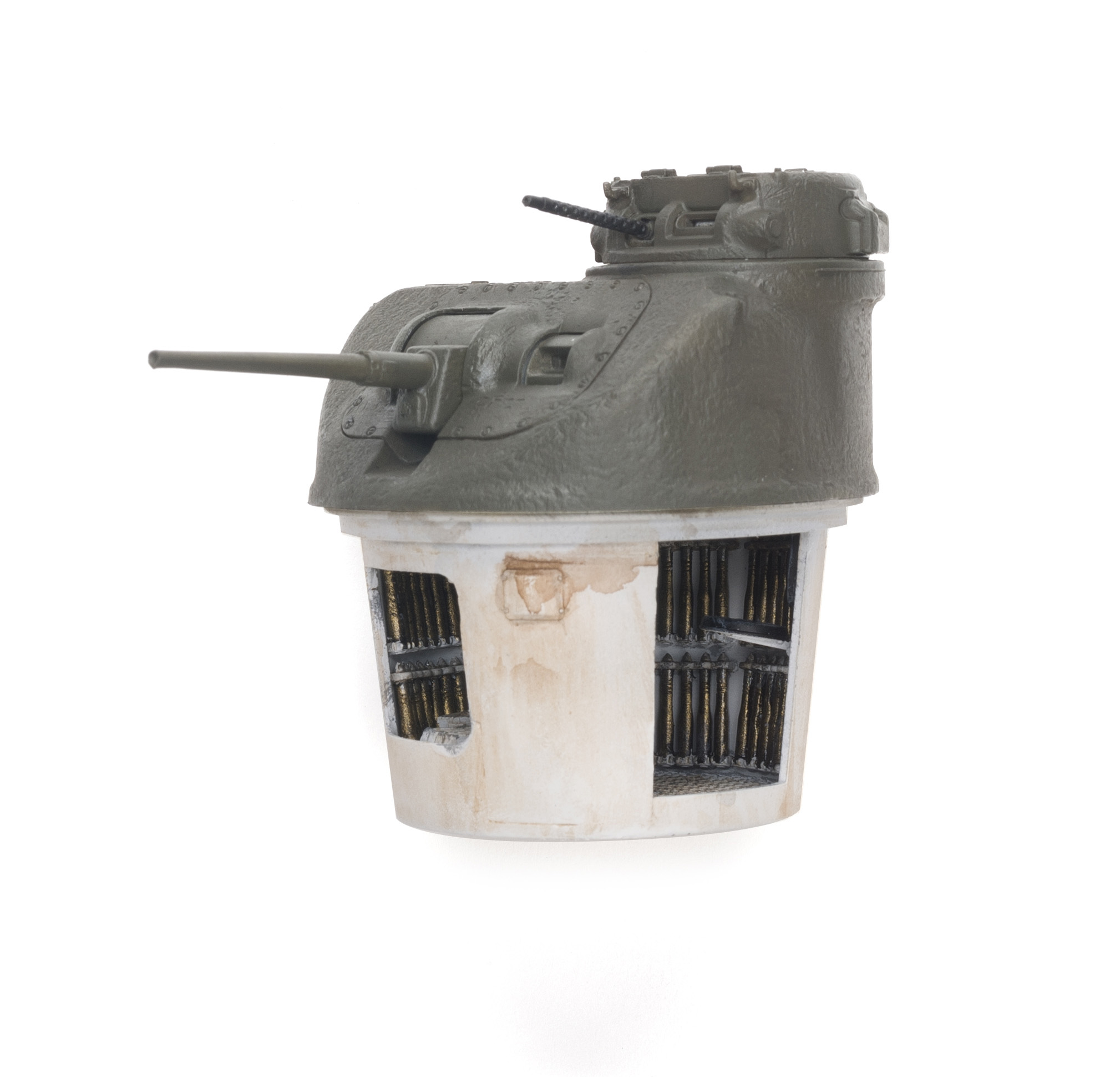

In Step 44. the position of the gun’s elevation mechanism was a bit vague. Test-fit the gun with the mounts in the mantlet to be sure the elevation gear doesn’t interfere with the gun’s movement. I extended the gun’s rotation pin with a styrene disc to give the unit a secure footing.

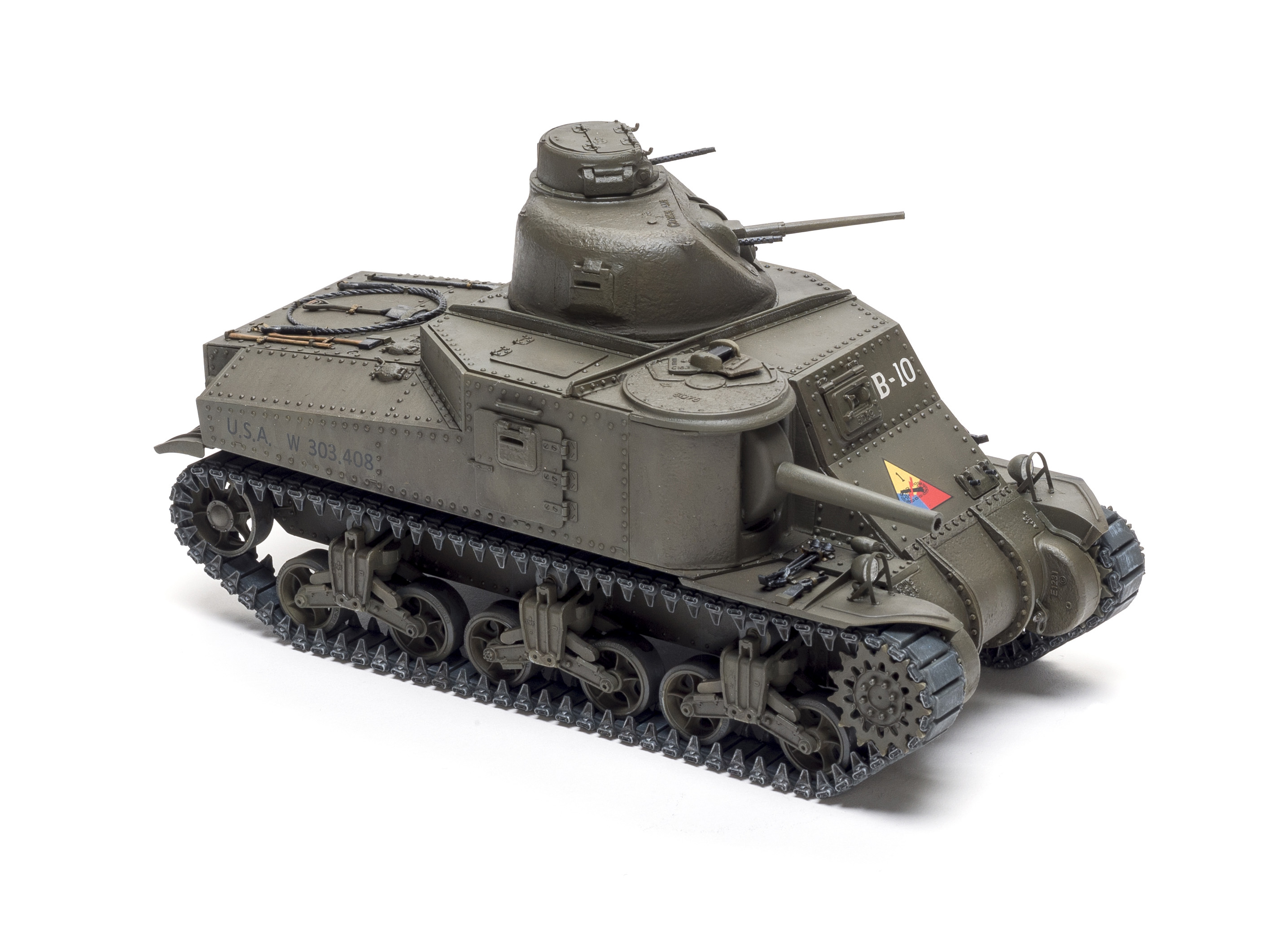

During assembly, I constantly checked the fit of the main body panels and was pleasantly surprised to find things fitting perfectly despite how much goes inside. Adding parts to the front pushed the nose forward and eliminated gaps I was apprehensive about.
I planned to leave the roof removable to display the interior, so I taped it in place to align the body panels as the glue dried. To leave the engine deck removable to show off the engine, I carefully glued the front and rear plates together.

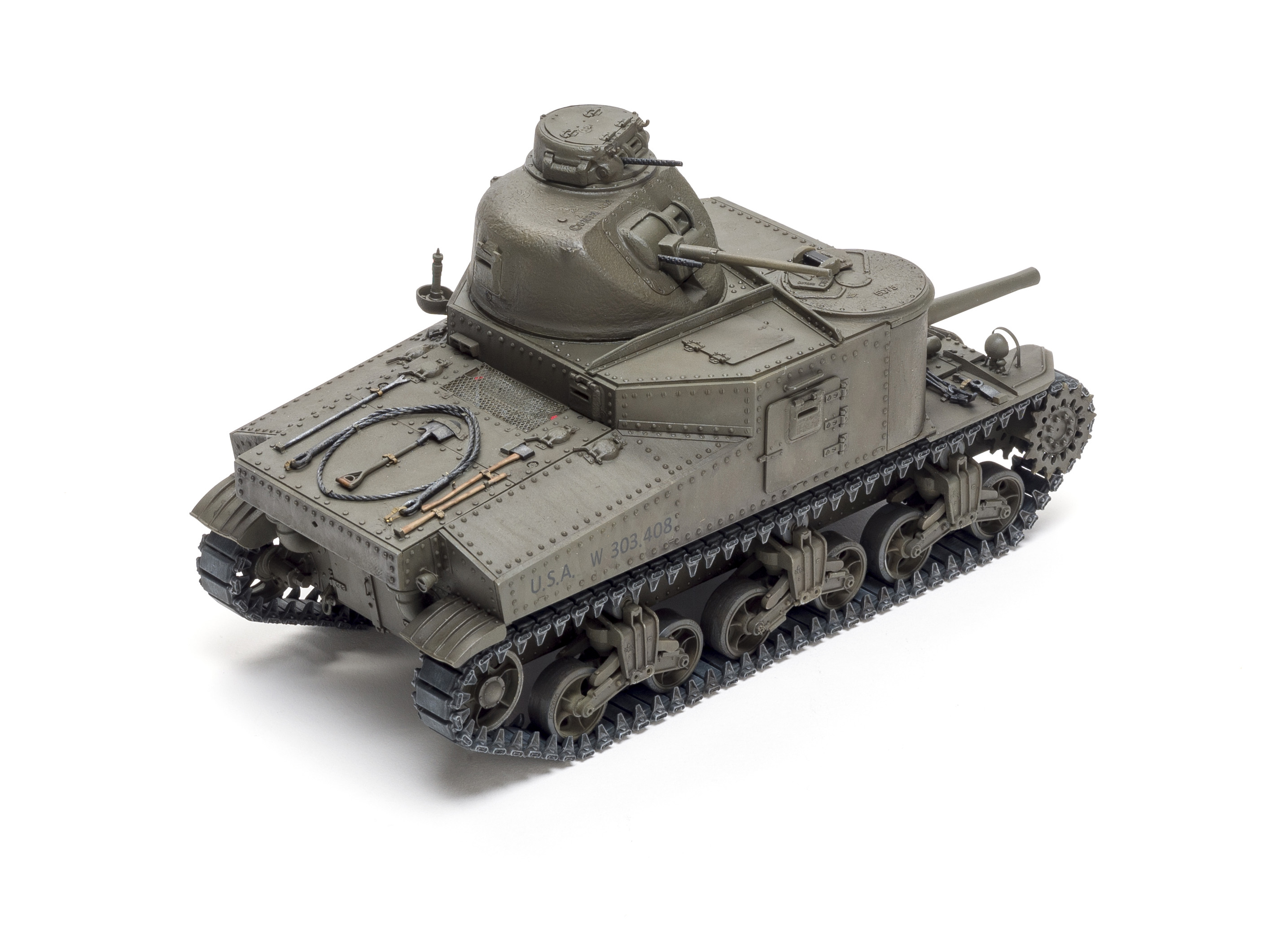

Adding tools to the engine deck proved a challenge. I finally gave up on the tiny PE tie-downs after a couple broke and one disappeared right in front of my eyes. Rather than providing anything for the tow cable, the kit has instructions to scratchbuild one; I used a piece of nylon tow cable from my spares box.

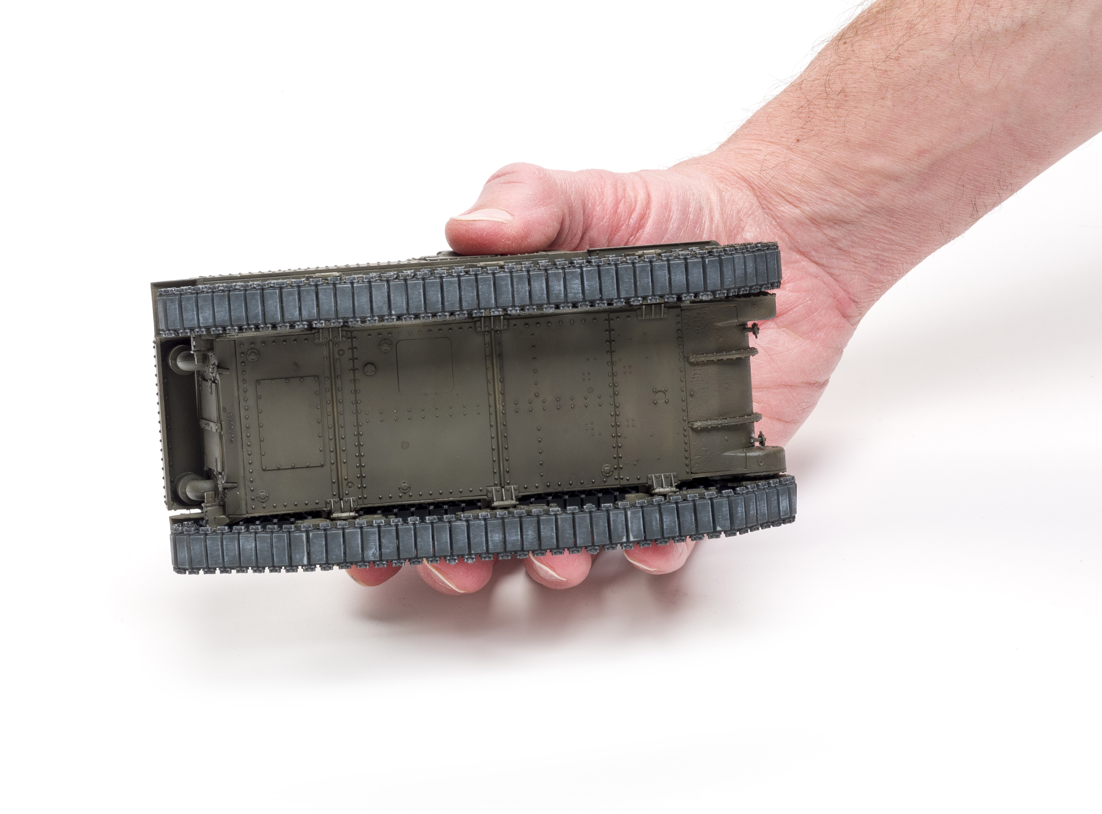

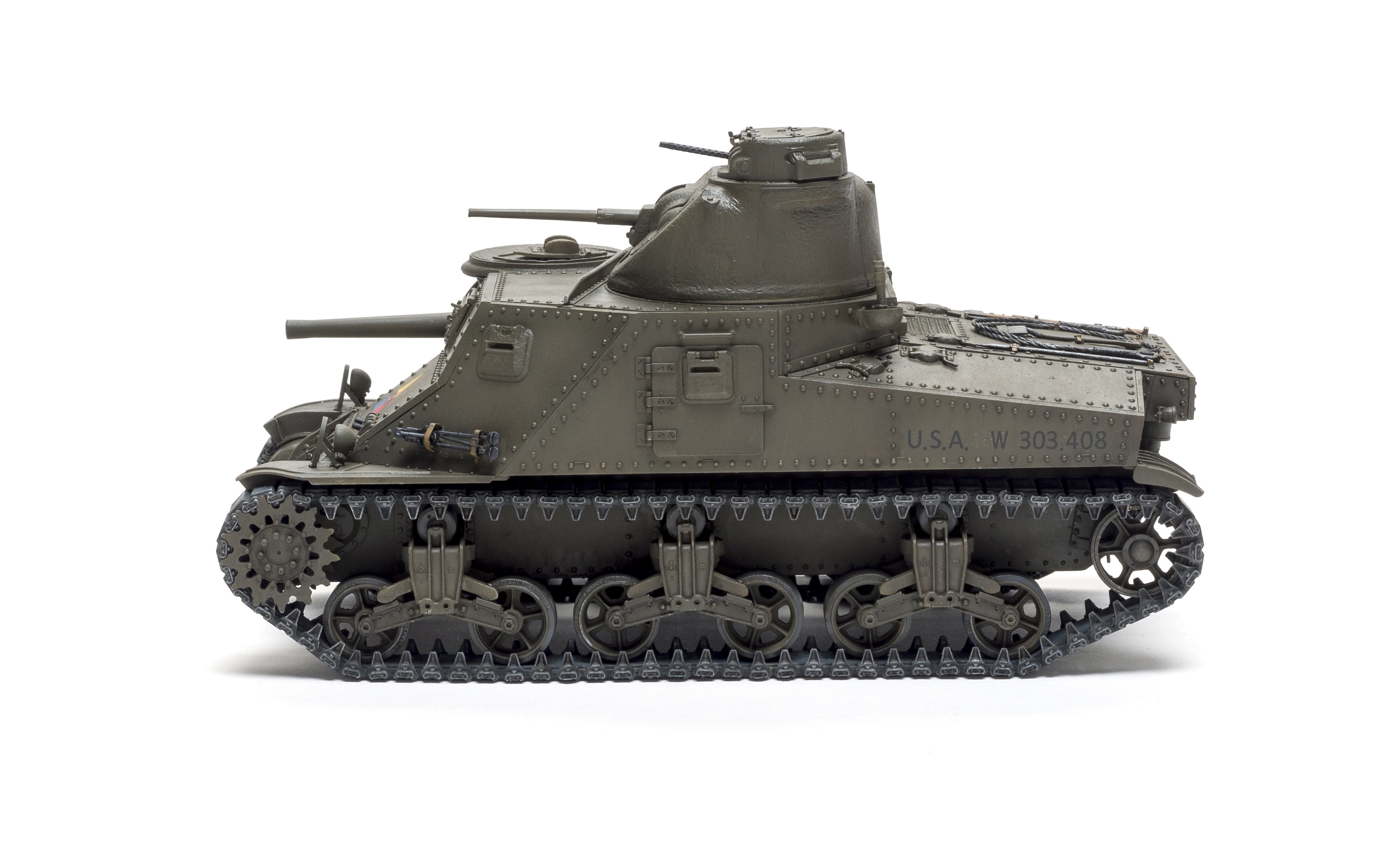

I had some issues building the bogies. The pins holding the wheel assemblies to the bogies are not secure so the wheels can easily fall off. I suggest gluing them in place after everything is aligned.
Once I built a small jig to hold the end connectors in place, the individual-link tracks went together quickly. I used 79 links for each run as indicated; by adjusting the idlers, a nice tight fit can be achieved.
The turret presented no issues, but you can’t see much of it even off the vehicle.

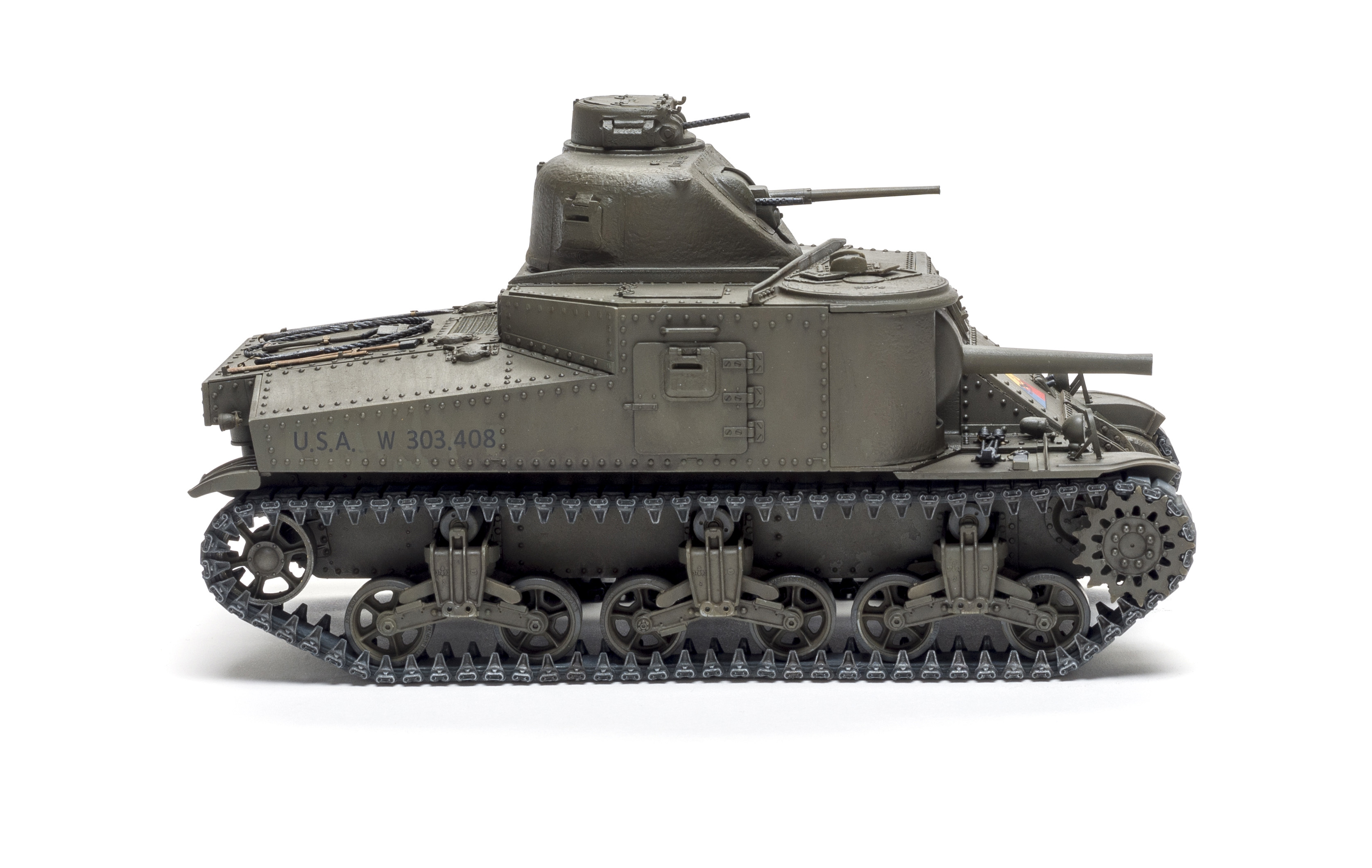

I painted my Lee with a mix of equal parts Tamiya olive drab and khaki drab with a little white. The decals went on beautifully using Microscale decal solutions
I spent 57 hours building my Lee and the model matched dimensions in David Doyle’s Standard Catalog of U.S. Military Vehicles (Krause, ISBN 978-0-87349-508-0). The quality of the molding and the parts fits especially impressed me. While not for novices, if you are up to the challenge, this kit will produce a Lee to make even Humphrey Bogart proud.
