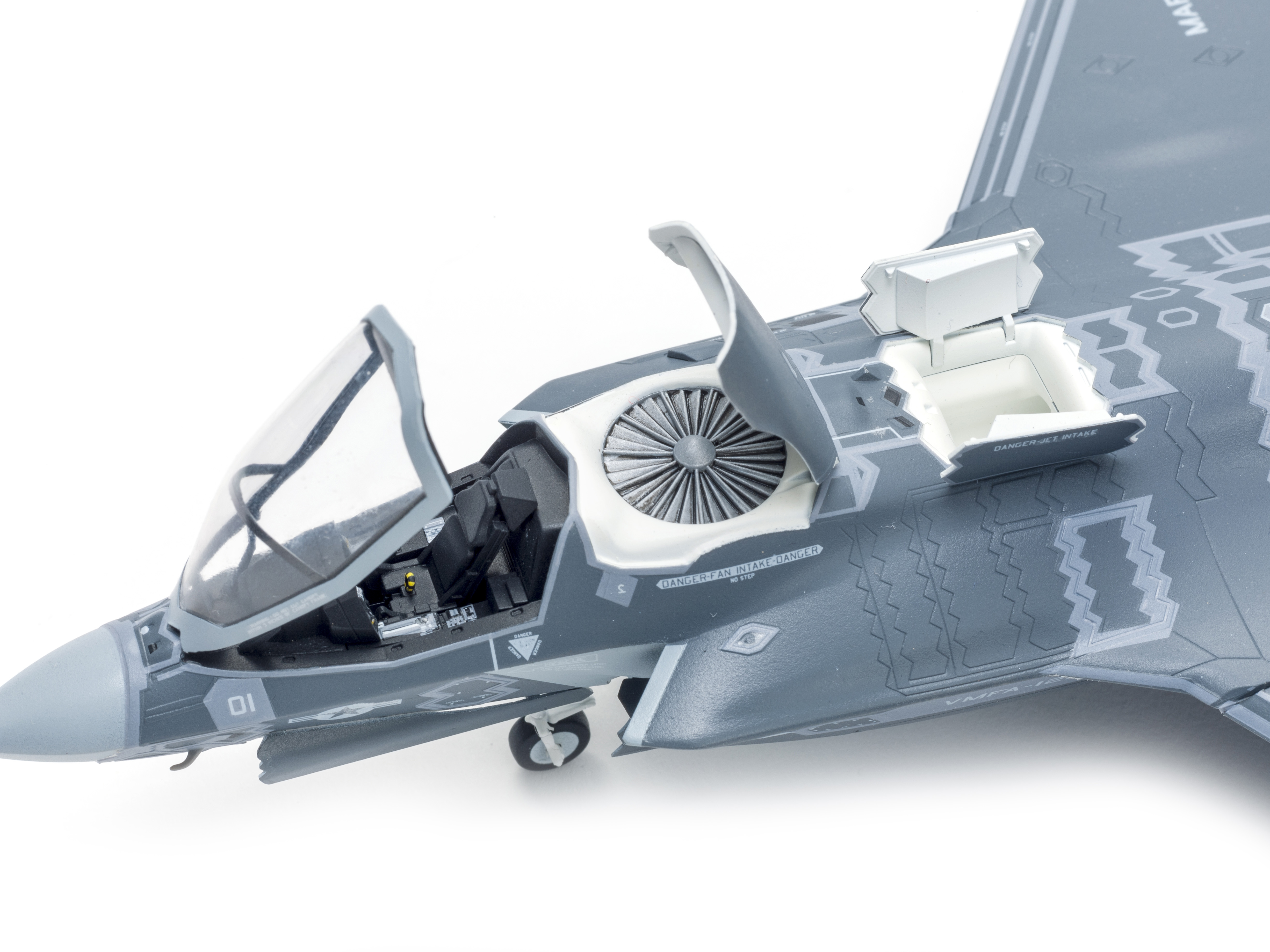

Landing and weapon bays with sharply molded details are sandwiched by the airframe halves. The upper lift fan is molded into the upper fuselage part, which complicates painting. The forward lift system’s lower exhaust fan is molded into a separate shroud and is also challenging to paint cleanly. However, there’s a driveshaft from the front of the engine to the fan gearbox as well as full intake trunks that look great with the fan and auxiliary intake doors open. Be mindful that the intake tunnels comprise multiple parts revealing unsightly seams when viewed from the front.
All gear, weapon, and lift fan doors are separate, but the kit provides optional closed-door parts that fit perfectly and are great for masking the bays if you plan to pose them open. Ejector-pin marks mar the inside of the nose gear doors.

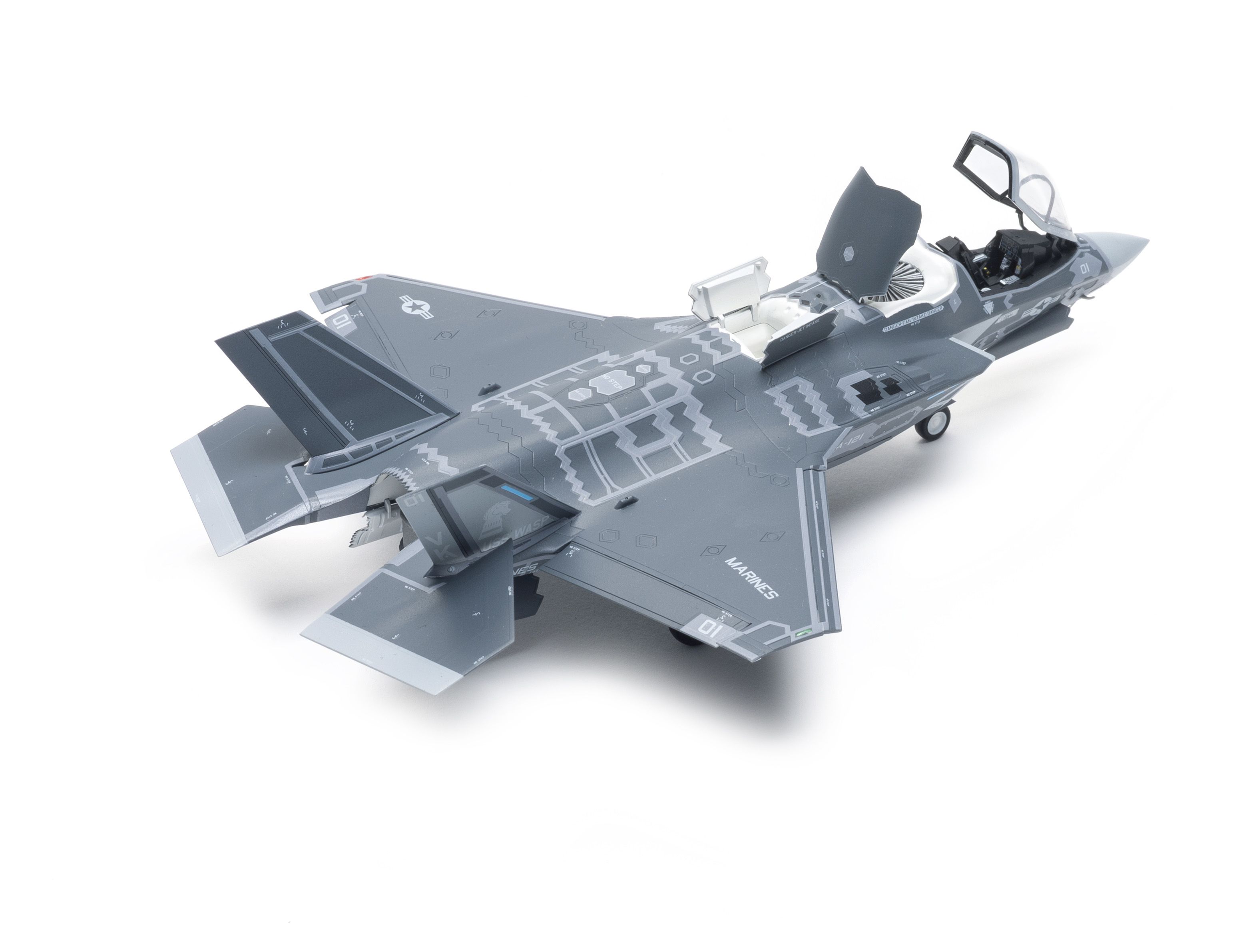

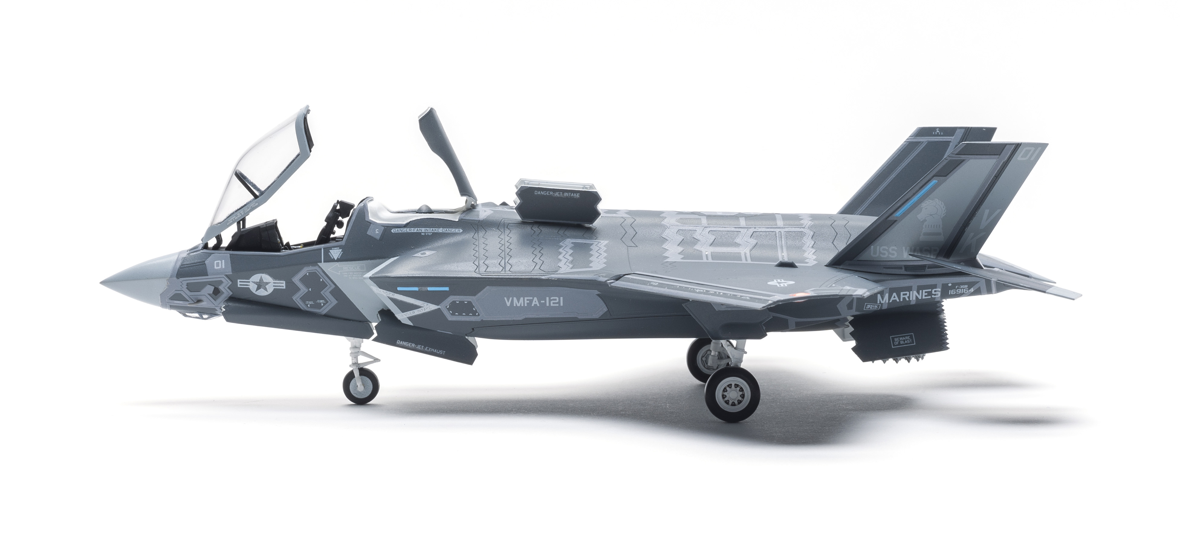

Other optional parts for the build options include drooped or stowed leading-edge flaps and flaperons, and neutral or drooped tailplanes. Everything fits great here, too.
Academy also provides the option for “beast mode,” with pylons and weapons. The underwing ordnance looks good on the part trees with plenty of fine detail; I chose not to use it.

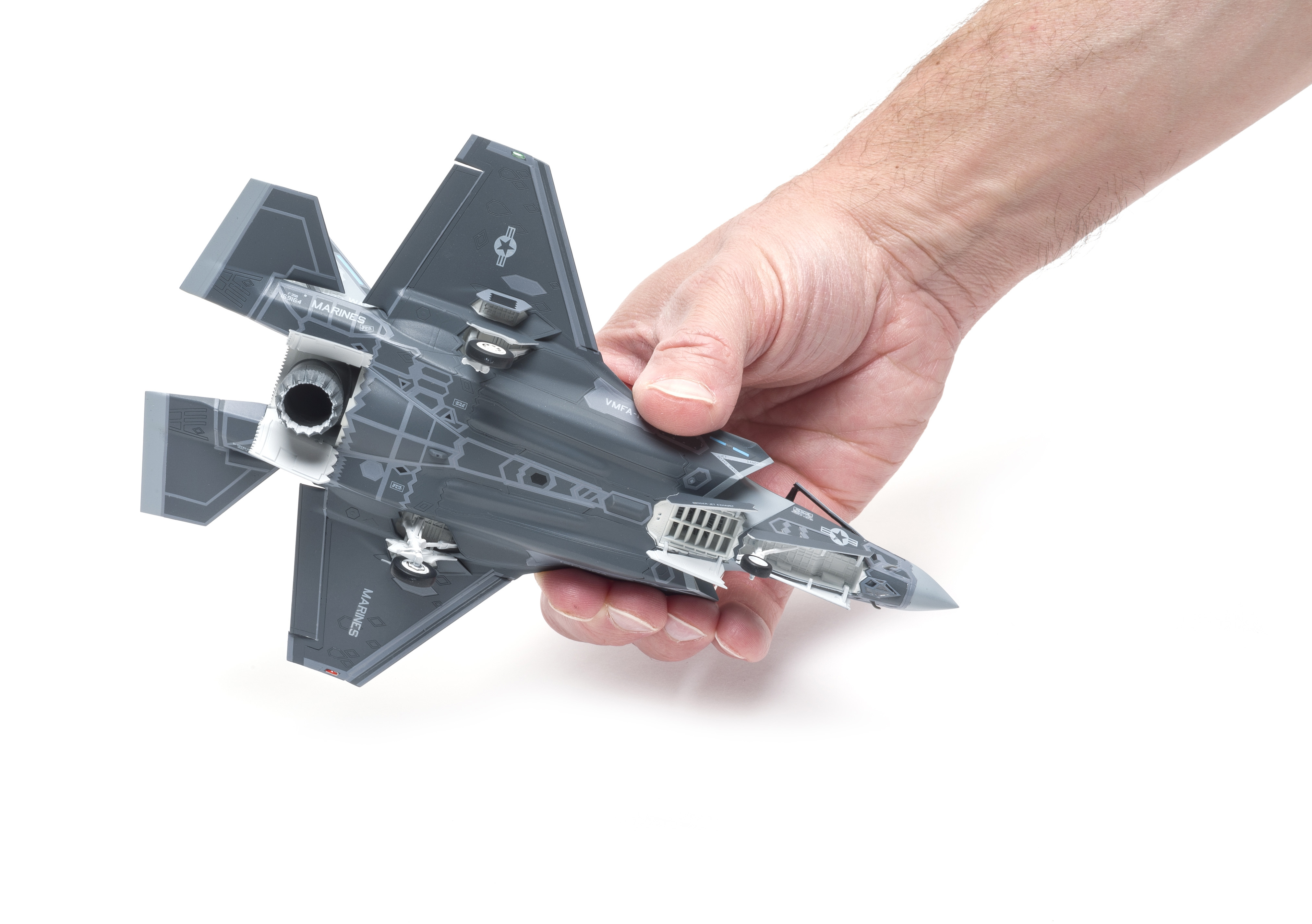

The model kit gets really hard to handle with all the doors open without adding more weapons. Thankfully, the hinges for all of the doors are sturdy.
