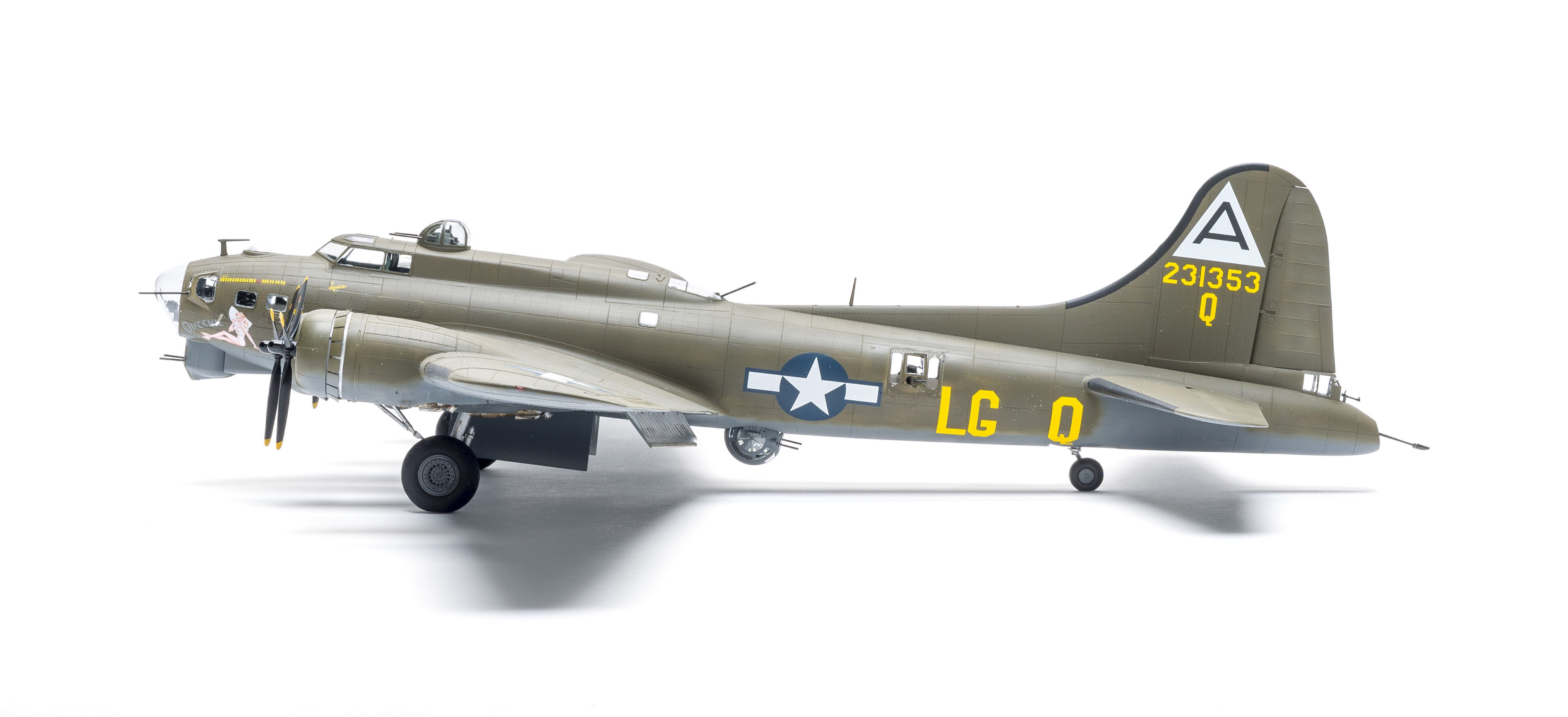

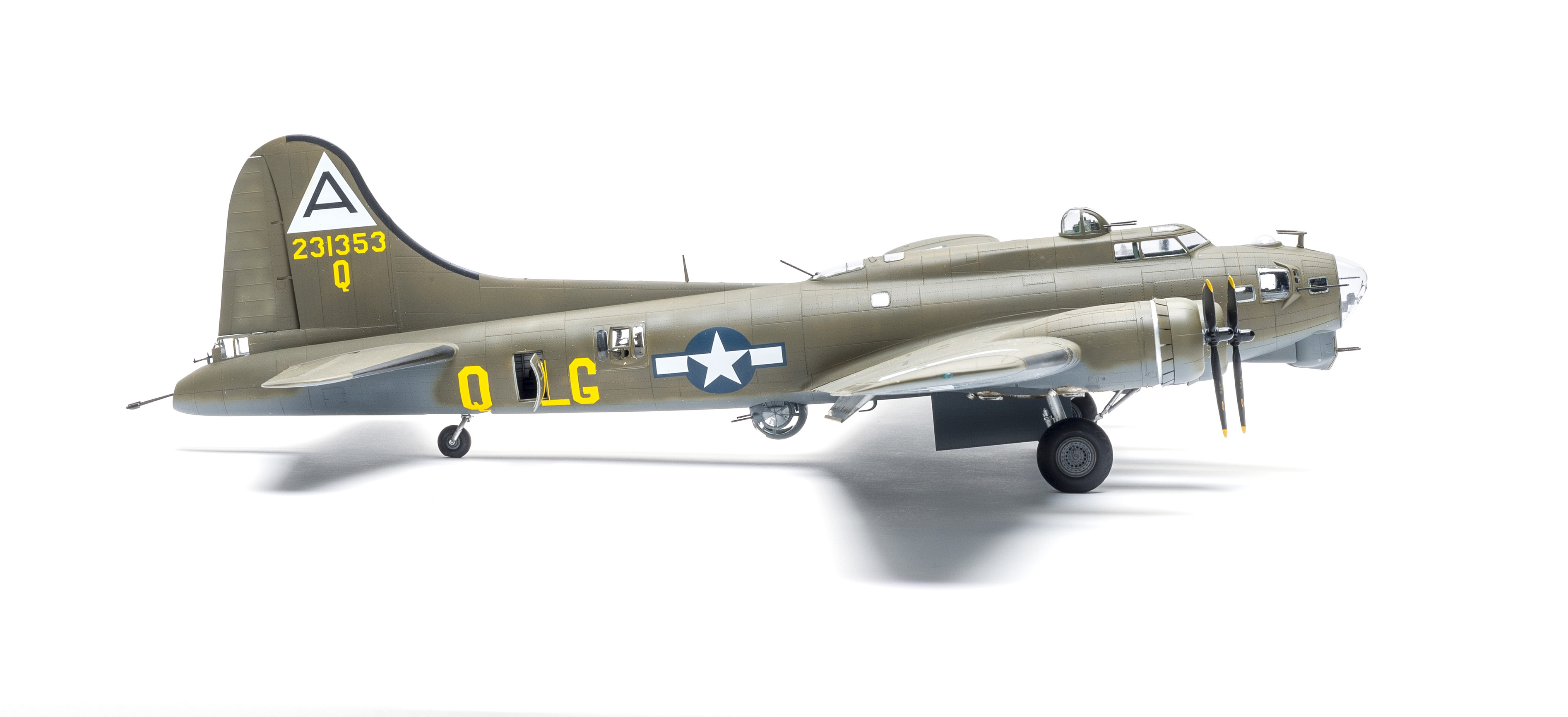

I painted my B-17 in subassemblies with Mr. Color lacquers, then I added the wings and horizontal stabilizers.
Fit the wings over the tabs on the fuselage and then slide them aft and they wedge into place. The mounting system is so tight that the wing roots didn’t need glue.
The fit of the horizontal stabilizers is perfect, although they have a slight dihedral when they should be flat.
The markings went down over a coat of Pledge Floor Gloss without problems, quite impressive for such large decals. Check references for the markings on the props; I followed the instructions, but I think the stencils and logos should be closer to the hubs.
The kit provides the option of either raised or lowered landing gear. An image of exactly where the drag-links mount inside the wells would have been helpful.
Then it was time for final assembly adding the antennas, gun barrels, waist and radio room windows, exhausts, and the engines as described earlier.
The finished model is impressive with a wingspan over 26 inches and is worthy of the title Flying Fortress. I couldn’t help but compare my experience with the HK kit to my rosy memories of building the Monogram B-17 40 years earlier. I wondered if the recessed panel lines were worth the price tag ($140 vs. $40). That was until I added the wings.
The superior fit of the subassemblies and the quality of the decals are worth every cent.
