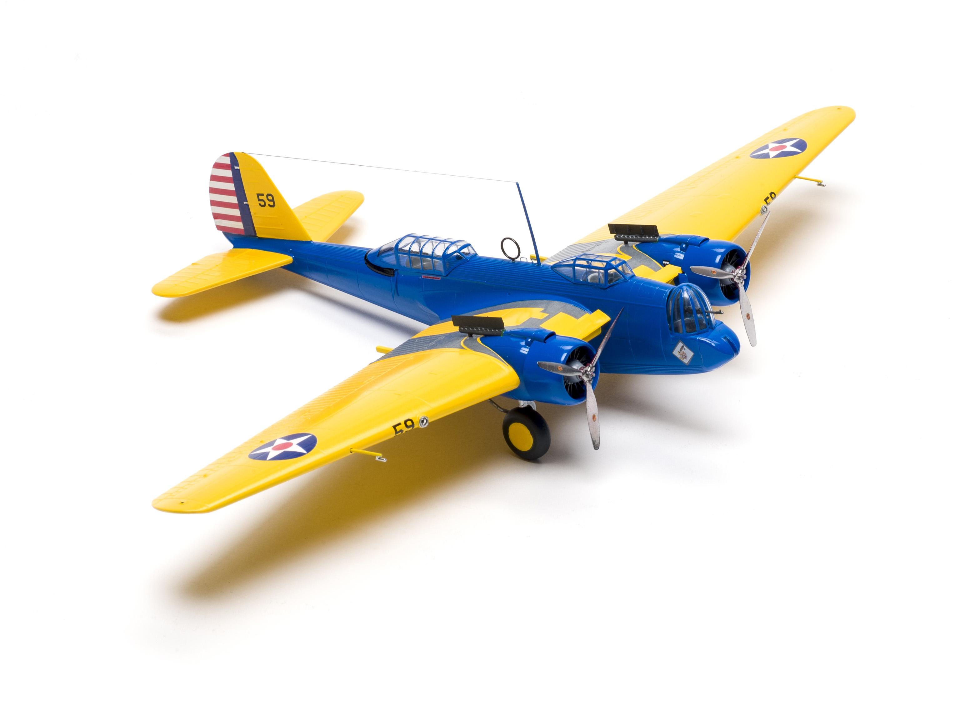

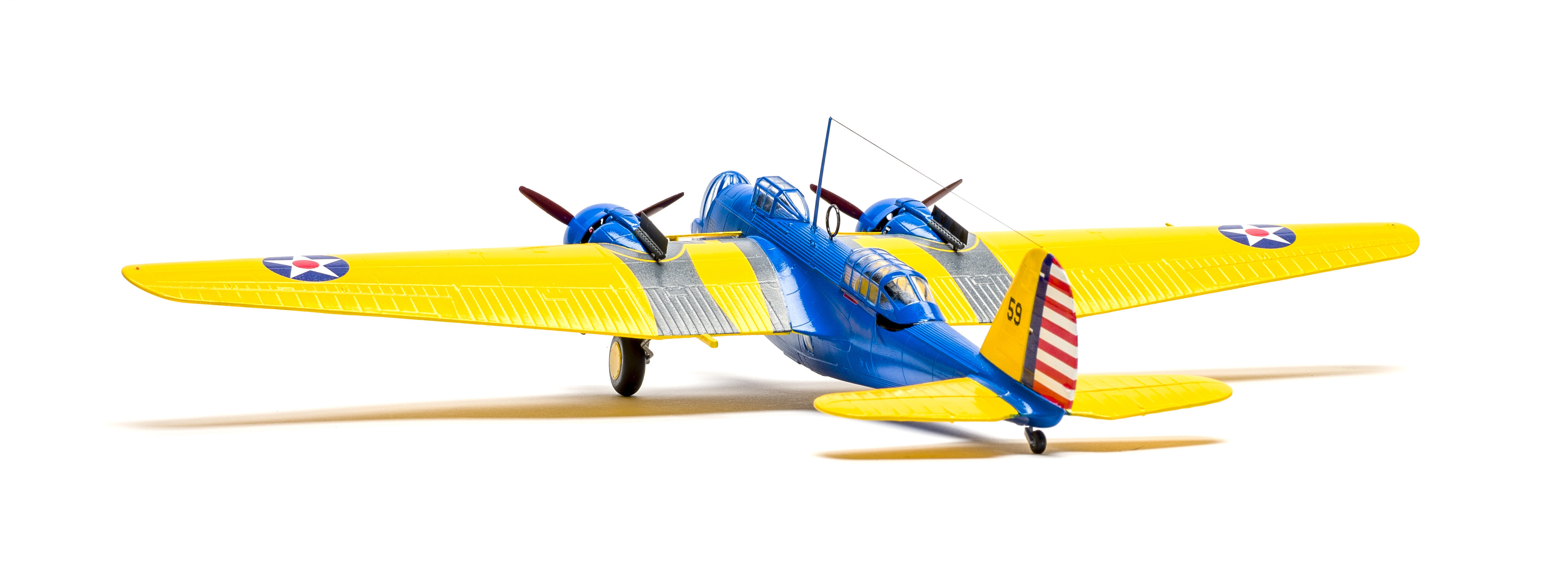

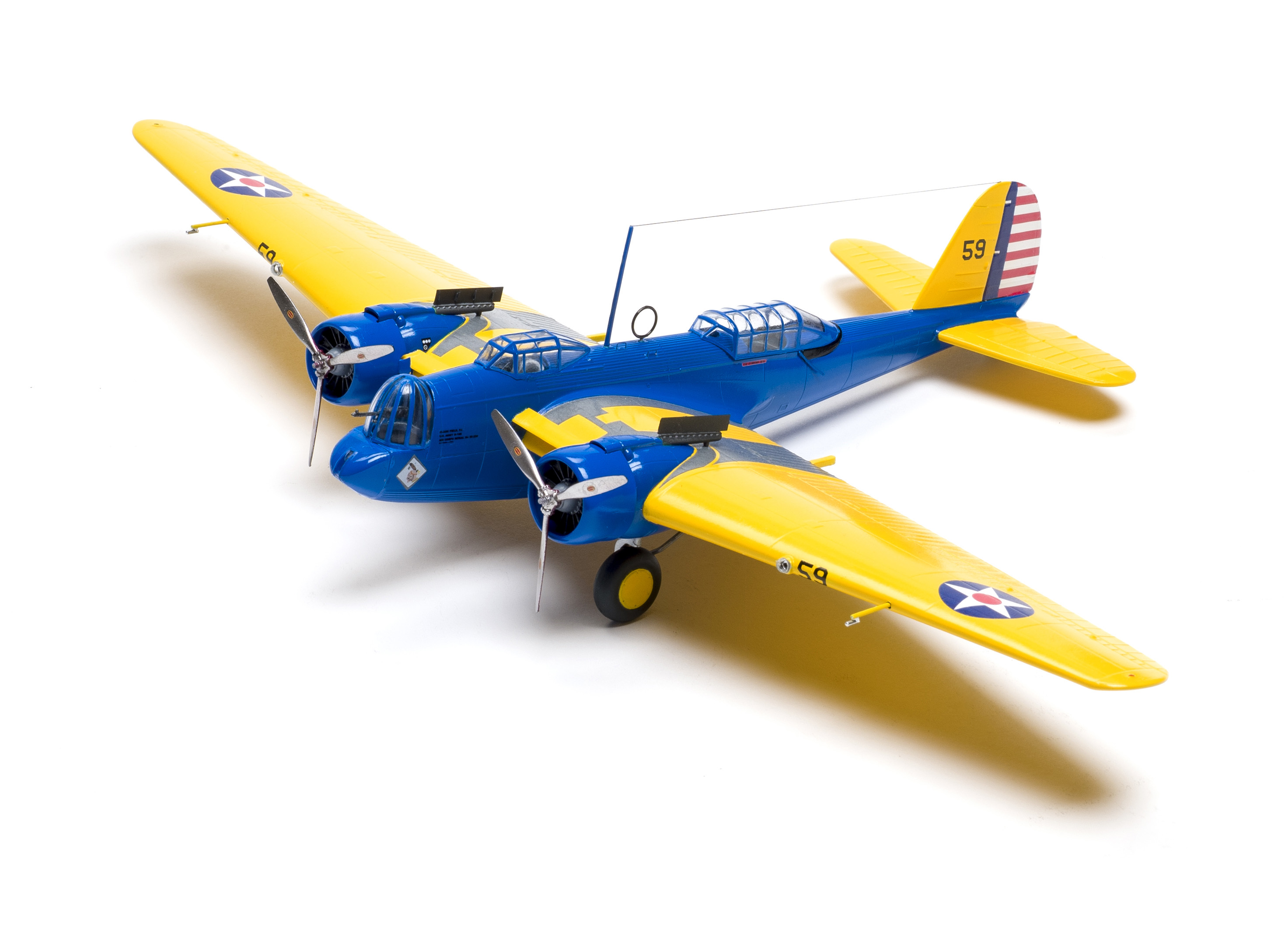

Building the kit was routine until it came time to place the wings on the fuselage. The kit provides a central spar that is enclosed in the fuselage, and the ends of the spars are designed to slide into slots inside the upper and lower wing halves. Flanges at the wings’ roots are designed to fit inside the fuselage, but if the spar is cemented firmly into the fuselage, it doesn’t allow the fuselage to flex enough to get the wing flanges in. I ended up chipping plastic away from the spar where it was glued to the upper fuselage to provide more room for the flanges to move.
I’m not sure if they are flash hiders or cooling vanes, but a PE panel attaches to the top of each of the two plastic exhaust pipes. Four tiny PE supports are supposed to be added to each panel. Each support measures 1 x 2.5mm and is almost impossible to handle even with the finest tweezers. I managed but I wonder how!
I painted my B-10 with Mr. Color lacquers. I lightened bright blue (C65) with white to match the Air Corps blue fuselage and cowls, and used yellow (C329) for the flying surfaces.
The colors on the kit decals are not as saturated as they should be, and the decals themselves are thin and rubbery. Be careful handling them as they can get snarled up if you move them too much. I recommend applying a coat of Microscale Liquid Decal film to each item before use.
I spent 22 hours on the little B-10 – a little more than usual trying to improve the fit of the wings. It’s not a kit for beginners due to the hard-to-handle PE, but it turns into a handsome aircraft, especially in its mid-1930s livery of blue and gold.
