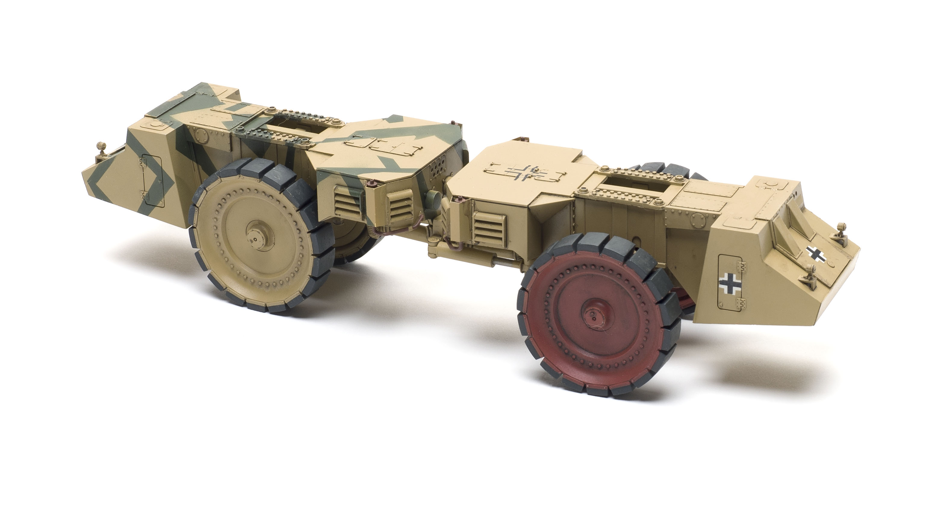

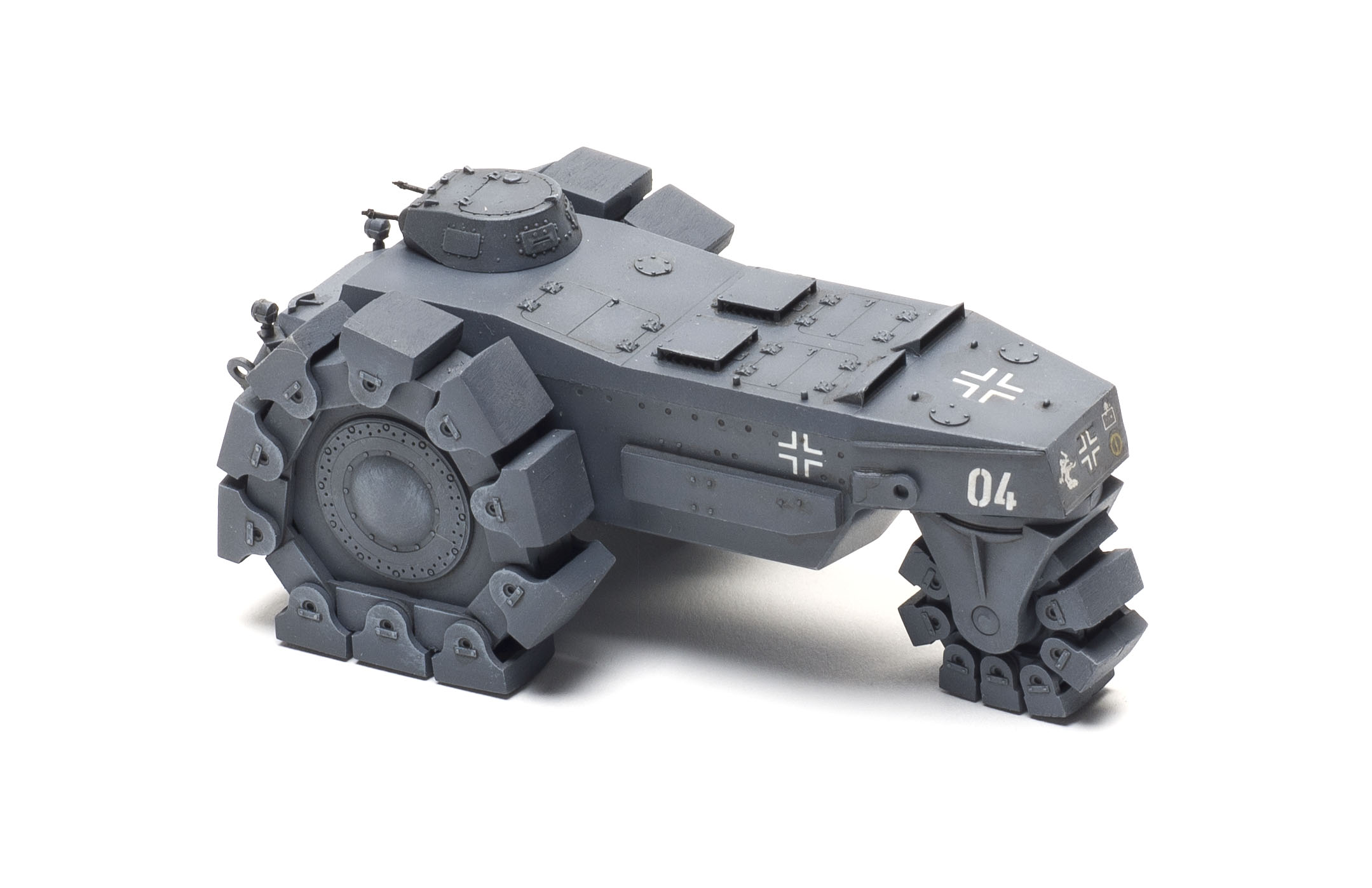

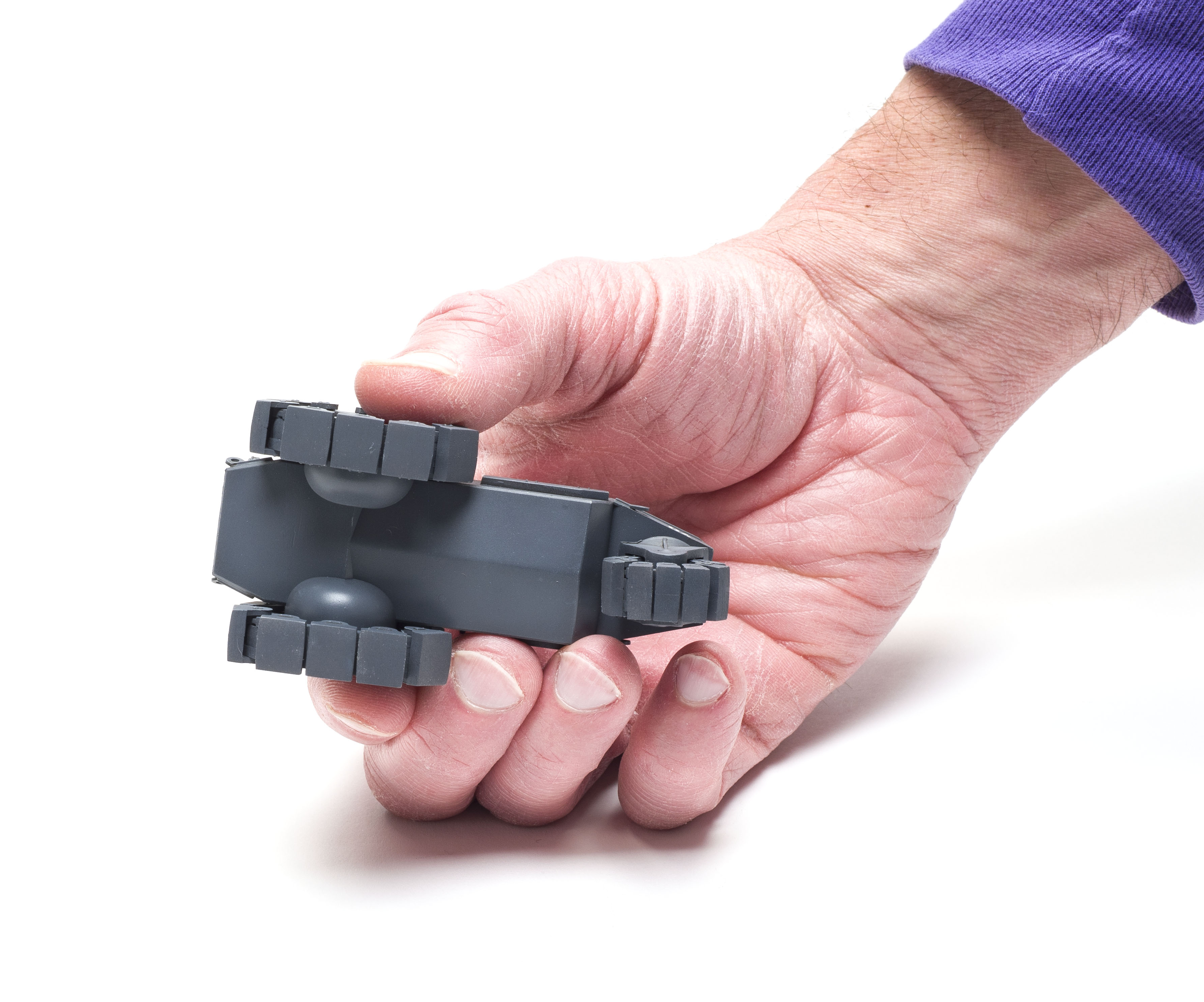

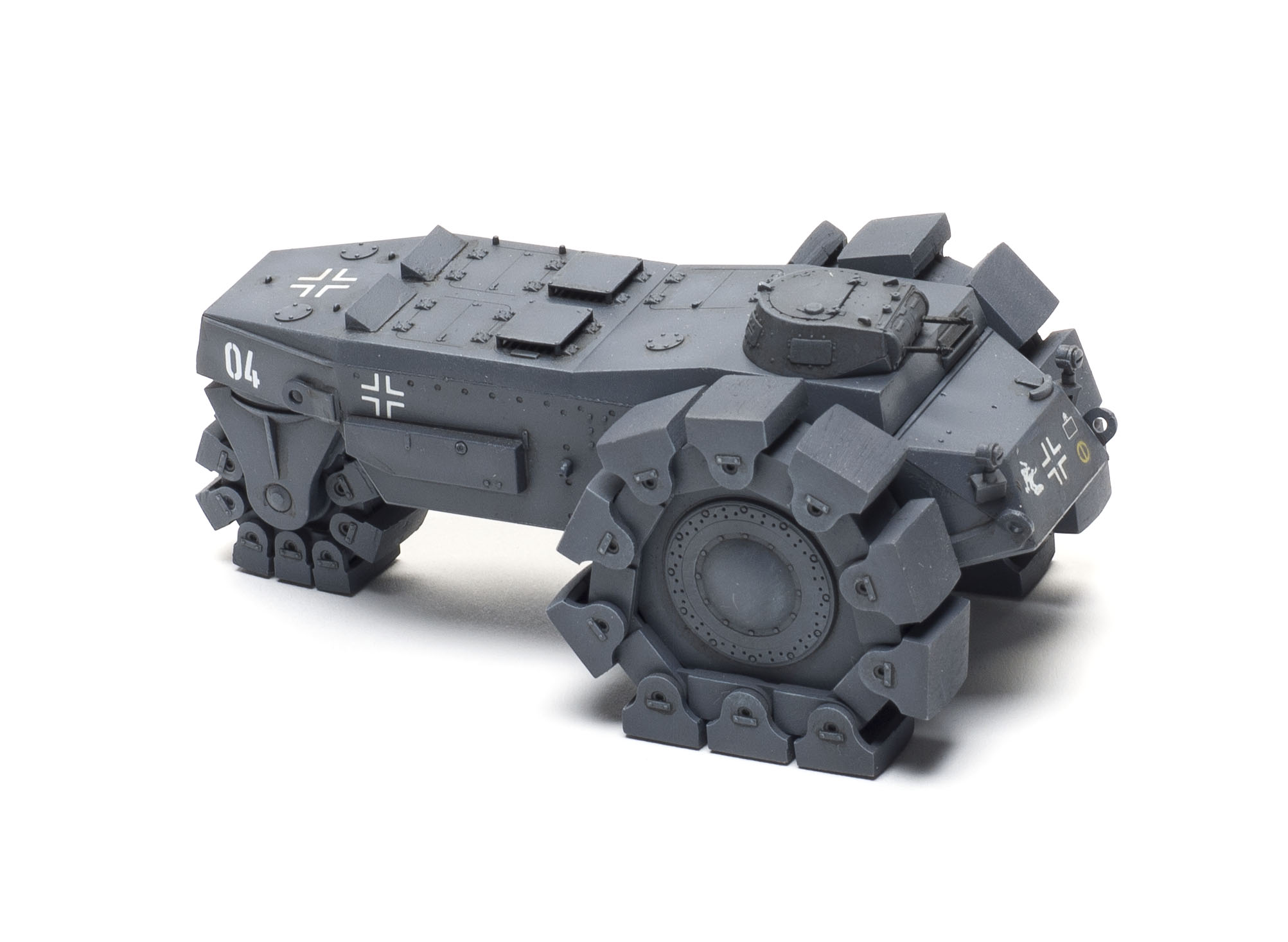

The VsKfz 617 wheels fit together fine, but the seams between the pad halves needed cleanup. I eliminated most of them with sanding, but a few required filling.
The body went together quickly with excellent fits that required no filler. I had no trouble shaping the PE vents and they fit well. I left the body and the wheels separate until I was finished painting.

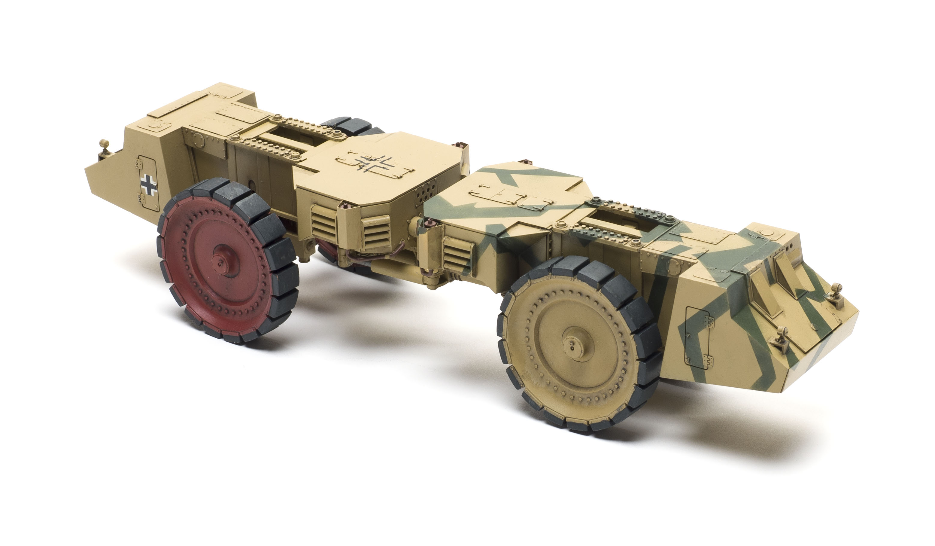

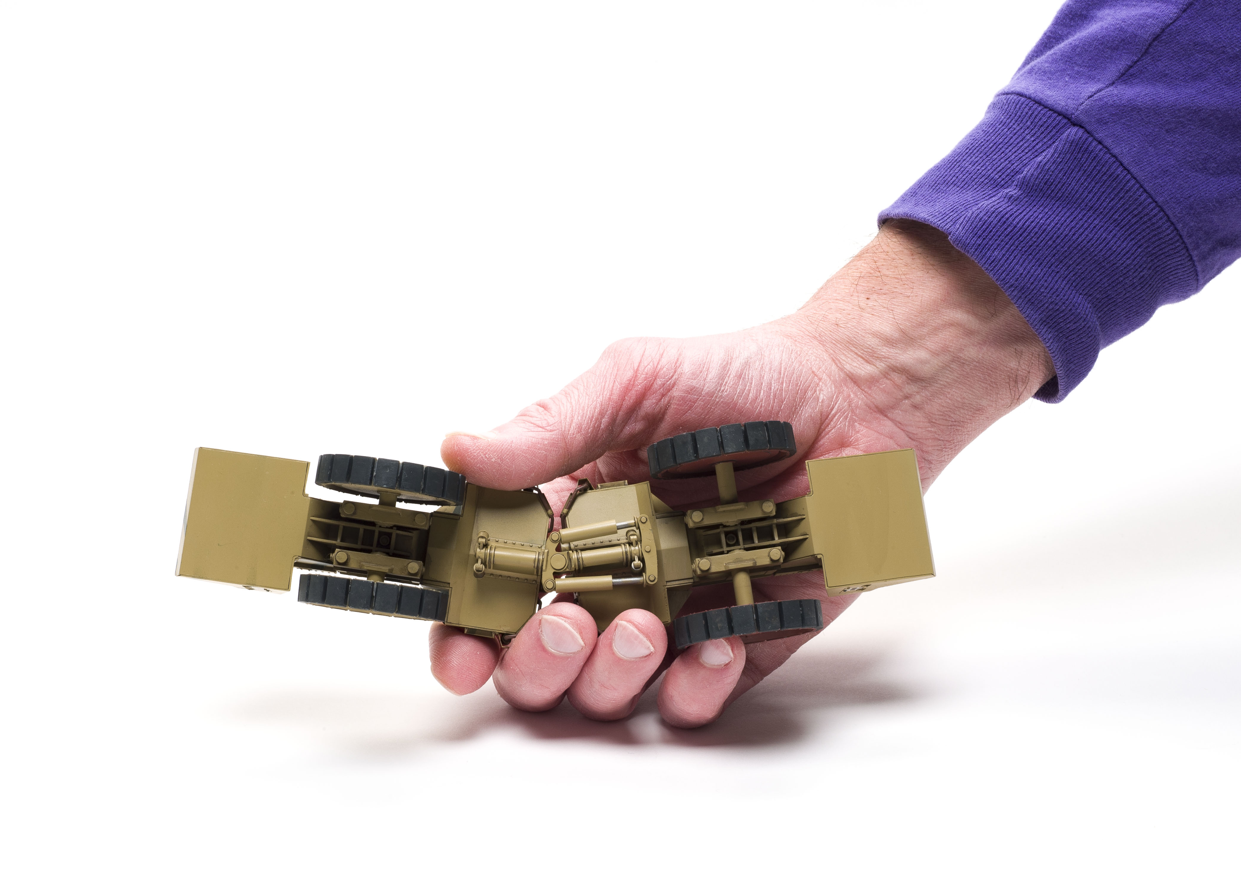

The Krupp Raumer was also an easy build. The parts fit well and no filler was needed. While building the bodies, I left the upper mid-plate (Part B4) loose to ensure the interior cavity was fully painted.
Cleaning up the exhausts required a delicate touch. I had no trouble bending the shields and they fit perfectly. I diverged from the instructions and added the axle parts (parts B2 and B3) to the bodies rather than the wheels. The wheels and interconnecting linkage were left off for painting.

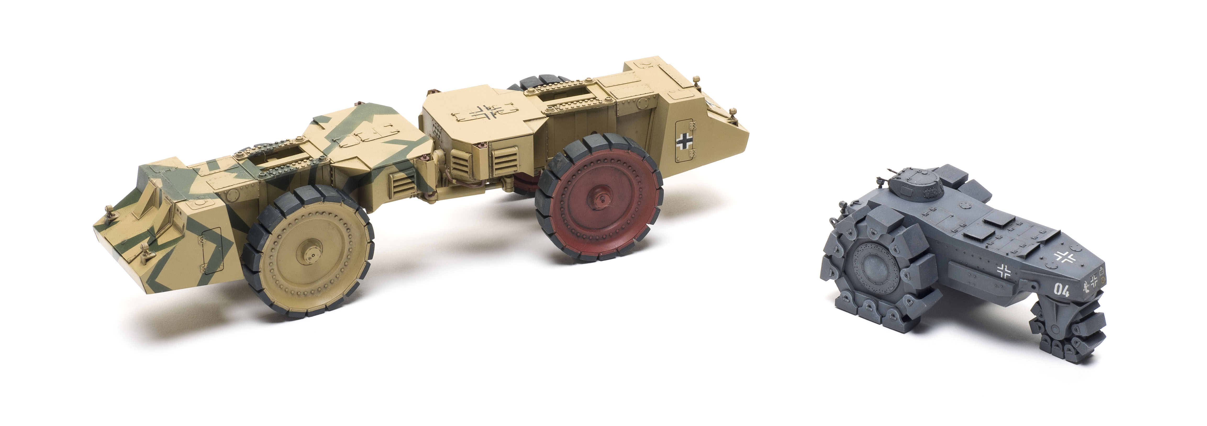

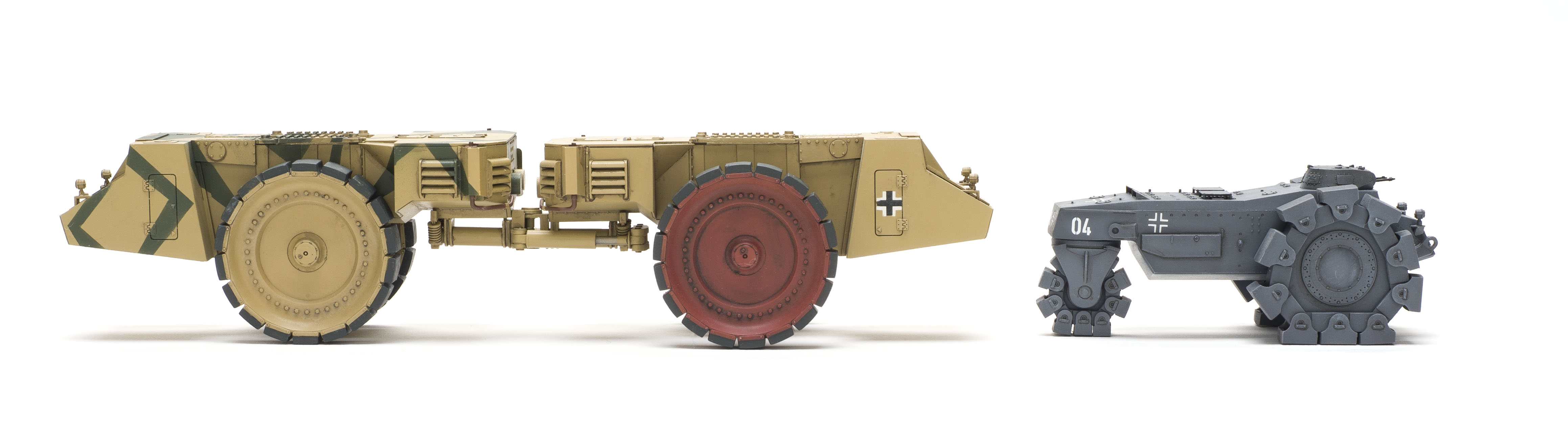

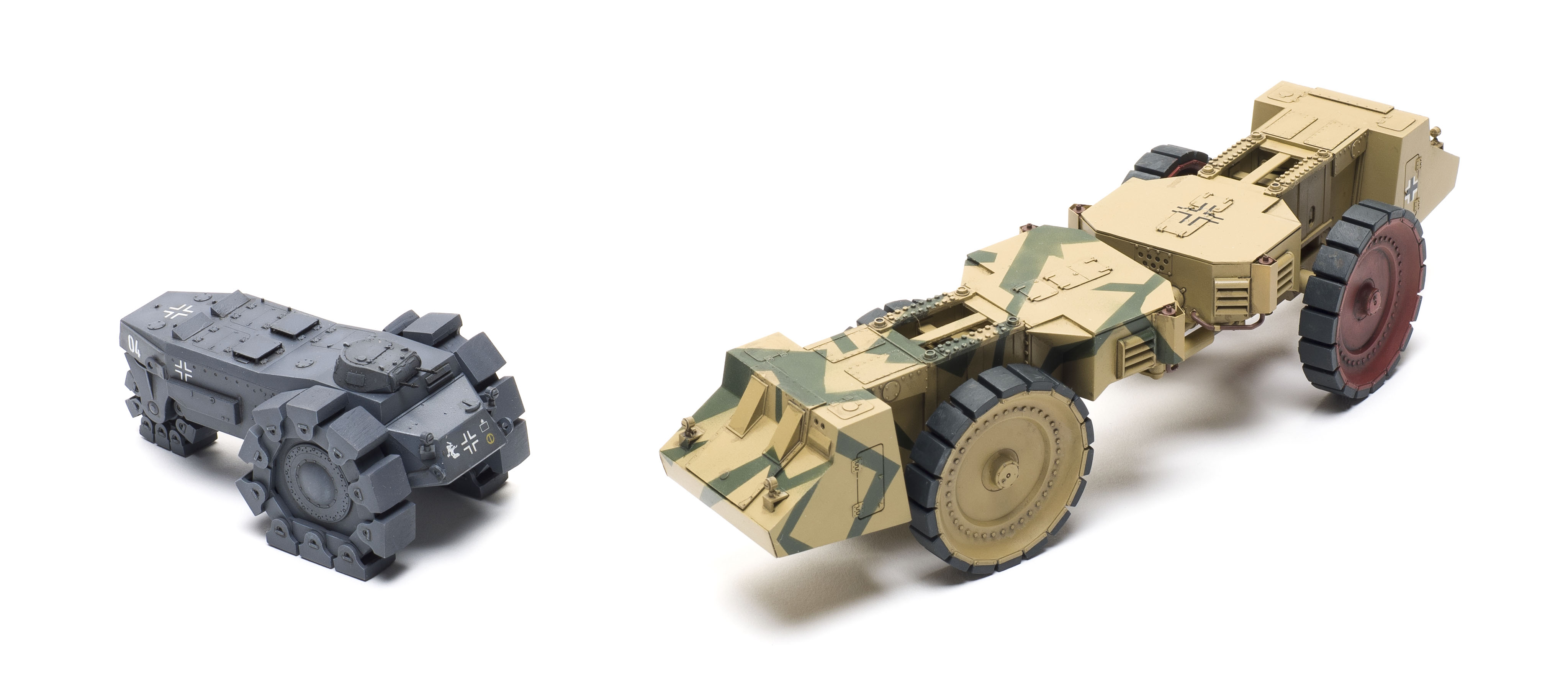

I painted the VsKfz 617 overall with Tamiya German gray (No. XF-63) lightened with a little white for fading and post-shading.
To base coat the Krupp Raumer, I mixed equal parts Tamiya dark yellow (No. XF-60) and deck wood tan (No. XF-78). The splinter camo was applied with NATO Green (No.XF-67). For the red primer wheels, I used Hataka red primer base (No. C175) and painted the tires with NATO black (No. XF-69).
The decals responded perfectly to Microscale Micro Set and Micro Sol over a layer of Tamiya gloss (No. X-22). I’ve never seen a German vehicle with the unit markings on the turret hatch, so I left that off the VsKfz 617. After washes and a layer of clear flat, final assembly went quickly.
