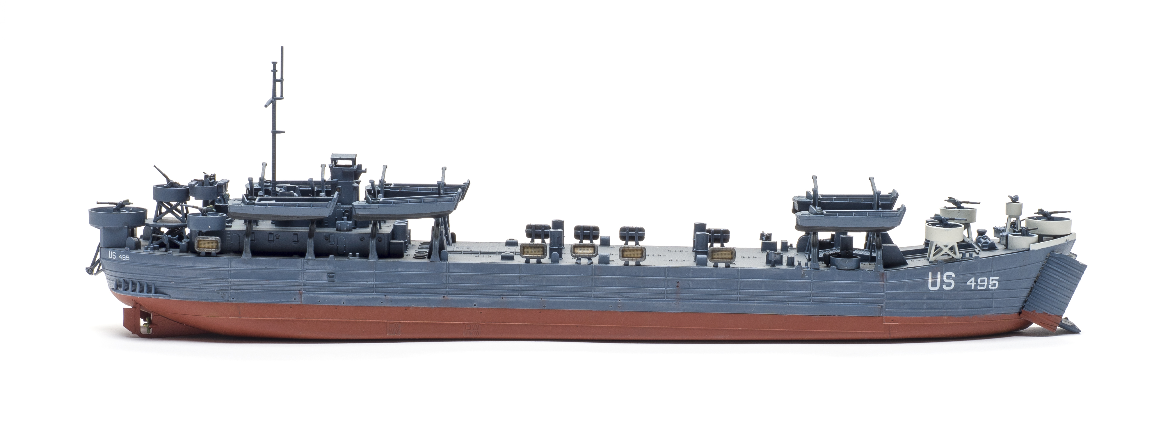

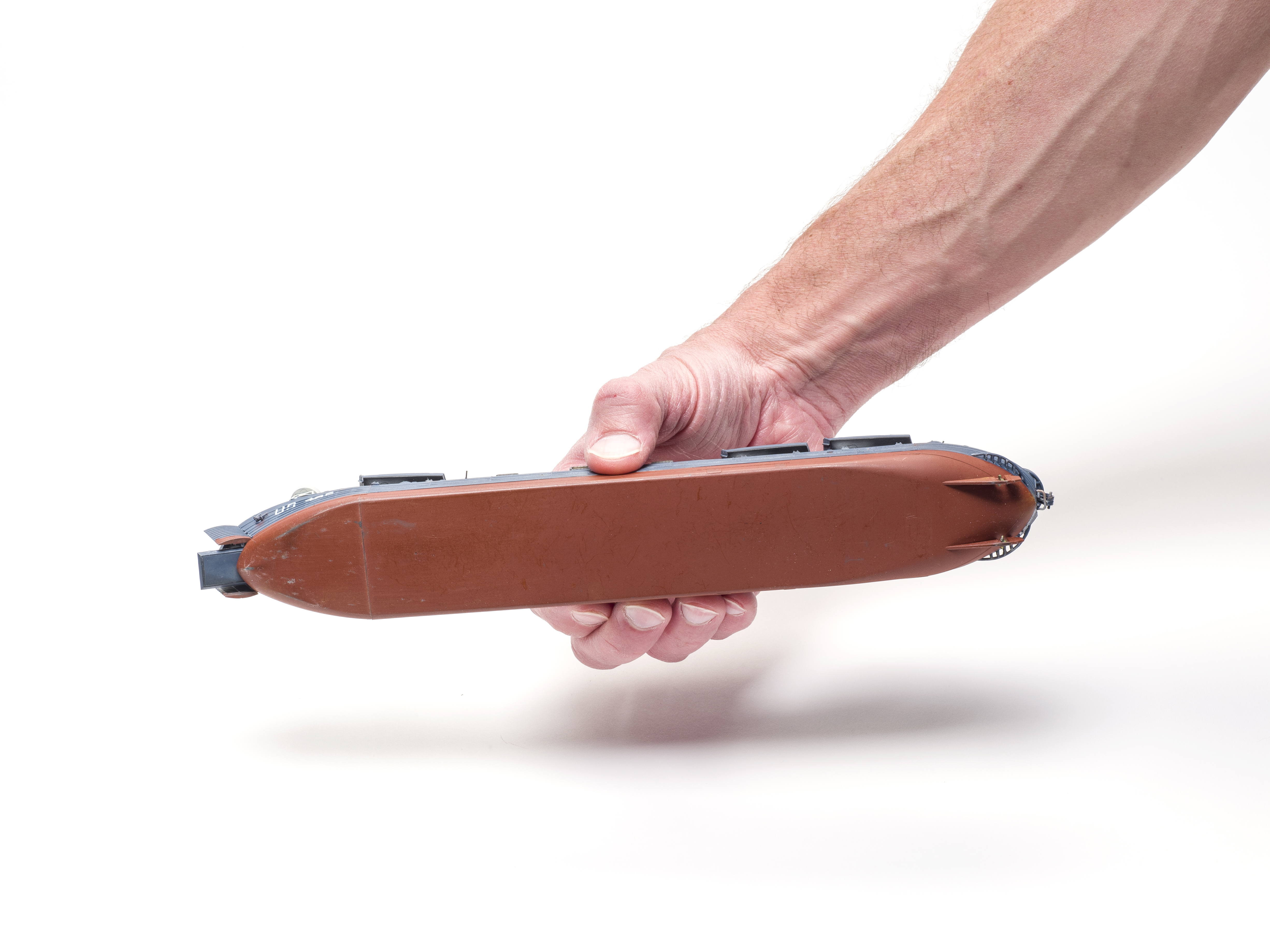

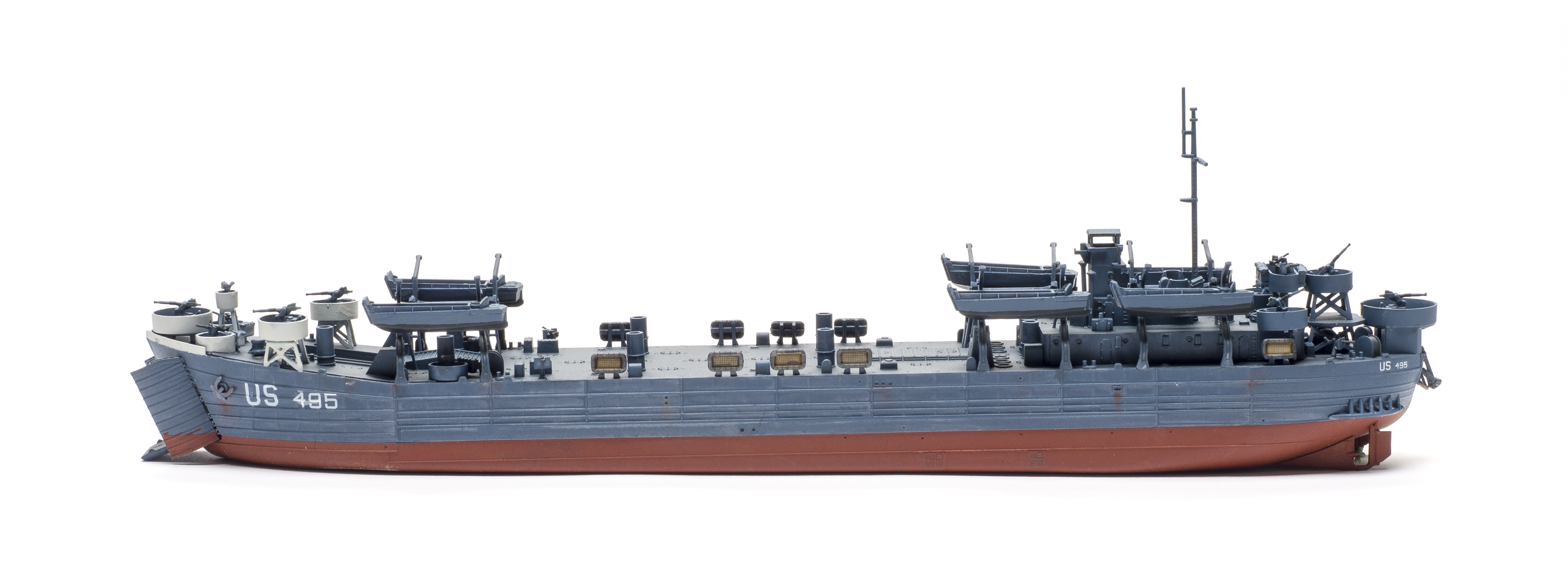

To paint, I used Model Master Metalizer steel as an under layer at the bow, salted it, and overpainted with iron oxide (it is a “sandscraper” after all). Horizontal surfaces were hand painted Model Master weather deck blue softened with PanPastel neutral gray-dark while vertical surfaces were painted Model Master navy blue. The bow gun tubs are USN light gray, and the props and 40mm ammo trays were painted gold, muted to bronze with a wash of medium green.
Overall, this is a great kit with plenty of historical options as well since AFV Club vehicle sets are available for both the WWII-era and the Korean War. Add to that the photo-etched metal set available from AFV Club and it can be as detailed as you wish but builds as-is into a very interesting and accurate subject.
