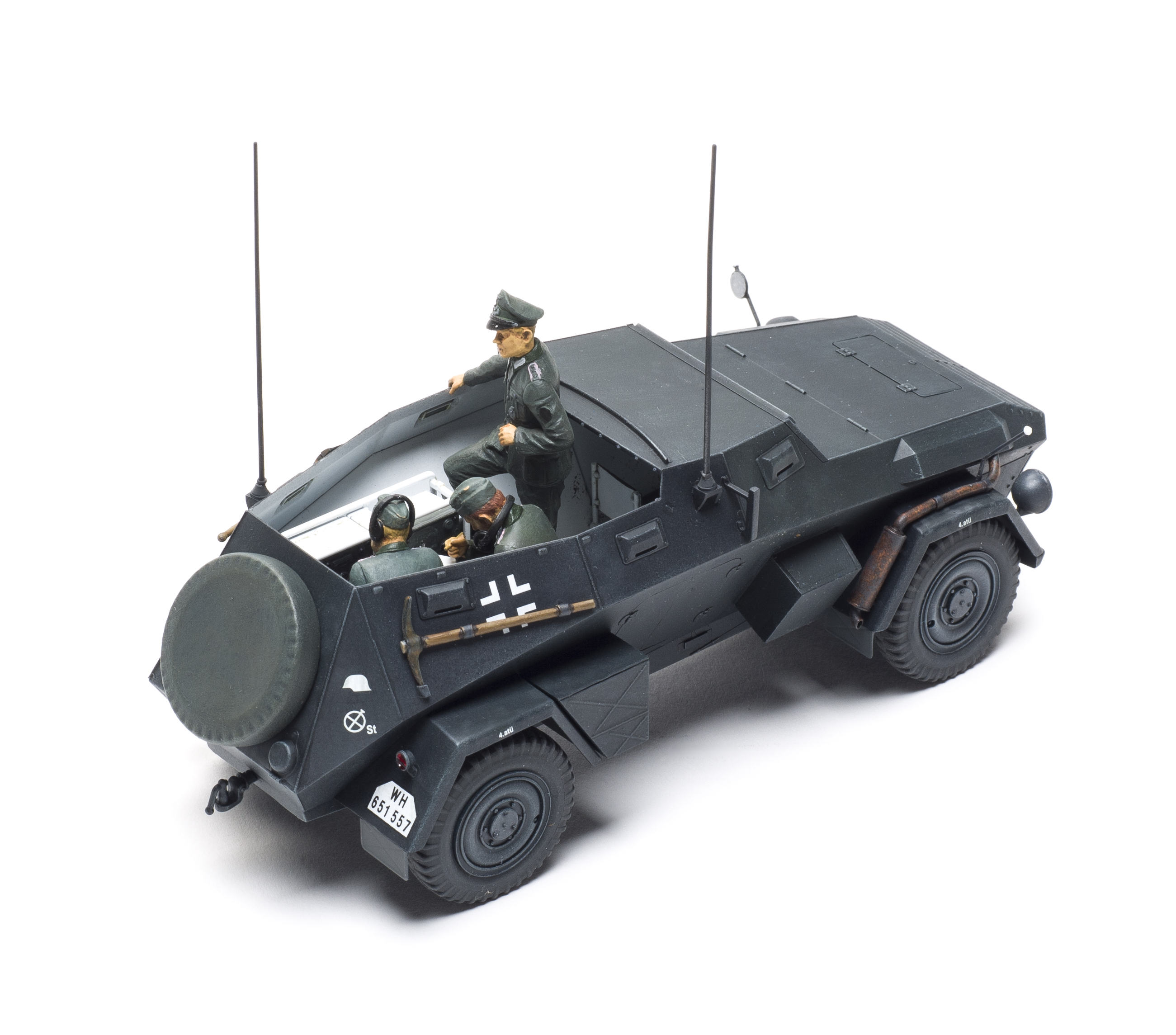

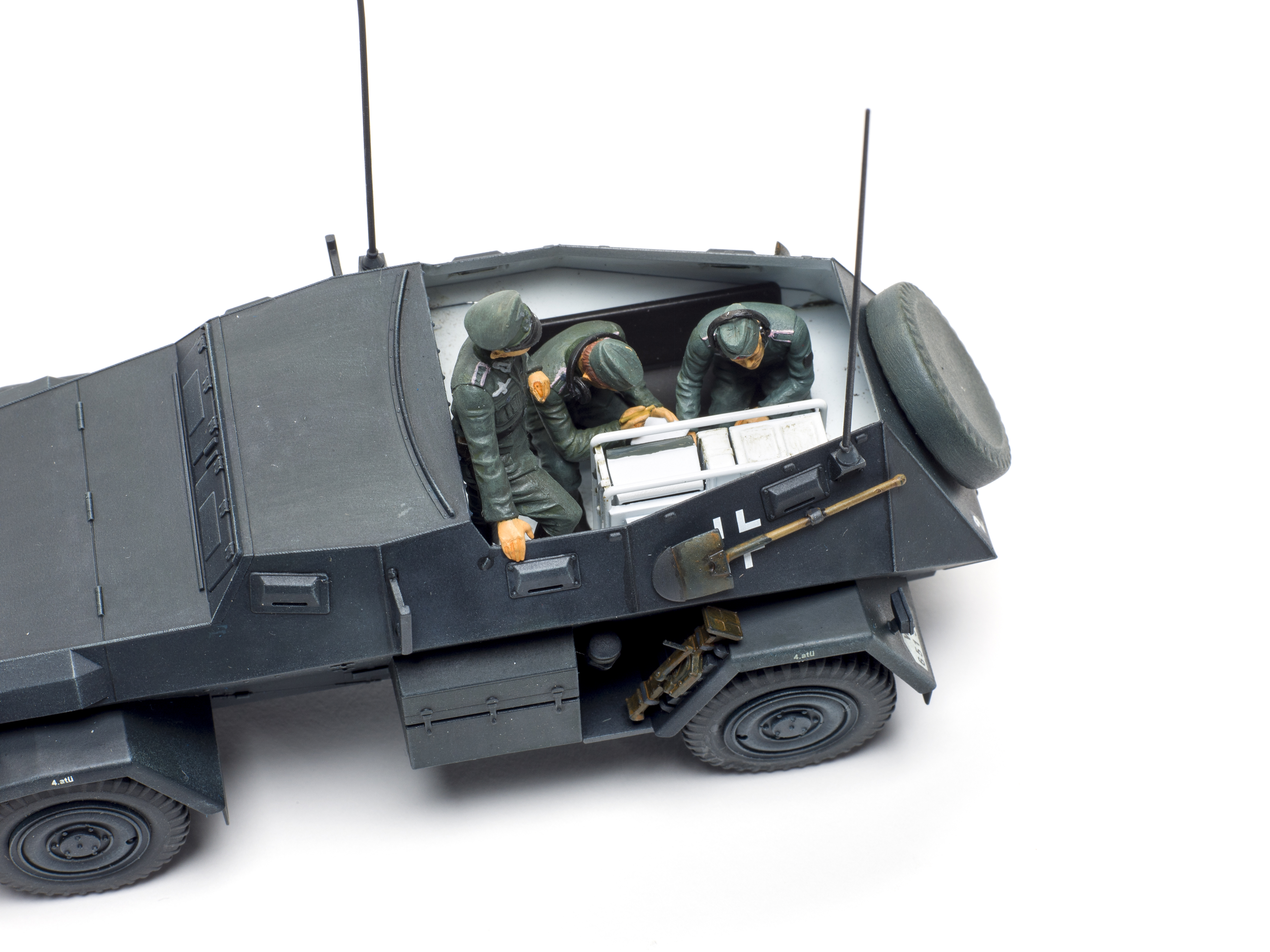

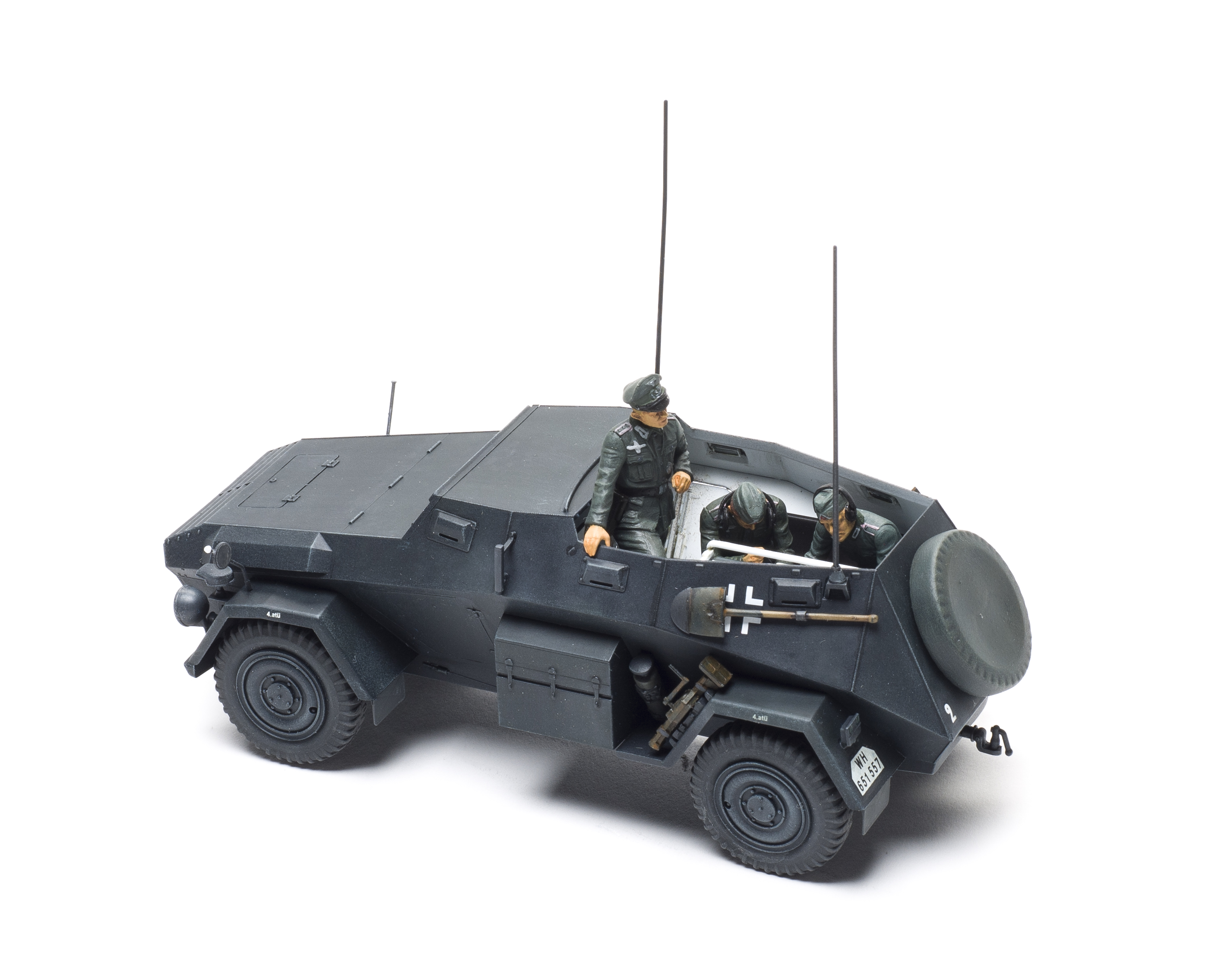

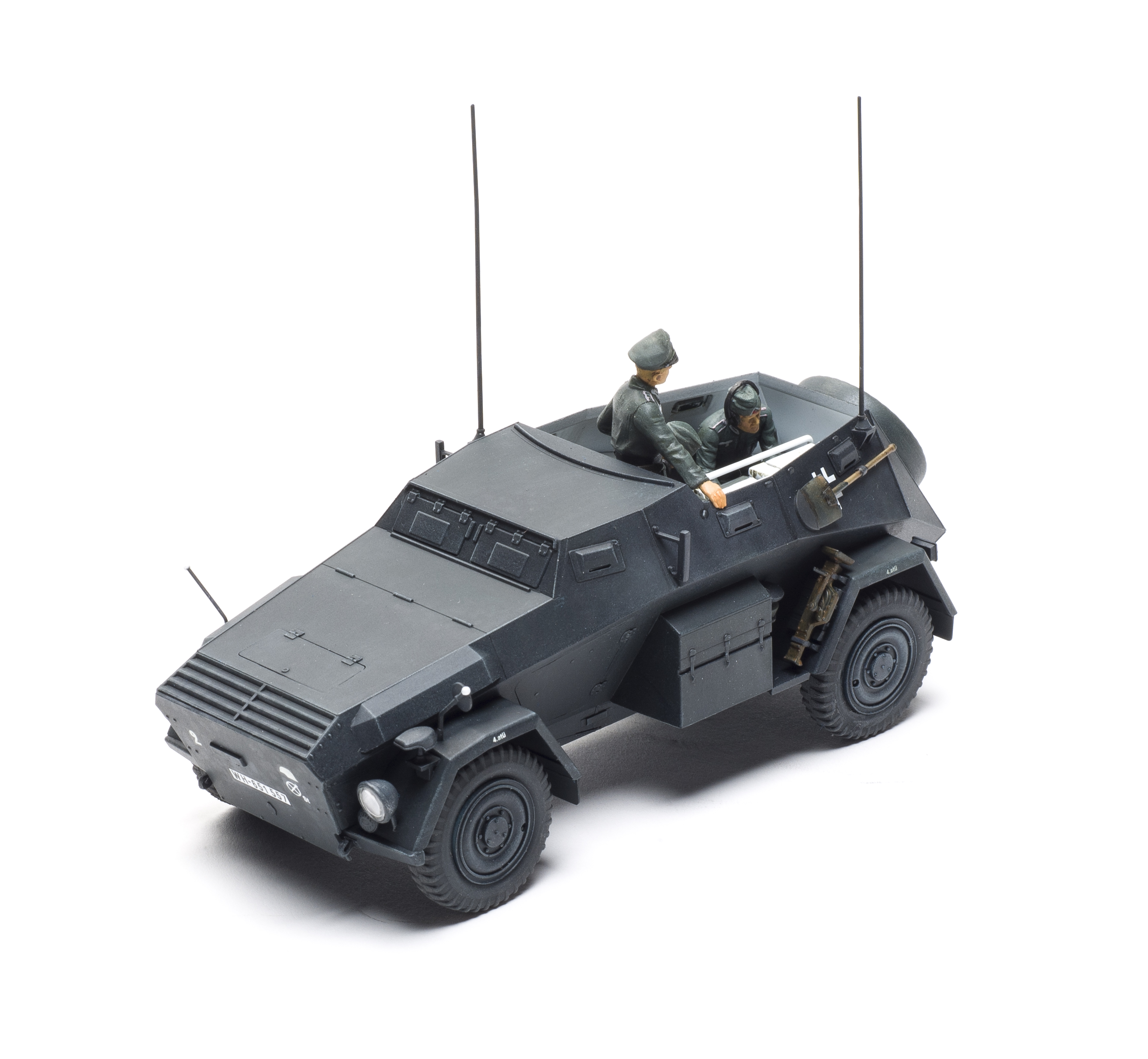

Inside, decals are included for the gauges. The directions show placement for the smaller gauges, but do not indicate which of the large gauges on the decal sheets to use. After the interior was painted, I glued the upper hull in place, then proceeded with the rest of the exterior. I thinned the mud flaps (Part E13) to give them a more scale thickness. The head lights are shown glued to fender brackets, but there are no brackets molded on the fenders. Without much surface area to glue the headlights, I drilled a small hole in the fender to make a secure bond. When trying to attach the antennas to the hull you will find a nub on the antenna base and a pin on the end of the antennae. I ended up removing the nub on the base and drilling a hole to accept the antennae. I also drilled the end of the exhaust pipe, because why not?

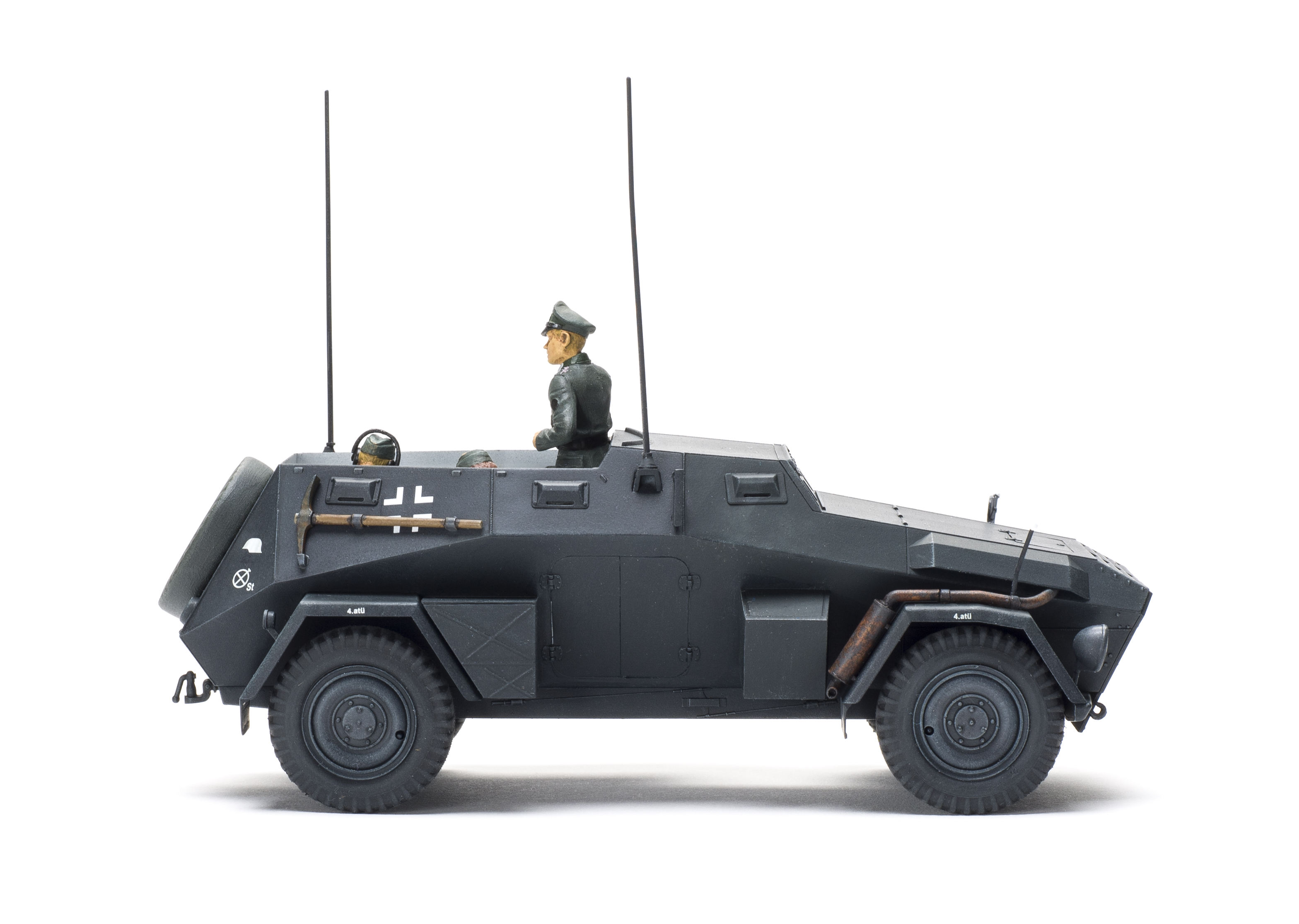

I modeled the vehicle from the Grossdeutschland Division in the Ukraine in 1942, and used a combination of AK Interactive, Humbrol, Acrylicos Vallejo, and Ammo of Mig Jimenez products. The kit’s decals are thin with little excess carrier film that disappears under clear coat. There was no silvering or bleed through that I noticed. To add a little interest to the interior, I painted the radios panzer gray and field gray (as per references).
The figures fit together well, although you’ll need to do some minor filling. The uniform detail is crisp, but you’ll need to remove some mold imperfections. Once painted, I found the features on the heads and faces really popped. The driver figure does not fit into its seat without some major surgery, so I left him out of the vehicle. The officer figure is shown with one foot stepping on something. If you have him stepping on a seat, then his other foot will not touch the floor. The directions do not show were to place the figures, so you’ll have to figure out positions that make sense to you.
If you hate working with photo-etched metal (PE), ICM’s kits are for you. Plenty of detail without the headaches PE can bring. Overall, the SdKfz went together well and logically, which makes it a good kit for modelers with a little experience. It took 33 hours to complete with most of the time spent painting the figures and filling in the ejector-pin marks. A word of warning: Be wary of photos of these vehicles on the internet. Many of the photos you’ll see are reproductions that vary in appearance based on the frame used. Be sure you’re looking for period photos. And if you want to dress it up, this SdKfz is just asking for stowage, radio wires, and maps.
