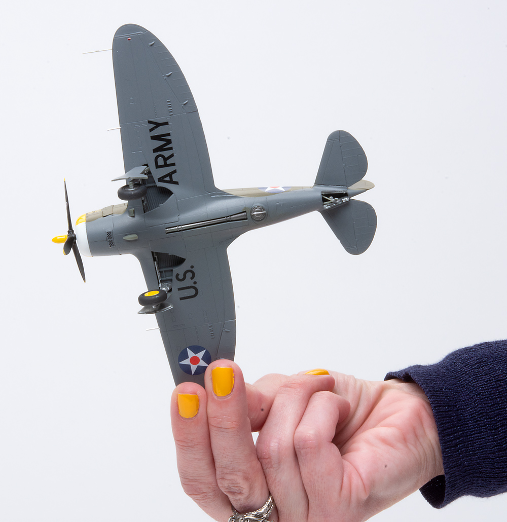

In the final step, it appears that the small inboard and outboard landing gear doors are mounted closed. It’s not clear how the linkage arms (parts D12 and D15) should mount inside the wells.

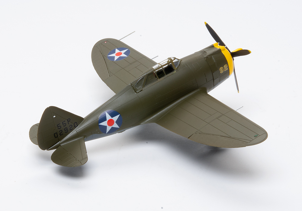

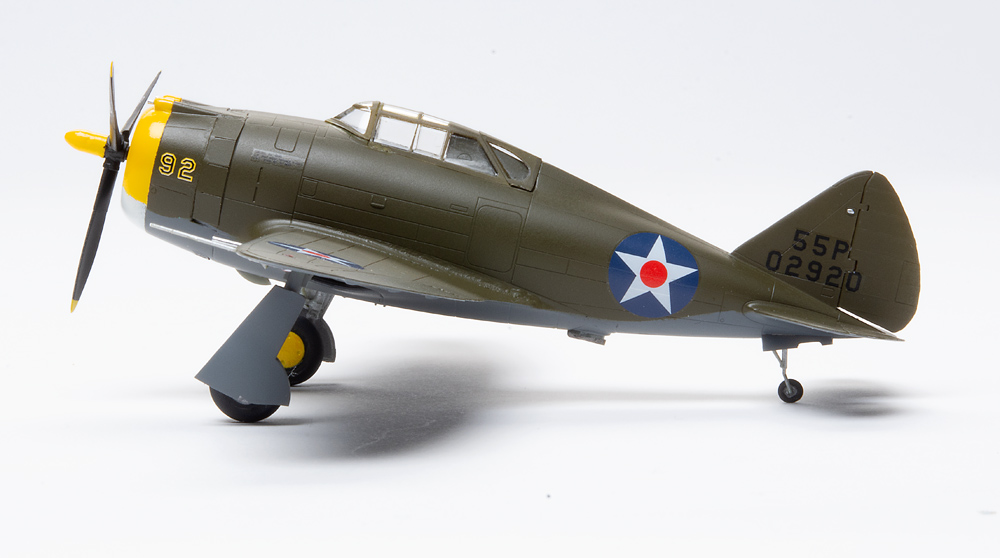

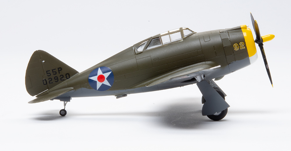

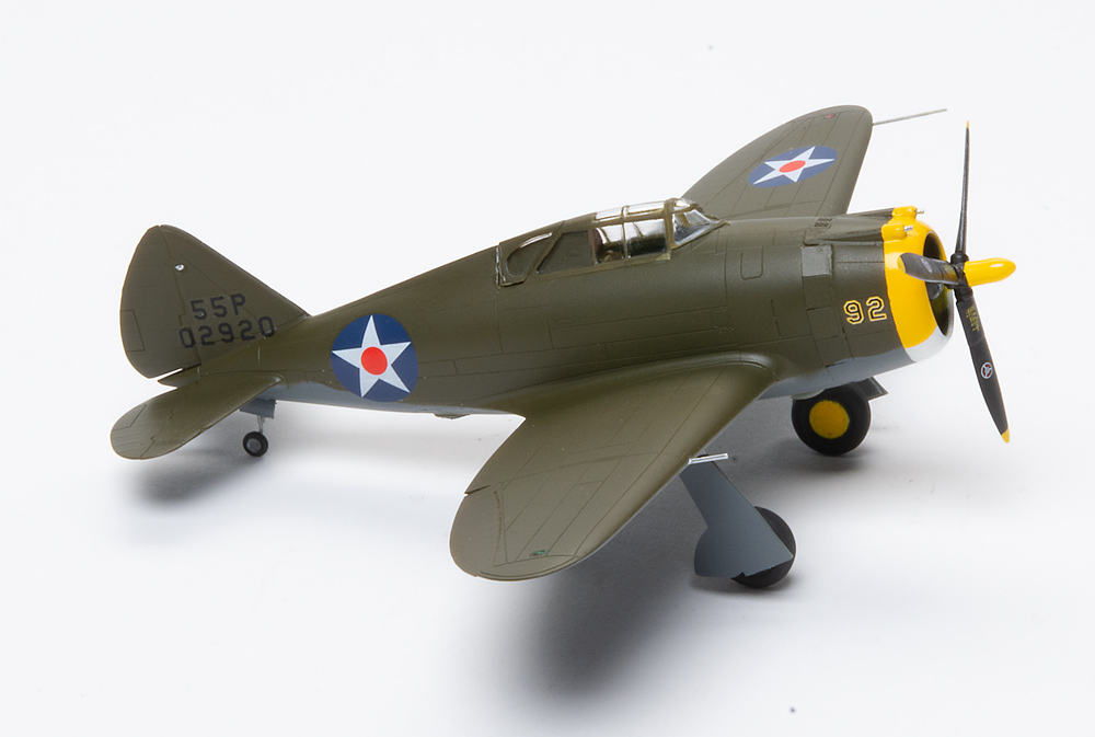

I painted my P-43 with Mr. Color lacquers using the kit’s handy, pre-cut vinyl masks on the canopy. I had no trouble with the well-printed decals, using only a hairdryer and a touch of decal solvent.
After 21 hours, my little P-43 looks pretty good. I can’t detect any outline or shape troubles when comparing the model to reference photos. While I was building this model, I was also watching an airing of the old movie Air Force about an early B-17 crew caught up in the opening American battles of World War II. Some of the cuts show swooping P-43s as attacking Japanese fighters! No CGI there!
