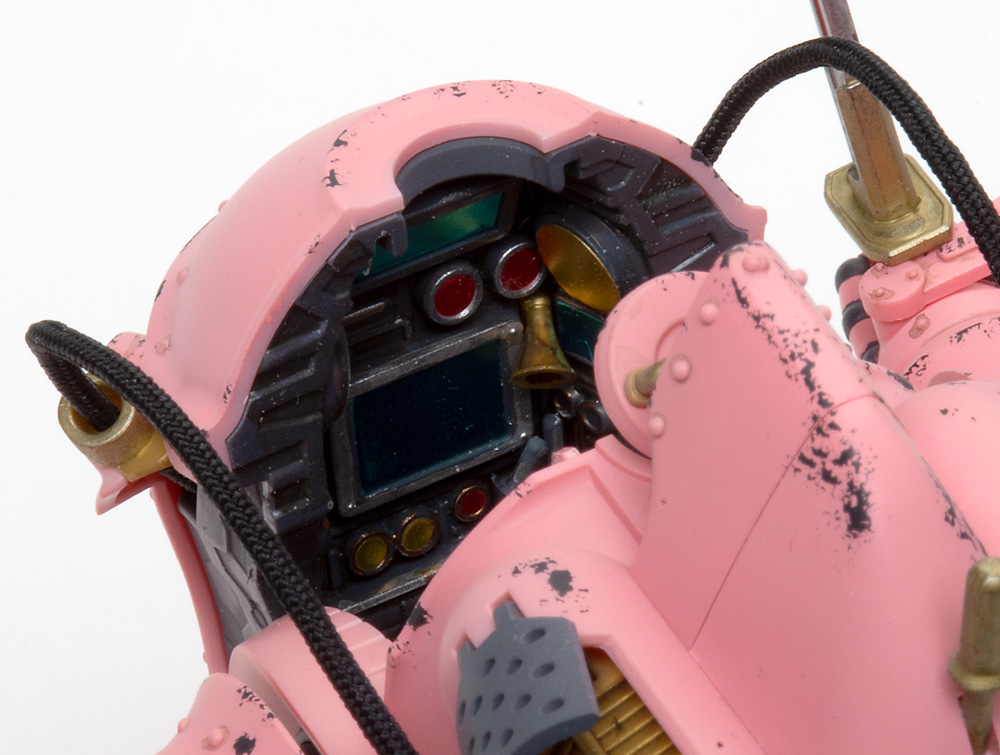

The instructions have you start building the pilot’s compartment. You’ll want to paint and finish the figure of Sakura Shinji before going too far along. Or you can leave her out if you aren’t intending to open the front of the armor suit to see inside. For many modelers, painting eyes can be a challenge. Bandai removes that obstacle and provides big, appropriately shaped anime eyes as decals for the figure. They fit perfectly and settled on just a little clear gloss.
Wires run from the figure’s flight suit to the rear of the pilot’s compartment. Wait until you’ve painted both the figure and the seat before you run the lines. No need for glue here; they stay put via friction. The kit’s stickers don’t look particularly realistic, but all my research could not turn up many official images of the armor suit’s interior for detail painting. I used the stickers and was surprised at how good they looked in situ.
In Step 7, be sure to attach the tubes (parts A14 and A15) before the assembled steam vent pods. If you don’t, you’ll be pulling off parts to get them to fit.
With so many curves, mold lines are practically inescapable. While numerous, the mold lines are fine and clean up easily. Similarly, the joins for the arm and leg armor are front and center. For a clean look, you’ll need to fill and sand them, which took me a while—and was the second longest part of the project aside from painting the figure. For me, the seam along the vent at the top of the suit need particular attention.
The Kobu-Kai’s complexity presents paint challenges. I painted practically all the parts on the parts trees first with Tamiya Pink, Gray, and Dark Gray. If I had to do it again, I would prepaint only the gray areas, and wait to paint the pink parts after the model was assembled and sanded. I only mildly weathered mine, using the box art as a guide. But you could go much further and give it a battle-weary appearance.
