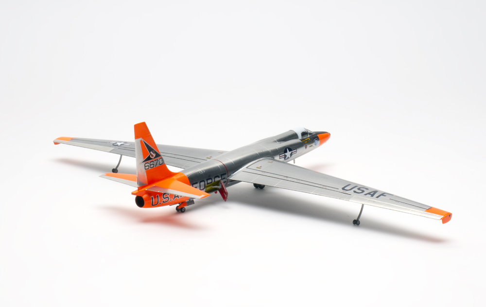

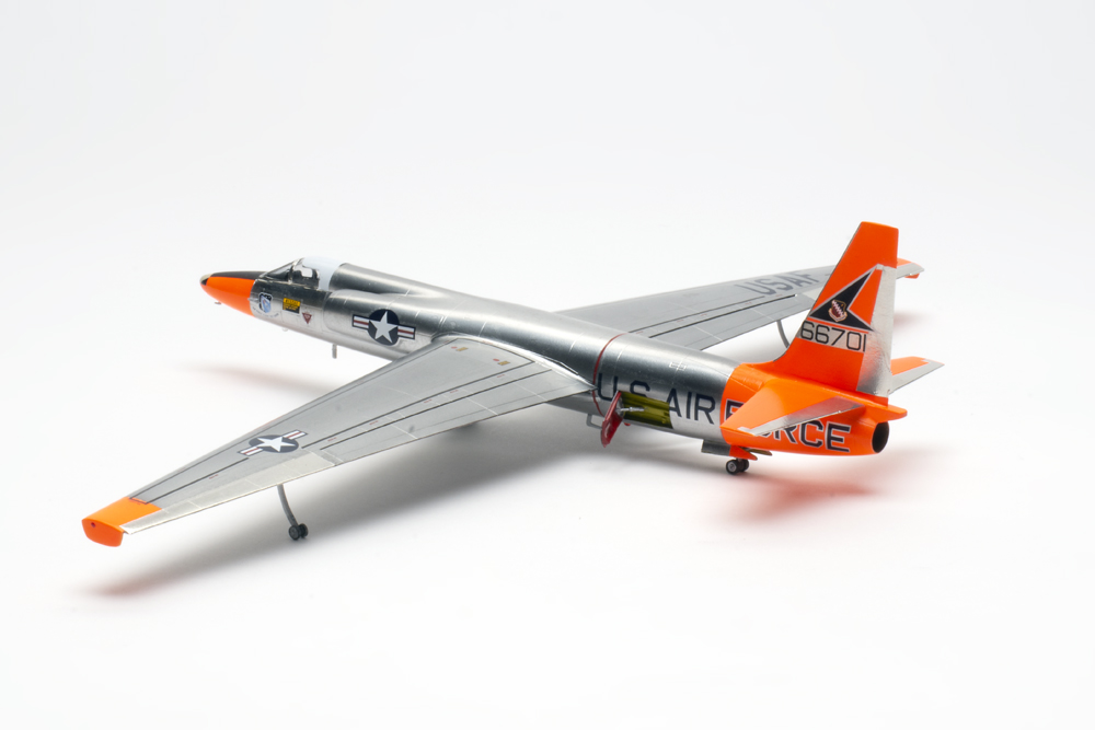

Wing construction is easy, but the large sensor fairing on the trailing edge of the starboard wing should be removed; it was installed on later U-2s. I carefully sawed it off along with the tiny fuel-dump pipes. The leading edges have separate parts to fill the area where “slipper” tanks were fitted on later versions.
Three air scoops are added to the lower fuselage, but photos of early U-2s show that some were not there originally. Same goes for two tiny clear domes on the nose. I omitted the one in front of the windscreen and filled its hole.

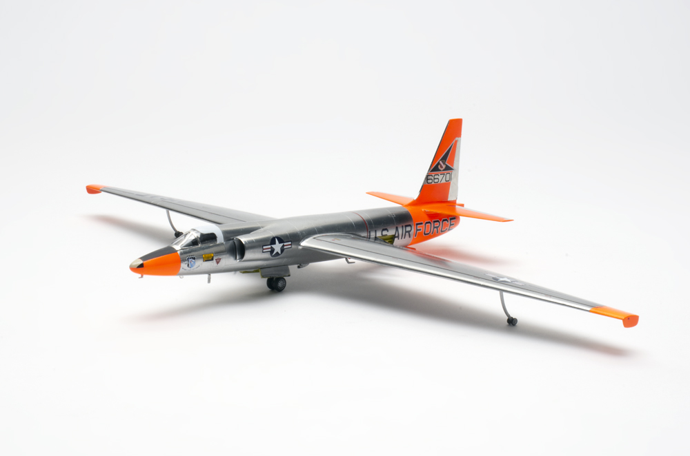

I just had to do the high-visibility test bird at Edwards Air Force Base, so I painted my U-2A with Alclad II Polished Aluminum (No. ALC105) over gloss black and Mr. Color Fluorescent Orange (No. C173) over flat white. The kit’s full-color markings guide doesn’t show the absence of the Day-Glo paint on the ailerons and elevators.
While the kit decal sheet is adequate, the style of the large “U.S. AIR FORCE” on the test bird is not correct, and the bare-metal outlining of some of the letters and the background of the serials on the tail are printed in a muddy gray. I substituted Caracal decals for the very same aircraft.
