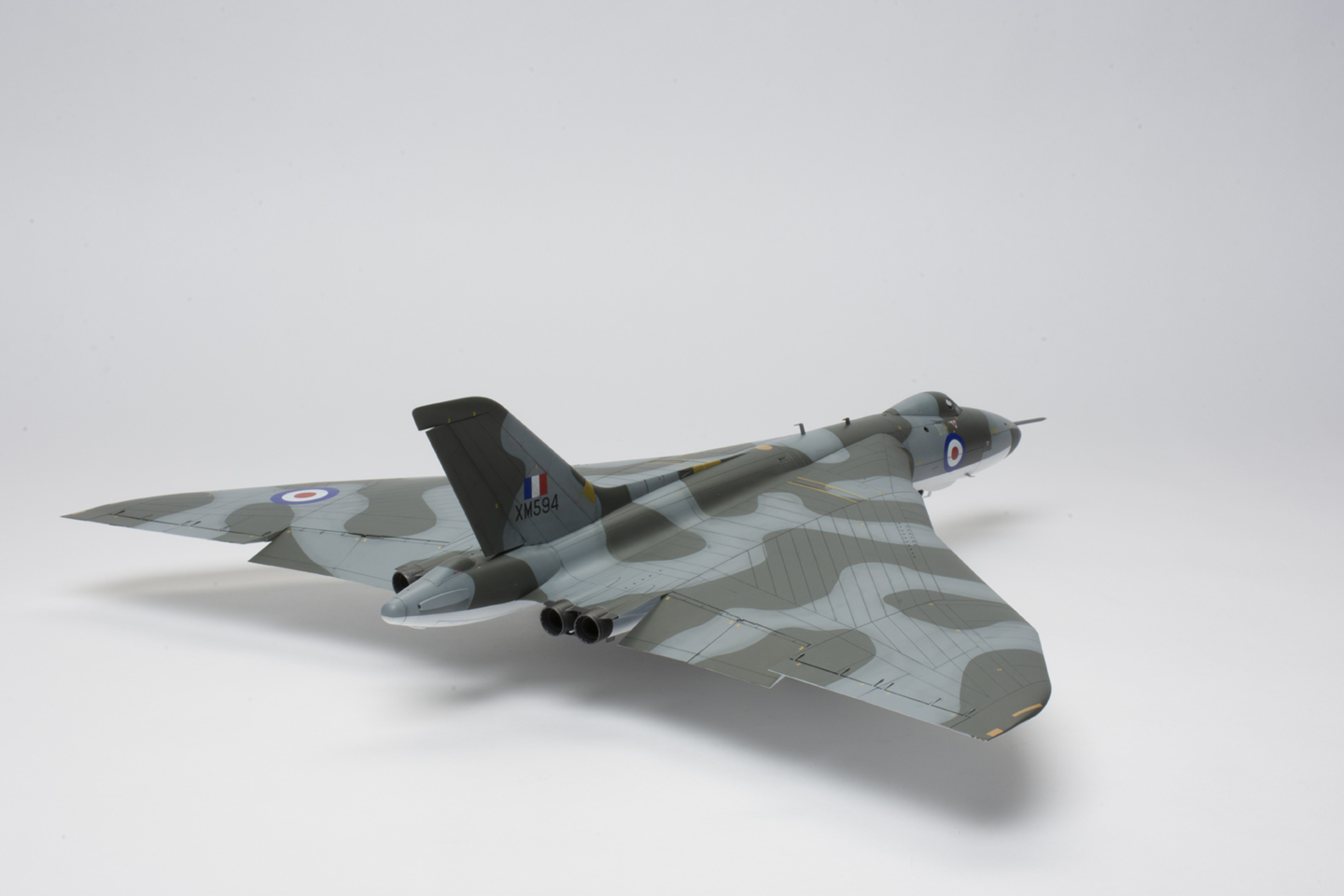

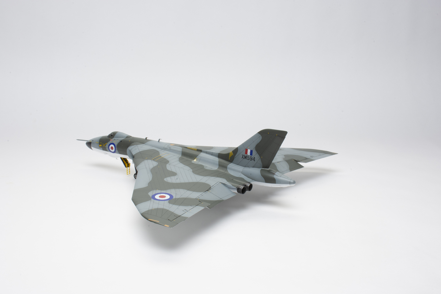

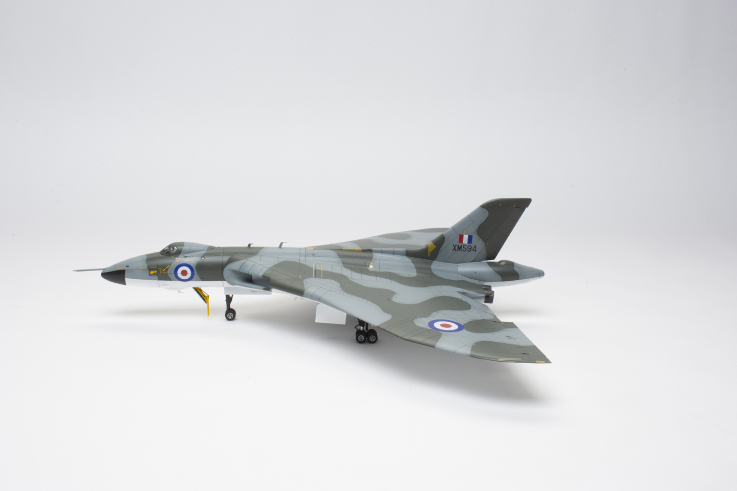

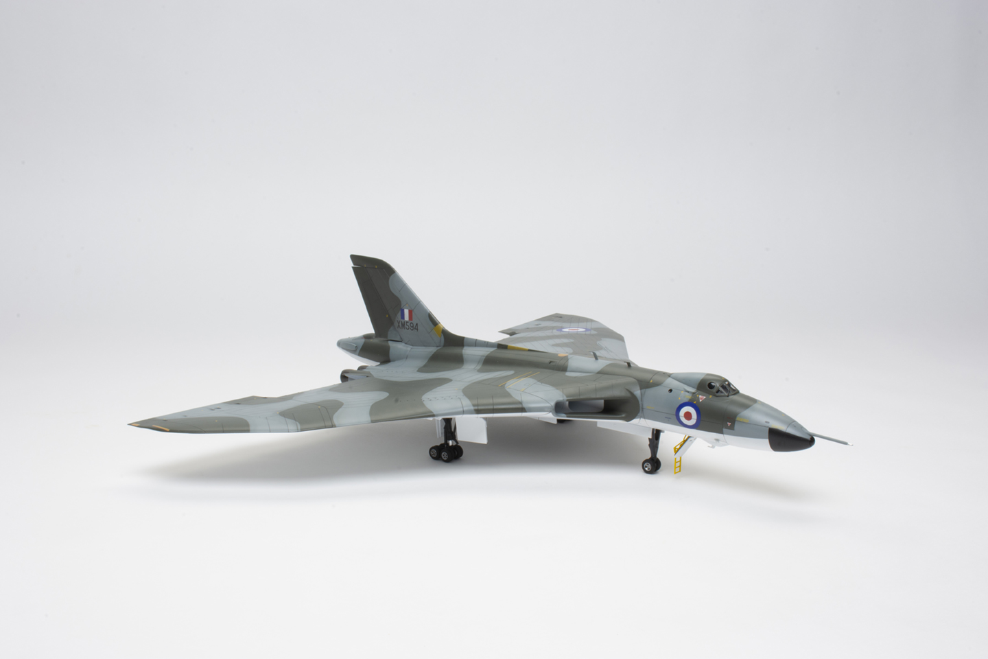

The bomb bay assembles from sides, frames, and spars that attach to sturdy supports for the massive wings. Good engineering makes for smooth construction, but be sure everything is aligned. I airbrushed the bomb bay with Tamiya white primer. The lower wings needed a just a little filler and sanding before I added the landing gear bays, bomb bay, and wing spars.

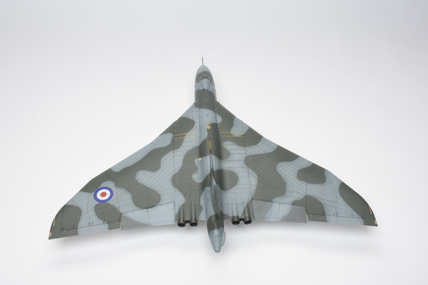

The engine intakes took a long time to complete. After gluing the parts, I filled and smoothed the seams before painting the insides white, and fits were generally good. The problem arose when I had to add camouflage fairly deep into each intake because I wasn’t confident I could mask and paint them. The instructions provided a template of the demarcation line, so I ended up painting some decal paper with the appropriate colors and used the template to make a decal to go into the intake.
It worked OK, but they still needed a little touch up, so I’m not sure it’s the ultimate solution. If you plan on using the FOD covers, add them before installing the intakes in the wings; they will not fit afterwards. After gluing the upper half of the wing together, I added it to the lower half.
The front fuselage fits the wing assembly well, but I carefully clamped it to minimize misalignment. I had to trim quite a bit from the mounting tab for the tail to fit flush with the fuselage. All the little bits and landing gear finished the build. The main gear legs were a little tough to get in place but are sturdy and should have no problem supporting the weight. If you paint the camouflage, enlarge the marking diagram 250%; it provides a nearly perfect match to the model.
