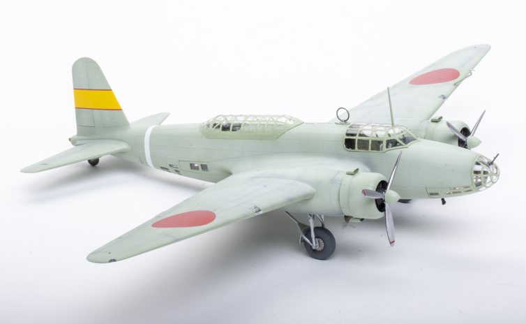

The interior parts fit inside the fuselage like a glove, and the resulting join did not require any filler. The wings, horizontal stabilizers, and separate control surfaces fit well. I wasn’t thrilled with my cutting of masks using the given templates, so I left the clear canopy, gunners’ canopy, and nose off the model.
Even though I assembled the landing gear as instructed, I trimmed the main wheel axles a bit shorter. I left the inboard side of the retraction struts (Part 51) unglued to allow me to “pop” the wheels in place after painting.
The nacelle assemblies fit perfectly in the recesses on the wings. I assembled the cowls but left them off the model until the final assembly — no glue was needed.
The nicely detailed engines were assembled and finished separately, too. Be careful removing the crankcase (Part D12) with its numerous attachment points and small, easily broken pushrods. There is a teeny lip around each spinner that makes the “edge gate” very difficult to remove.

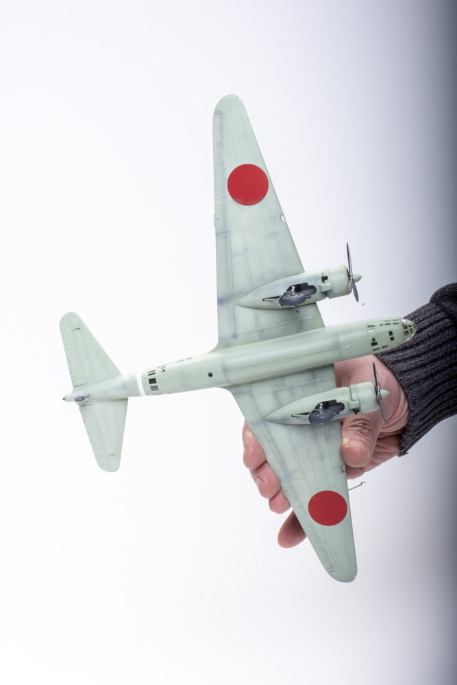

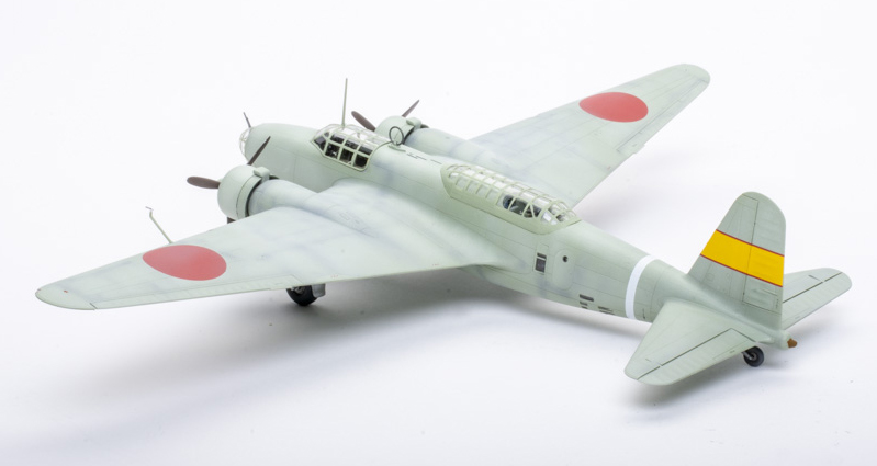

Like Henry Ford’s Model A, you can have your Sally in any color, as long as it’s green-grey. ICM captures this elusive color well in ICM Green-Grey (No. 1063). I primed the exterior with Tamiya Sky (No. XF-21) and oversprayed with the ICM color.
The handful of decals settled nicely with no issues. A bit of shading and weathering preceded the addition of the detail parts, followed by a flat coat.
Lastly, I hand-painted the frames on the clear parts and cleaned up the jagged edges with my paint eraser — a sharp toothpick. Then, I attached the canopies and nose to the model.
At long last, the market has a modern tooling of the Sally with plenty of detail to satisfy. The fit and execution are outstanding, and a fine replica will result after a bit of work. I spent slightly over 22 hours on mine and enjoyed every minute — except for painting the frames on the clear parts!
