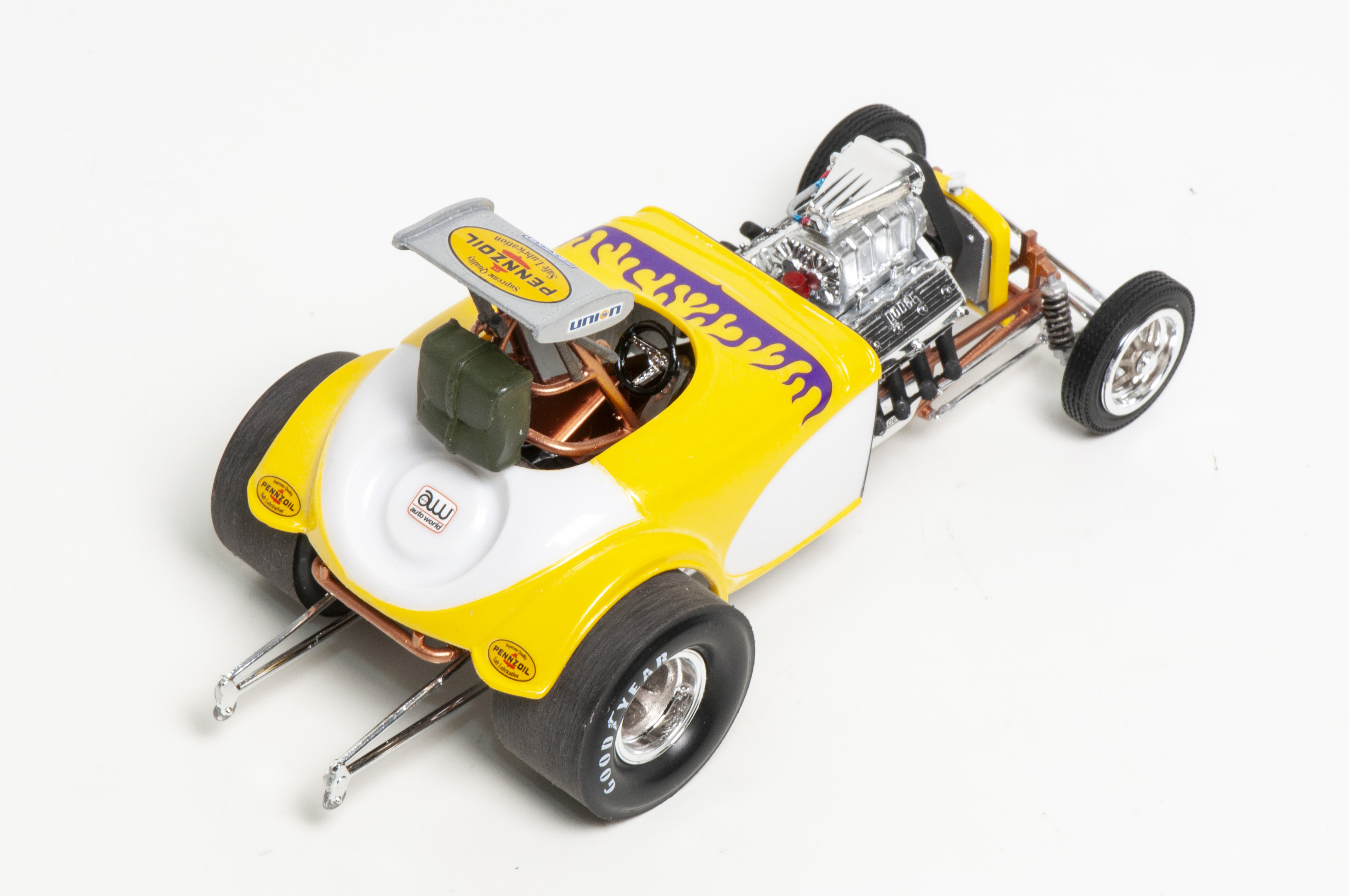

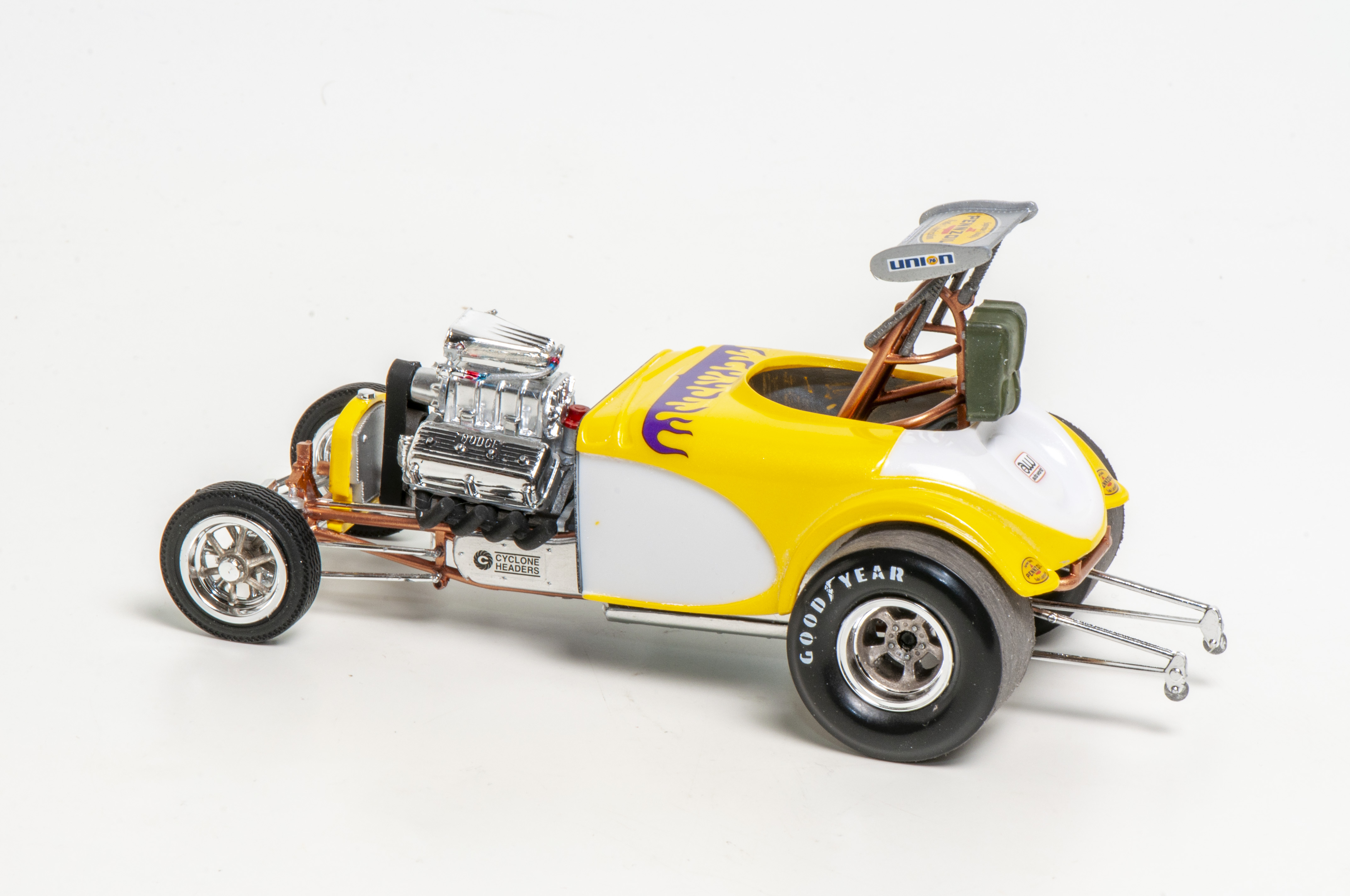

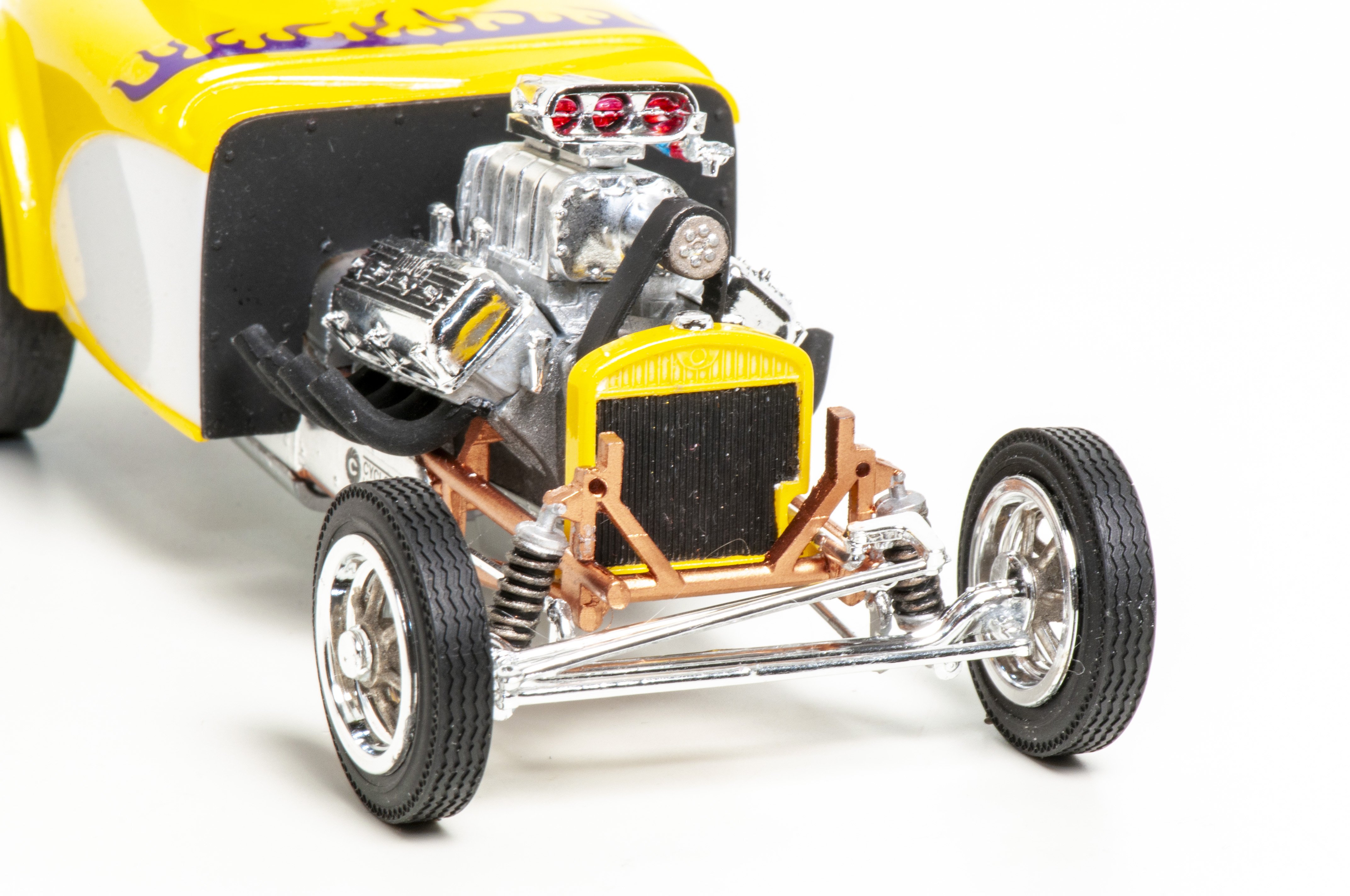

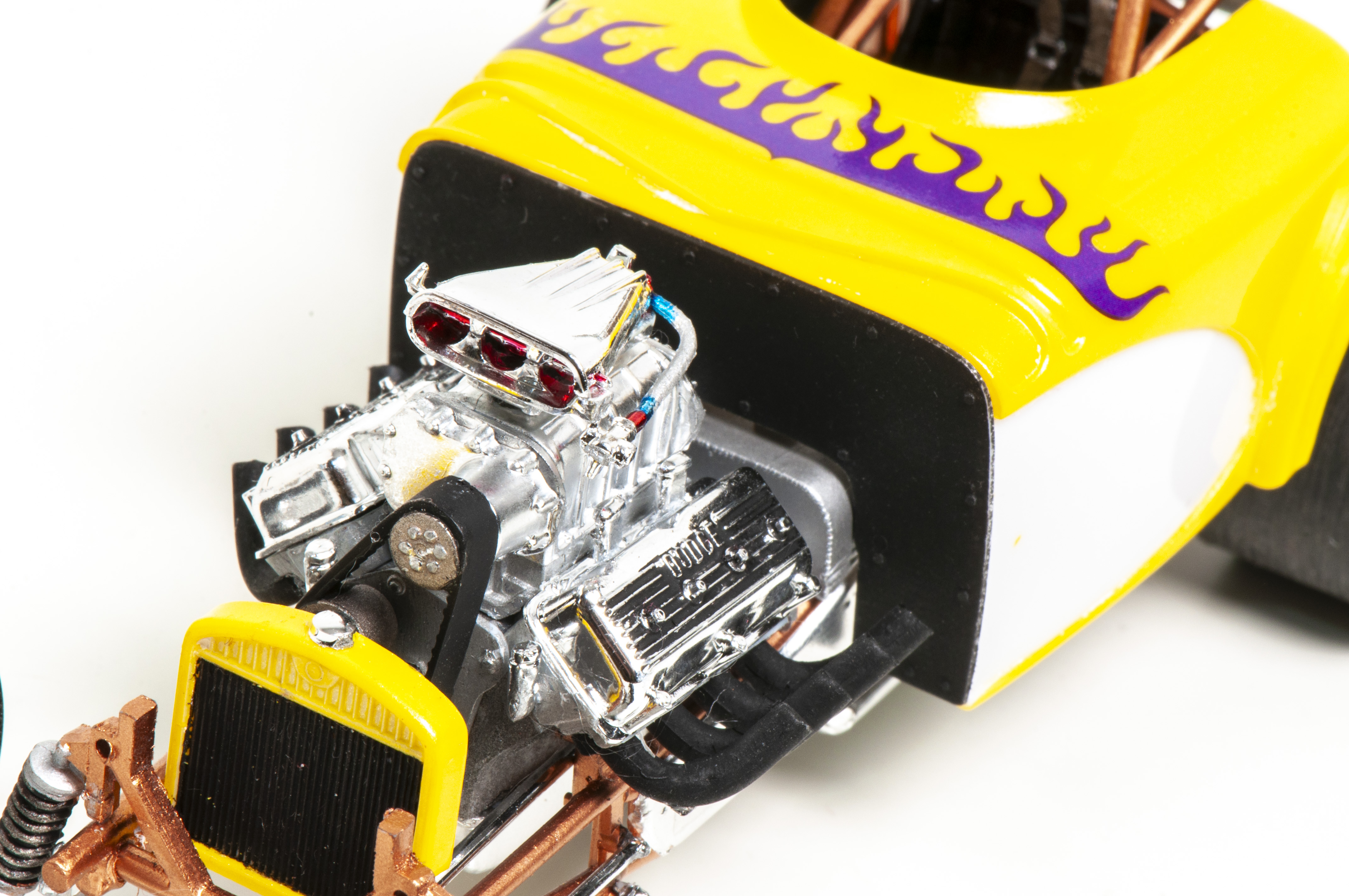

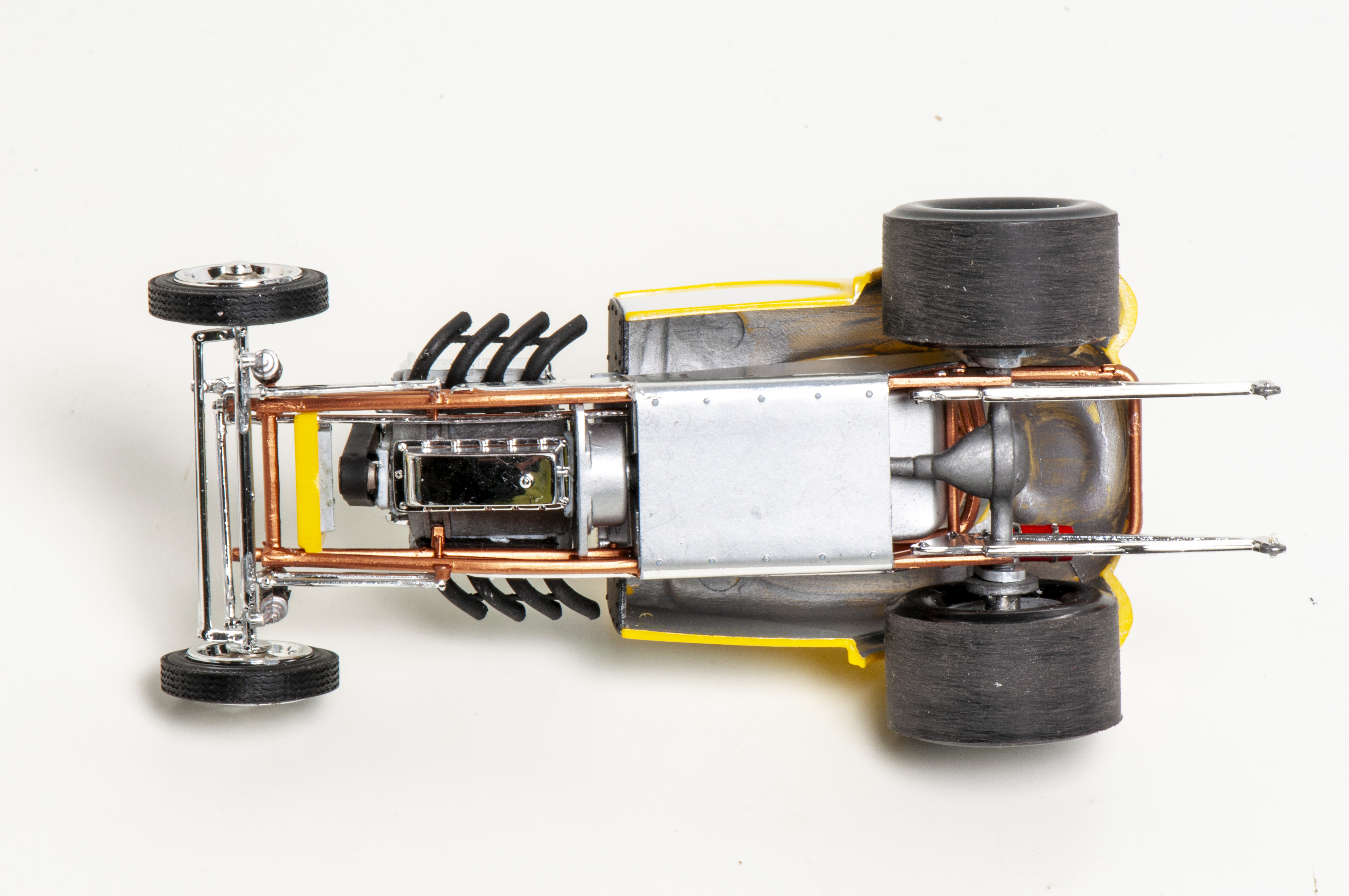

The five-part tubular chassis is tricky to assemble; use the interior floor pan (Part 8) as a jig to align the chassis parts as the glue sets. The left frame on my kit was slightly bowed; check yours and, if necessary, bend it back to shape before assembling the frame. The steering shaft (on Part 101) needs its edge clipped back about 1/32 inch to accept the Pitman arm (of Part 110). The front cross member (Part 17), is molded with the Wild Willie Model T radiator attached. Since a separate Bantam grille shell is provided, you’ll need to remove the Model T portion from the cross member by cutting it away just above the shock towers. Note that this step is not shown in the instructions.
Pronounced mold seams mark both sides of the body where they meet the rear fenders and will need to be addressed before painting. The rest of the kit parts show the tool — now 50 years old — to be in generally good shape with minimal flash on only a few parts; the only notable ejector-pin mark is the seat bottom cushion.

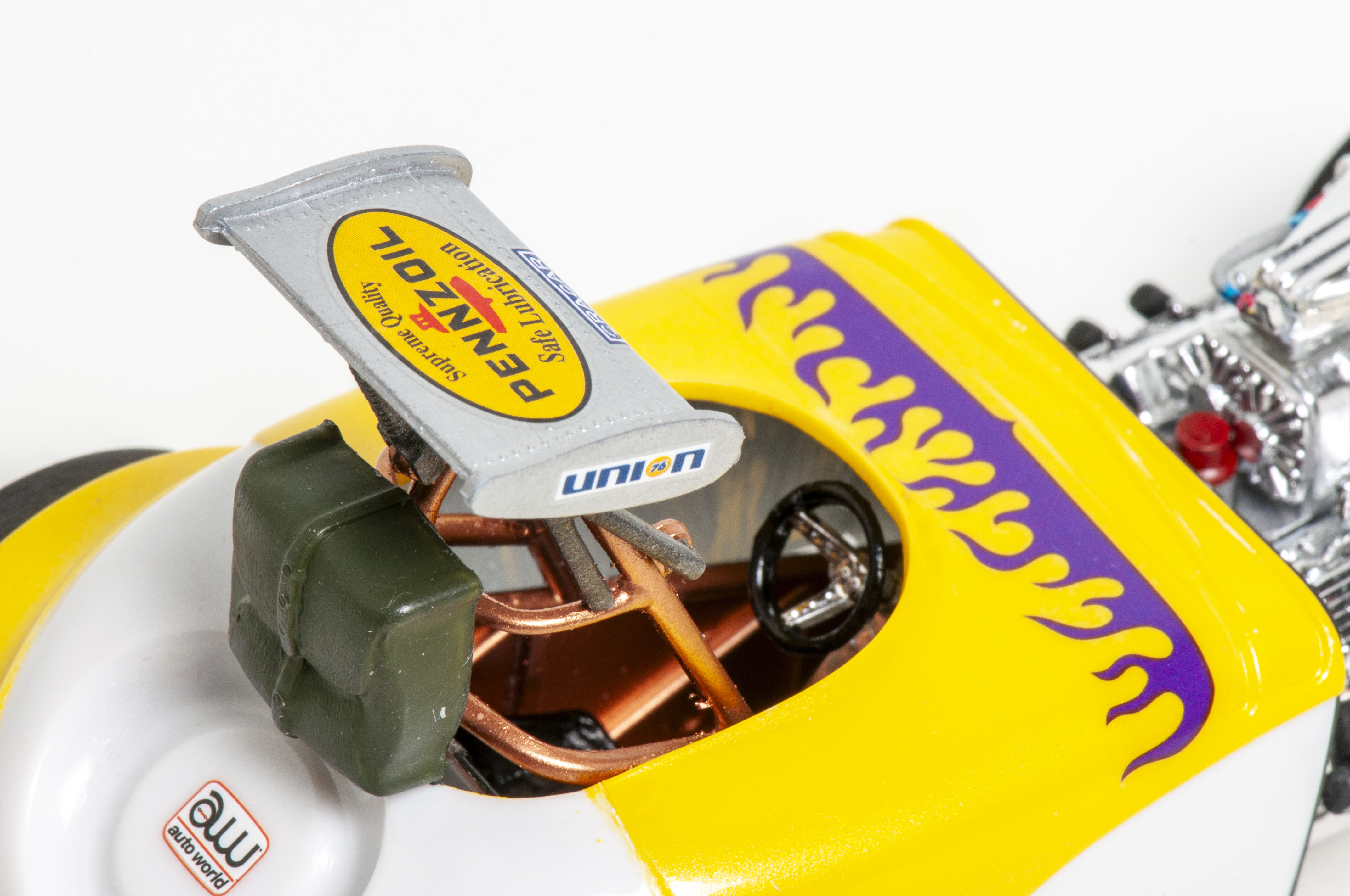

A newly expanded decal sheet provides brilliant colors and a range of very crisp, period-correct sponsor decals, but most of the flame graphics — rendered in both bright red and violet options — do not fit the contours of the Bantam body easily. Another new feature is the very sharp hollow and flexible drag slicks with “Goodyear” printing. For this reissue, Round 2 left all the tooling gates for the plated parts tree open, yielding many leftovers from the Willie Borsch kit that you can add to your model car parts box.
While there were no “white-knuckle” moments assembling this kit, some of the smallest parts — rendered perfectly in scale — lacked precise mounting tabs and required extra patience. And, as usual with older kits, meticulously check the parts fit and assembly sequences before breaking out your glue.
I invested about 25 hours building the kit, partly due to added paint detailing. My only addition was Bare-Metal Foil on the sides of the frame rails and top hat. Experienced, savvy drag-racing modelers should give this reissue a serious look. I’m certain you’ll enjoy building this little-known landmark in drag-racing kit development.
