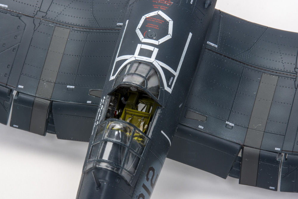

Construction begins in the cockpit. Not mentioned in the instructions are duplicate consoles and panels without the excellent raised detail for use with the kit’s decals. There is some play in the parts fit, but the details are an exact match to the pictures in the 1998 edition of Detail and Scale Vol. 55. Magic Factory even provided the correct seat supports for the early and “raised cabin” seats, and the appropriate internal armored glass. Diagrams are included showing where to drill holes for the forward antennae and the supports for the folded wings. Only open these when appropriate.
The four cockpit sections do not lock together and want to twist and warp. I used the fuselage sides to clamp them together. Here, I realized just how ambitious Magic Factory has been in trying to eliminate fuselage seams by using separate inserts matching panel lines. The bulkheads don’t fit precisely, which leads to play and small gaps along the fuselage, allowing the nose and tail to touch. The two inserts immediately aft of the canopy have nothing to set their width, causing additional issues. This happened with both airframes. Rather than following the instructions, you might be better off working from the rear to the nose.

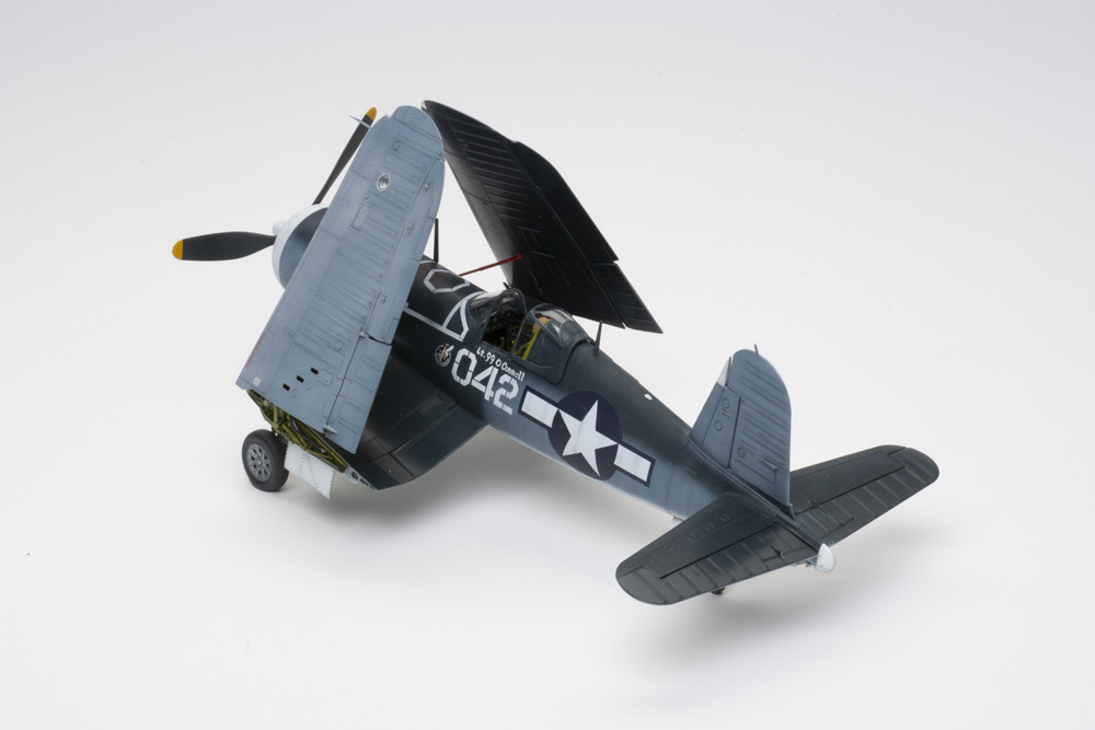

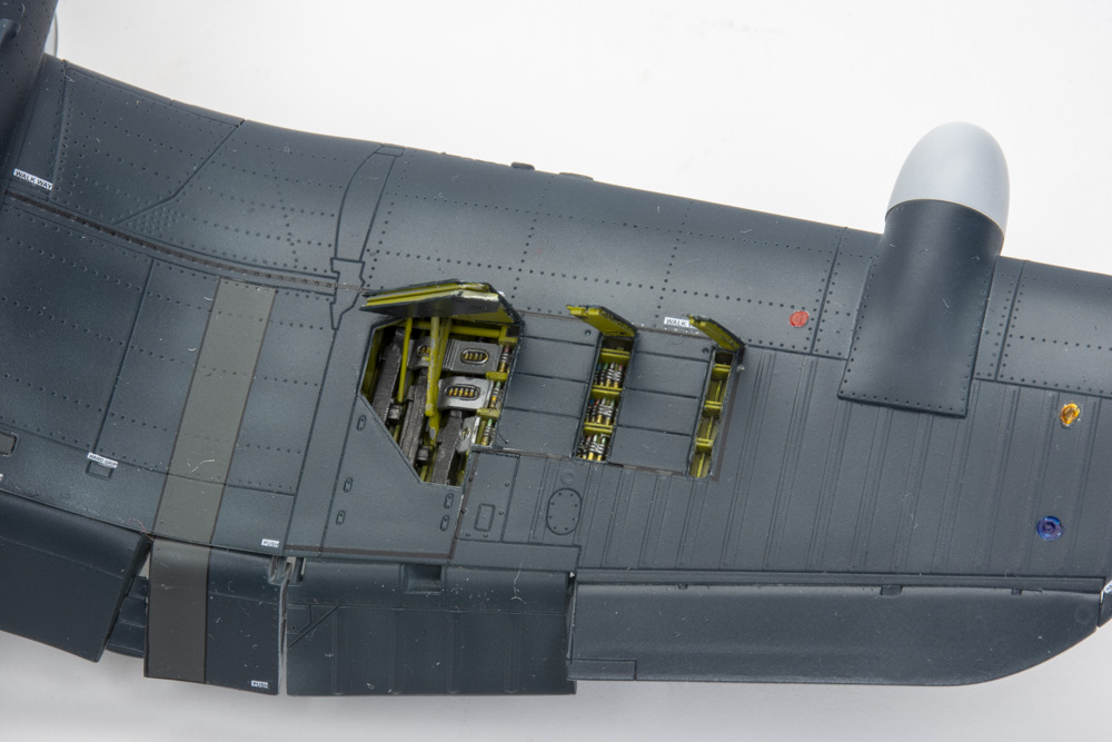

The straight wing was next. Once again, the parts have a small amount of play. The ammo belts don’t quite reach the ammo chutes, and I needed to modify the shortest chute to get it in place. I used white glue to hold the gun bay doors in place during painting and easily remove them afterward. Separate wing tips indicate the possibility of a British Corsair in the future. The folded wings went together without problems. I waited to push the outer wing panels all the way down the spar until after painting. They are so tight they will not come back off once seated.
I needed to trim several bulkheads and the firewall to get the fuselage to seat correctly on the wings, but once seated, they only needed a swipe of filler.
All the decal options are for aircraft painted in variants of the tri-color scheme. My decals were slightly out of register, with a sliver of white showing on the left side of the insignia. The call number for 042 should be smaller, matching the blue outline on the bar of the national insignia. One set of decal stripes on the bomb fit with help from Solvaset, and the other came up a touch short. I used Alclad II Klear Kote Gloss to prevent silvering, but a few of the stencils did anyway. After an acrylic wash emphasized the panel lines and rivets, I used Alclad II flat and semi-matte to provide the correct non-specular and semigloss sheens.
