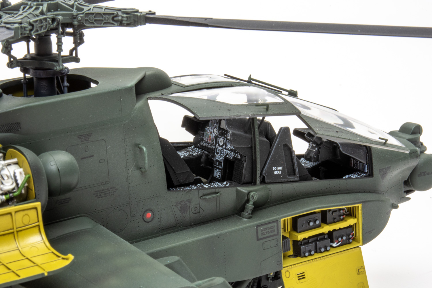

The cockpit instrument panels and consoles receive decals over the underlying detail. I had a bit of trouble getting the decals to settle over all of the switches and knobs. Separate cushions and PE seat belts finish the seats. With the large canopy glass, everything is visible in the cockpit, so it’s nice Trumpeter put as much detail as it did here. The cockpit tub fit perfectly in the fuselage halves.

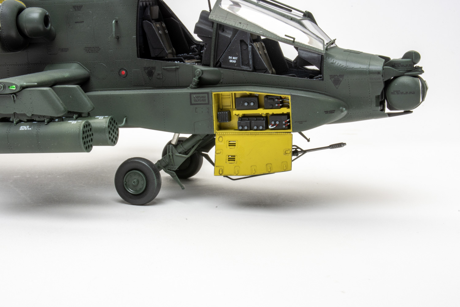

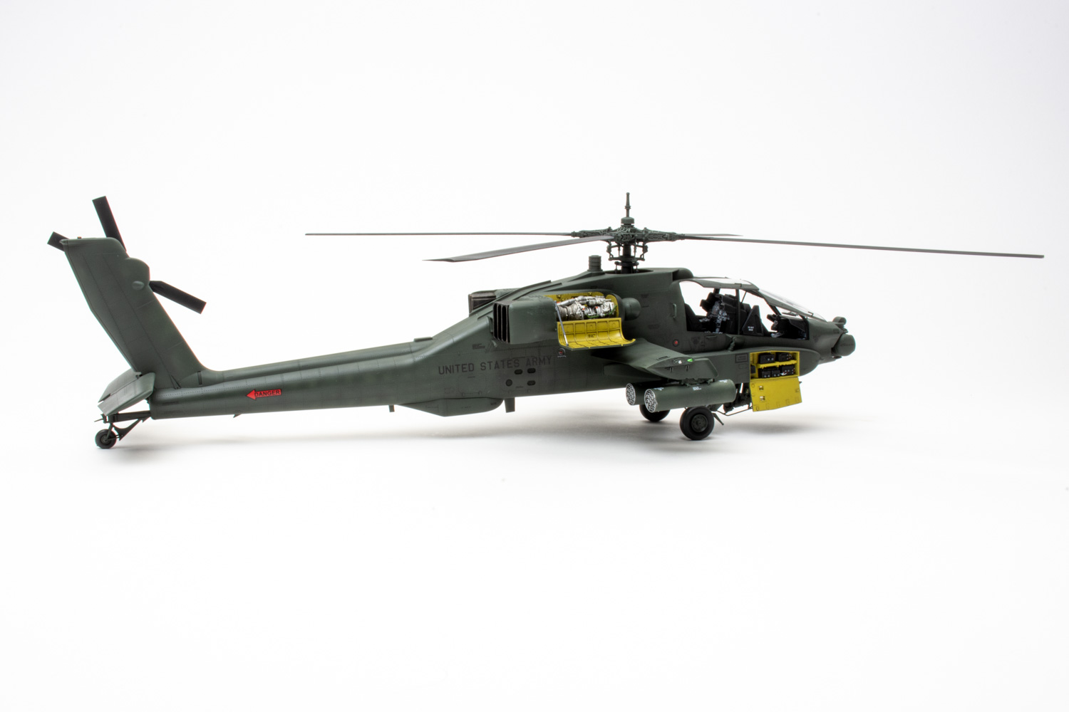

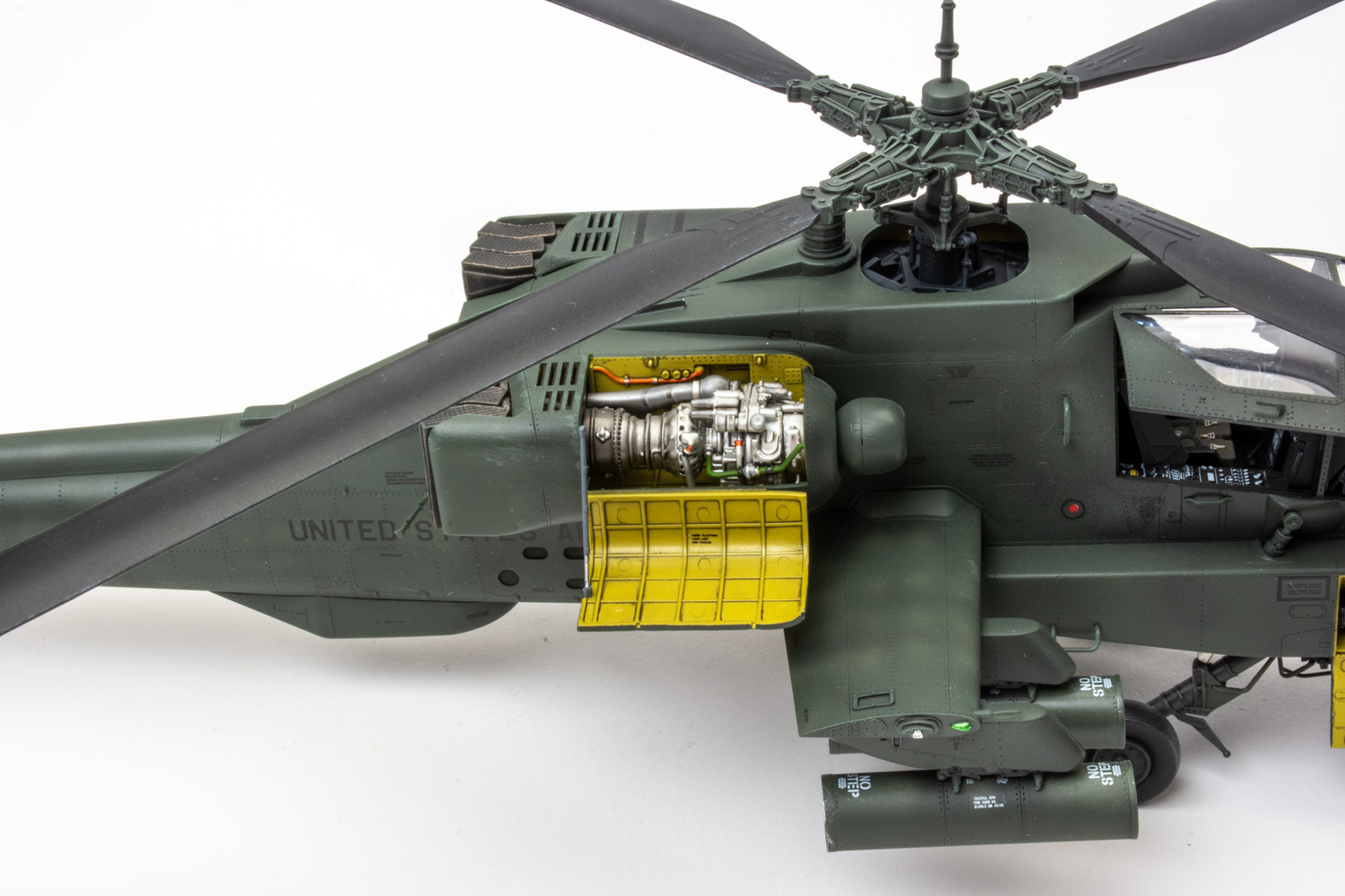

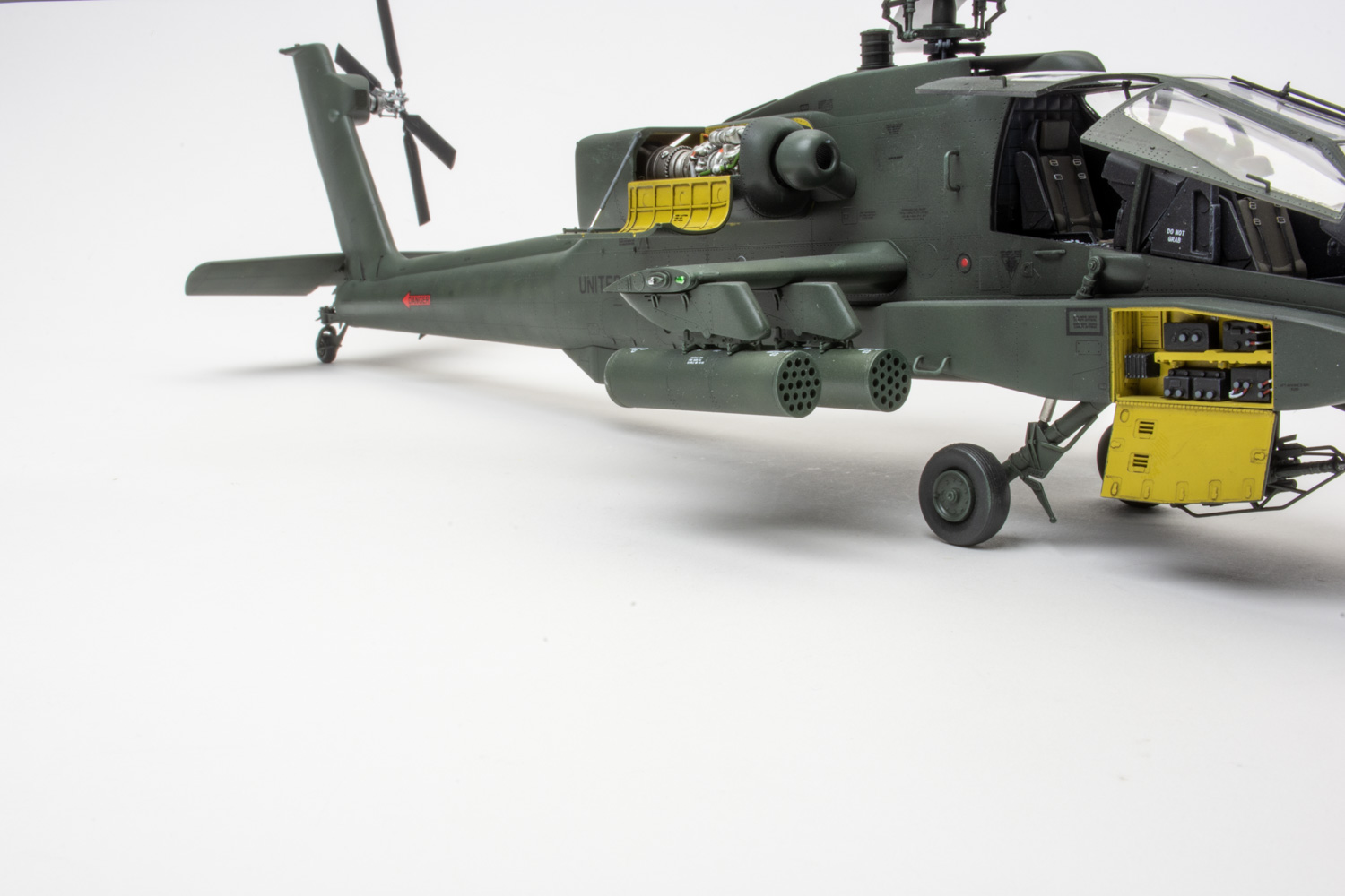

You can pose the left- and right-side avionics bays open or closed. The doors fit closed without any gaps. The vents in the bay doors are molded open — a nice touch! You can also leave the engine covers open. Again, if you close them up, the doors fit nicely and tight. The well-detailed engines are gems with an auxiliary gearbox and all the plumbing. I was disappointed that the nacelle doors have ejector-pin marks between the ribbing. It will take some doing to remove them.

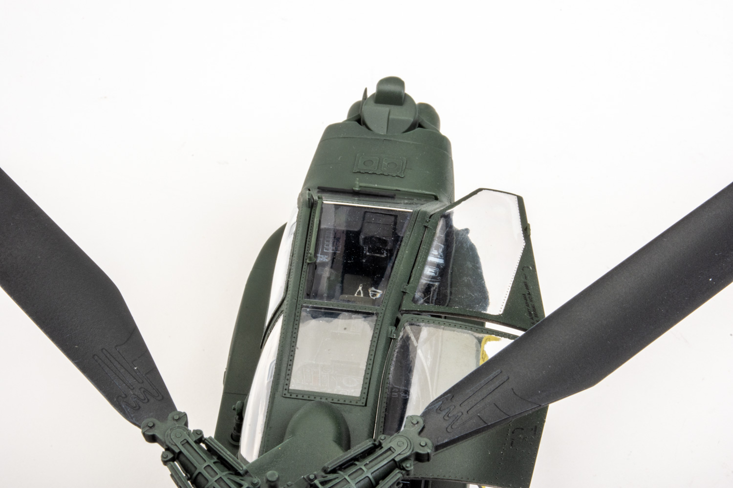

I left the canopy doors open on my model, although you can opt to close them. Precut masks help with painting the big, clear parts. You’ll find the mask for the front door a bit large, so you’ll need to trim it for it to fit properly.
The kit includes Hydra 70 rocket pods and Hellfire missiles. For my chopper’s loadout, I chose four rocket pods all the way across.

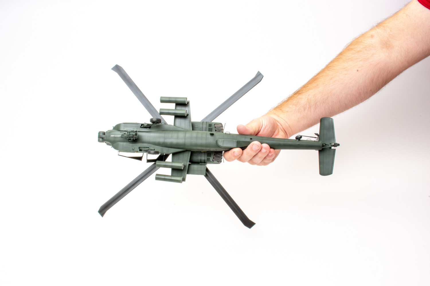

The main rotor assembly is a work of art and a breeze to assemble. The separate rotor blades have conical attachment points that fit into the rotor head. Unfortunately, the blades don’t have molded droop. The plastic resisted my attempts to warm and shape them. The tail rotor, in contrast to the main rotor, was fiddly to assemble.

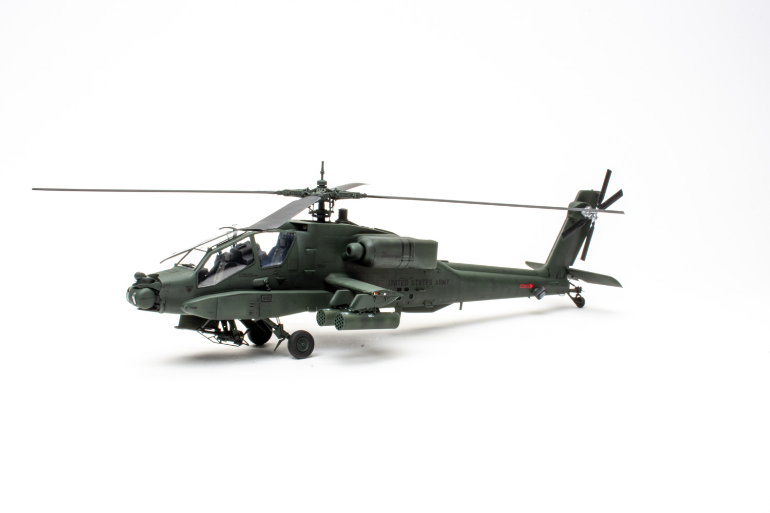

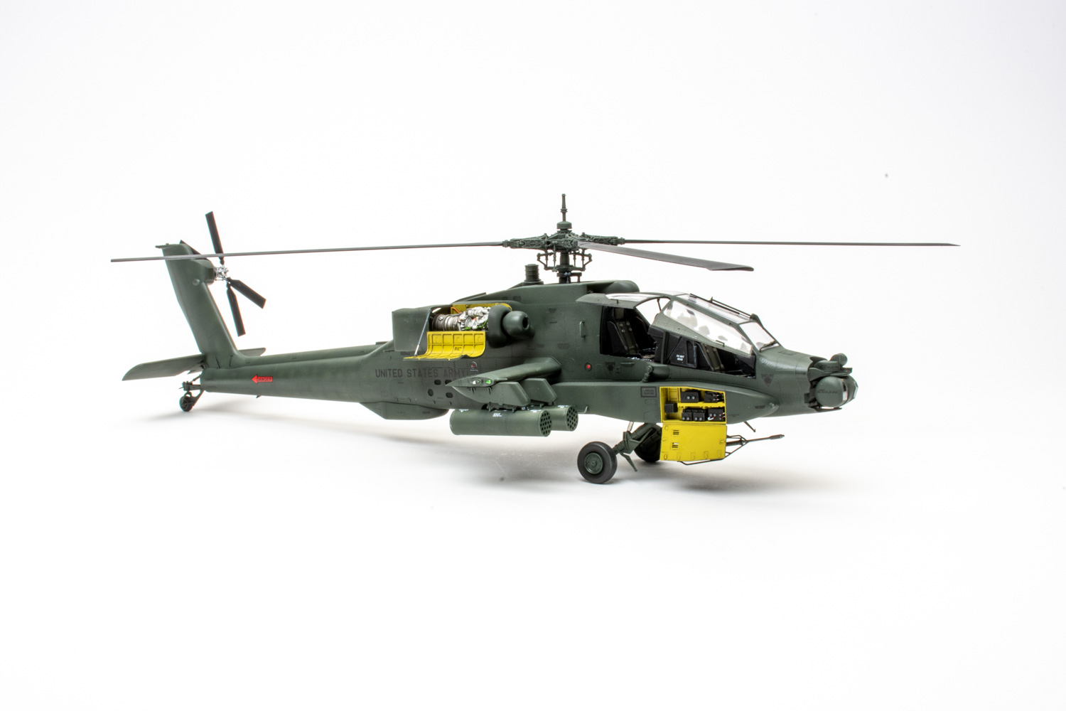

The Trumpeter 1/35 scale AH-64A (Early) Apache plastic model kit does a nice job replicating this amazing helicopter. Despite the decals, it is a great kit. My only advice is to go slowly with the decals. The ones I was able to apply, worked well. They are thin and tend to fold, so work to minimize that possibility when applying them. Or look for appropriate aftermarket markings of your choosing. In the end, you’ll have an impressive model. I recommend this kit for those who have a couple of years of experience with building, but definitely not for beginners.
