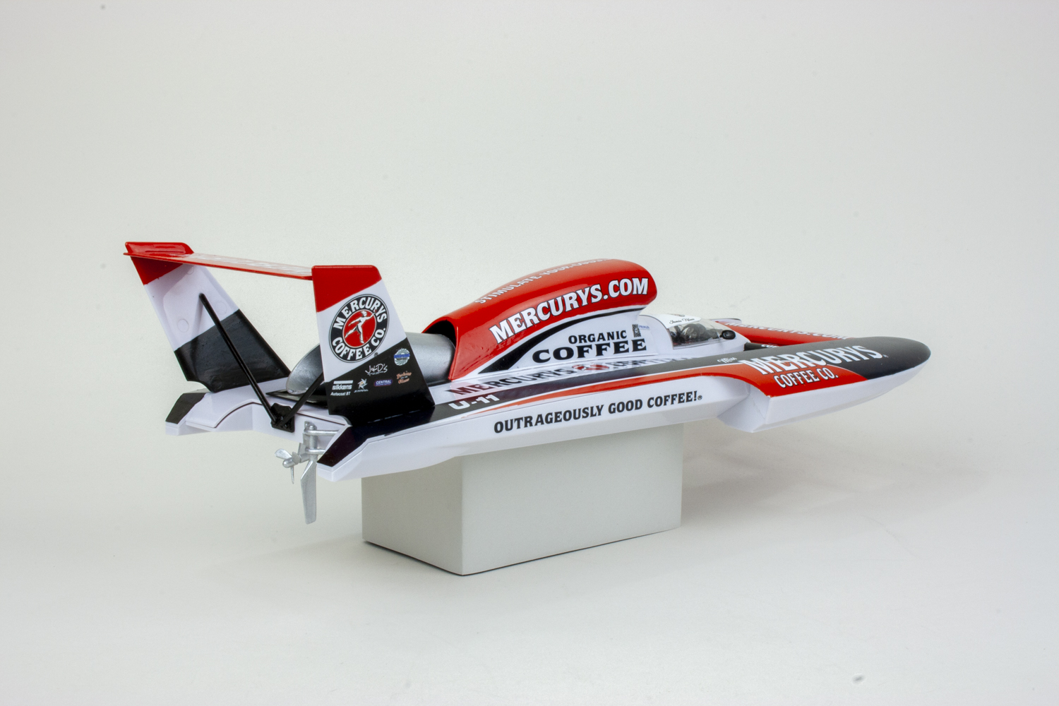

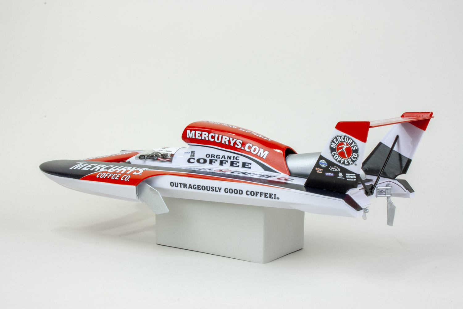

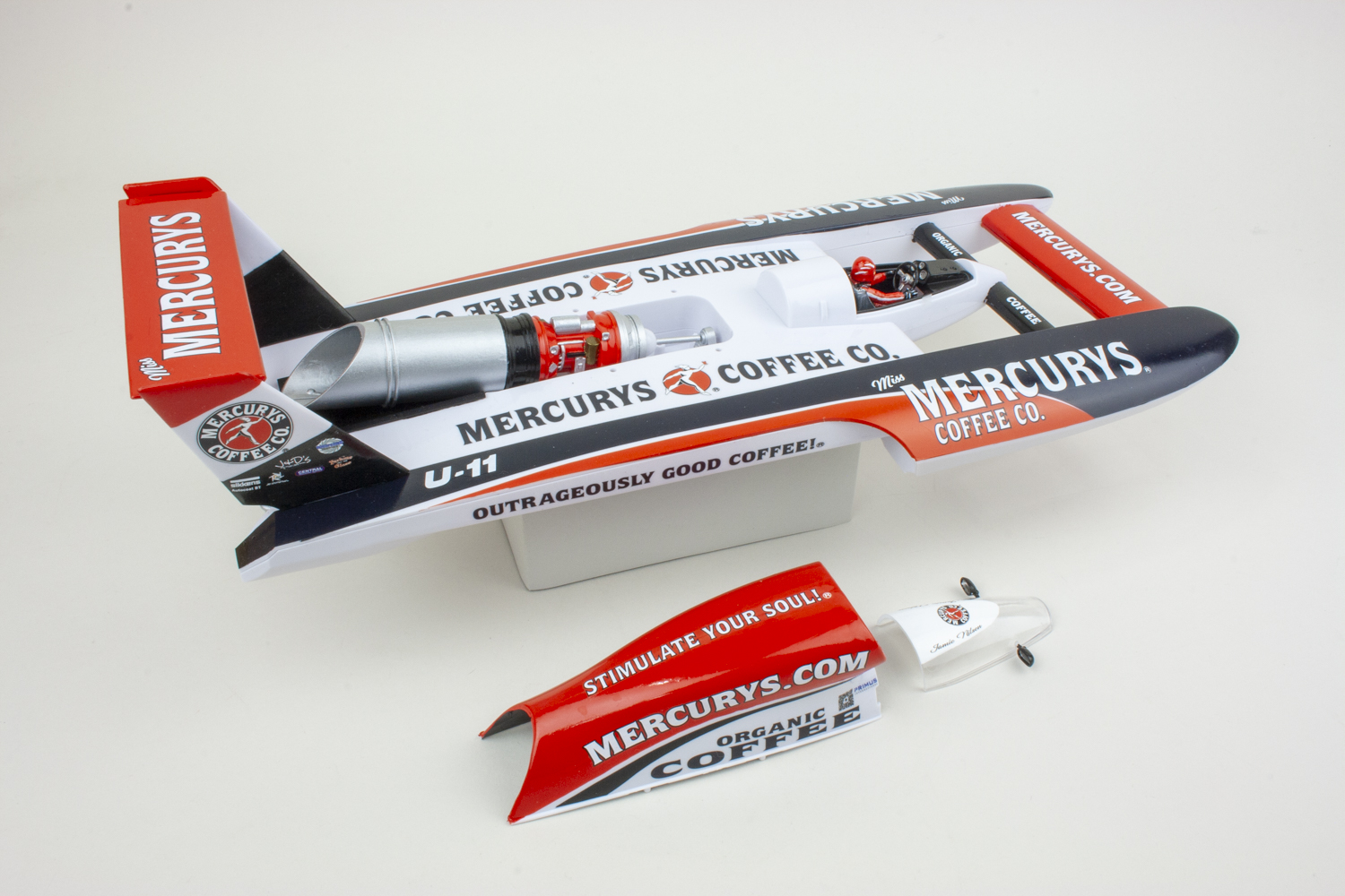

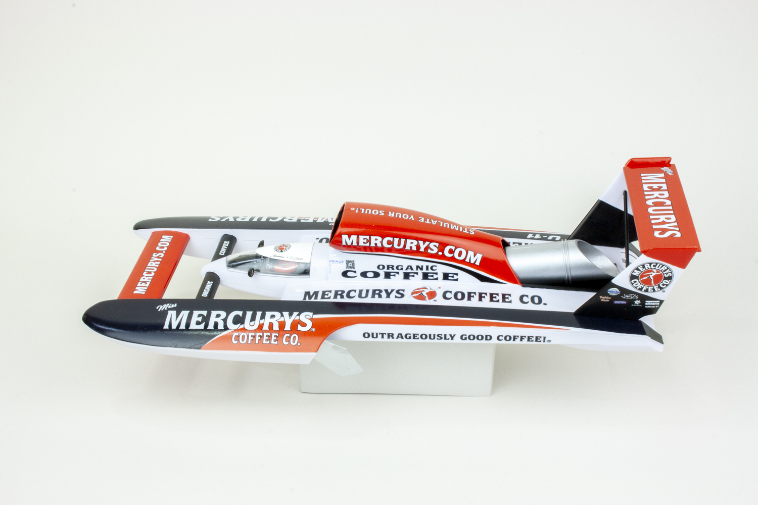

Mercurys Coffee Company is a new sponsor for the 2024 season, with veteran driver Jamie Nilsen at the wheel. I chose to build my model as Miss Mercurys Coffee because the striking graphics are on a white background, the color of the bare kit plastic. In the spirit of building the kit as DA International intended, I suppressed my contest modeler urges and built the kit as a novice would: No spray paint, airbrushing, or even masking, and I did not fill in ejector pin marks. The model is supposed to be a quick, fun build, so that’s how I did it.
The plastic is firm, and sands and trims well with a hobby knife, and the hull surfaces are a nice glossy white, perfect for my no-paint approach. Typical modeling solvent cements, such as Tamiya and Testors, did not create strong plastic welds, but the model held together fine. I used superglue for extra strength where the vertical stabilizers attach to the wing. The kit includes a sturdy, crystal-clear, laser-cut acrylic plastic display base and an electronic sound card, speaker, and switch for audio effects, as well as acrylic paint, brushes, and a small tube of glue.

The hull halves snap together with a minimal gap around the perimeter, but glue and clamps minimized gaps at the front canard wing and cockpit spar. The driver scales out to about 1/43 scale, so a 1/25 scale driver would be a good upgrade when I build a second kit.

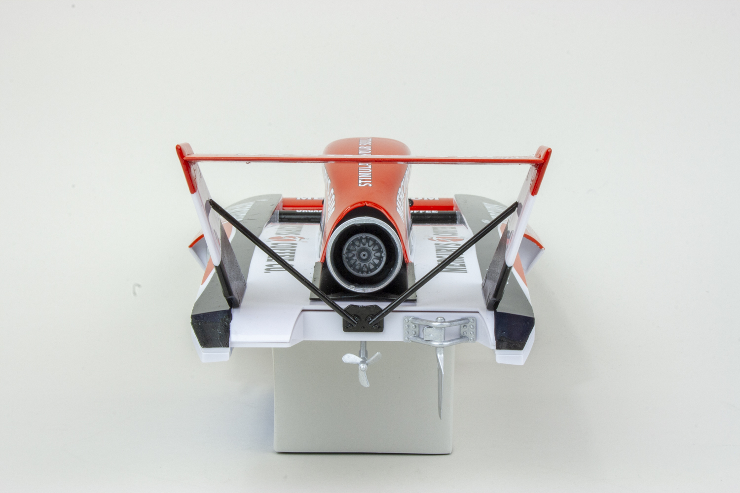

The Step 3 illustration shows the relationship of the engine, driveshafts, and gearbox, and those are assembled into the hull in Step 4. I left off the exhaust nozzle cover (Part C8) because the photo on the box does not show this part on Miss Mercurys Coffee.

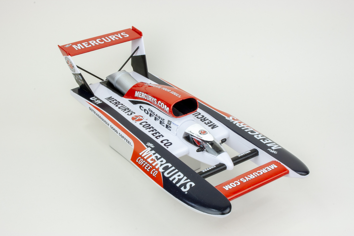

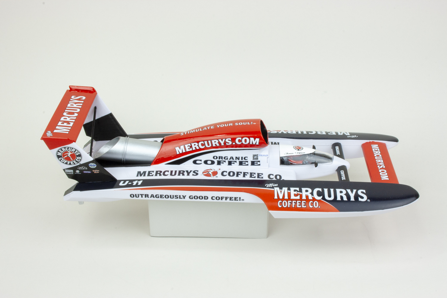

The kit paints did not include a match for the red-orange on the decals, so I mixed my own with Testors enamels and brush-painted parts of the front canard, rear wing, fairings, and cowl. The exhaust heat shield, cockpit, and fairings were painted with the kit’s semigloss black, the engine red-orange, black, silver, and gold, and the exhaust nozzle with Tamiya Chrome Silver. I painted the top of the canopy gloss white to represent the cockpit hatch.
The decals are strong and respond well to setting solution and a hairdryer. The black stripes on the hull are 14 inches long, and I may have used too much solvent, resulting in a few small wrinkles. Instead, cut the long decals to make them more manageable and take it easy on the setting solution.
Leave the turning fin, rudder, and propeller shaft loose until the end of the build because you’ll want the model on a flat, stable surface to install the wing and its vertical fairings. I removed material from the locating pins on the wing strut mount (Part B3) so that it could move to compensate for the strut length and attachment to the fairings during installation.

DA International’s Unlimited Hydroplane plastic boat kit is great! It’s big, excellent value, and an exciting subject. Though the kit is simplified for a fun, quick build, the potential is there for a truly unique contest-quality entry, and the team markings yield a handsome model.
