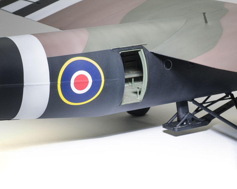

Bronco’s kit opens up numerous diorama possibilities, given how many kits of vehicles and figures are available in the same scale. Despite the Horsa’s relative simplicity, Bronco included plenty of detail. The cockpit is missing only wiring and plumbing. The cavernous troop cabin includes optional seats to fit along the sides, stepladders, and hanging straps.

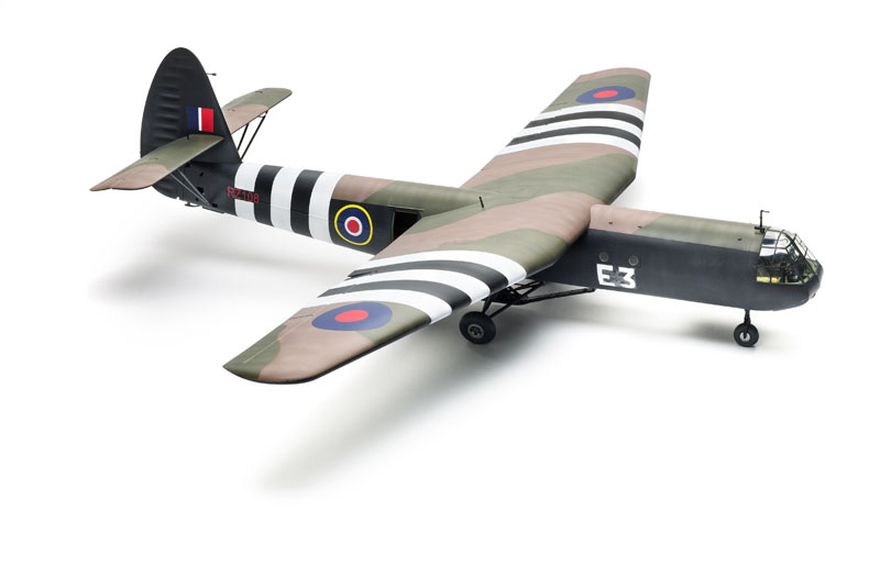

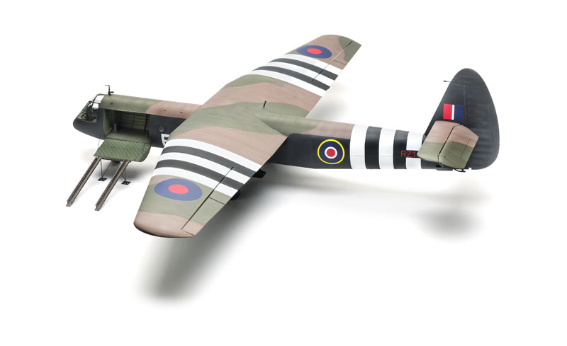

Decals provide markings for three gliders, all in identical Royal Air Force camouflage with invasion stripes. The stripe dimensions and placement vary slightly, so pay attention when choosing. The instructions incorrectly call for Tamiya dark yellow (XF-60) for the brown; it should be flat earth (XF-52). Also, the marking profiles show the RAF fin flash facing the same way on both sides. But the red portion should always face to the front of the aircraft. No detail color callouts are included.
The large fuselage comprises multiple sections. Decent fits aid assembly of the large plane, but care and clamps are needed to prevent gaps.
Numerous large ejector-pin marks complicate construction. They are easy to remove if you find them before applying glue; test fit, trim, and test fit again.
I didn’t join the fuselage frames to the floor as suggested in Step 5. Instead, I combined steps 5 and 6, trapping the frames between the floor and the lower fuselage, which includes alignment slots.
Don’t forget to install the nose weight. It’s just barely sufficient to keep the tail up.
You’ll need to open holes in the floor for seating in the forward half of the fuselage; they’re present in the aft section.
The instructions warrant careful study. Precise part placement can be hard to discern from the drawings. For example, I never figured out how part C30 fit. (It can’t be seen anyway!)
Step 17 shows the struts for the stabilizers fitting an incorrect hole in the fuselage, but the next drawing shows the right spot.
Before painting, decide which cargo door option to use. And don’t forget to install the overhead frame supports before attaching the roof. Ask me how I know!

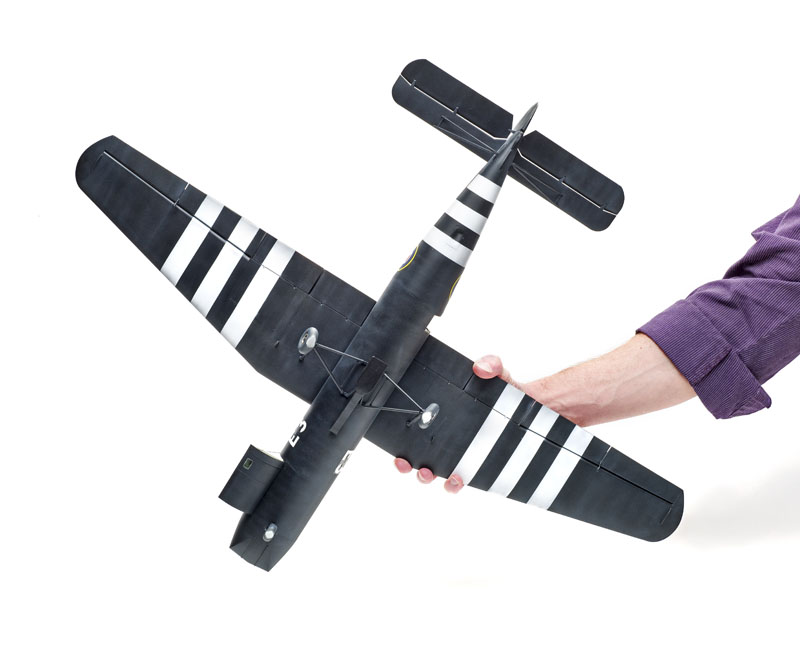

Because of the model’s size, I left off the outer wing panels until after the center section was mounted on the fuselage. That allowed for easier handling while cleaning up this critical connection. Once the roots were secure, it was a snap to level the wings.

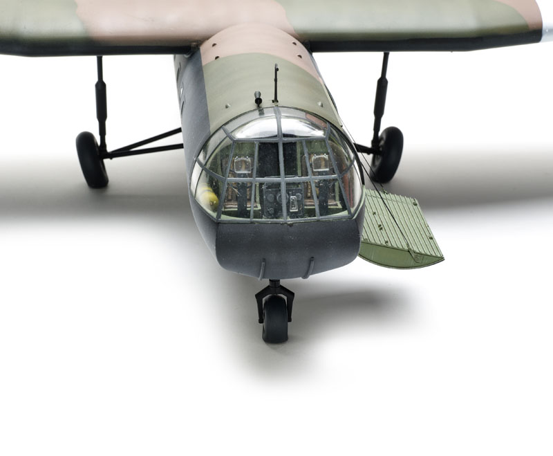

Bronco includes masks for both the inside and outside of the windscreen and cabin windows, but many of them are slightly undersized.

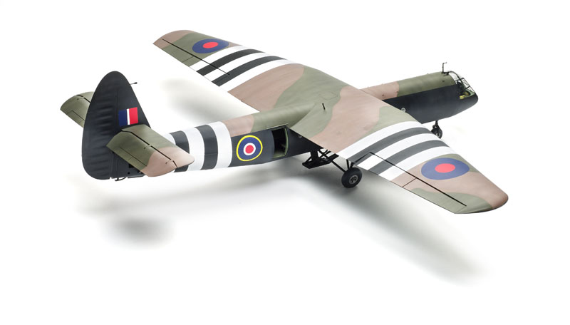

I painted the underside of the extensive airframe with Tamiya spray-can semigloss black, then airbrushed highlights with Tamiya dark gray. To paint the upper camo, I made paper masks by enlarging the  instructions on a copier.
The decals went on OK, but I encountered silvering around the fuselage numbers.

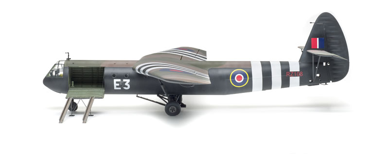

After flat-coating the beast, I attached the cargo door so it was level with the included ramp, and added support wires using EZ Line.
