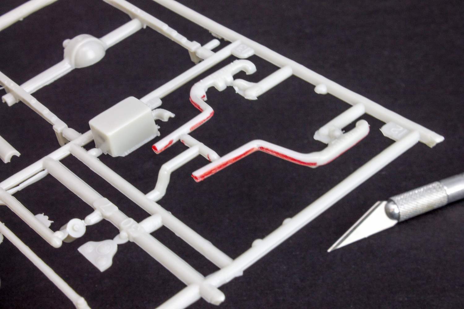

I use Tamiya side cutters (No. 74123) to snip styrene parts from the parts trees (also called runners, frames, and sprue) in plastic car model kits. Always align the nippers so the smooth back edge of the jaws faces the part you plan to remove.
Only a small amount of the sprue gate will remain, and it can be cleaned up with a sanding stick or a hobby blade.

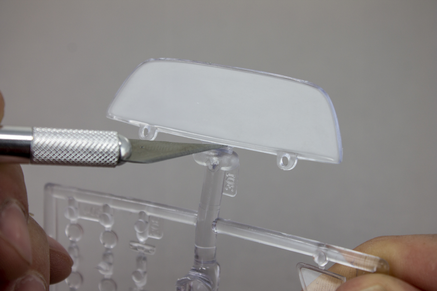

Clear plastic parts, like windows, can be brittle and may crack because of the stress of side cutters. In these instances, I use a hobby knife instead and repeatedly pull the No. 11 blade through the sprue gate. You can achieve a similar result with a razor saw.

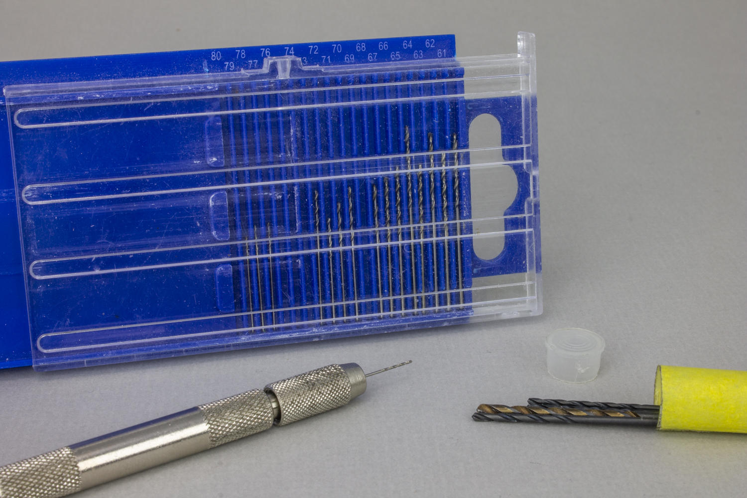

Sometimes, locator holes for joining two parts are too small, partially covered, or nonexistent. You can open the holes with the tip of a sharp No. 11 blade, or you can enlarge one with a micro-drill bit in a pin vise. Note that a pin vise can be a useful tool as you gain experience, especially when you decide to enter the world of engine bay detailing, distributor wires, brake lines, and carburetor linkages.

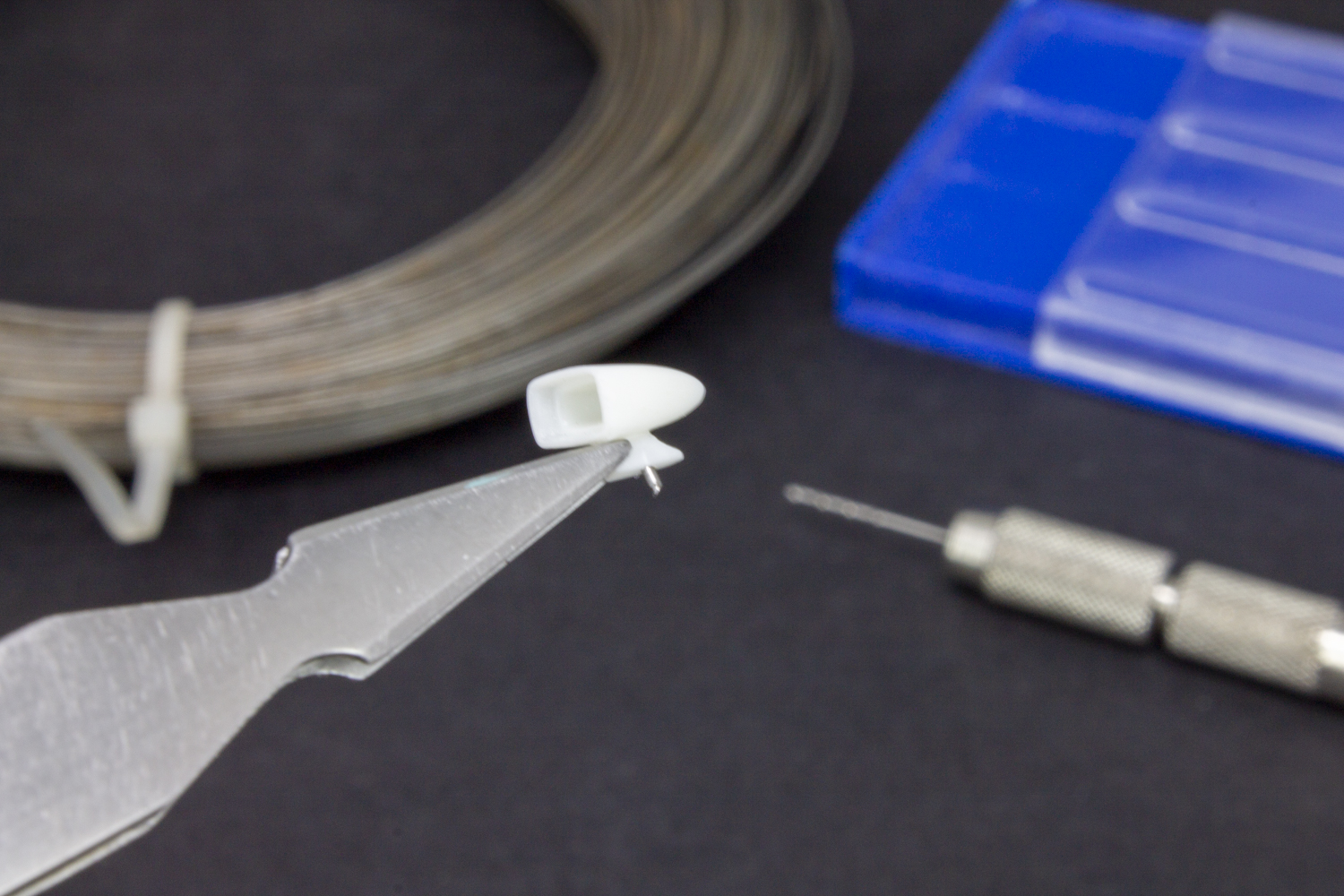

Another use for a pin vise is drilling a hole to pin small parts that don’t have good attachment points, like side mirrors. Drill a hole in the mirror to accommodate a .024-inch diameter metal pin (piano wire or brass rod works). Drill a corresponding one on the body where the mirror belongs and glue the part in place.

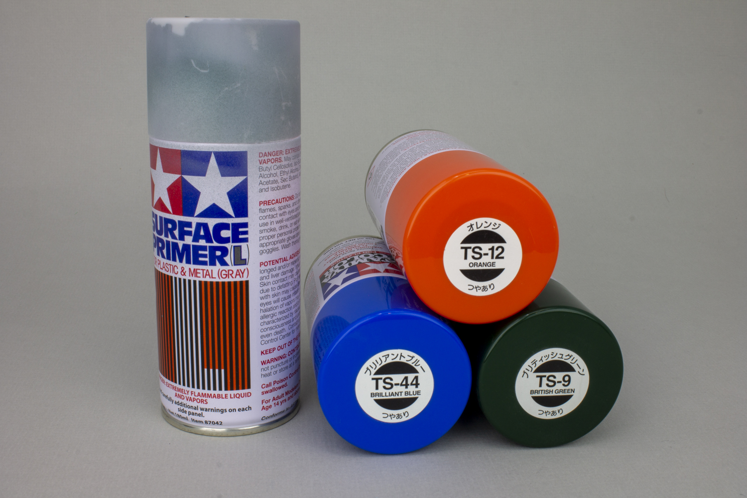

Primer is recommended to help reveal any imperfections on the car’s body and to promote better adhesion of paint. Hobby paints are recommended because they are formulated specifically for use on plastic, although some automotive paints work, too. One rule of thumb is to stick with the same brand and line of paint to avoid mishaps. Tamiya primer and lacquer paints are readily available from hobby shops and online and work well. Priming the other subassemblies (engine, interior, suspension, etc.) is less critical and up to you.

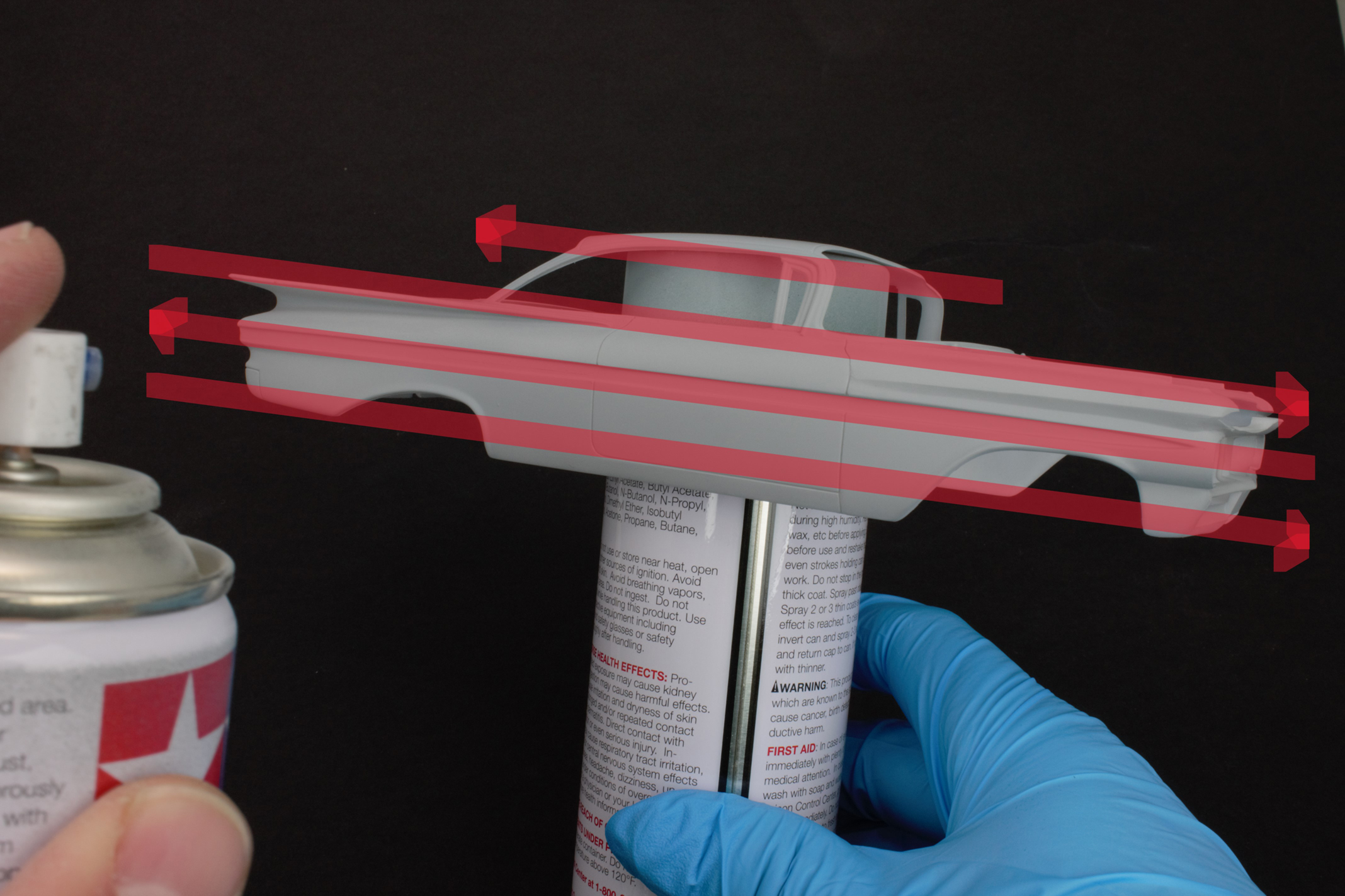

When spray painting the body, I like to work from the bottom up in a snaking path until I reach the roof and repeat on the other side. I then spray the trunk, roof, and valances. Always begin and end the paint flow pointed away from the body, not directly at it, to avoid paint spatters. Typically, two or three coats of primer should sufficiently cover the body. If it feels too heavy or too light, experiment with the pace of your passes or the can’s distance from the model, which should be 6 to 8 inches.

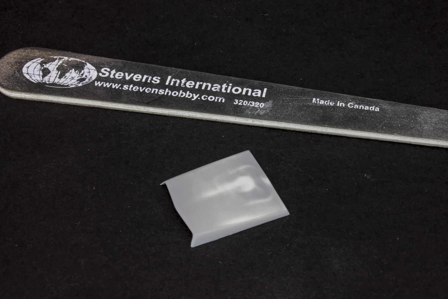

After the primer coats, sanding with a 320-grit stick can eliminate imperfections you couldn’t see in bare plastic. This hood scoop should be perfectly smooth with a slight crest running down the center. The molded detail from the underside crept through and can be corrected with putty, sanding, and re-priming.

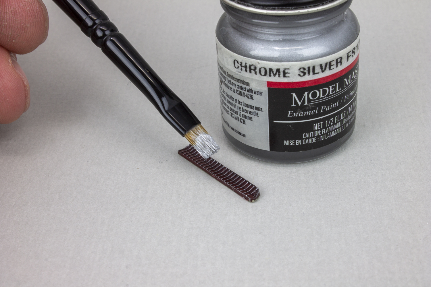

These Cougar taillights beg for dry-brush detailing. To use this technique, I dipped the brush into chrome silver enamel and wiped off the brush on a paper towel until most of the paint was removed. Then, with the brush at a low angle, I lightly drew the bristles over the raised portions until they were covered to my liking.

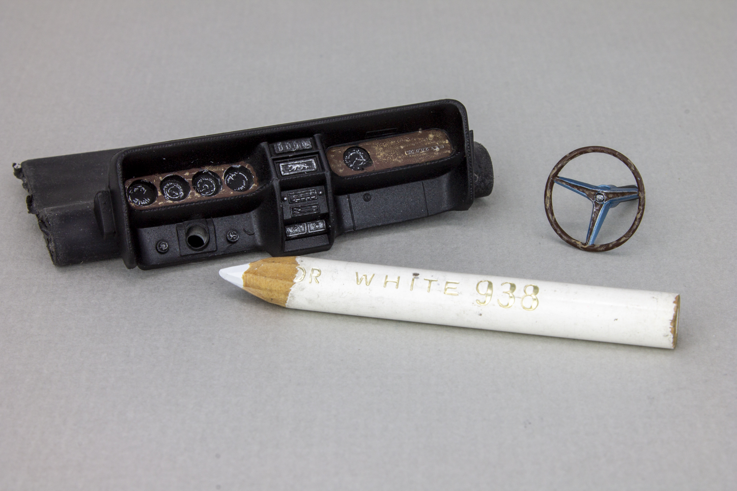

While many modern kits include decals to replicate gauge faces, there is a quicker, simpler option: drag a sharp, white, colored pencil over the top, molded gauge detail. Do the same with a red or orange colored pencil for the needle.

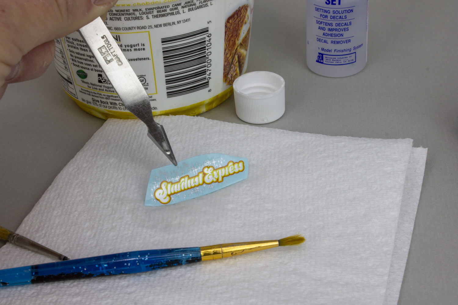

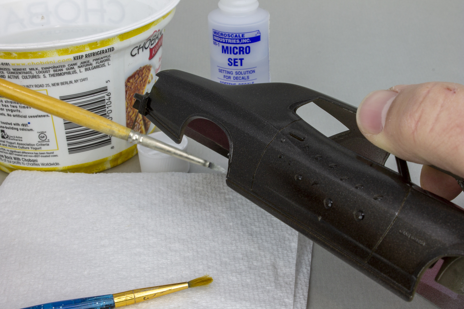

Most plastic model car kits include water-slide decals. Trim the decal as close to the clear carrier film as possible using a pair of sharp scissors. Place the decal into a container of clean, room-temperature water for about 20 seconds. During that time, dab setting solution like Microscale Micro Set onto the desired location with a paintbrush.

Remove the decal from the water and rest one edge against a paper towel to wick away excess water. With light pressure from your thumb, check to see if the decal is ready to slide. Carefully and slowly slide the decal toward the edge of the backing paper.
FSDBC0323_20
Grip the decal with tweezers and place it on the model. The setting solution you added earlier breaks the water’s surface tension and allows it to settle against the model’s surface. If you need to move the decal, add a little water around the edges with a soft paintbrush and maneuver it into position.
FSDBC0323_21
When you’re ready to anchor the decal, touch the paper towel to its edges to wick away most of the remaining water and setting solution. Check for any remaining moisture bubbles and draw them out toward the edges of the decal with a paper towel, a thick paint brush, or a cotton swab.
