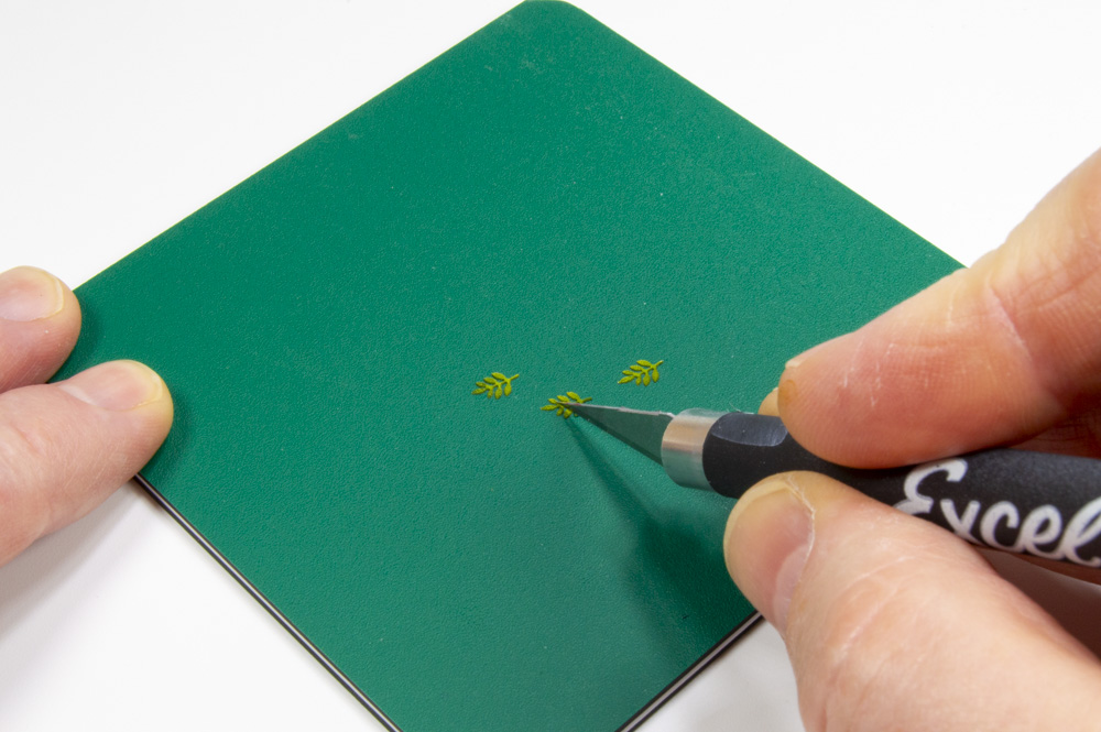

Don’t be afraid to modify the parts. For me, these were too short to individually model the ferns I envisioned. I cut the top leaf off two or three pieces, making sure to save them for use later.

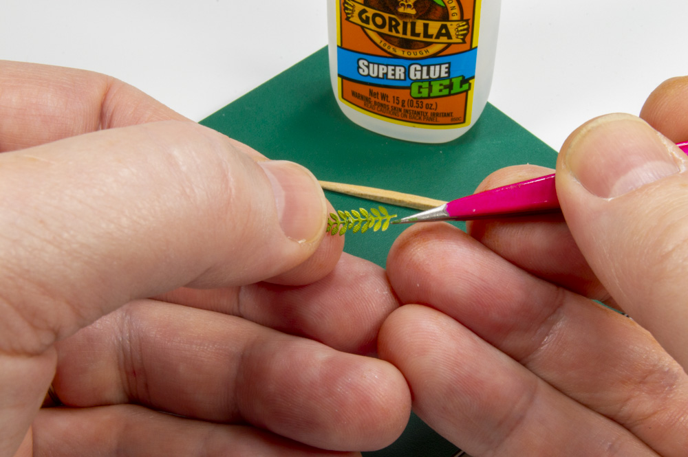

Taking three modified leaf sections, I glued them together with gel superglue. Depending upon what materials you are using, you may need to use more or fewer parts. Let your references be your guide.

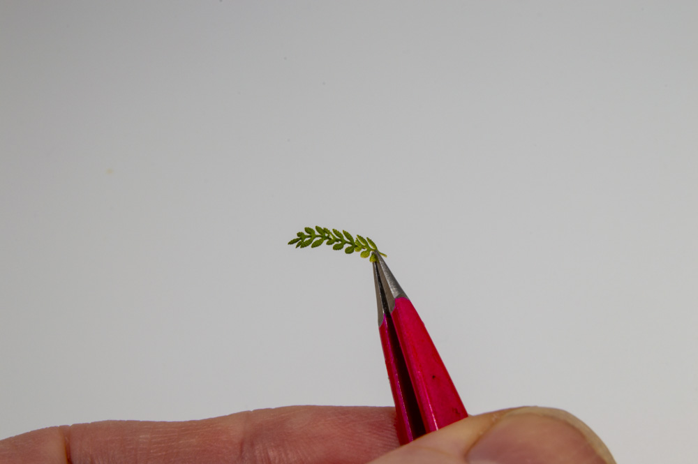

Here is the fully assembled frond. Now, go back and make as many as you need.
Drill small holes in your figure or diorama base where you want to plant your ferns and glue a few fronds into each. Fan the fronds outward to create the whole plant. Done!
