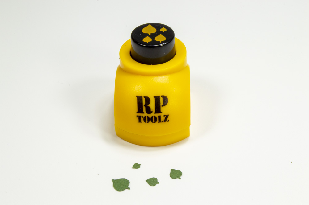

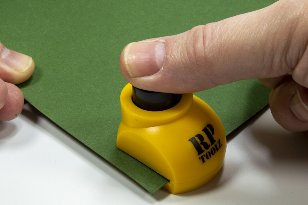

First, you’ll need leaves for your vines. A leaf punch like this one from RP Toolz allows you to make scale leaves quickly. I wanted broad leaves for my scene, so that’s the type of punch I chose. Make a bunch of leaves from construction paper of the appropriate color for your scene.
FSDSNAP061_02
This particular punch provides four different sizes at one time, which is great for quickly producing a bunch of leaves. Yes, technically, these are lime leaves, but the important thing is to have leaves that are believable — oak or maple leaves would look inappropriate on a vine.

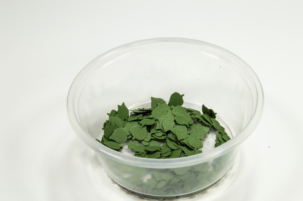

Place your punched leaves in a container that can be sealed with a lid. This will prevent you from accidentally blowing them away with an airbrush or sweeping them off your work surface. Just like real leaves, they will escape otherwise, and you’ll be picking them up all over. Yes, I did just that!

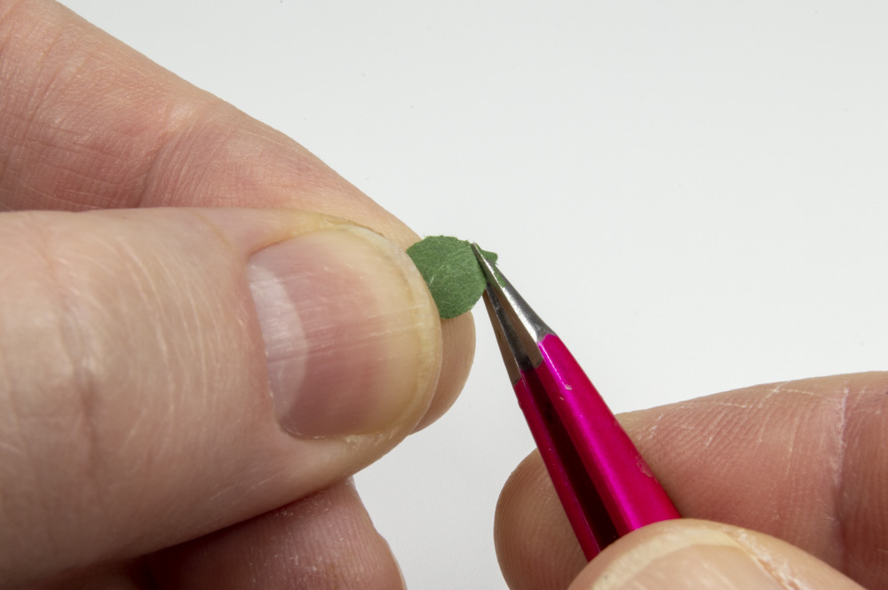

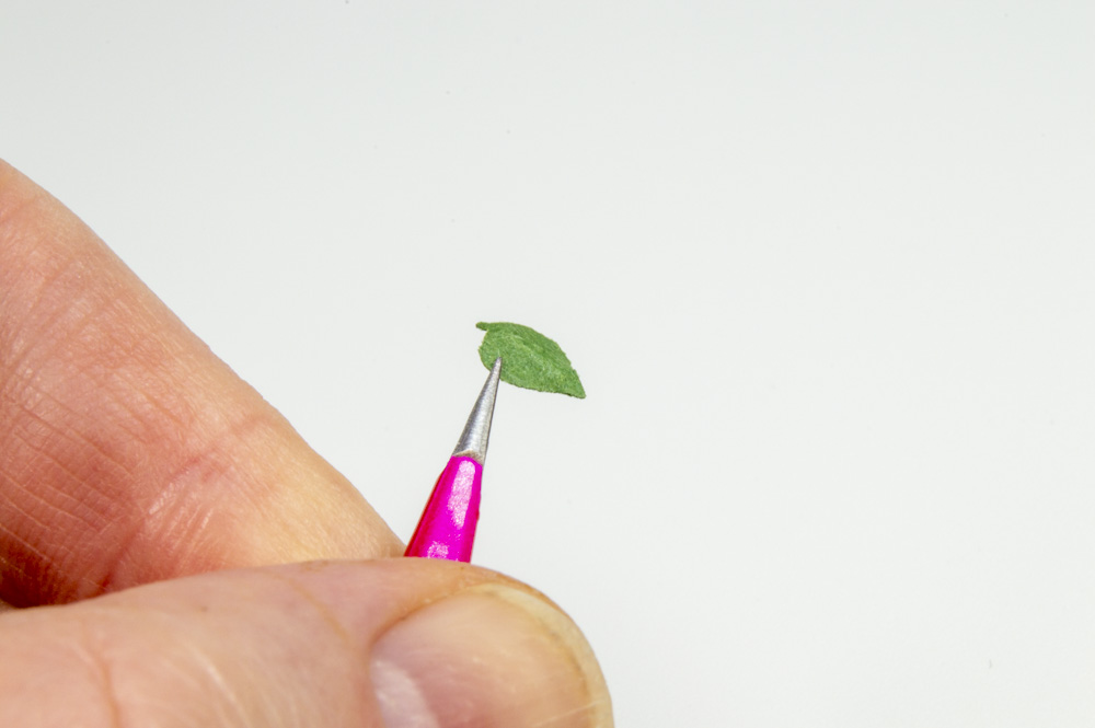

For my vine, I used the smallest leaves from the punch. Crease the middle of each leaf with a sculpting tool or other tool that has a straight edge but isn’t so sharp it will cut the leaf in half.

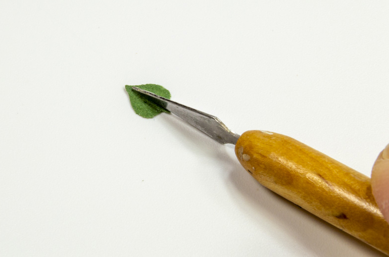

Then bend the tip and stem ends of the leaf with tweezers to achieve a more naturally curved shape. Does it take a while? Yes, but the finished model will be worth the time and effort.
