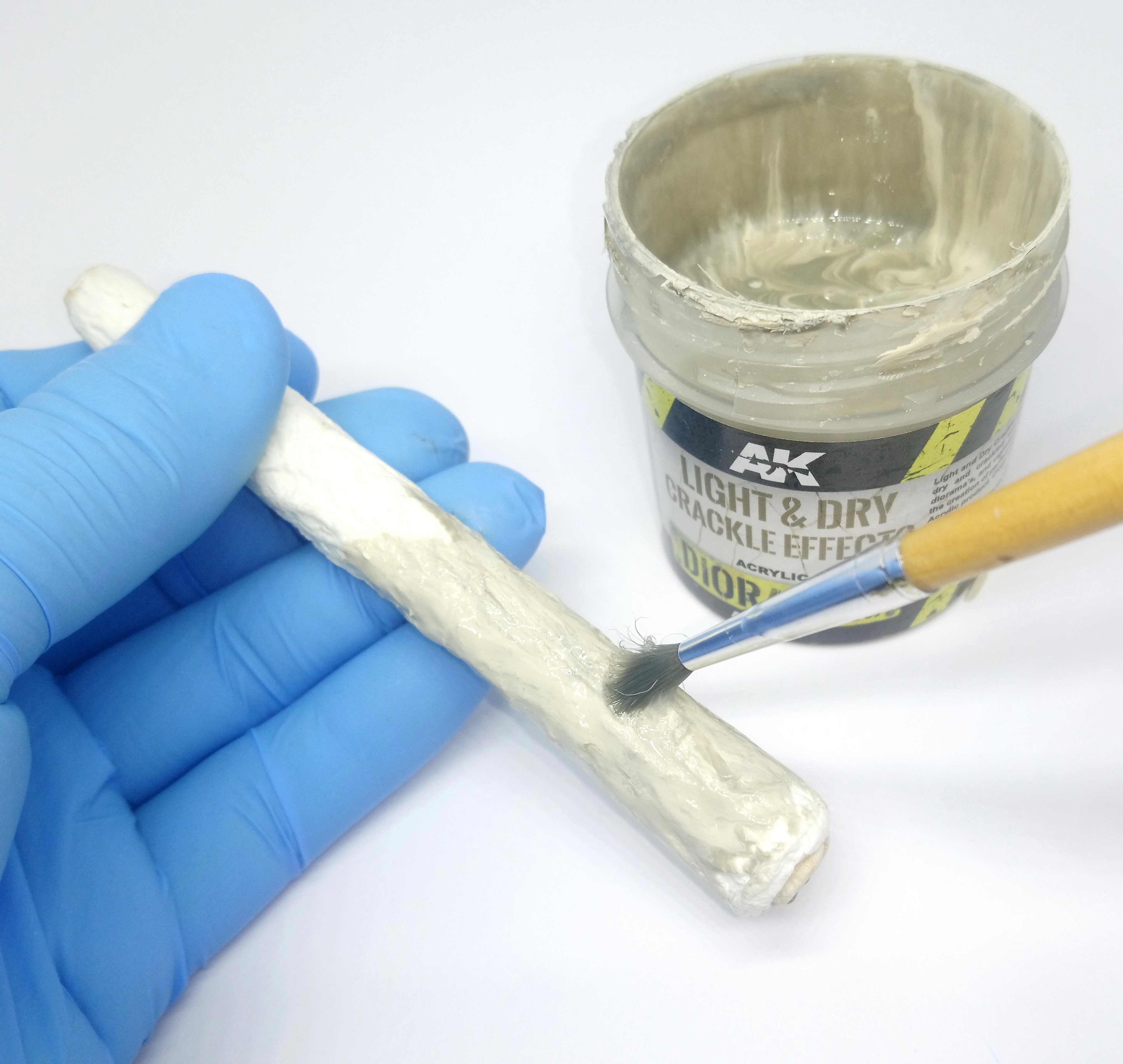

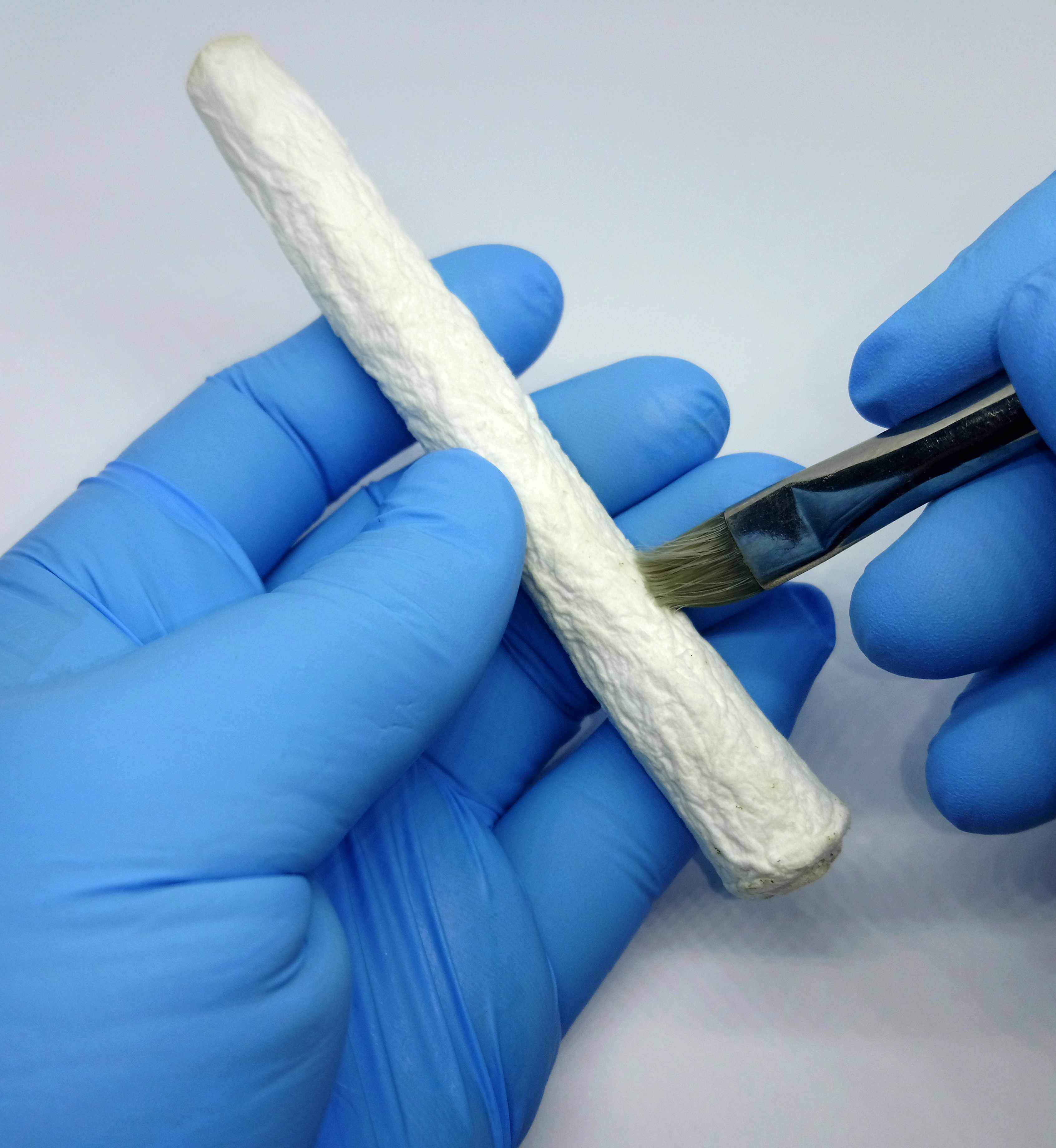

For trees with larger trunks, make a core (balsa wood works well) wide at the bottom and tapered toward the top and wrap it in tissue paper soaked with white glue.
FSDSNAP048_02
After the tissue and glue have dried, apply AK Interactive Light & Dry Crackle Effects (No. AK8033) with a wide, flat brush. When the acrylic paste dries, it will have a naturally cracked surface, like the bark of a maple, oak, or similar tree.

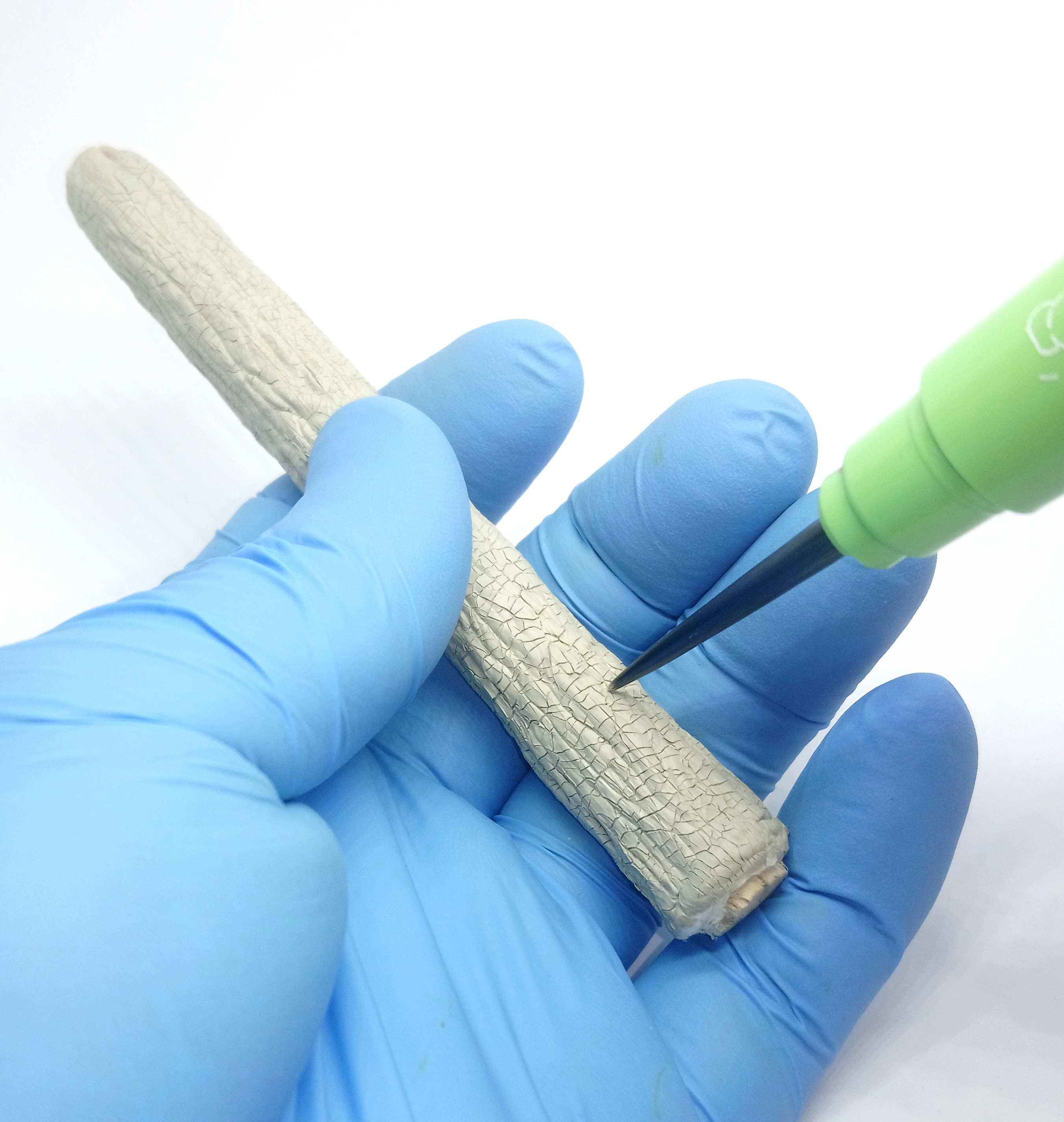

Use a scribing tool to create realistic contours in the bark running vertically along the length of the trunk. This further simulates a tree trunk’s naturally undulating surface.

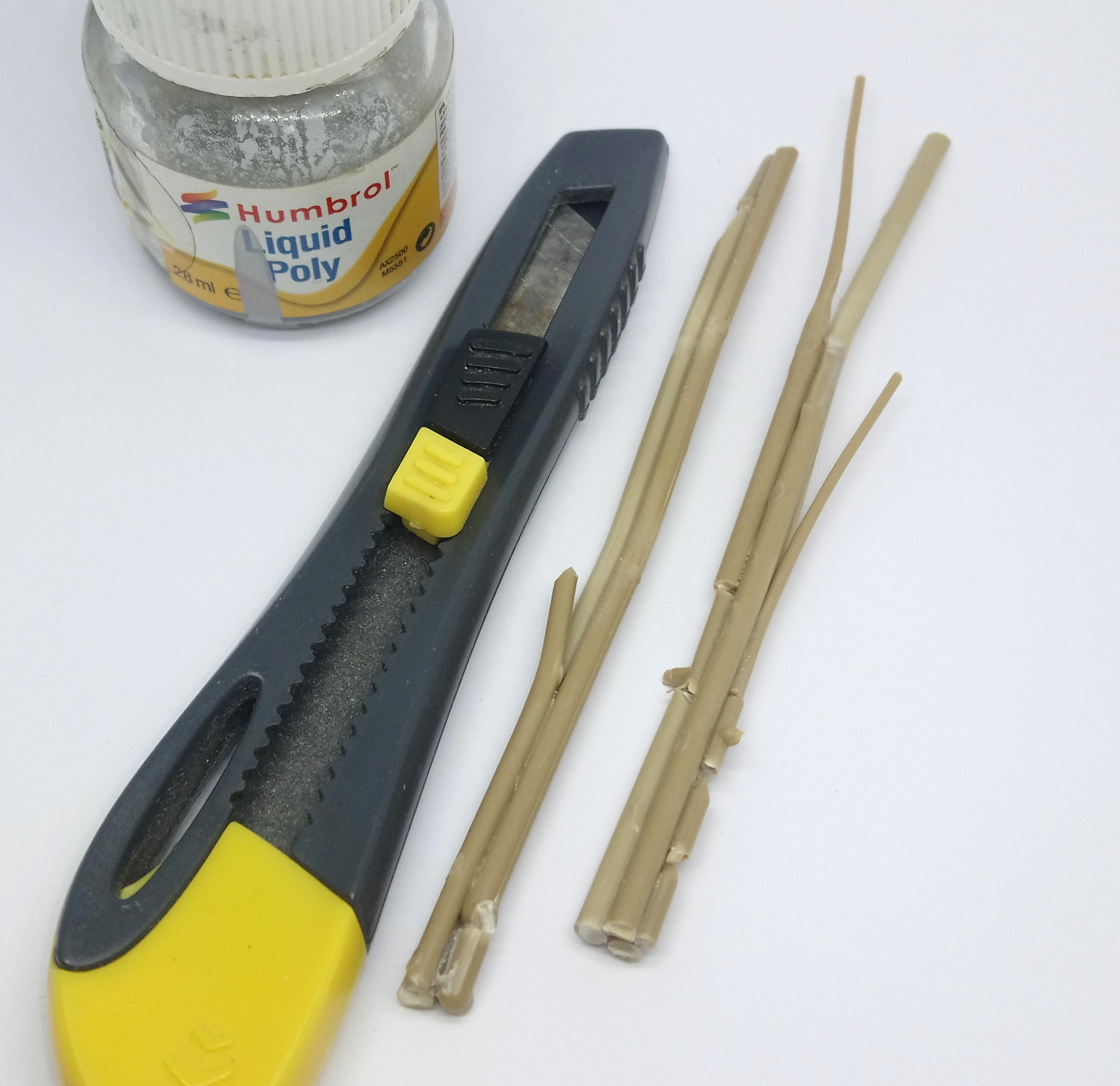

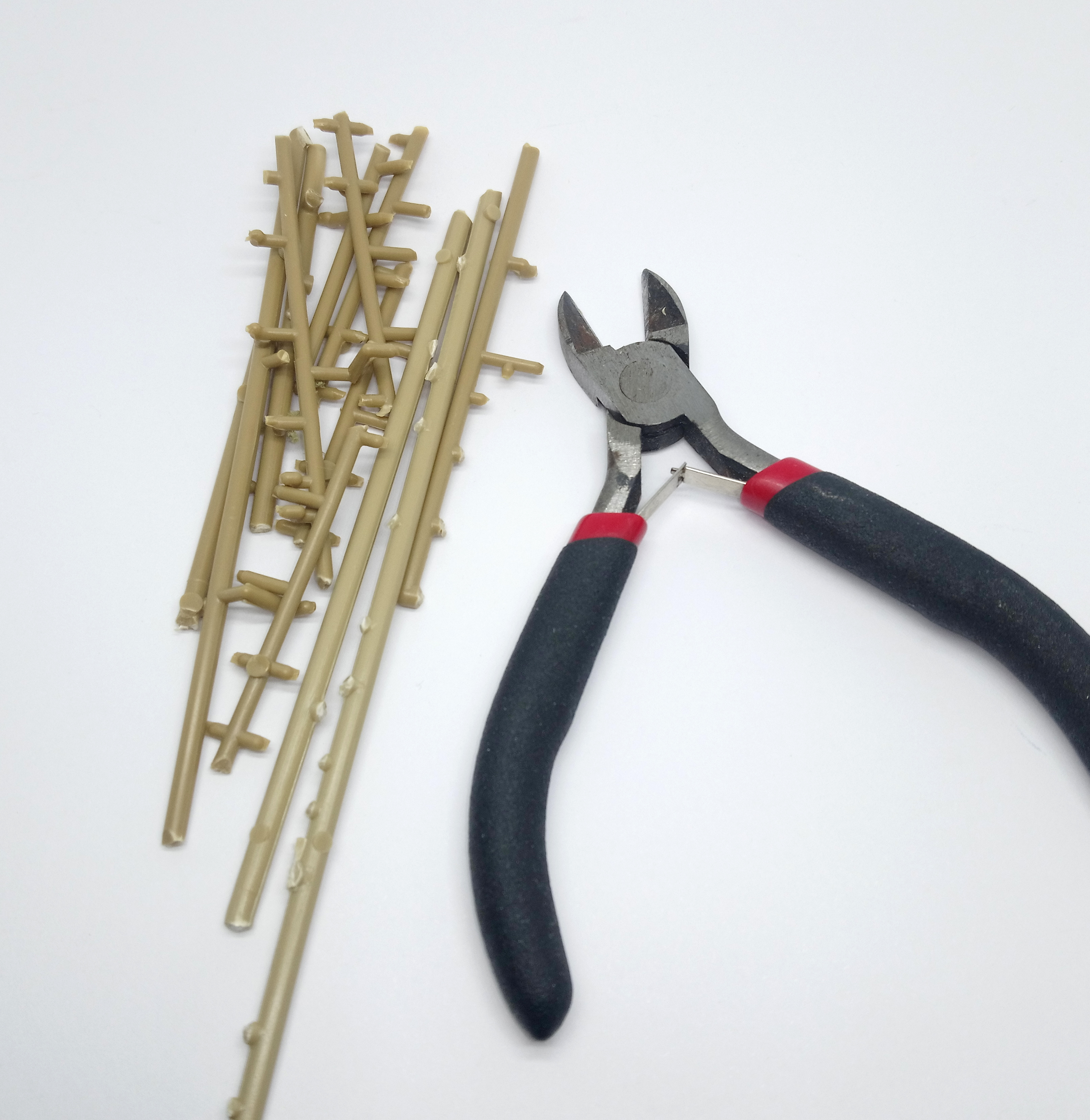

If you need trees with thinner trunks, trim lengths of sprue of any unwanted branches.
FSDSNAP048_05
Glue the lengths of sprue together with liquid plastic cement. Feel free to bend them into natural-looking shapes, or even heat and stretch the ends to get tapers. Be creative!

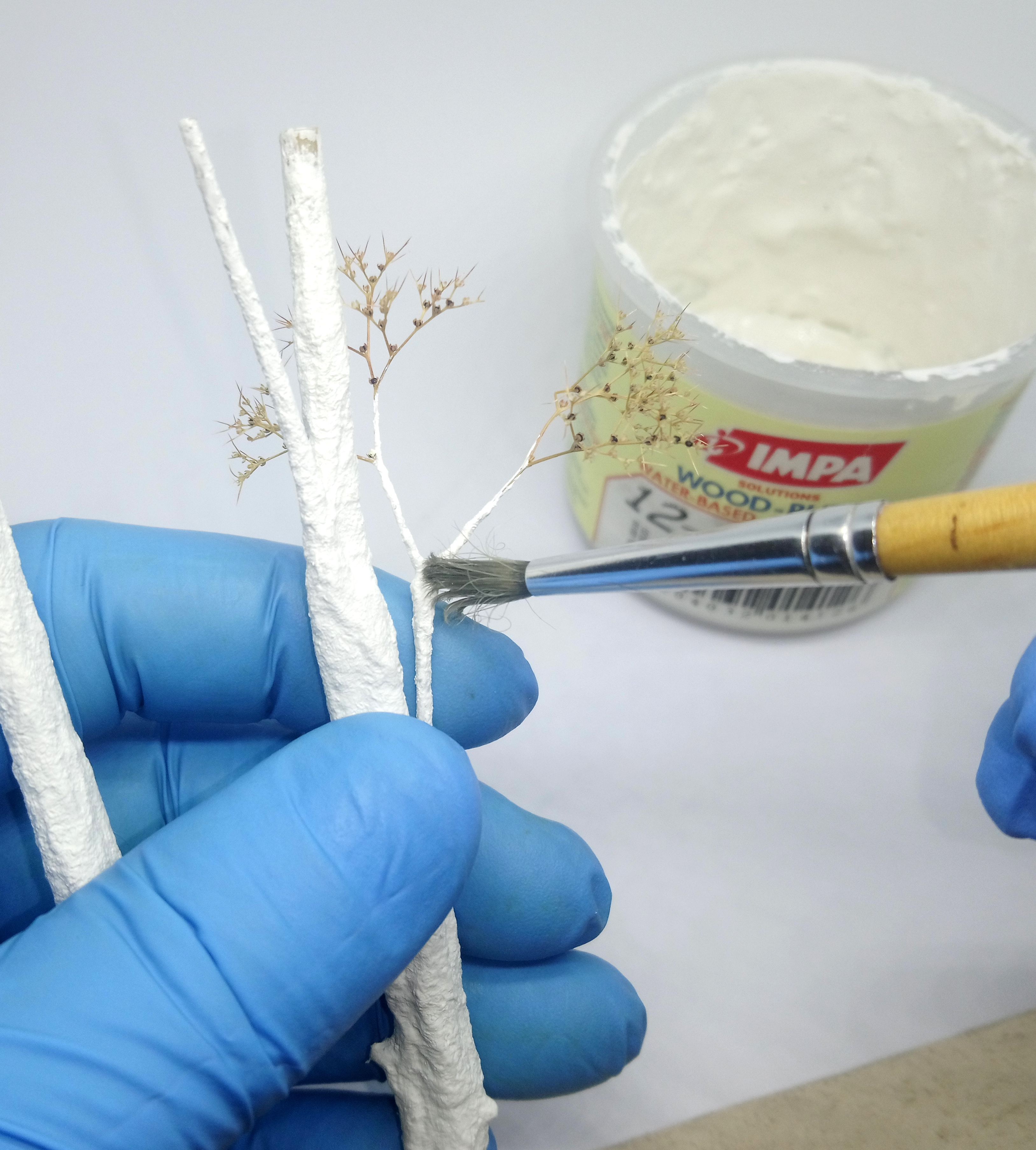

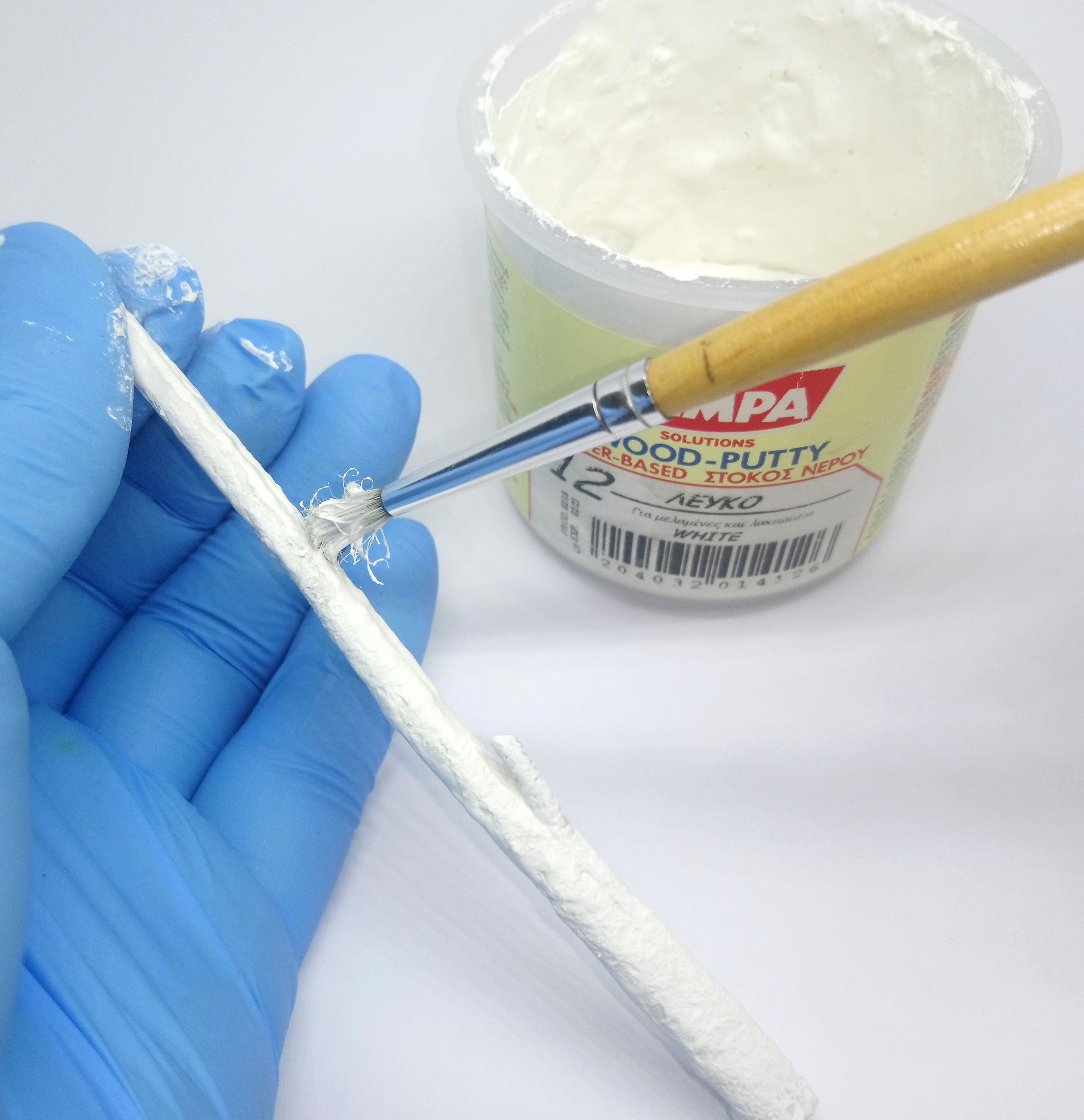

Wrap with tissue and white glue as before and let dry. However, instead of reaching for the Crackle Effects, add texture with water-based wood putty that you can thin and stipple with a brush.
FSDSNAP048_07
Joefix Studio Sea Foam (No. 903) works well to model branches. Superglue pieces in place and then apply wood putty to hide the joins. Of course, you’ll want to paint your tree trunks colors appropriate to the species of tree you’re modeling.

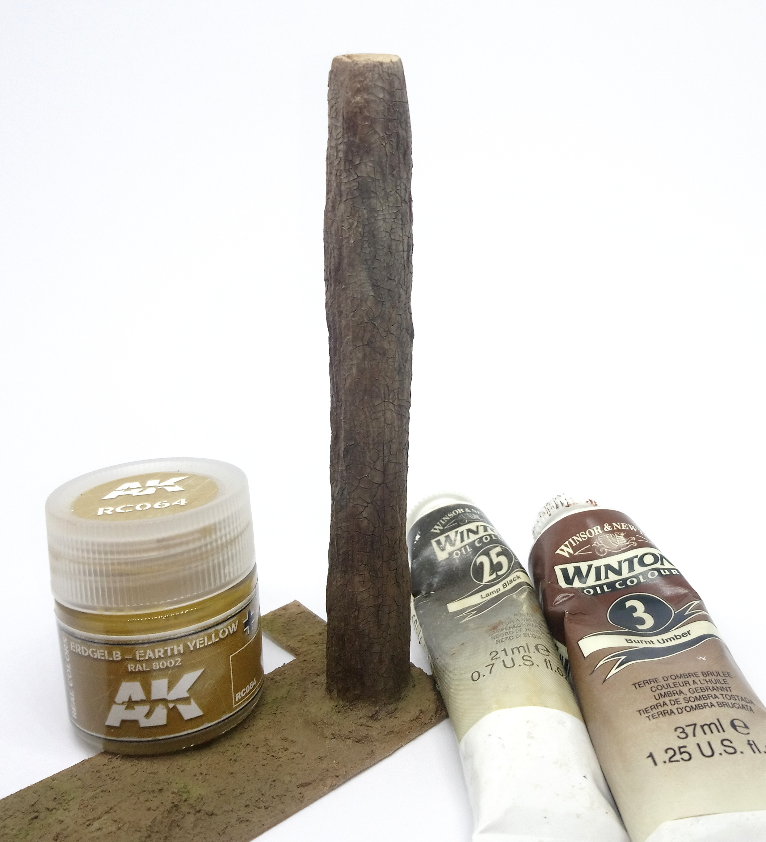

In this case, I painted the larger tree trunk AK Real Color Earth Yellow (No. RC064) and then applied lamp black and burnt umber artist-oil washes. The smaller trees were airbrushed Tamiya Flat Earth (No. XF-52) and then treated with a lamp black wash.

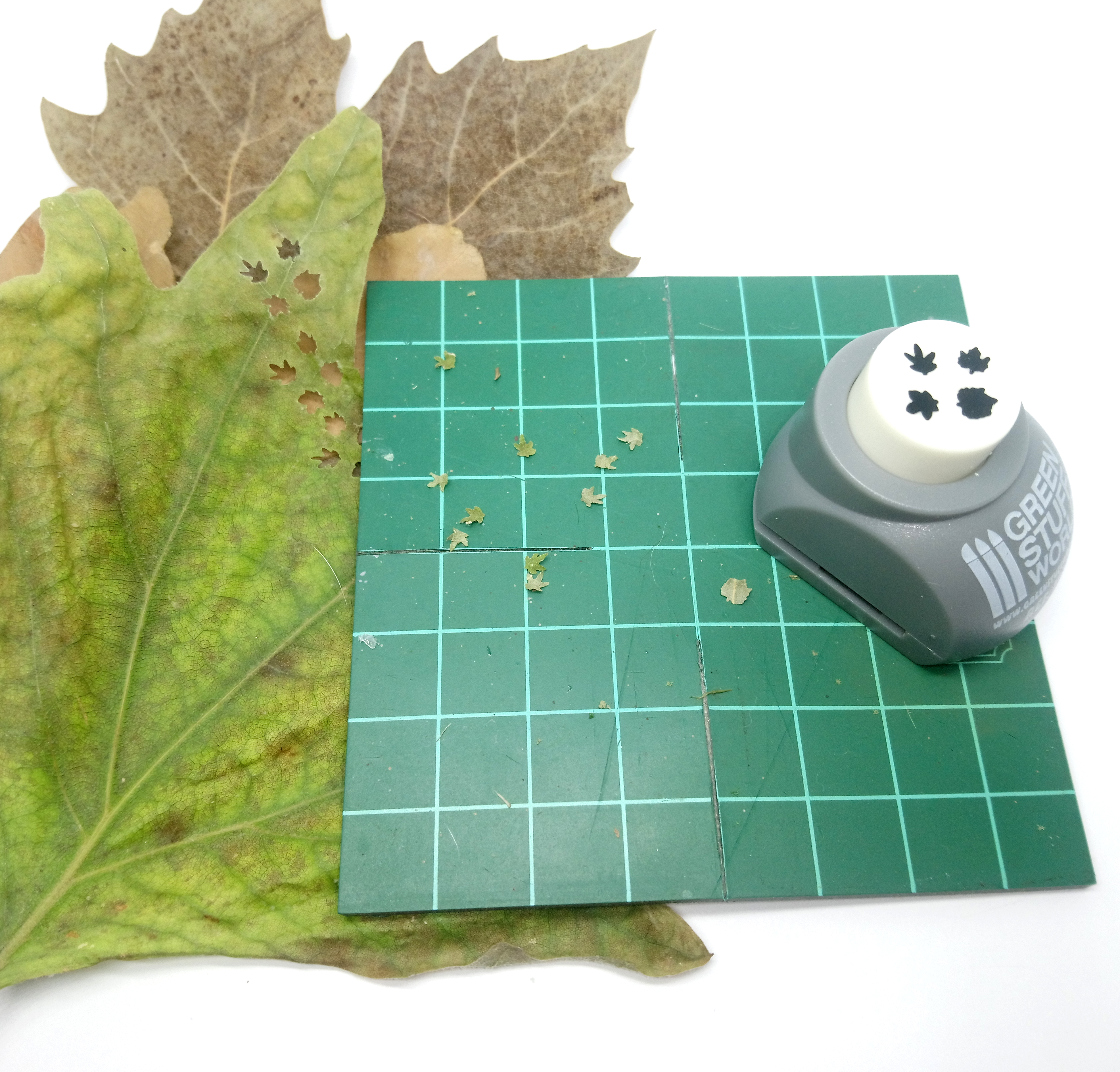

Using a leaf punch, like this one from Green Stuff World, make as many leaves as you can — too many is better than not enough. Although, you can always make more if you need them. I punch them out of fallen leaves that aren’t too deteriorated.
