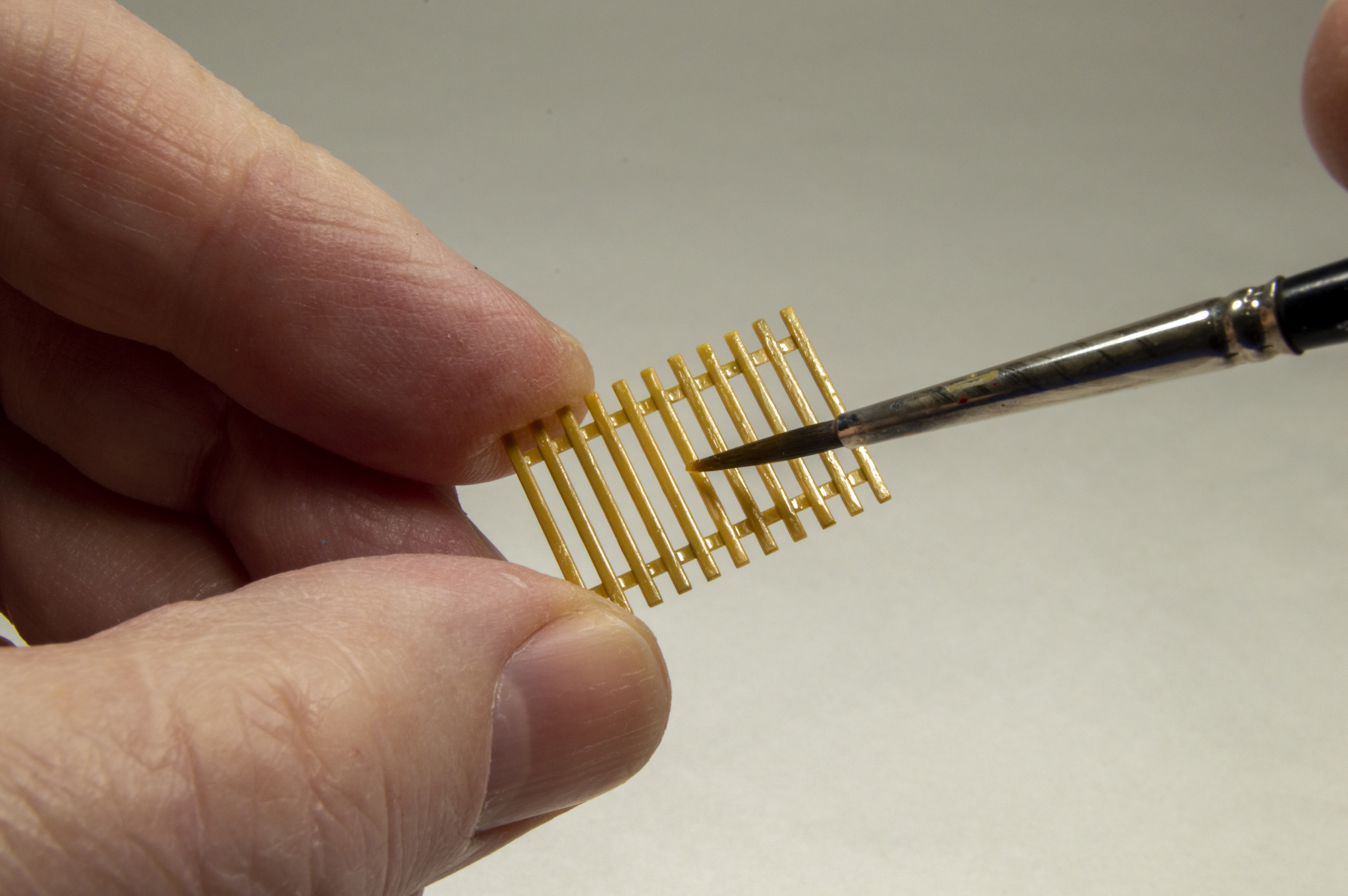

Once thinned, brush the chipping medium onto your pre-painted part, making sure that the base coat is thoroughly dry first. Chipping medium is glossy and will require a few passes with the brush to coat the part. You can see how it beads up as it is applied. Don’t worry: Successive coats will provide even coverage.

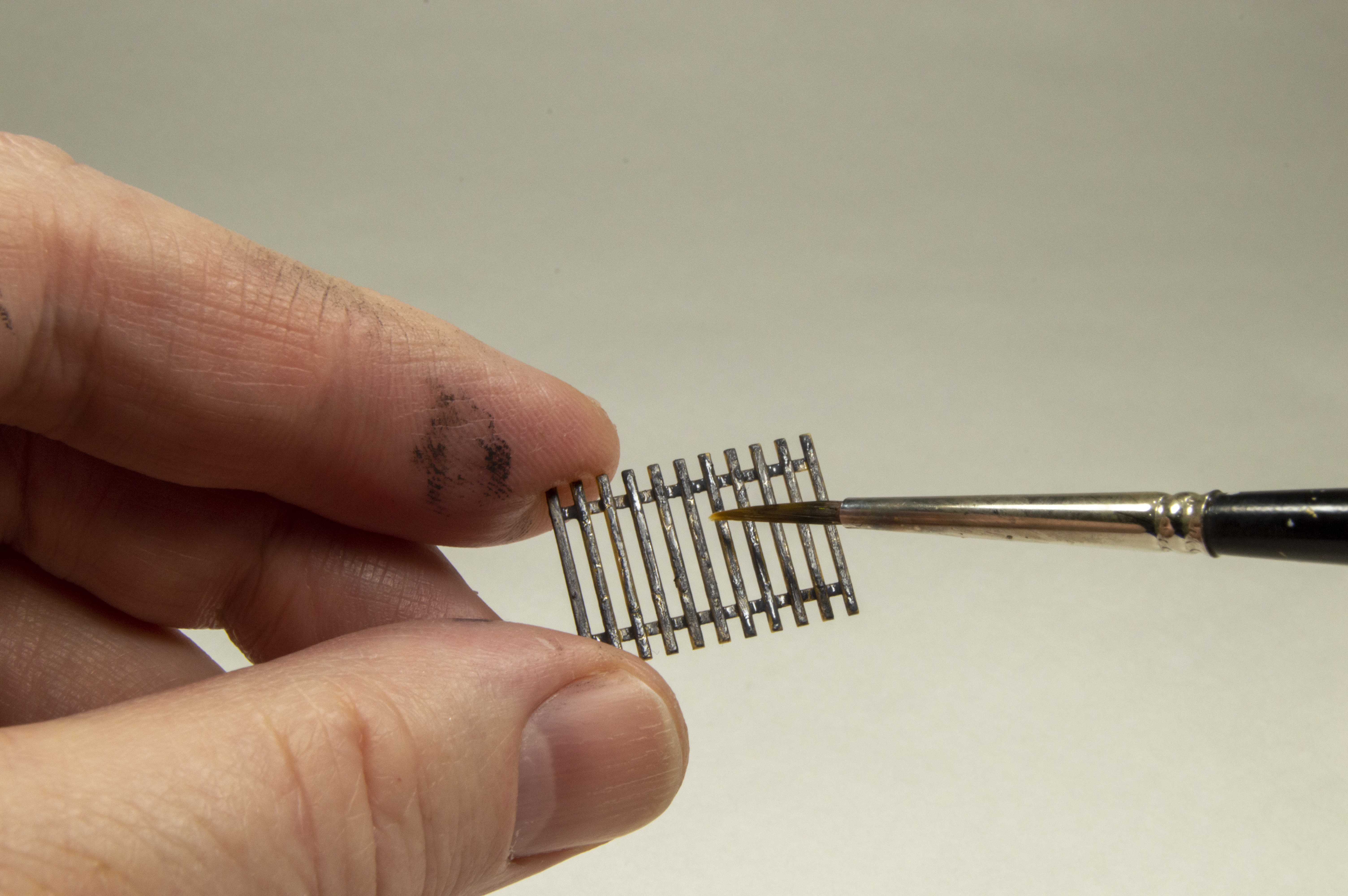

Allow the chipping medium to dry 24 hours. The next coat of paint must be water-based acrylic, like Vallejo, Ammo, Reaper, or similar paint. The top acrylic color does not brush on smoothly or evenly, but that is part of the effect happening already.

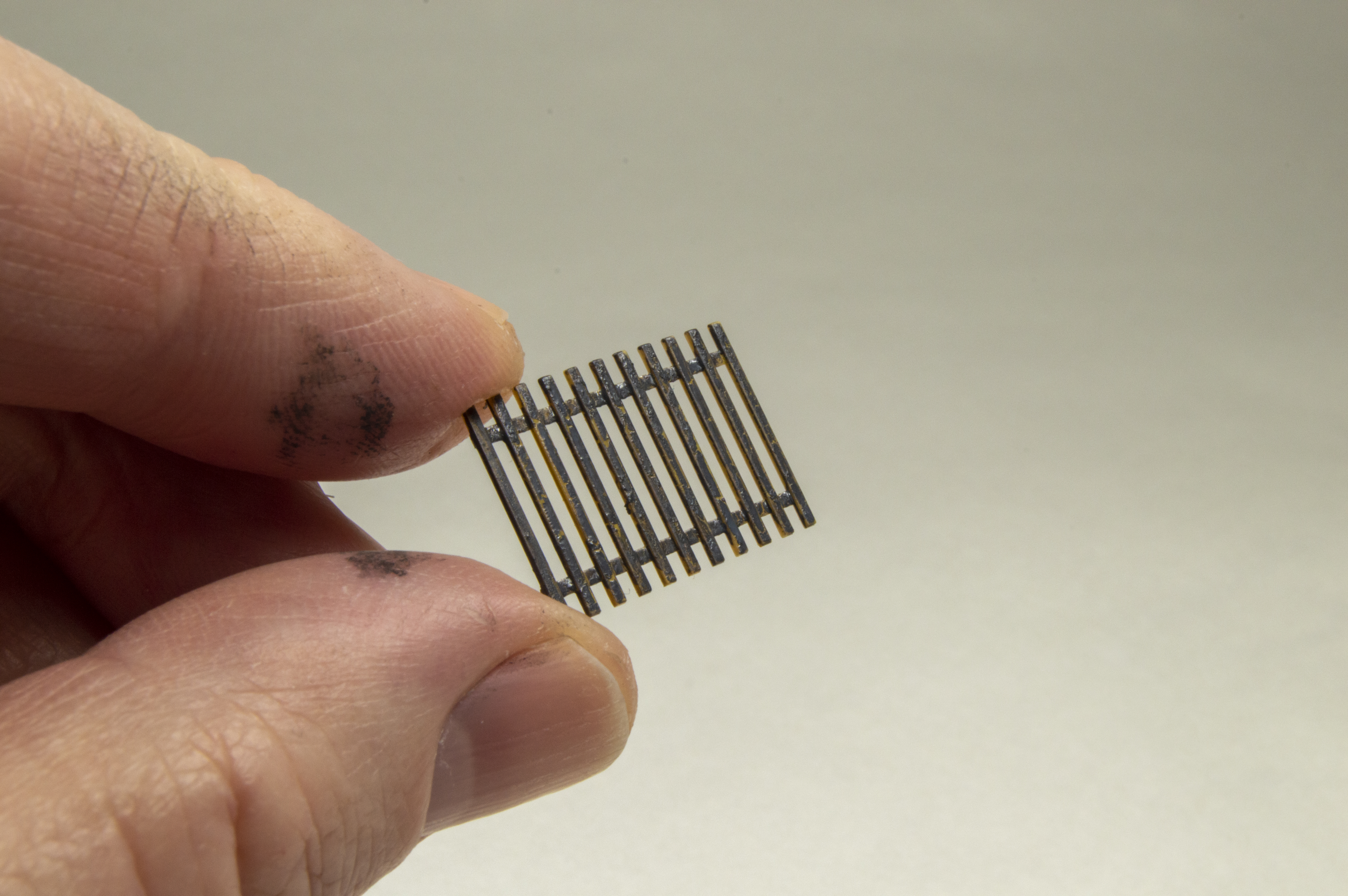

At this point, if you wanted only minimal scuffing, you could stop here. As you can see, the base color already shows through the dry top coat.

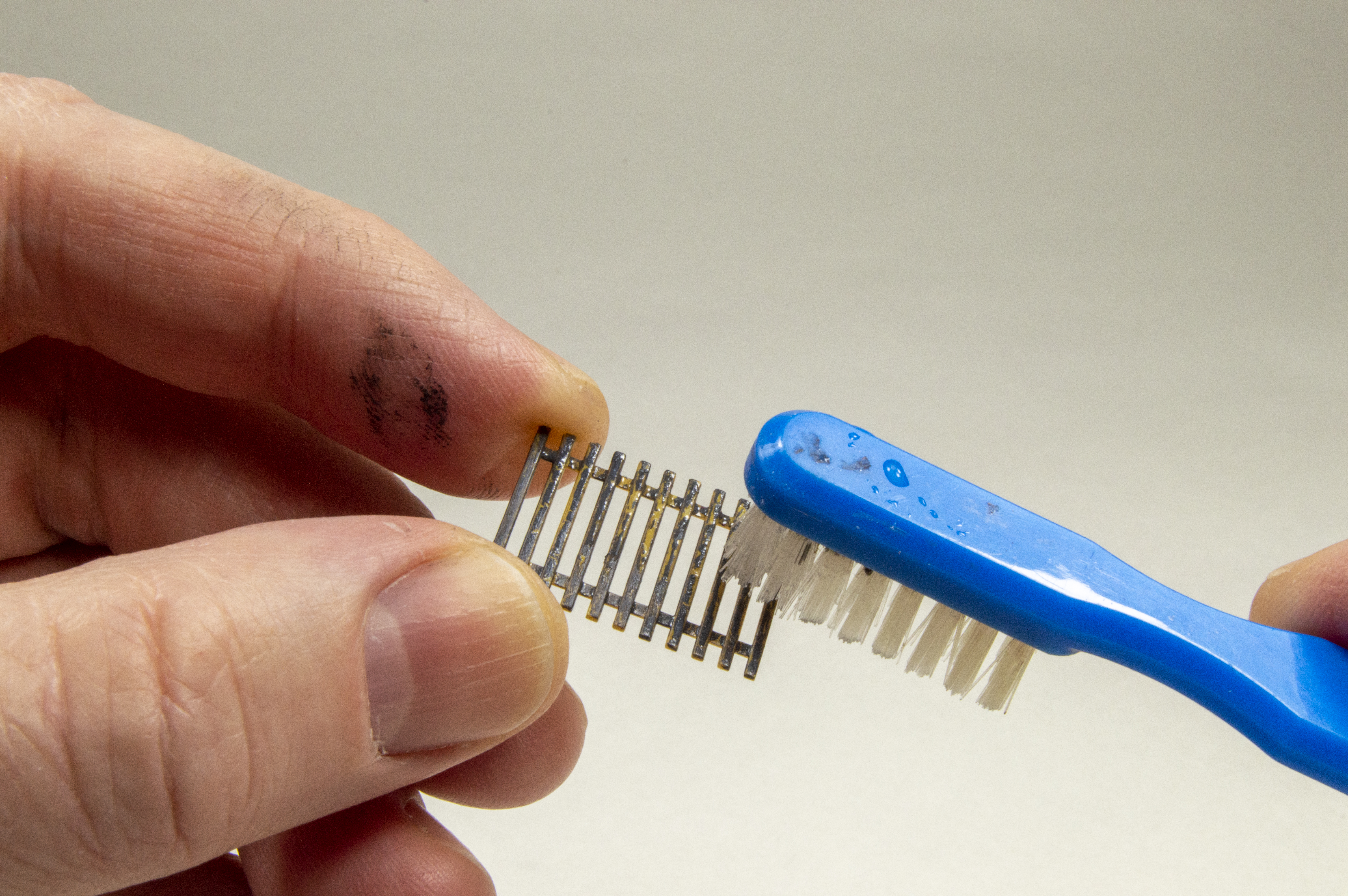

To show more wear, let the paint dry for 15 minutes and then gently scrub it with a wet toothbrush to remove chunks and chips of the top coat. Rinse the brush and repeat. Note: Be careful and not overly aggressive. You can always remove more if you want.

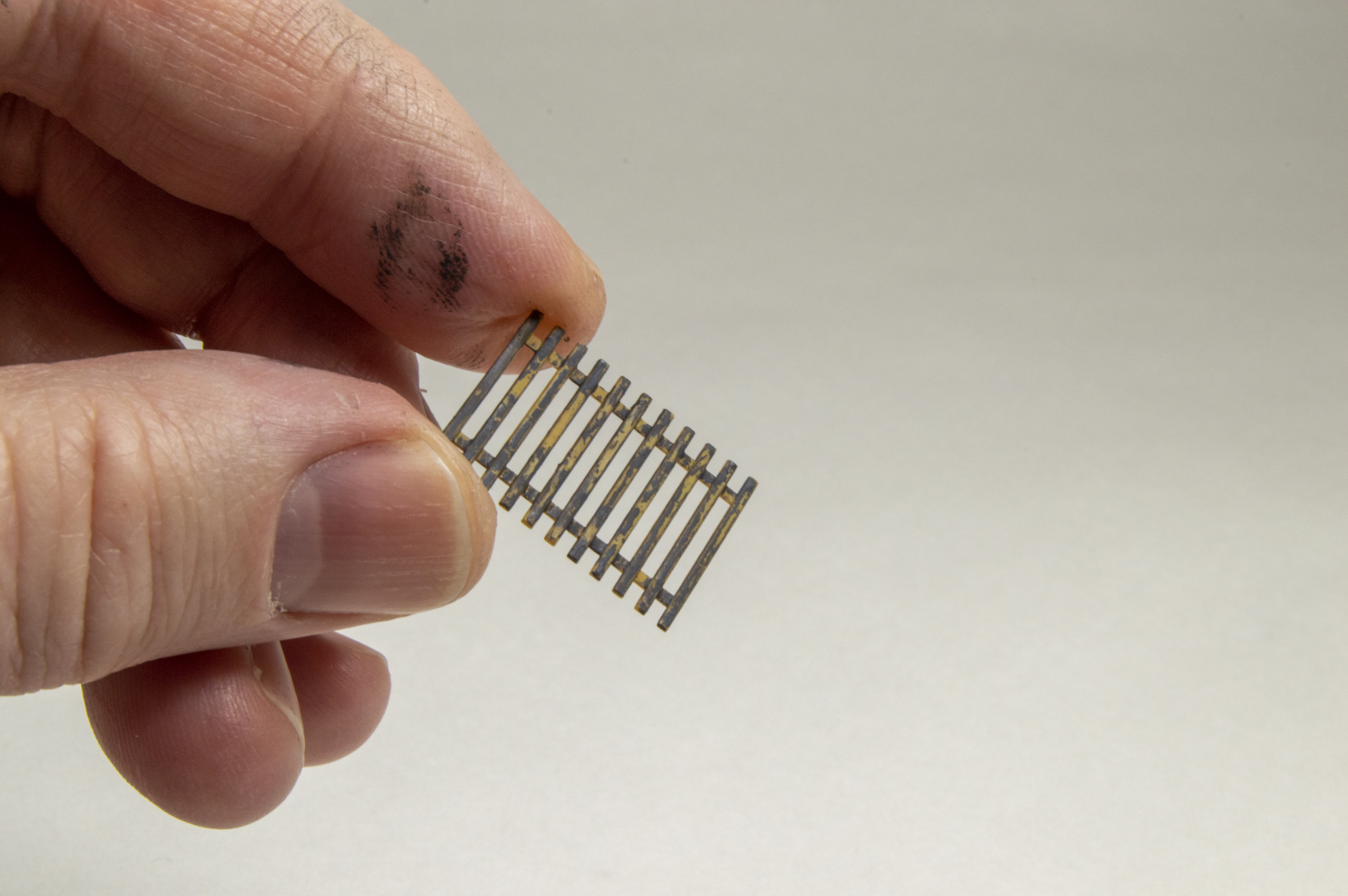

Finish with a flat clear coat (varnish) and the process is complete. Here, the part looks like painted wood that is well worn. Further weathering will enhance the effect, but for parts that are partially hidden, a quick treatment like this is all that is needed.
