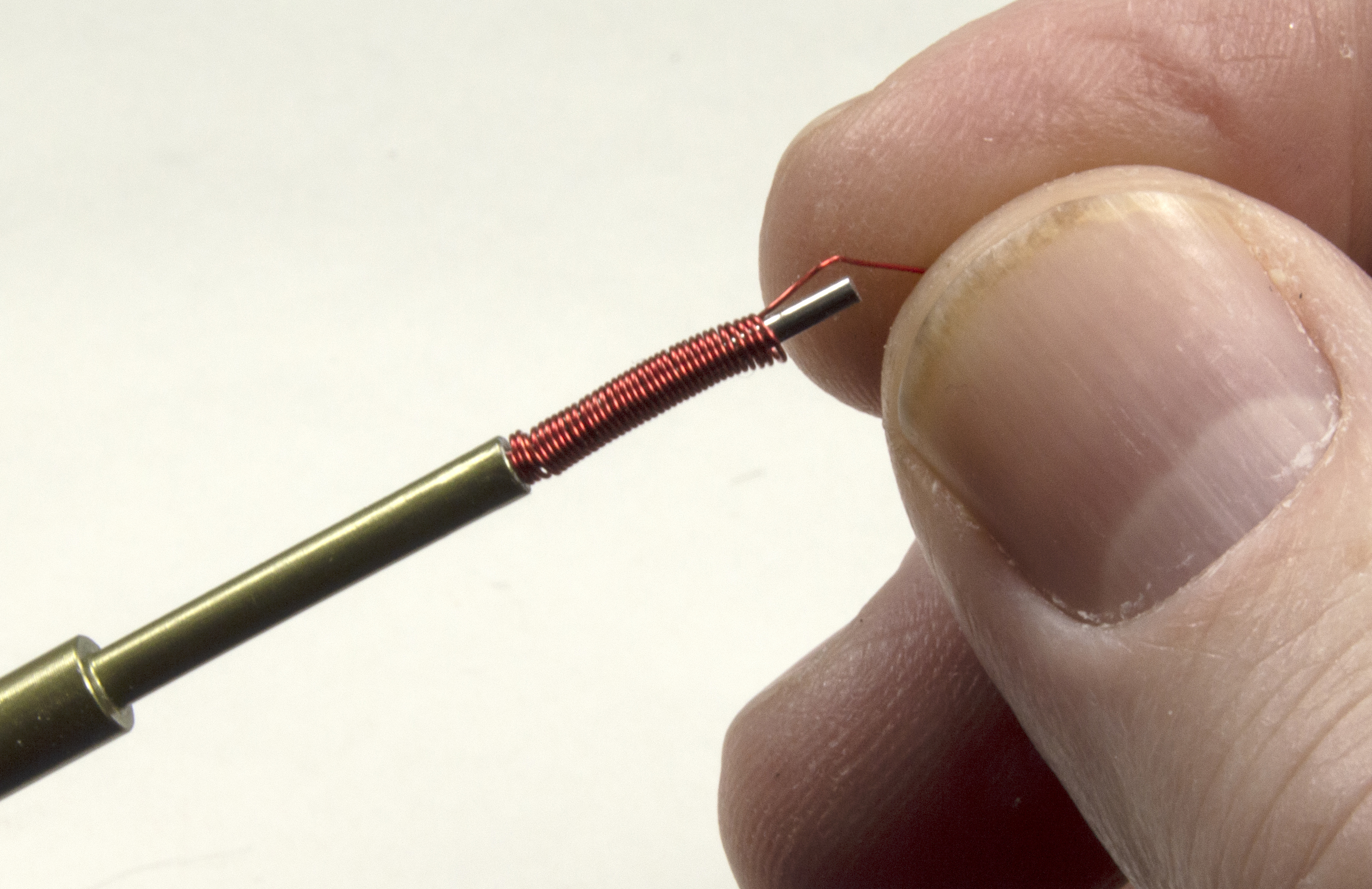

Harnesses have rings for attachment points and buckles for size adjustments. To make these, wind fine wire around an appropriate shape. In this case, I wrapped wire around a tool designed to make curves in photo-etched metal.
FSDSNAP016_03

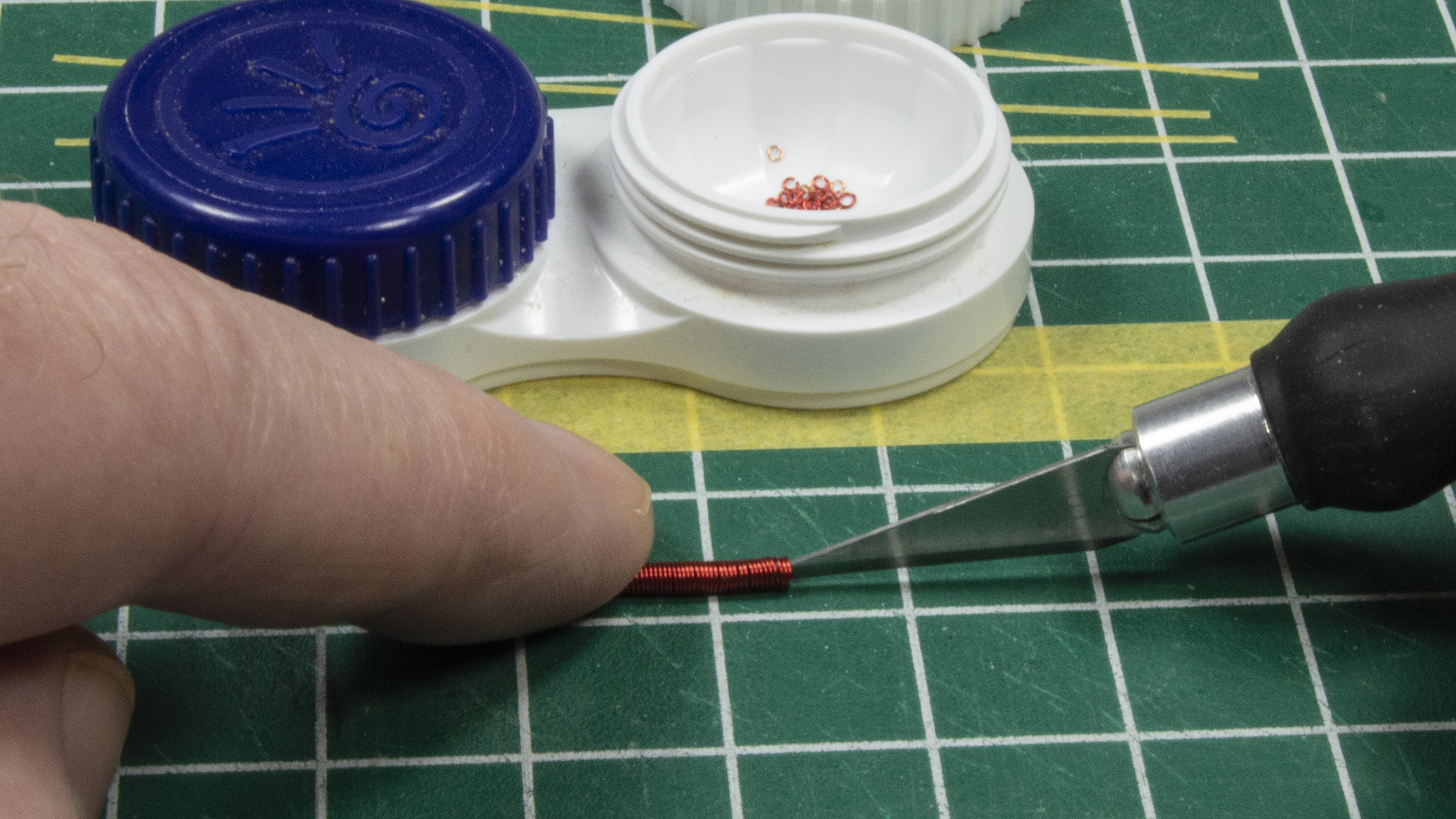

Once you have several coils around the shape, slide it off and place it on your cutting mat. Sliding a knife blade into the center of the coil and cutting will provide many rings. I transfer these to an old contact lens case for safe keeping.

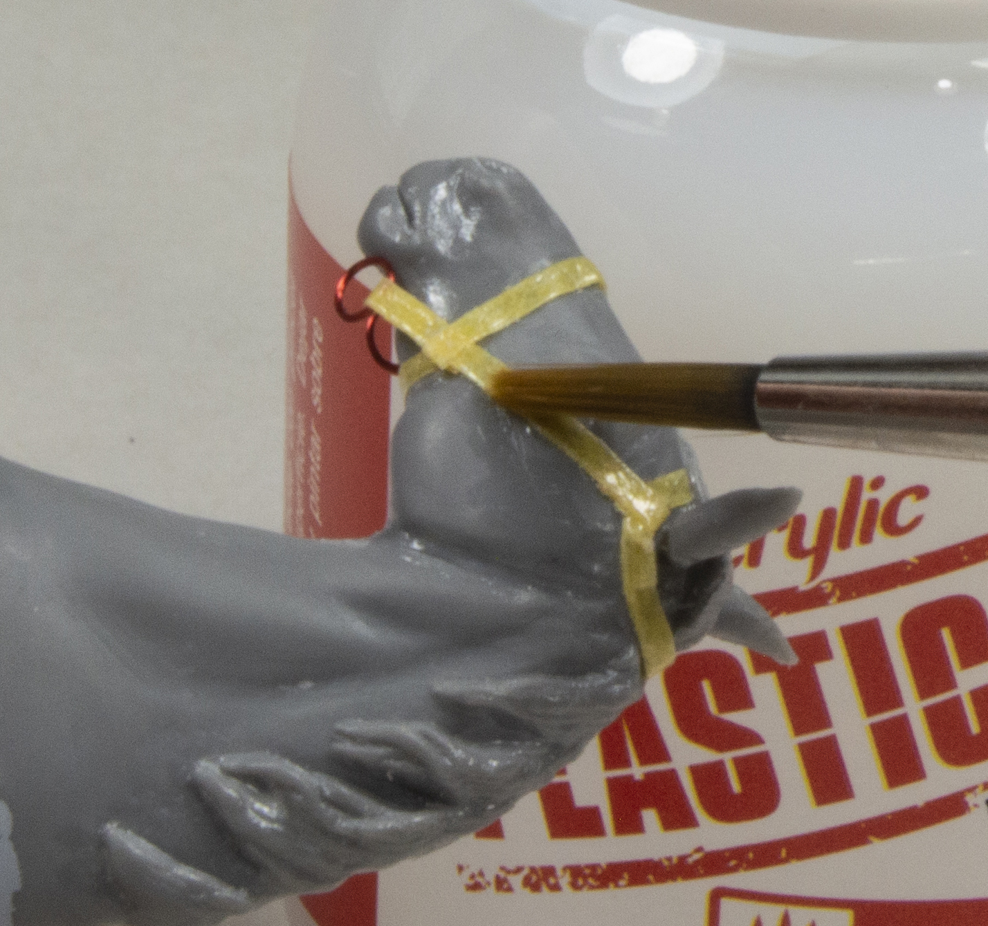

A thin coat of Ammo by Mig Jimenez Acrylic Plasticator, in this case, the thick version (No. A.MIG-2076), helps lock everything down and provides a smooth finish for painting.
