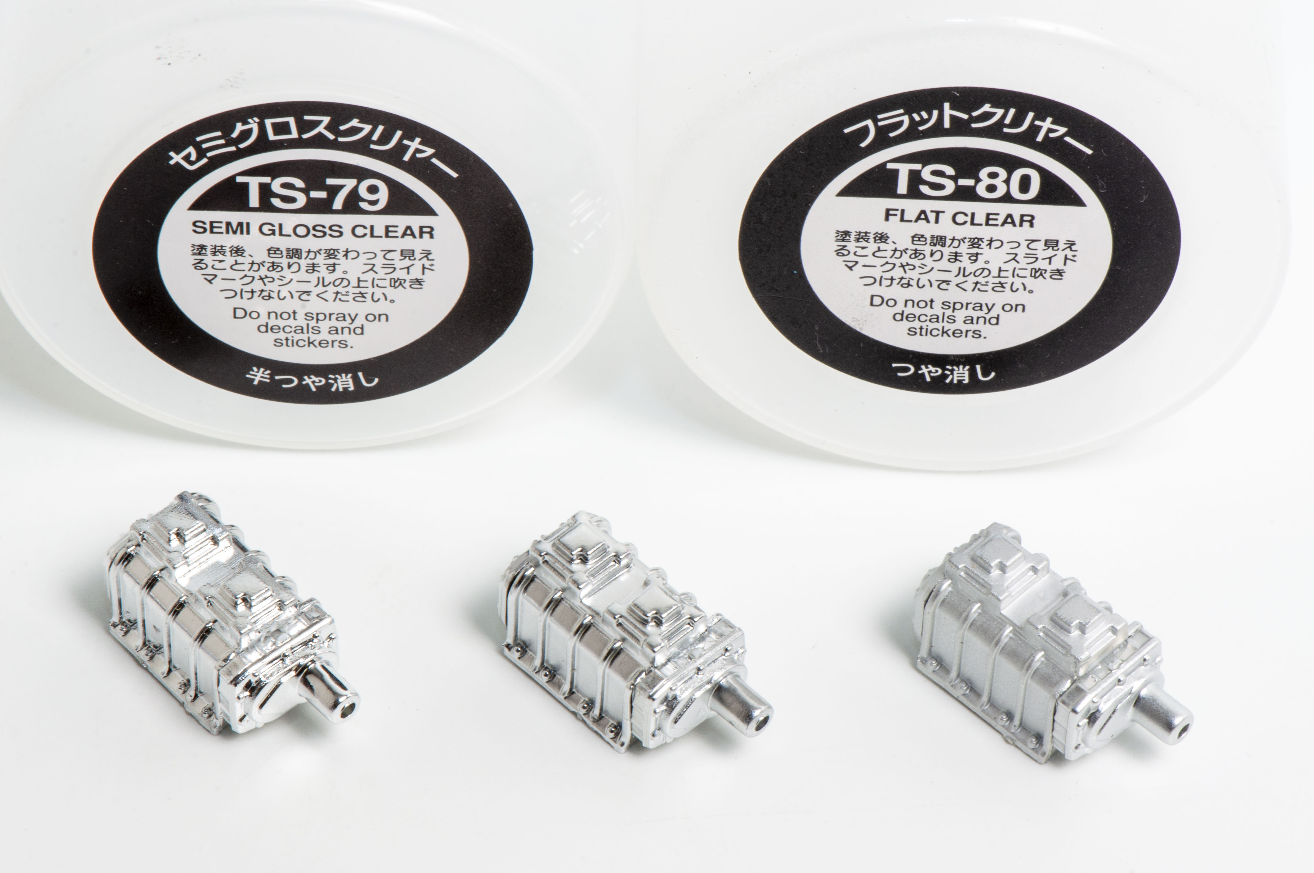

The clear, vibrant chrome plating in modern kits often appears unrealistic on scale engines (left). You can use Tamiya Semigloss Clear (No. TS-79), center, or Flat Clear (No. TS-80), right, to tone down parts like these supercharger blower cases.

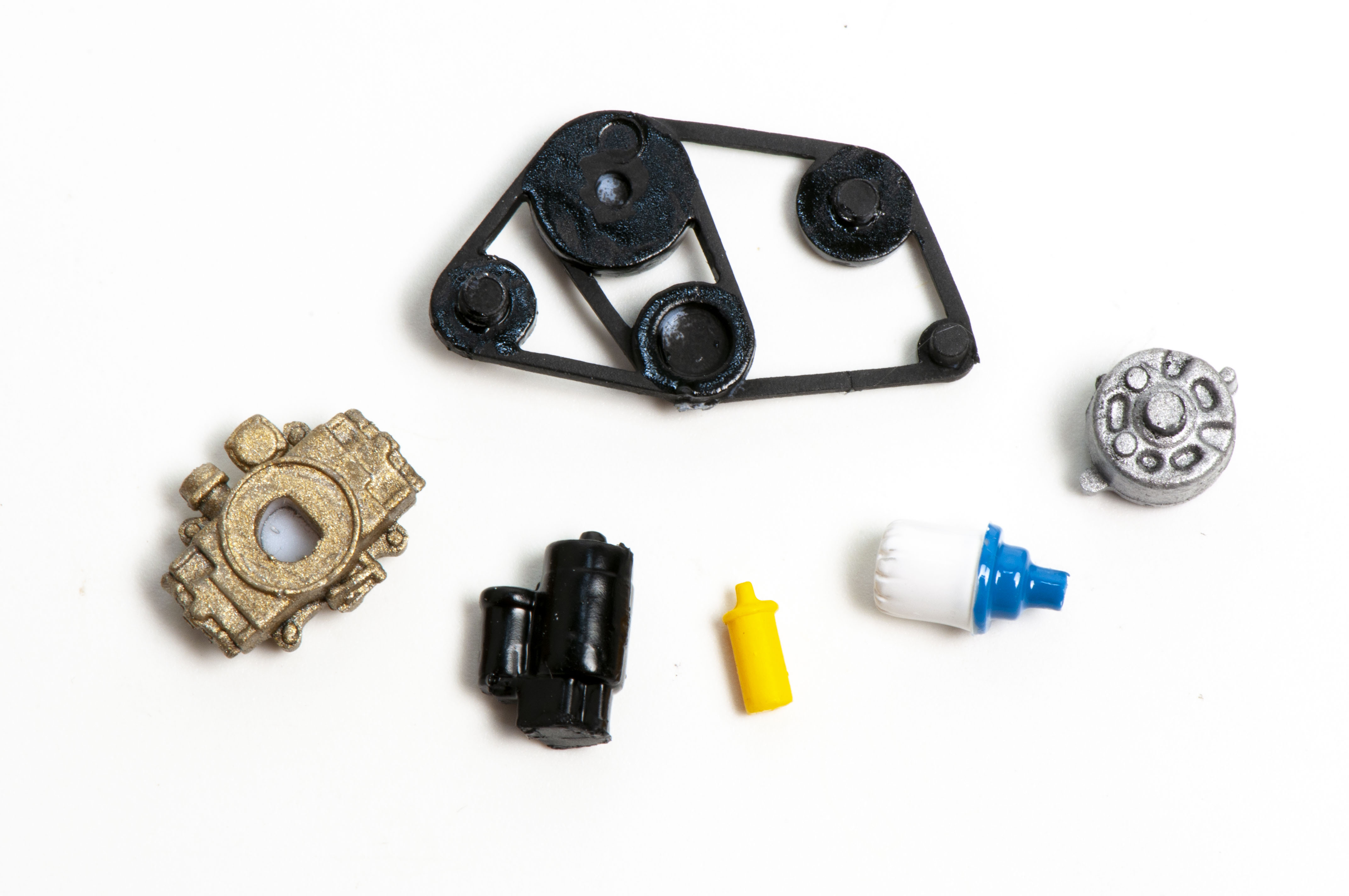

Engine fan belts are always flat black, but fan-belt pulleys can be semigloss or gloss back, silver, chrome, or the same color as the engine block. Carburetors typically appear golden; starters, semigloss black; oil filters, white; and alternators, silver. Ignition coils are often black, but sometimes yellow on certain older Ford engines. Add Vallejo Model Wash Dark Gray (No. 76.517) to the carb and alternator for depth.

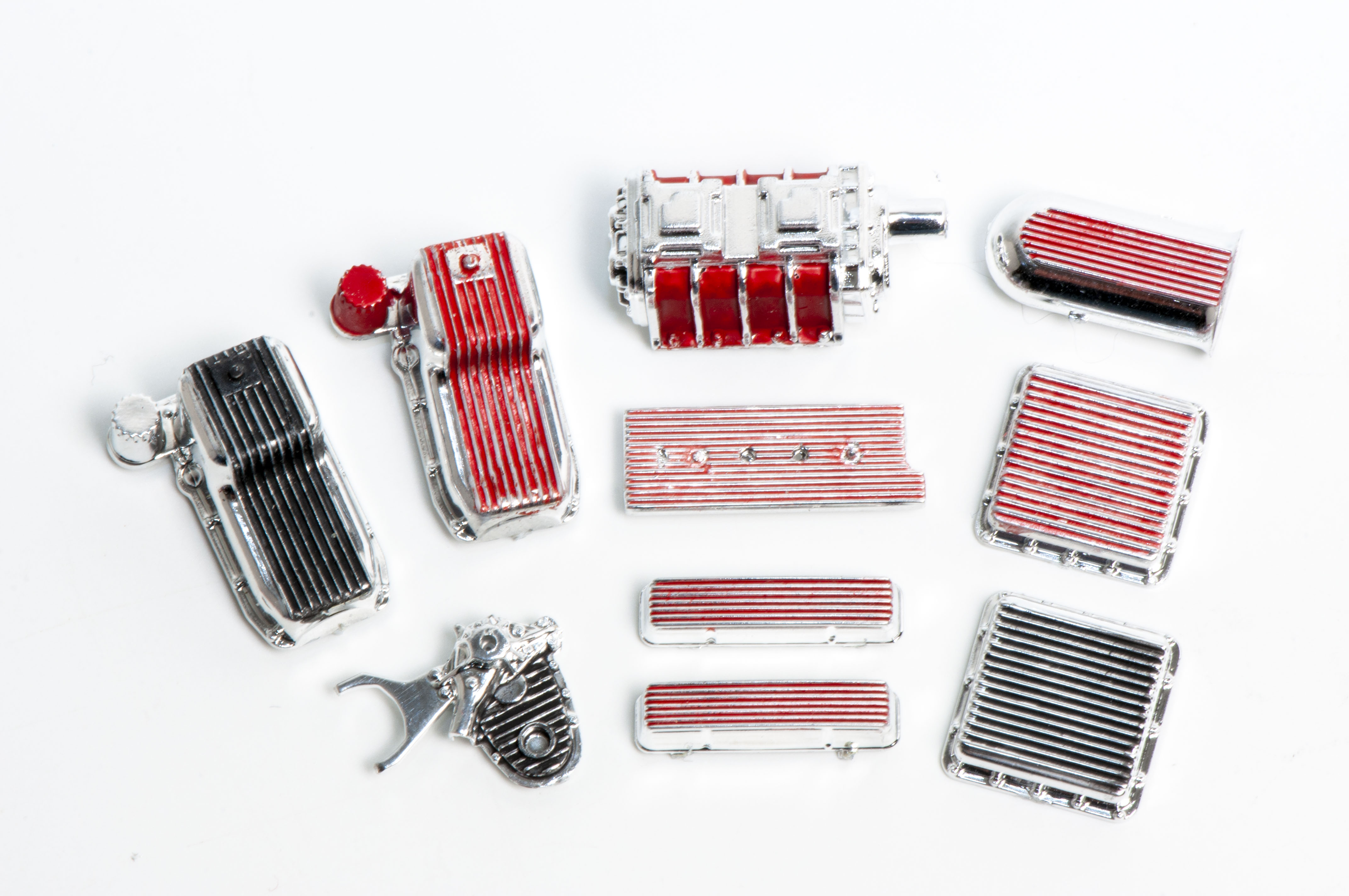

Hot rod and street machine engines often include aftermarket valve covers, front covers, oil pans, and transmission pans with finned surfaces. Builders add paint to the recessed surfaces between the fins. Flow thinned enamel or acrylic paint between fins to replicate this effect. Remove excess paint with a toothpick or soft cloth.
