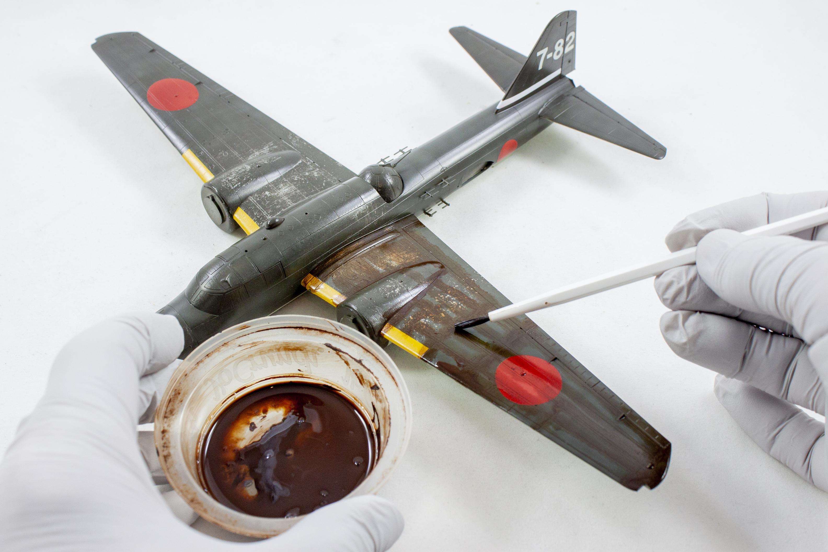

1. Washes
As a rule, modelers usually turn to washes as the first step in weathering. Typically applied over a model’s basic paint, a wash is nothing more than paint thinned to a very translucent consistency that flows well into nooks and crannies on your model. You can make your own washes or buy premade acrylic, enamel, and oil-paint formulas from many of your favorite paint manufacturers.
The two most common wash techniques are the pinwash and overall wash. With a pinwash (really it should probably be pin-point wash) you target small details and panel lines with a fine brush. For the most part, you’re letting the wash flow via capillary action and accentuate details to help make them more visible. A overall wash can accomplish the same goal, but you’re applying the wash to the surface of your model with a large brush and letting the wash accumulate in and around the fine details.
You’ll want to keep cotton swabs handy to soak up and remove any unwanted wash. Washes can also be used to simulate fuels, oil, and grease stains, as well as rust.

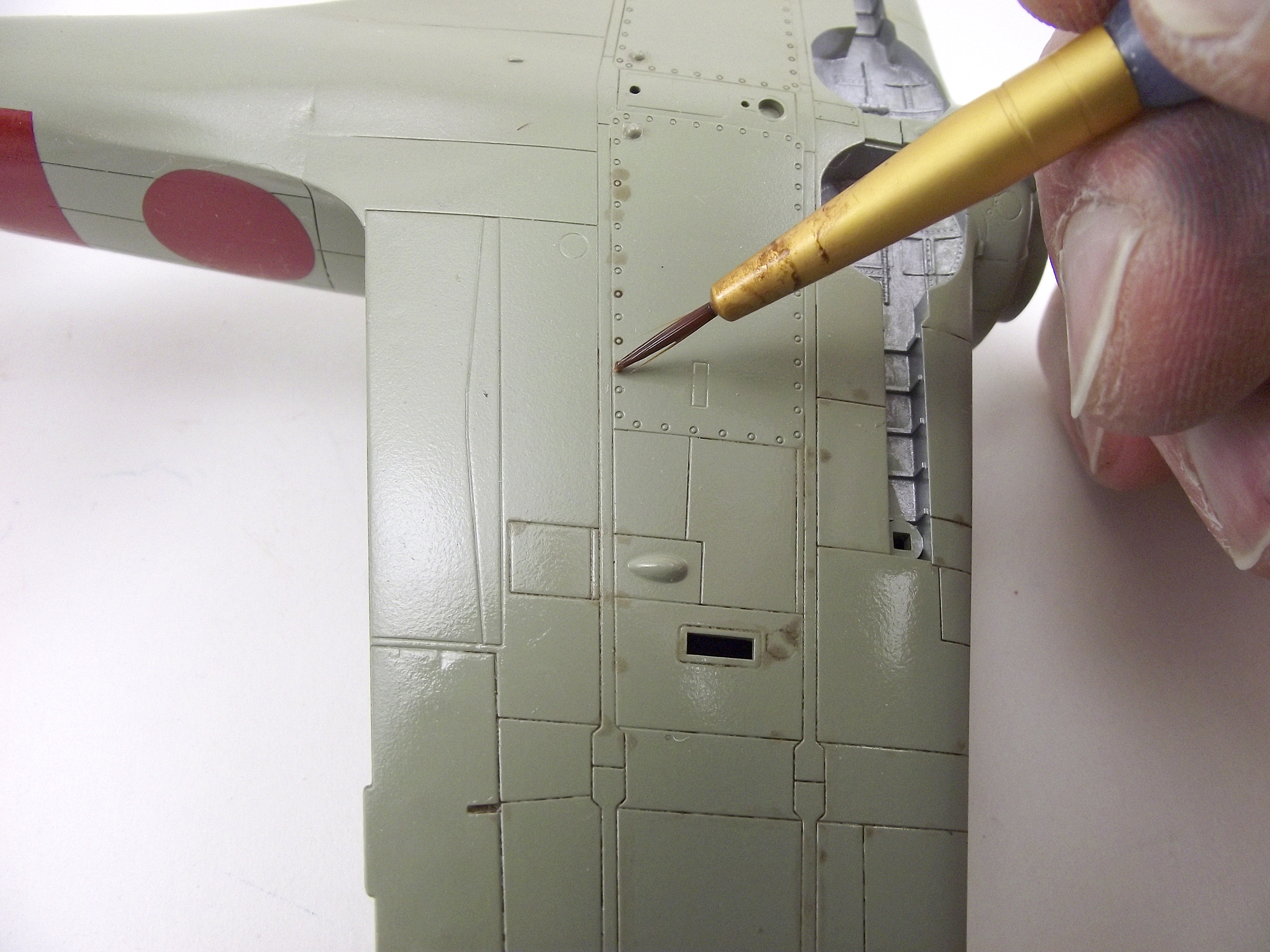

Pinwash
A finely pointed brush is the best way to apply a pinwash. Touch it to places like screw heads, panel lines, or any where you want to accentuate details.
Wash_1
Here, modeler Chuck Davis made a wash by mixing burnt umber artist oils and Turpenoid. He applied a generous amount along the panel lines on the wings and fuselage of his Ki-67 bomber.

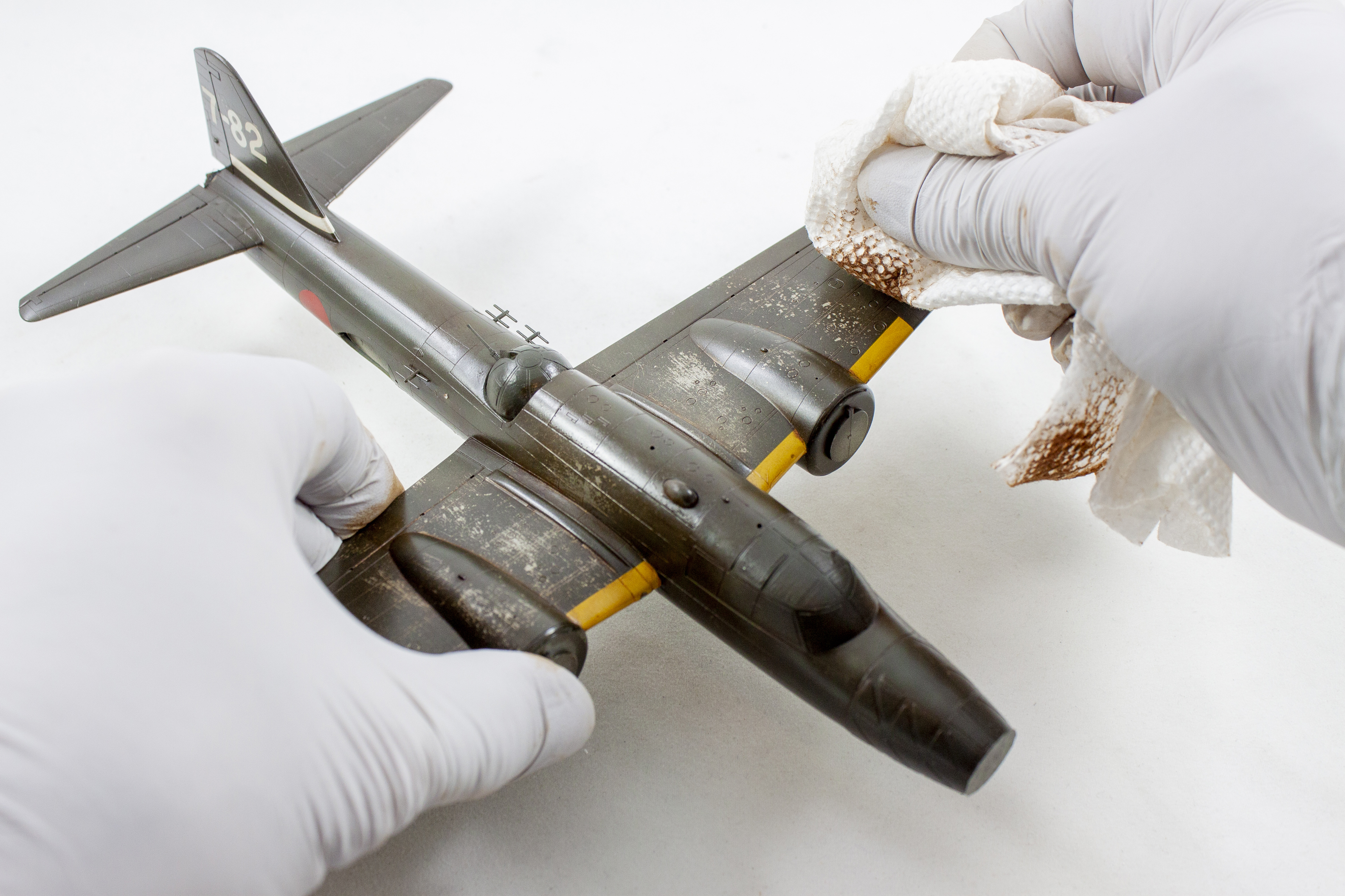

Wash2
After letting the wash set for 30 minutes, Chuck removed the excess wash with a paper towel making sure to swipe in the direction of airflow.

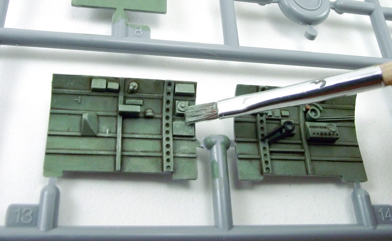

DryBrushing
Here you see Aaron Skinner dry-brushing the raised cockpit details of a 1/72 scale Zero fighter to leave behind just a little paint on the corners and ridges.

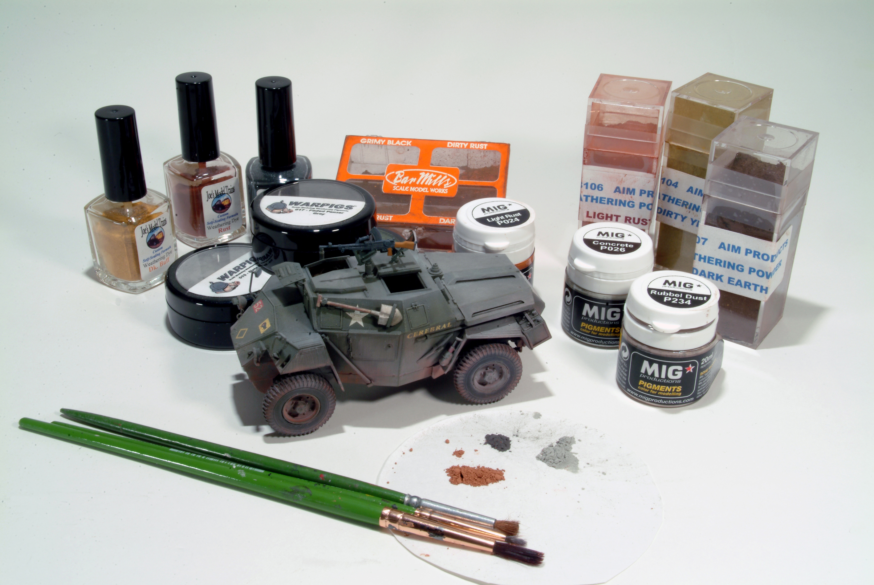

Pigments
A number of manufacturers make ready-to-use pigments in popular premixed colors for modelers. Some have a fixative mixed in to help them stick to the model.

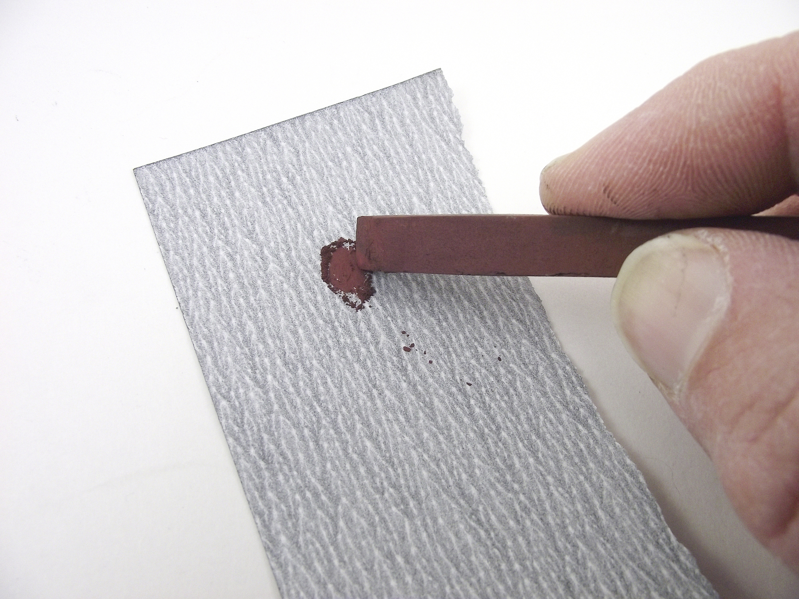

Pastels
If you decide to use pastels, you’ll have to grind them to powder first. Messy, but you’ll be able to custom mix your own colors.

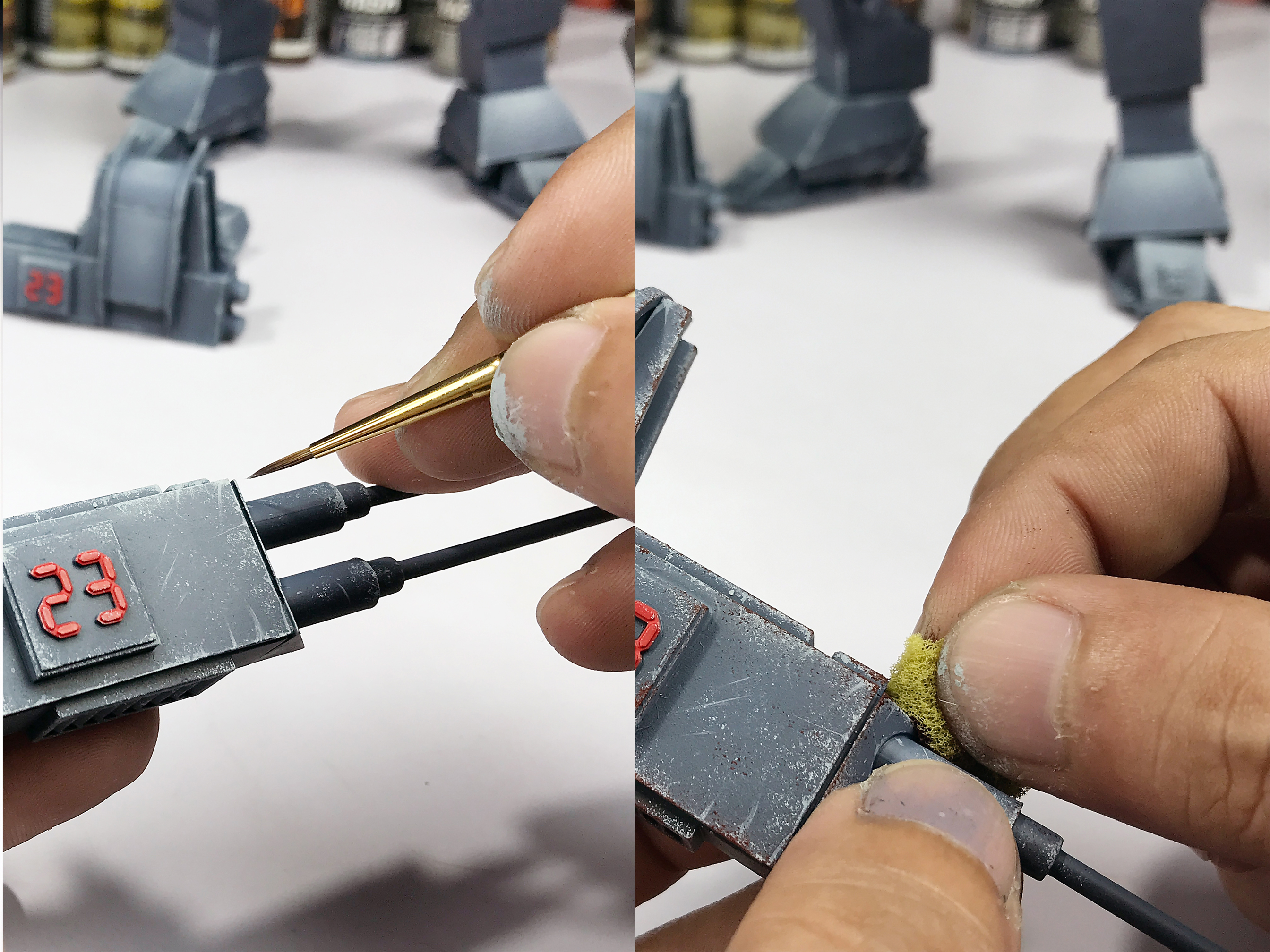

4. Chipped paint and scratches
Several techniques for chipping paint exist, but the simplest requires only a fine tipped brush and/or a micro-fiber sponge. Typically, a couple of coats of paint go onto full-size vehicles—at least a primer coat and then the color coat. Figure out the color of your vehicle’s primer coat (often a dark gray) and then paint tiny “chips” with your paintbrush in places that would naturally see wear. Try to make the chips appear random.
Alternatively, you can tear a small piece of a micro-fiber sponge, hold it with tweezers, dip it in the paint and blot away the excess (you don’t need a lot!), and then touch it to the model where you want to see paint chips. The sponge should naturally create a random pattern. However, be sure to twist your and adjust the angle between touching the sponge to the model to maximize the irregularities.
If you want to simulate deep gouges that go all the way to the metal, switch to a metallic color and use the same method and concentrate on the places you’ve already made paint chips.
This technique is easy to overdo, so be restrained the first few times and use a critical eye when assessing your work.
ChippedPaint
Renowned Gunpla modeler Don Suratos employed both a paint brush and a micro-fiber sponge to achieve the chipped paint and scratches on his Dust 1947 Gunther walker. Notice he used red for the deep chips for contrast and visual interest.

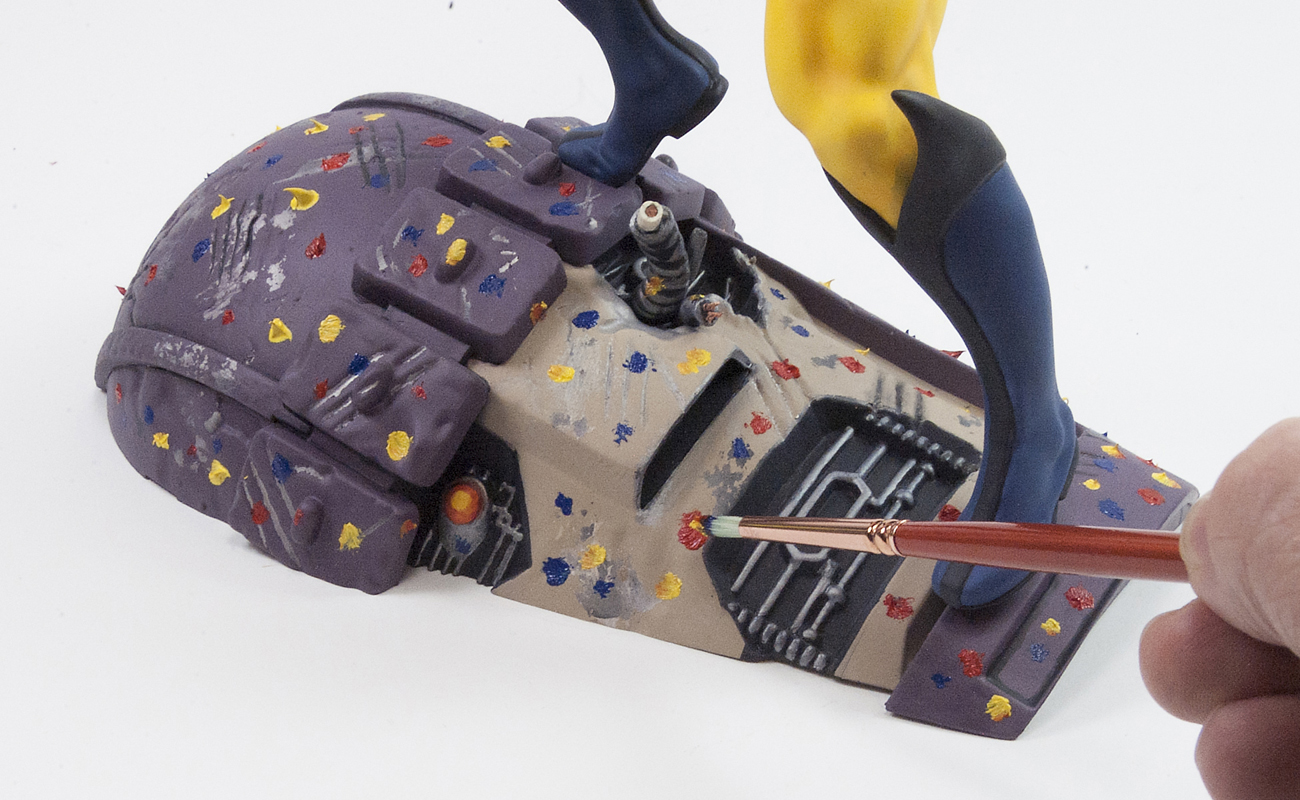

DotFilter1
Tim Kidwell applied a dot filter to the Sentinel base for his Wolverine figure. He dabbed blue, red, and yellow (traditional print colors) artist oils all over it first. Then he drew a wide, flat brush wet with Turpendoid through the paints, always in the direction of the top of the head to the chin—the direction of gravity when the Sentinel was standing.
