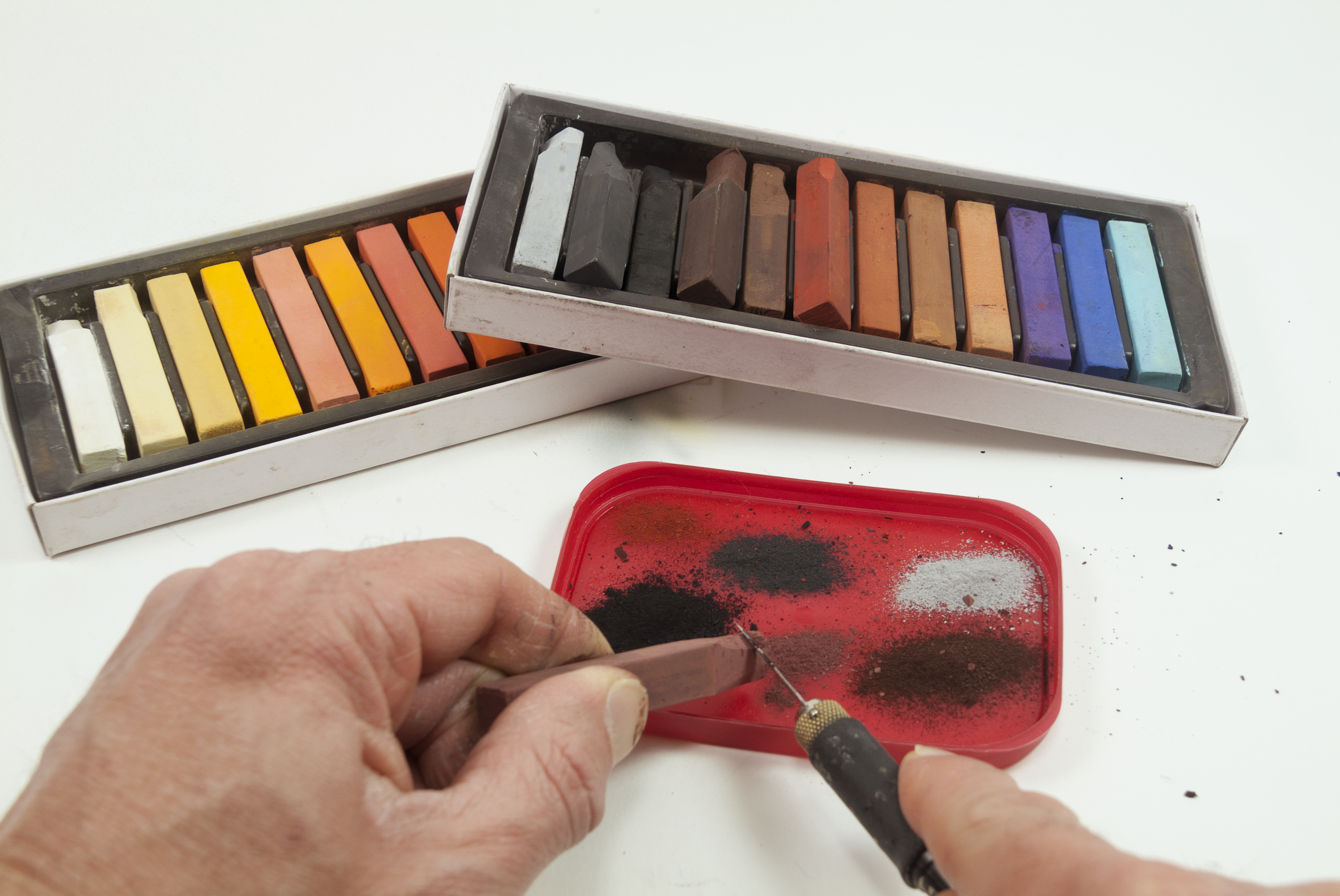

Pastels provide a subtle, controllable, and fairly forgiving method of adding streaks and scorching. Start by scraping a knife along several pastel sticks (black, dark gray, light gray, burnt umber, raw umber, and raw sienna) to make piles of powder.

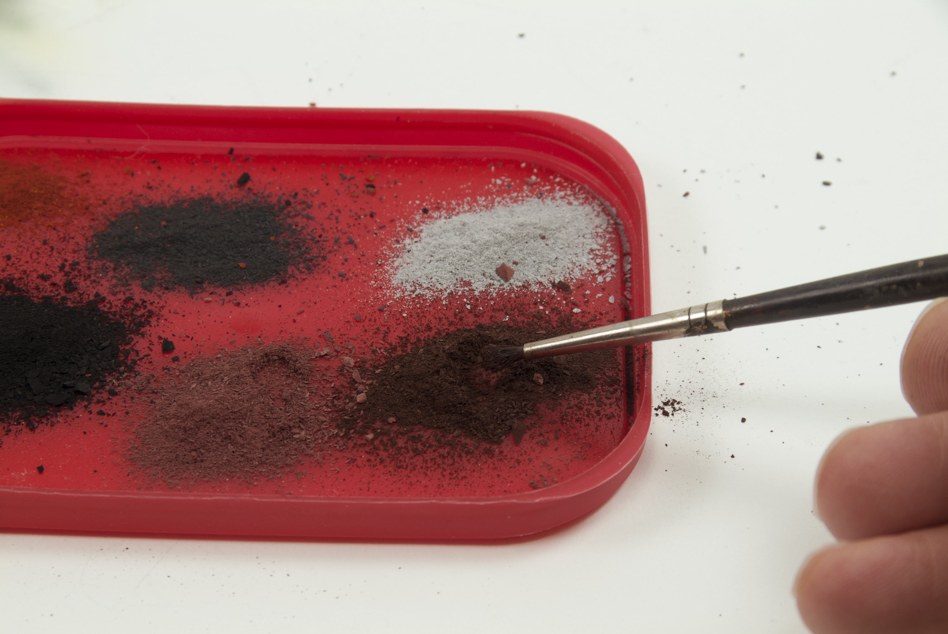

Wash your hands after handling pastel sticks so you don’t leave fingerprints all over your model. To apply a color, pick up a little on an old paintbrush. You may want to label this brush because you won’t want to use it for paint again. Keep it for applying pastels and pigments.

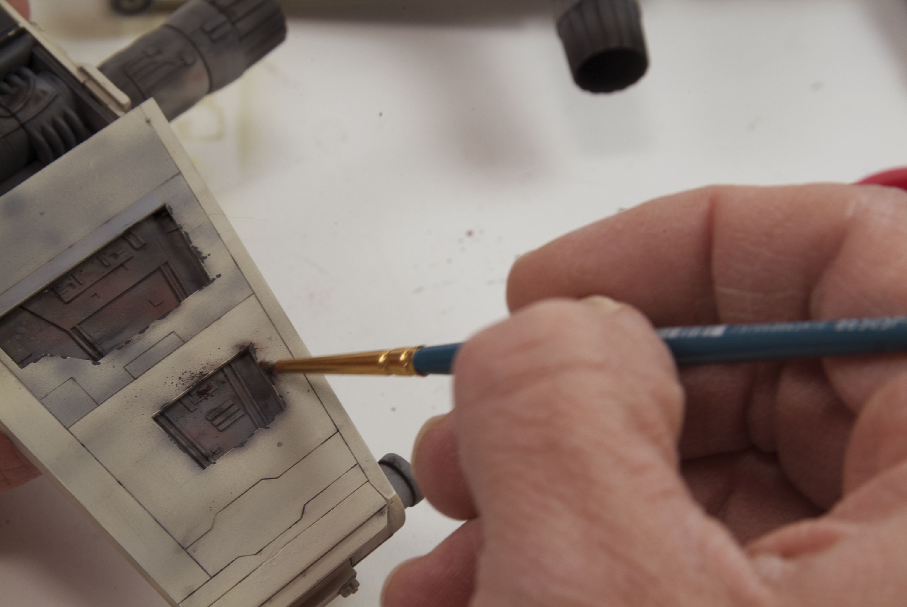

Touch the brush to a point on the model where a streak of color will start. Don’t press hard—just use enough pressure to deposit powder on the surface. Then lift the brush and gently blow the excess off the model.
BKS1280702_104
Now, return the brush to the surface and gently sweep it back from the starting point across the surface in the direction the vehicle primarily travels (typically front to back). The result will be a fine line of color that decreases in density toward the rear.

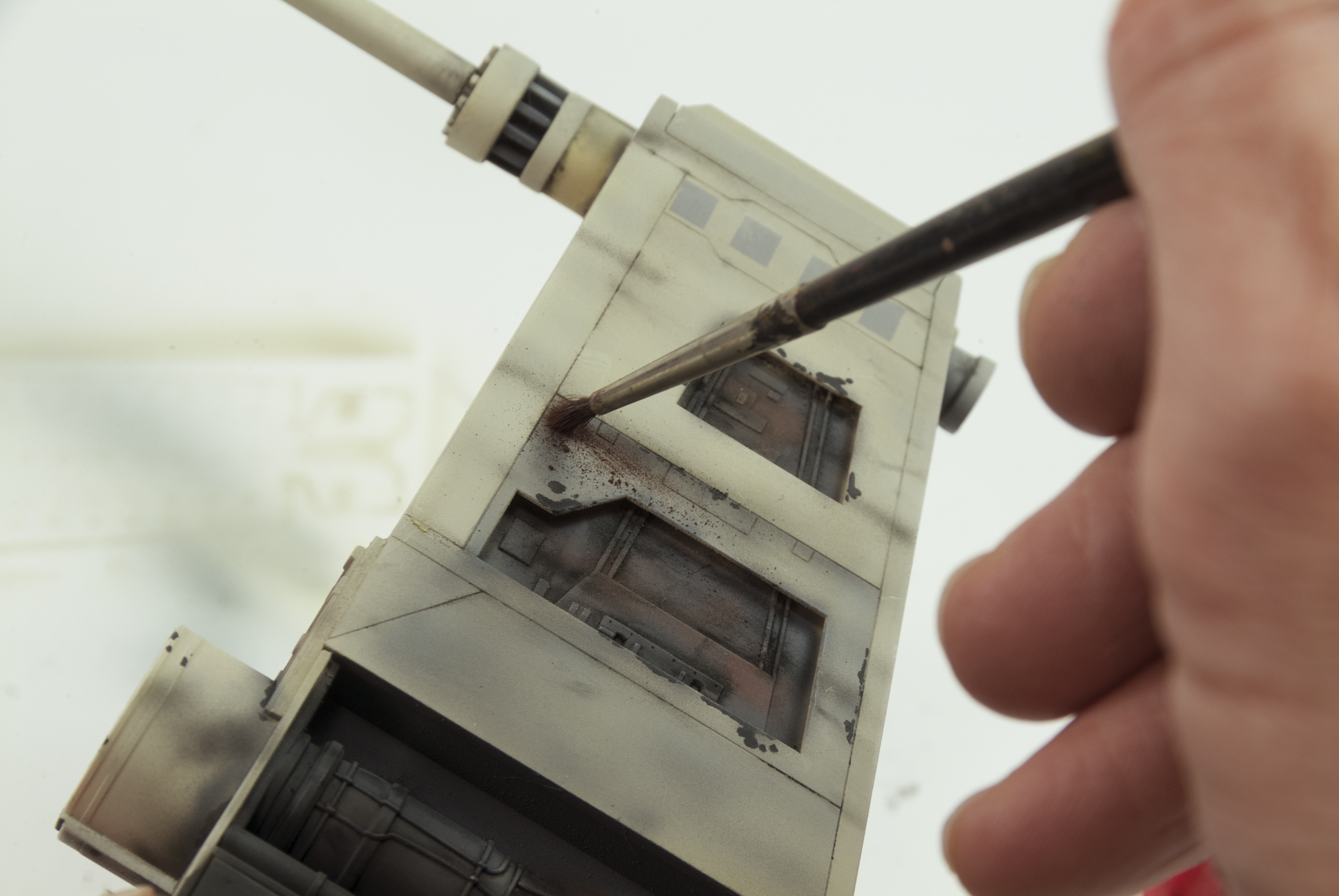

Where there are chips in the paint maybe caused by a laser blast or quickly extinguished fire, gently scrub dark gray pastel powder over them. It helps blend them into the overall weathering so they aren’t so stark.

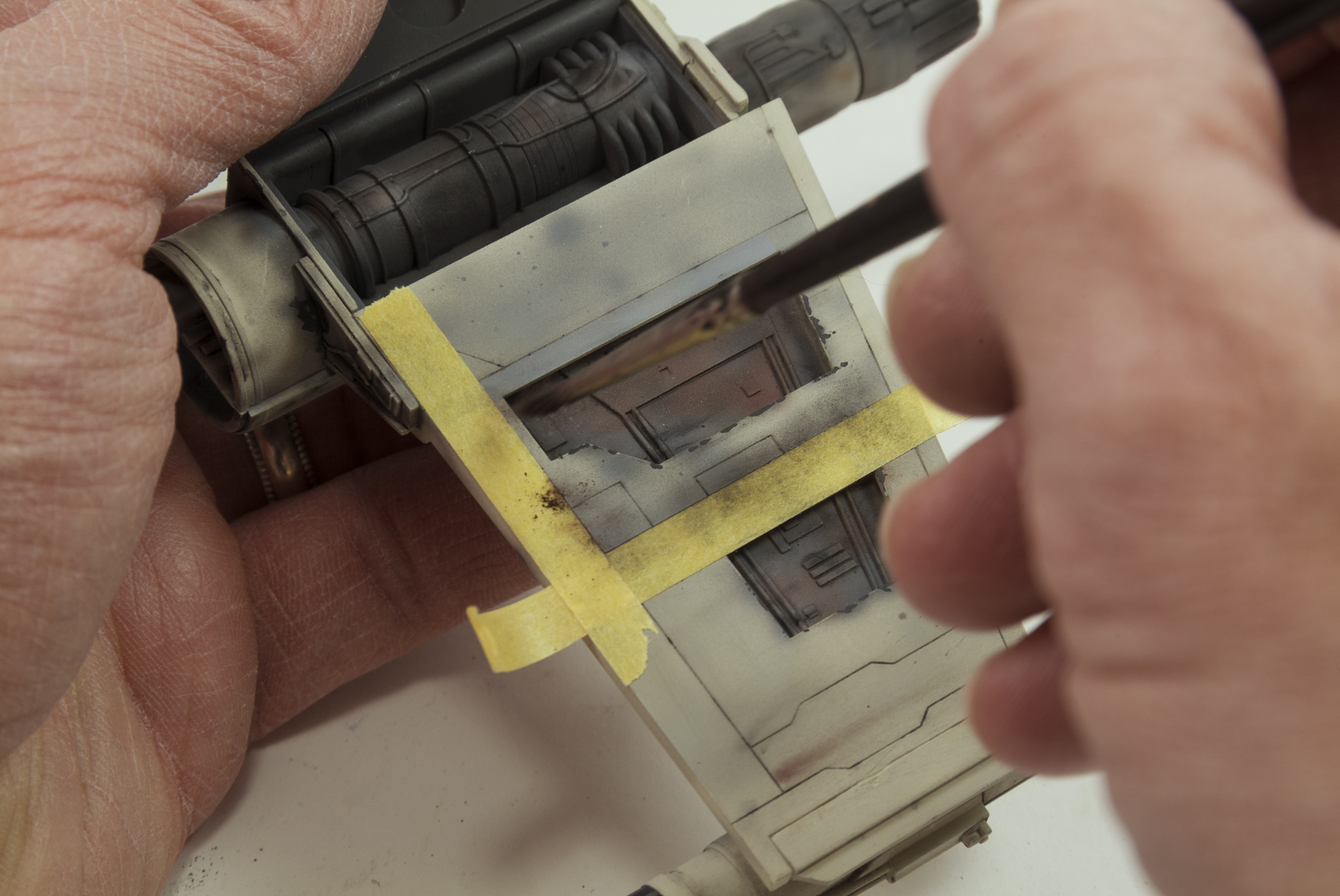

You can run tape along select panel lines and brush and scrub powdered pastels along the edges. This produces hard-edged weathering that may indicate where panels have been replaced, giving the vehicle a used feel that all Star Wars ships (unless they’re from Naboo) should have.
