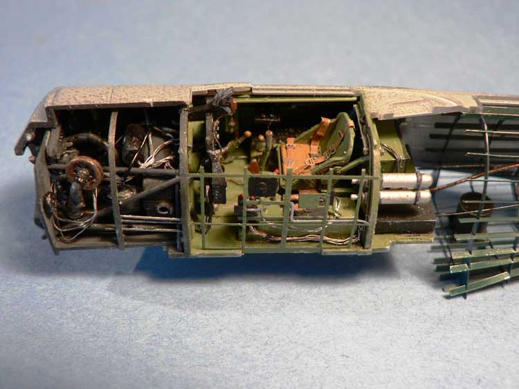

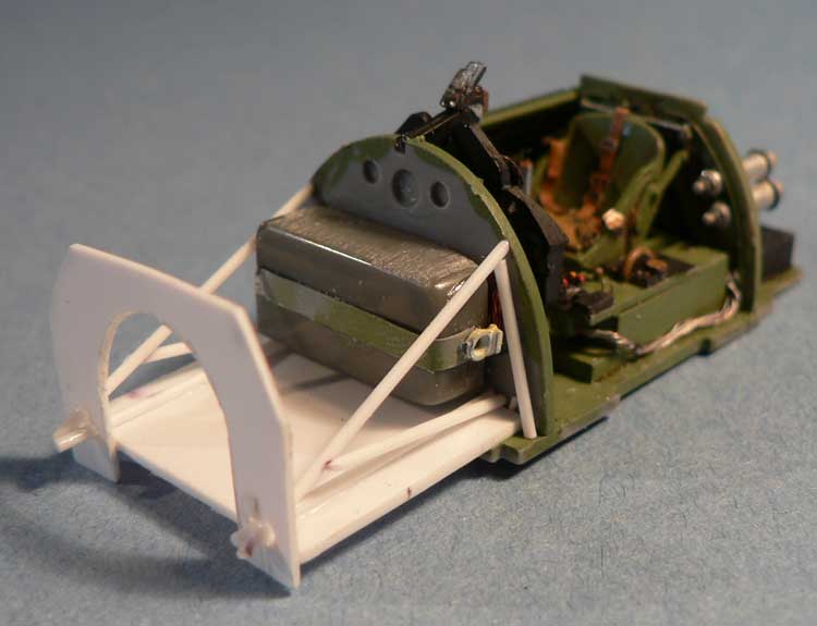

Like most modelers, Waikong started in the cockpit, adding wire and styrene details to dress it up a little.

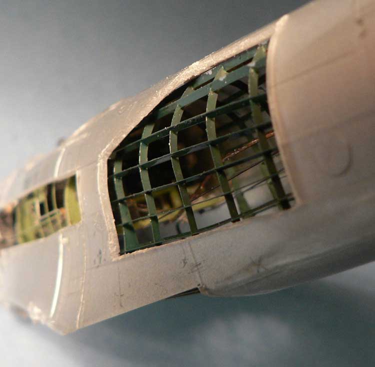

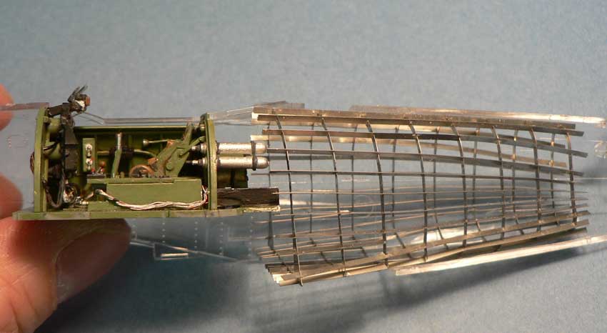

The details continued aft as Waikong wrestled with the wobbly photoetched-metal formers and stringers.

If he was going to show off the engine, Waikong had to build a styrene firewall and engine mount.

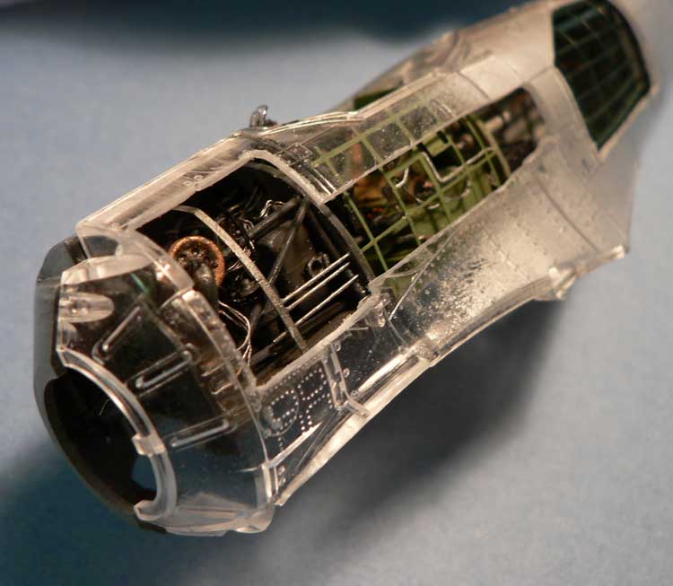

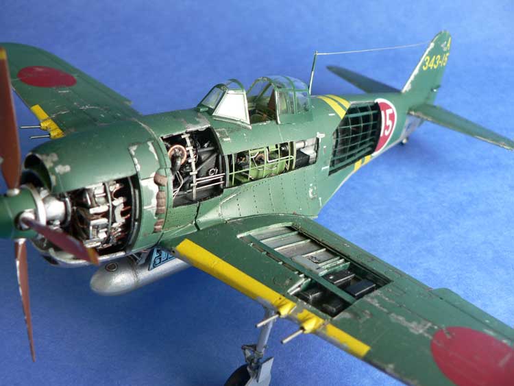

Waikong employed "gizmology" to fill the space. It looked like a lot to fit in the nose ...
cutaway N1K2-J Shiden Kai aircraft
... but fit it did. Remember to paint the inside of the fuselage before closing it around the details, Waikong cautions.

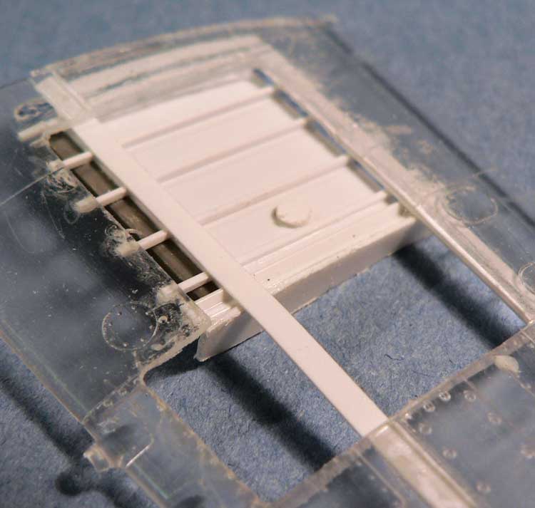

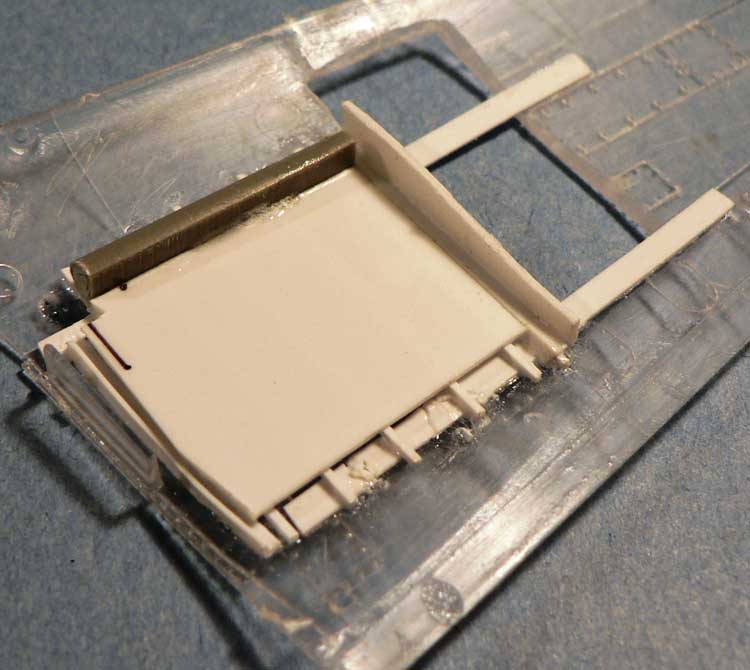

Waikong opened just enough wing to suggest more ...
... using styrene sheet and strip to fill in
details ...

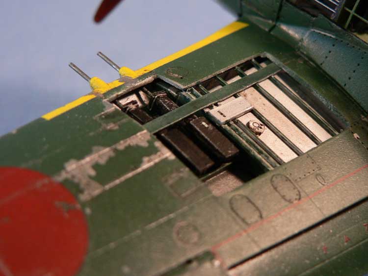

... and "revealing" machine guns and fuel tanks.

Taken in sum, the details lend an air of complexity to Waikong's carefully considered cutouts.

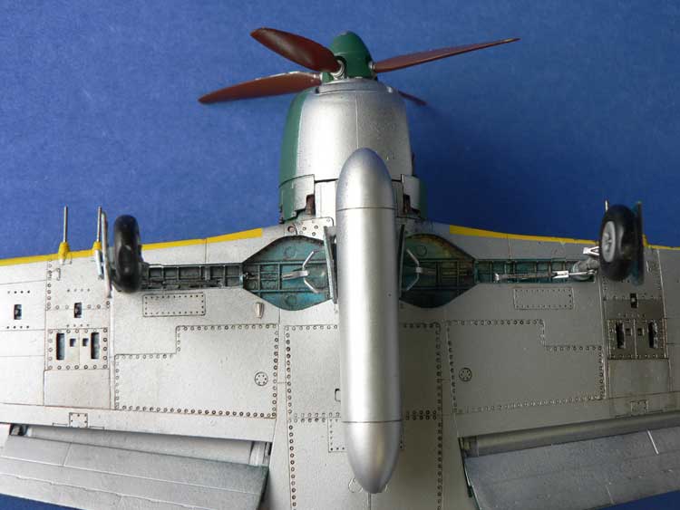

Things are kept relatively simple underneath and in the wheel wells.

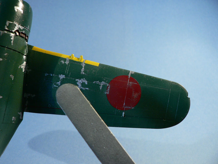

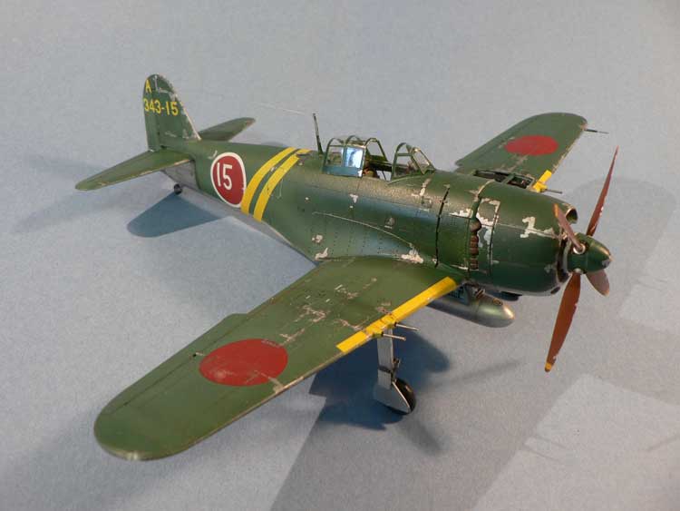

Waikong "chipped" paint with a silver marker, sanding it back a little to keep it from looking too bright.
The result is a realistic depiction of the level of weathering seen in wartime photos - and a darned good-looking George!
