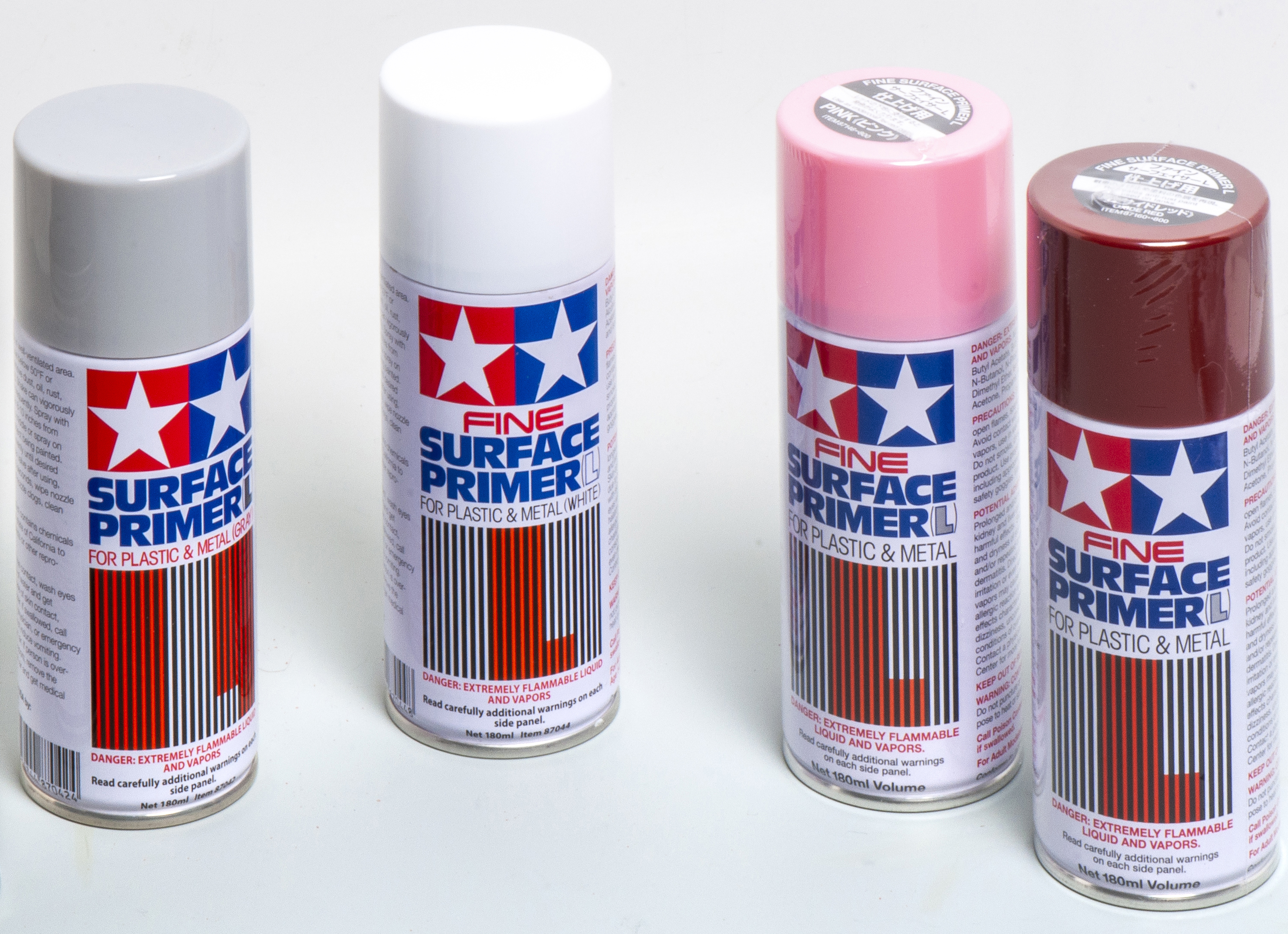

I recommend primer for nearly all model projects. If you’re using Testors or Tamiya lacquers, Tamiya Fine Pigment Primer in pink (for red color coats), rust (for dark colors), or gray (for all other colors) is a great starting point. These will protect your parts from “hot” paints that would otherwise eat the styrene and provide some “tooth” for the paint to hold on to.

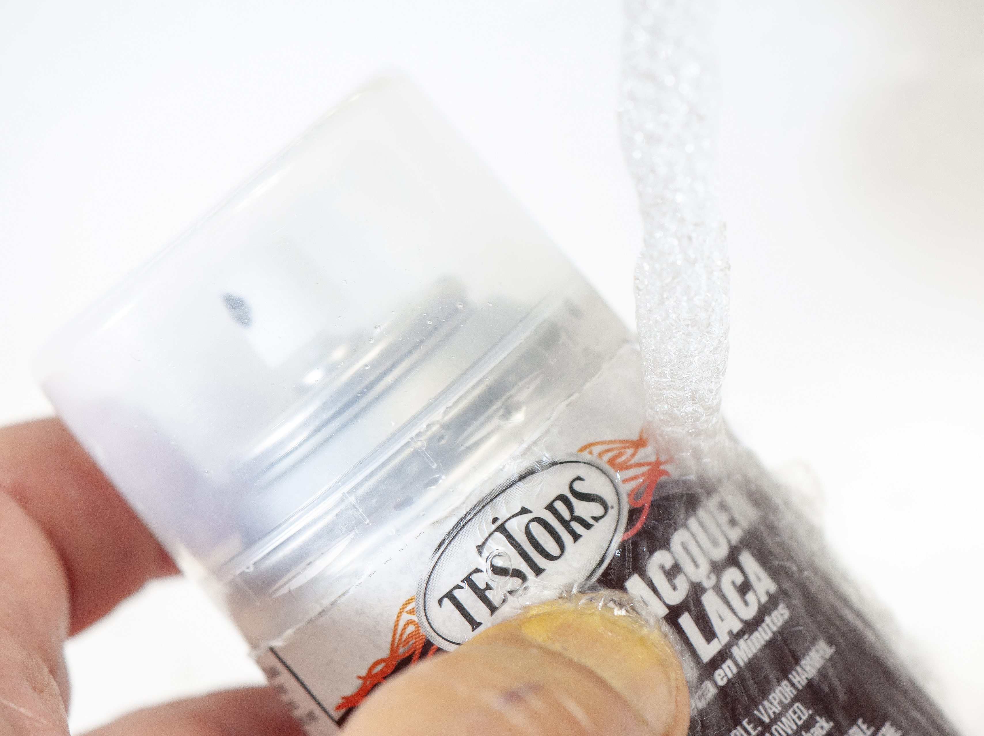

Before each aerosol application of your color coats and your finish clear coats, hold your spray can under a faucet with running warm water for a minute or so. Doing this will help provide constant pressure during application. Use caution: If the water is too hot for you hand, it’s too hot for the paint can.

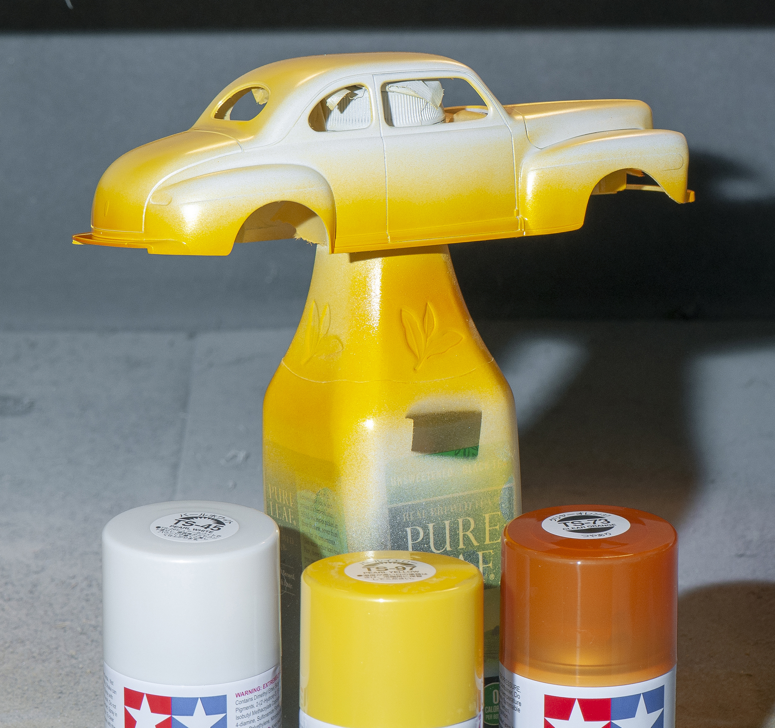

A well-lit painting area helps you judge the glossiness and smoothness as you apply the paint. Turn your model in the light and you’ll be able to see any differences in sheen. Ideally, you want a light source above the model plus a light source behind and slightly to the side of you (so it doesn’t cast your shadow onto the model).
SCABF0419_05
With practice, you can achieve an extremely glossy appearance straight from the can with hobby clear-coat lacquers. This body was in the paint booth just a couple of minutes prior to this picture, and it appears super glossy.

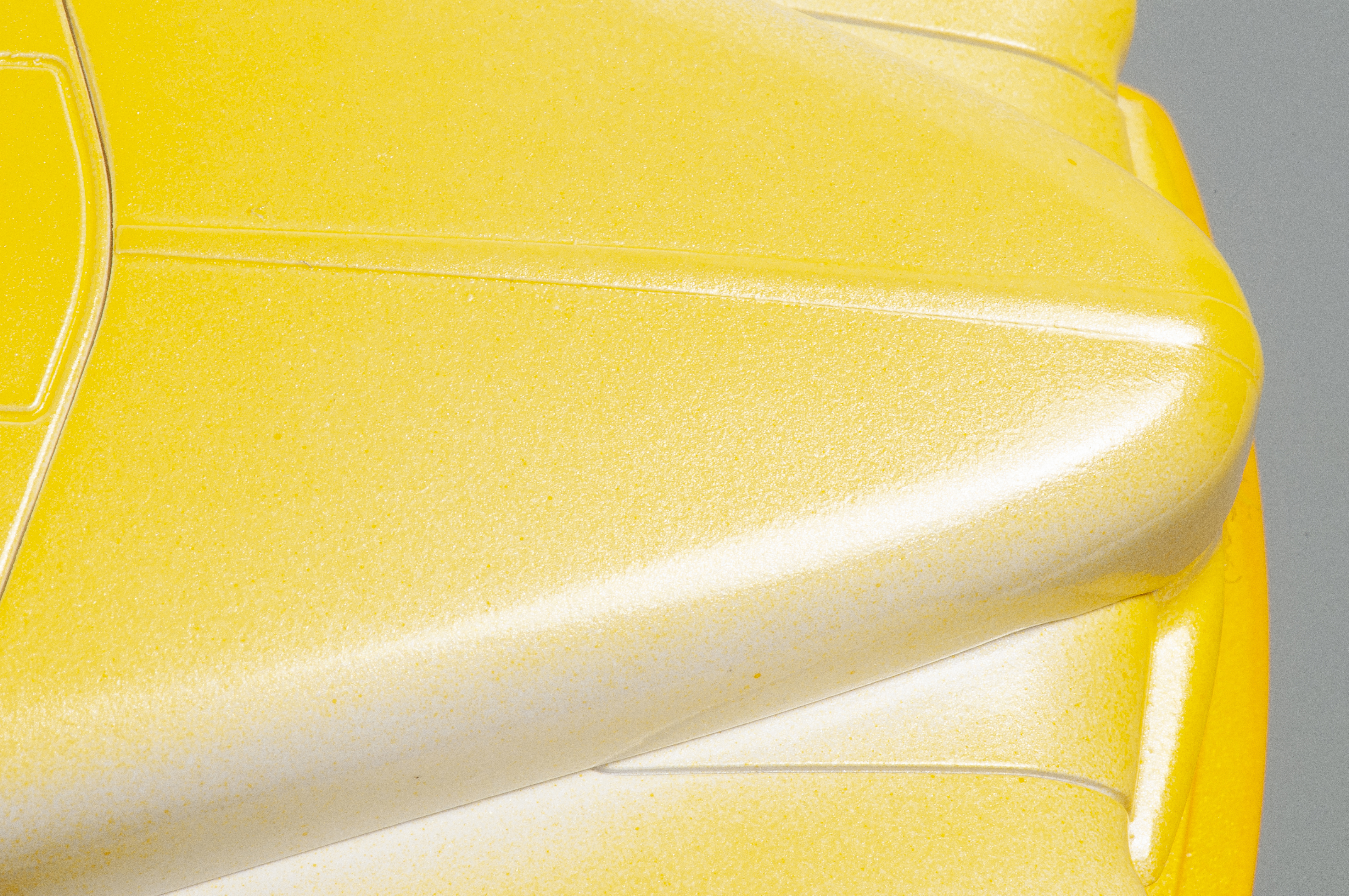

Bonus tip! As paint dries, it contracts. Even the glossiest, most flawless paint applications will develop a very fine “orange peel” texture. Look carefully at the front edge of the hood and the light reflection and note the slightly textured appearance. It’s not terrible, and you could choose to leave it at that. However, if you want to take your model to the next level, you can remove the orange peel. To do that, you’ll need a rubbing compound. See how to make rubbing compounds work for you here.
