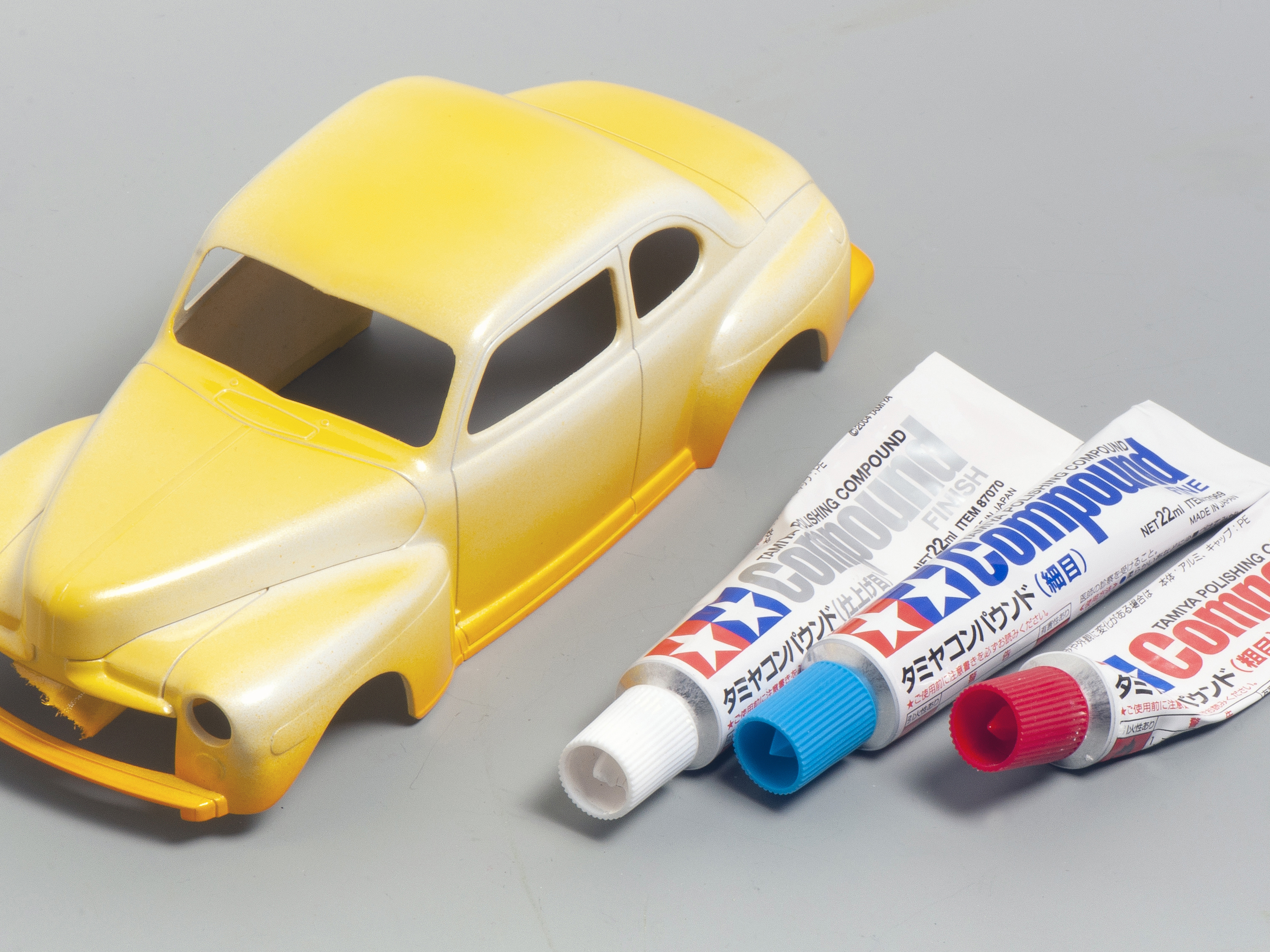

Rubbing compound is a paste with a fine-grained abrasive particles that minimize orange peel. For hobby paint finishes, Tamiya’s coarse, fine, and finish rubbing compounds work well. Mr. Hobby also offers rubbing compounds in three grades, including fine and super-fine.

Begin with the coarse compound, applying it with a soft cloth and using gentle pressure. Work one area at a time. For instance, on a car, start on the hood, roof, or trunk. It may take four or five applications on a single area over the course of 15-30 minutes before you get the glossiness you desire. Then follow with single applications of fine and then finish compounds, polishing until you get uniform and mirror-like reflections.

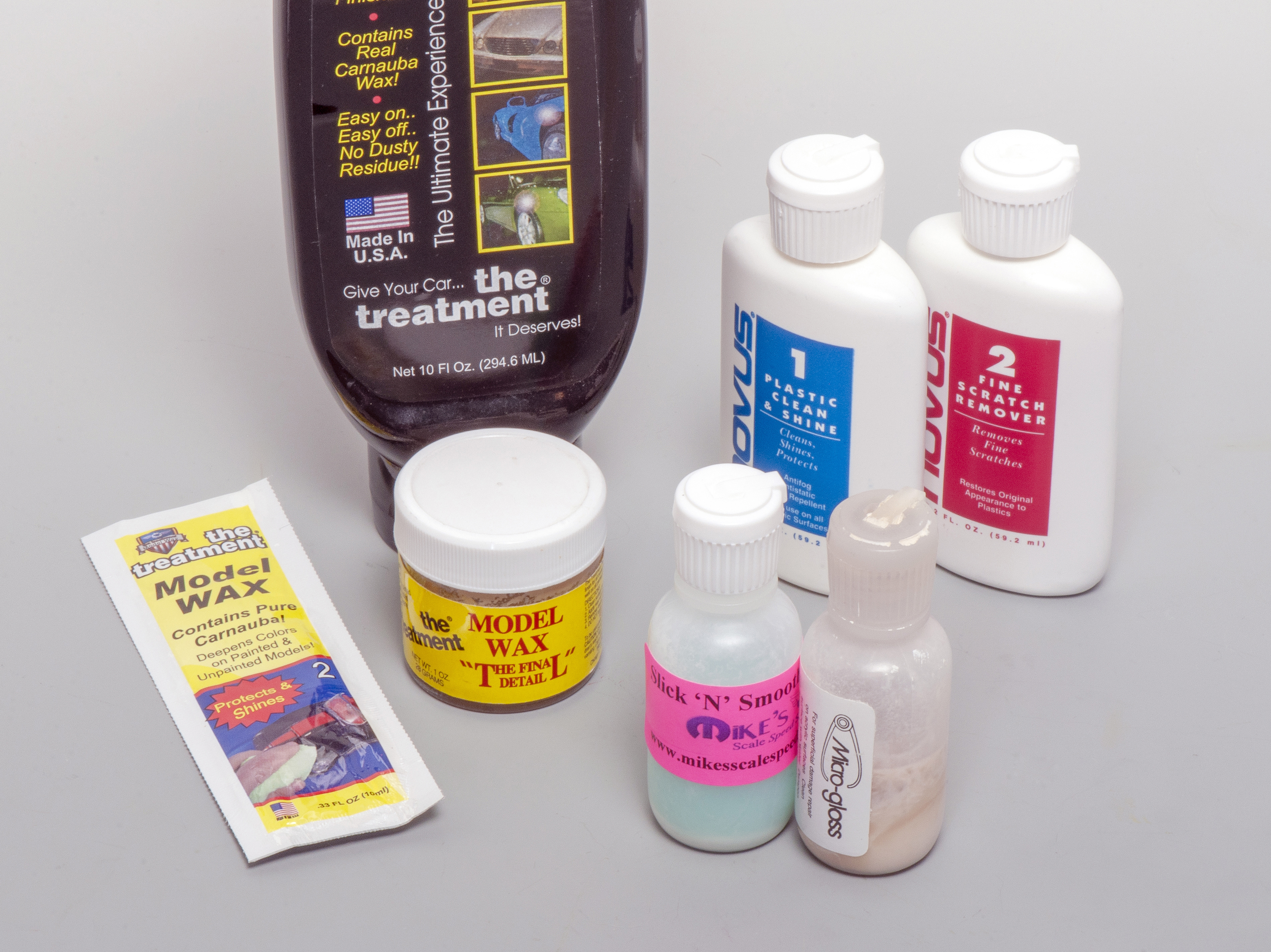

The last step is to apply a hobby wax. My go-to is The Treatment. It’s no longer sold in jar size, but you can find it in small packets (just Google search The Treatment model wax). Other modelers swear by Novus No. 1 and No. 2 compounds. And if you make it to scale model shows, there are often plenty of choices from the vendors.

Apply your choice of wax in a circular motion with a soft cloth, continuing to polish until it works into the surface and remaining surface wax becomes stiff. Then wipe off the excess with a second soft cloth and buff the result. Move on the next section of the model and repeat the process until all surfaces have been waxed.
