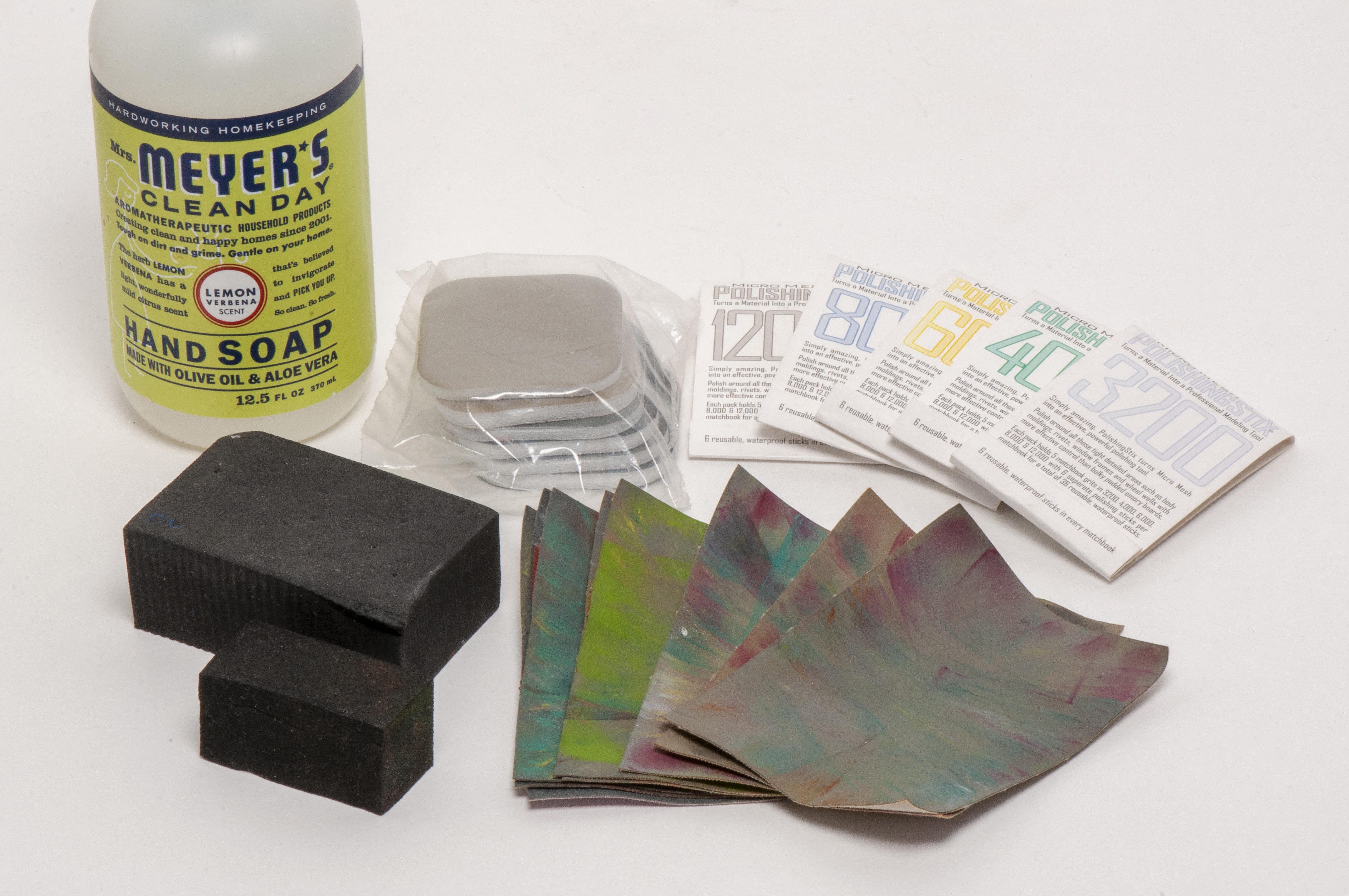

Let’s say that despite you best efforts, your model has heavy orange peel (a texture that can develop when paint dries) and/or a dull, grainy finish right out the paint booth. You’ll need polishing pads in abrasive grits ranging from 1800 to 12000. Slightly soapy water in an old soap dispenser makes an excellent lubricant during polishing.

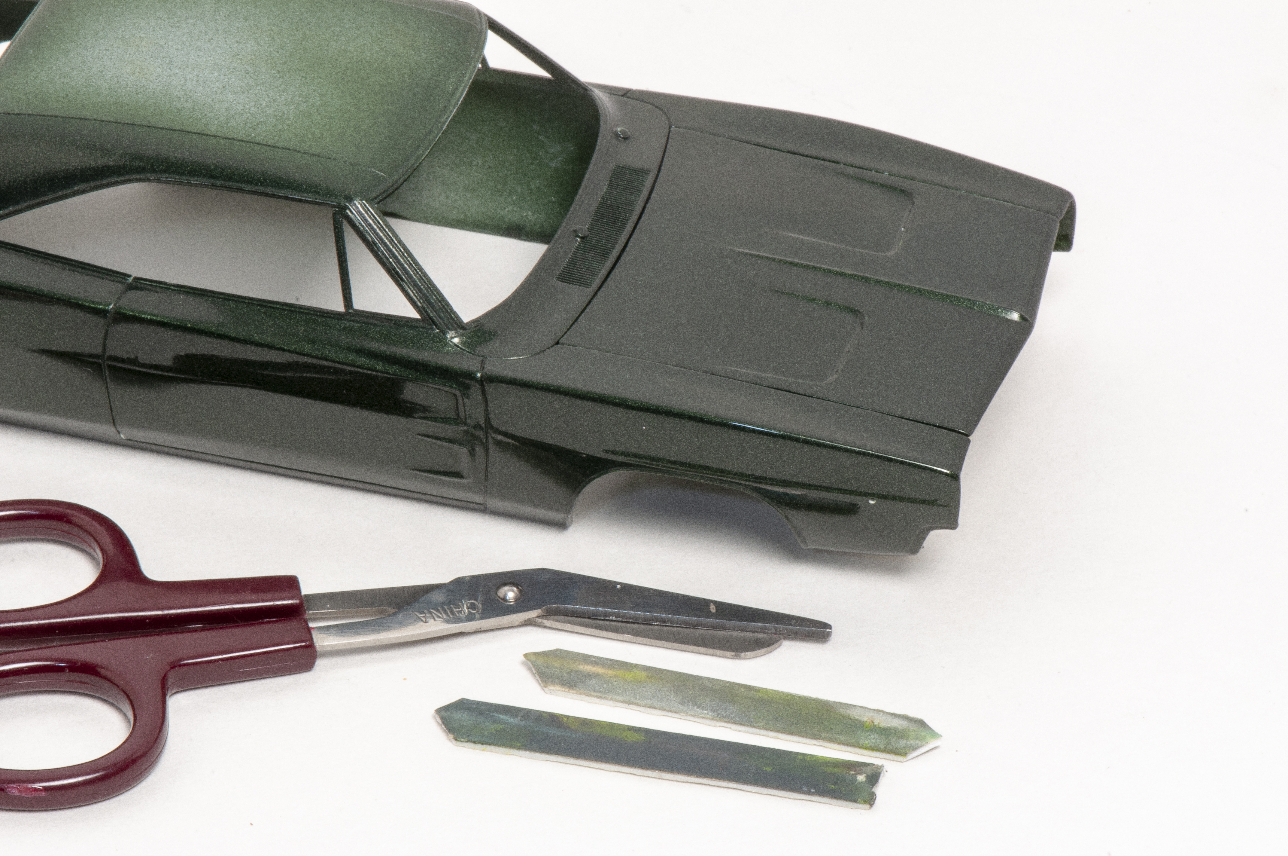

While polishing pads or cloths are good for most surfaces on a model car body, they have trouble reaching smaller recessed surfaces that you can find, like the door scoops on this 1968 Dodge Charger body. The same challenge applies to other sorts of models, such as airplane fuselages. This is where polishing sticks work best. I cut off the used edges of polishing sticks to expose new sections of fresh grit.

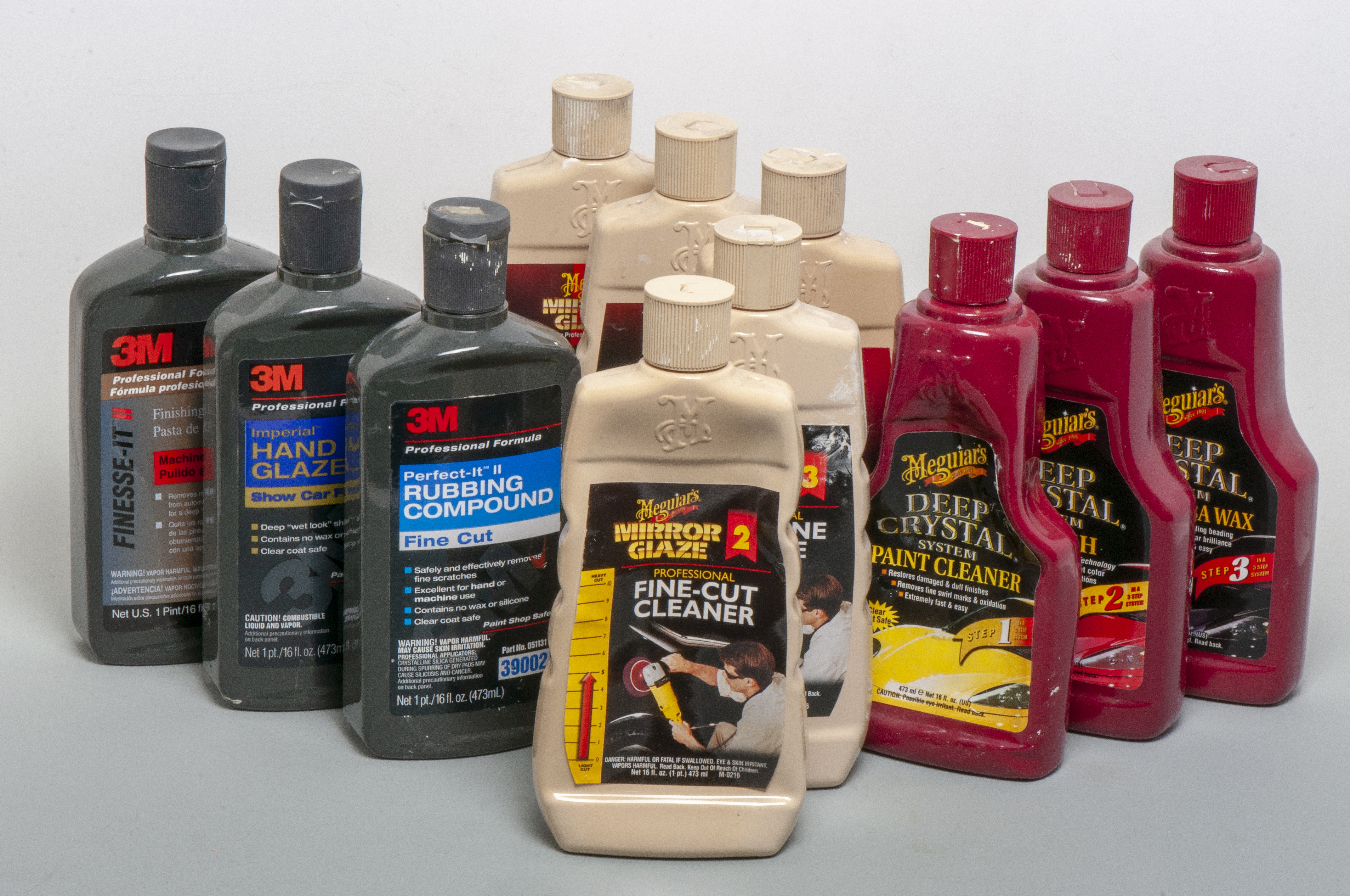

If you have chosen automotive paints rather than hobby paints for your project, you should also consider using automotive paint finishing compounds. They are more expensive than hobby equivalents but will last you a lifetime. Consult your local automotive paint expert for the best choice and try to stick with one brand for your rubbing and finishing compounds, glazing or swirl remover, and finish wax.

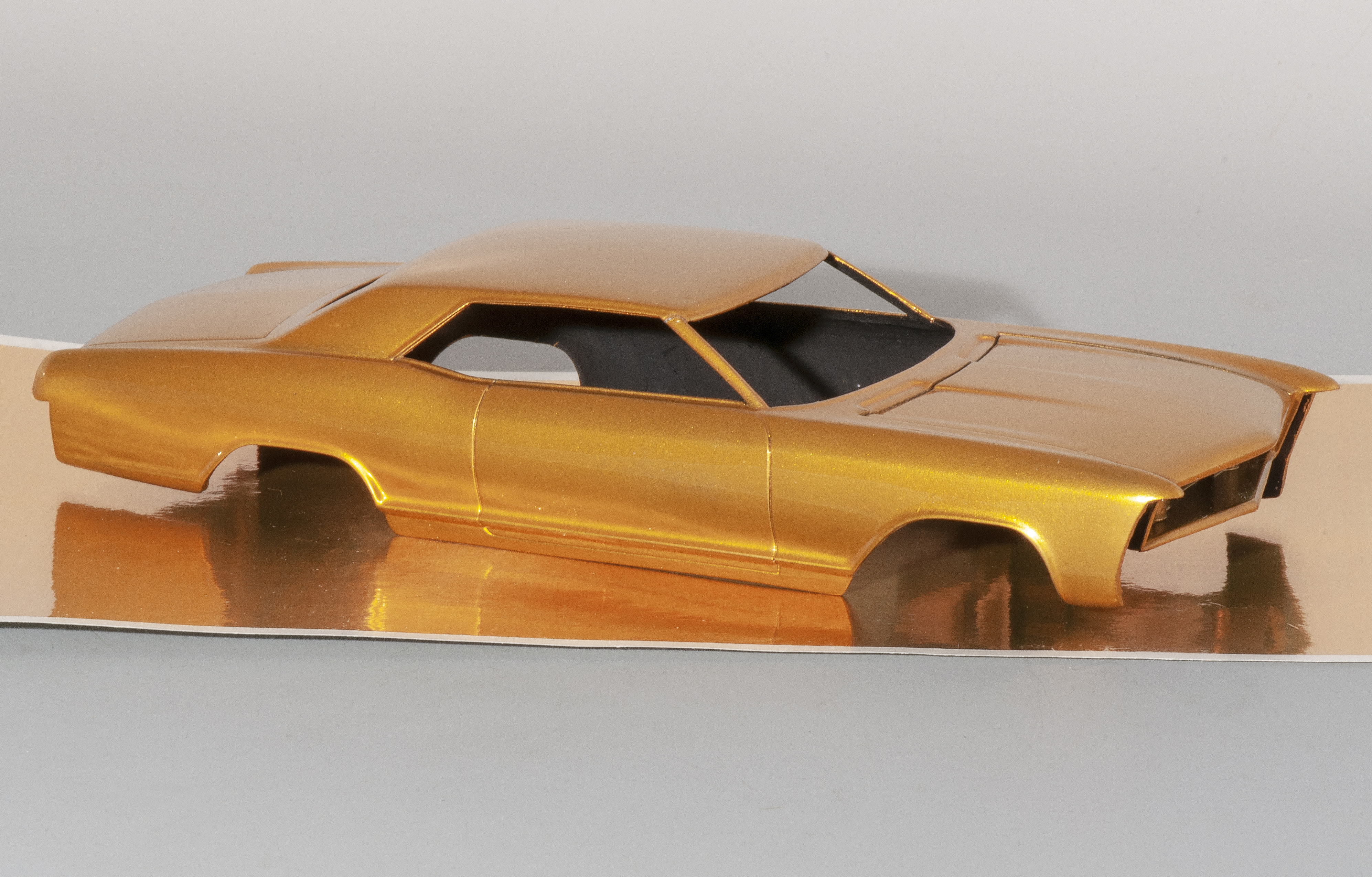

On this chopped Riviera, I tried to eliminate the orange peel on the horizontal body surfaces with rubbing compounds [link to rubbing compounds story], but it didn’t quite do the job. So I backtracked and used the 3400- to 12000-grit sanding pads, followed by a repeat of the rubbing compounds, swirl remover, and wax. Now all the surfaces show a glass-smooth finish.
