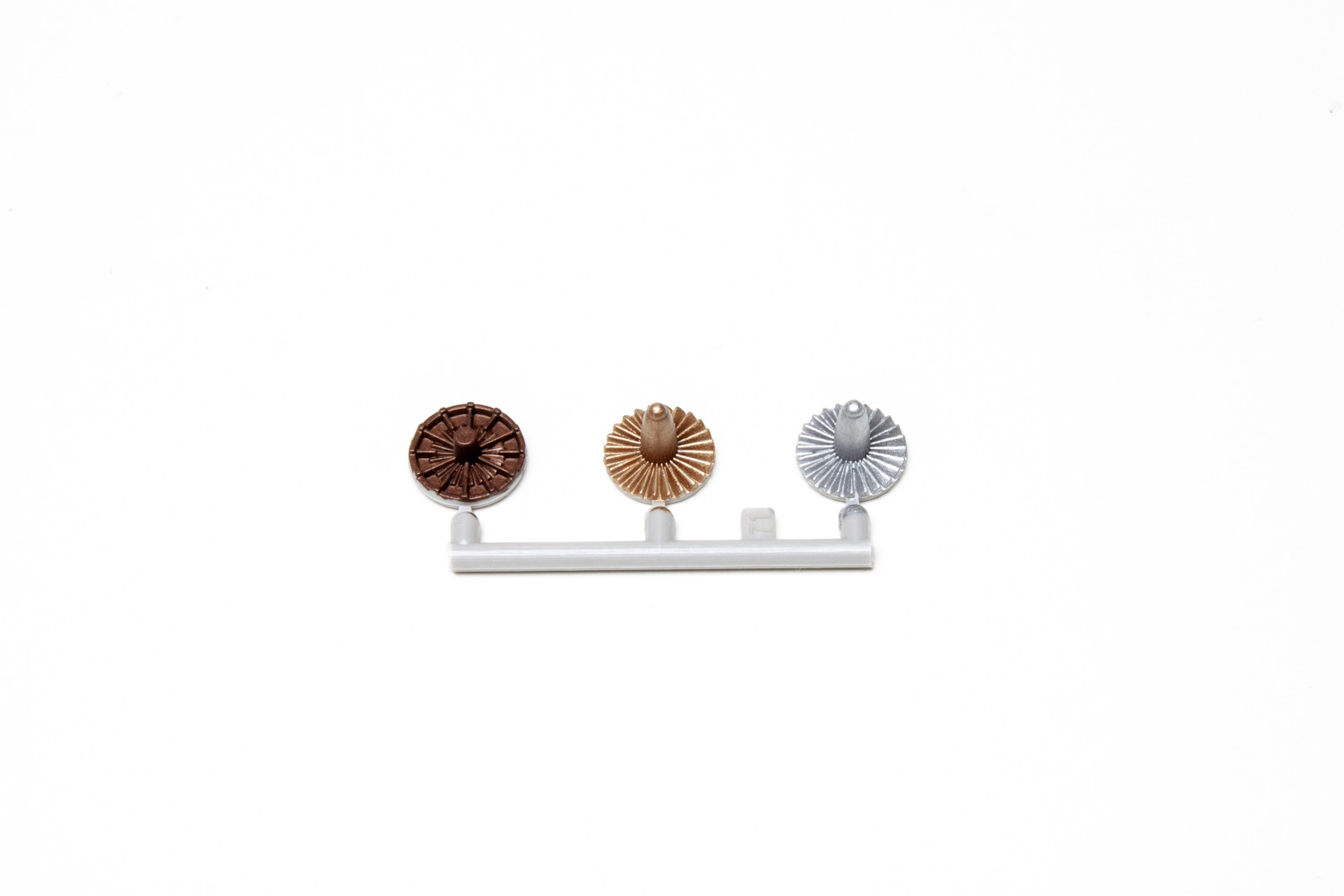

My first test was to brush paint these engine parts with metallic colors Burnt Iron, Copper, and Silver. They covered well and dried smooth with no visible brush strokes.

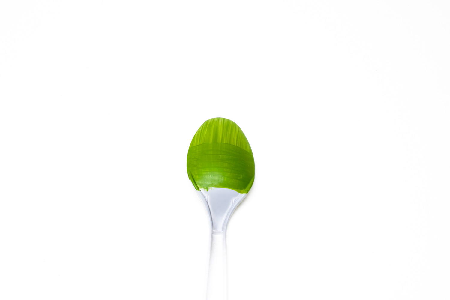

Next, I tried brushing a larger surface. The spoon was first primed with Mr. Surfacer 1200. Then I brushed on the first coat of Bright Green. A second coat was added to the bottom half and coverage was better, but the finish was no longer smooth.

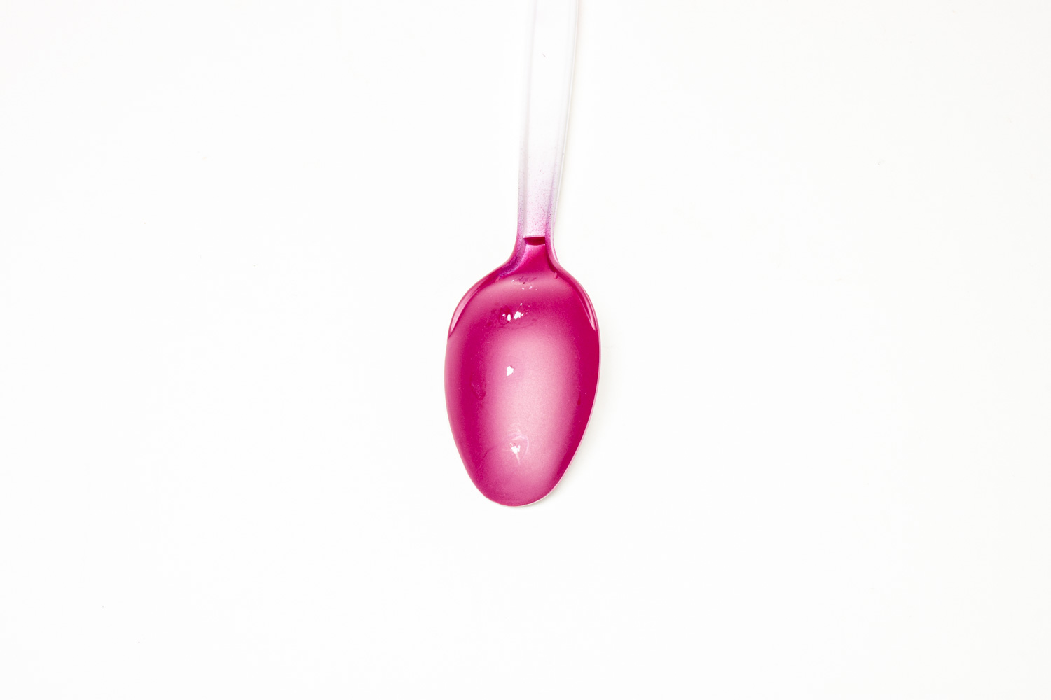

This is Magenta (No. ATOM-20033) from the basic color set airbrushed in a couple of medium coats with about a 1:1 mix of Mr. Leveling Thinner. Coverage was excellent, and the surface dried to a perfectly smooth finish. The scratch marks are from puddling some decal softening solutions on and scratching with a toothpick.

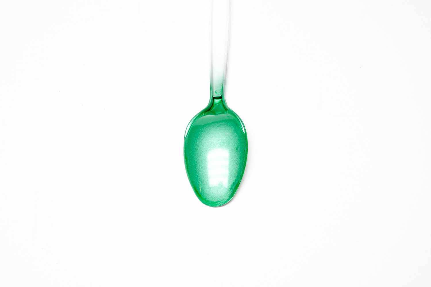

Here is Aotake Green (No. ATOM-20175) mixed about 1:1 with water but sprayed a little too heavily on the second pass. The color tended to blow off and pool at the edges. It was later dipped in Future floor finish just to see how it would affect the color.

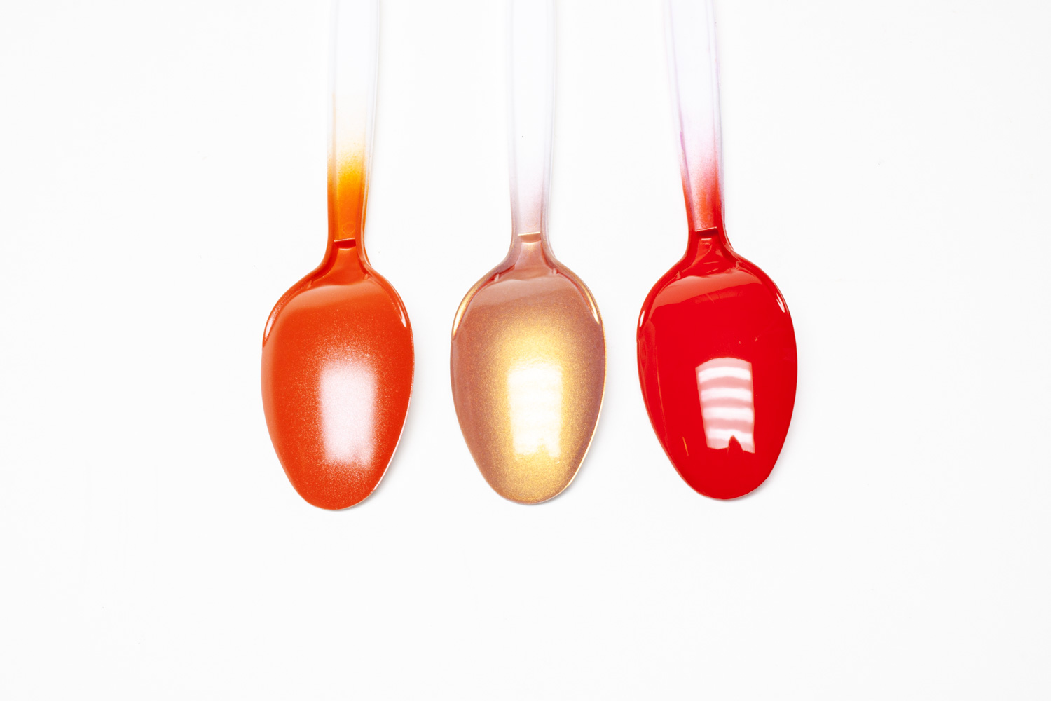

I tried several different clear coats to see how they would react. The spoon on the left is Orange (No. ATOM-20027) with two coats of Tamiya Pearl Clear (No. TS-65). It didn’t work as well as I had hoped. In the middle is Gold Pink (No. ATOM-20171) under Tamiya Clear (No. X-22) and the results were much better. The best finish came from the Ammo Cobra Motor 2K Clear.

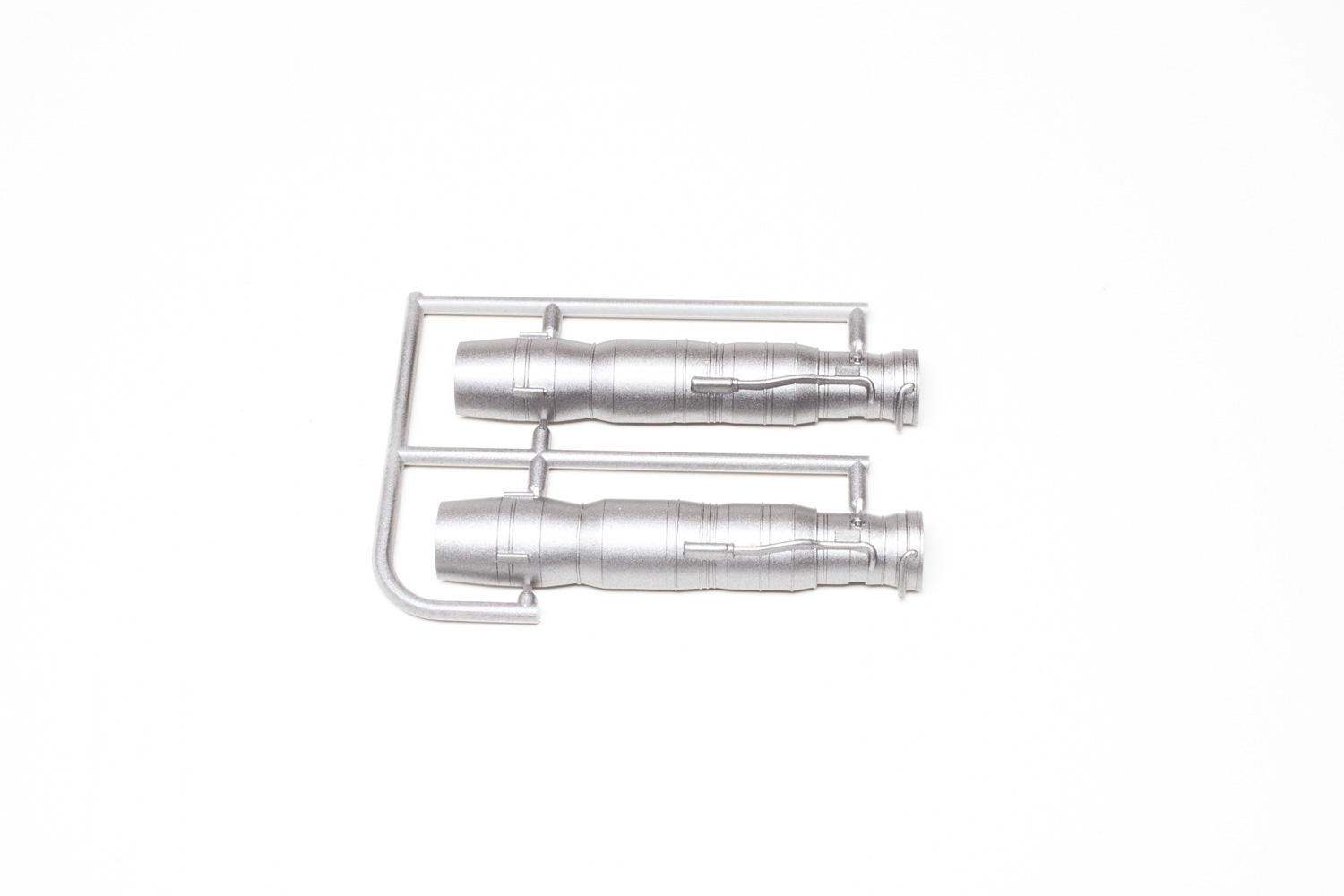

The top part was painted with Gunmetal thinned with water at about a 2:1 paint to thinner. It sprayed easily, covered well, and dried with a slightly grainy texture. The lower part was painted with Steel but thinned with Mr. Leveling Thinner at about the same ratio. I didn’t notice any difference in performance between the two thinners.
FSDWBB0924_12
Next, I tried the top piece in Aluminium straight from the bottle. It didn’t spray quite as easily, but it didn’t seem any different once dry. I also tried making a wash and spraying a narrow line and both seemed to work satisfactorily. The lower piece is Brass (No. ATOM-20173) thinned at about 2:1 with isopropyl alcohol. Again, it sprayed out well, covered in about two medium coats, and dried with the same slightly grainy texture.

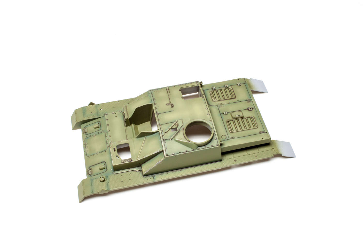

I haven’t built a tank model in probably 40 years and don’t have many in my stash, so excuse me for painting a German tank with Russian colors! After priming with Mr. Surfacer, I gave it a base coat of Russian Green (No. ATOM-20071) and then added shading with Deep Green (No. ATOM-20098) and some highlights with Yellow Green (No. ATOM-20073).
FSDWBB0924_14
I added a wash with Black Brown (No. ATOM-20063) and then some chipping with steel and burnt iron. I’m not happy with the chipping, but that’s more me not really knowing the process. Overall, though, I think the result is pretty good for an amateur.

For my first test, I took engine parts from a Fujimi F-14 kit and brush-painted them with Burnt Iron (No. ATOM-20169), Copper (No. ATOM-20170), and Silver (No. ATOM-20164). I chose metallics because they are typically the hardest colors to brush paint. These brushed on easily straight from the bottle, covered the unprimed parts evenly, and leveled out without leaving brush marks. The metallic particles aren’t quite as fine as Alclad II, but they are smaller than those in Tamiya acrylics. To my eye, the copper looks more gold than copper.
Pleased with those results, I moved on to a larger surface. I primed a spoon and did a first pass with Bright Green (No. ATOM-20084) straight from the bottle. The first coat dried smooth, but coverage was far from adequate. I brushed on a second coat perpendicular to the first, and while the coverage was nearly there, the finish was no longer smooth. I’ll have to experiment a bit more to see if I can get better results — thinning, technique, and a different brush may all affect the outcome. For now, I’ll just stick to airbrushing a larger surface.

For my airbrushing tests, I used a Paasche VL with a medium tip and air pressure dialed to 15 psi. First up was Aluminium (No. ATOM-20165) straight from the bottle. It seemed a little thick and looked somewhat splotchy going on, but it dried evenly with just a slight texture. Next, I tried Brass (No. ATOM-20173) thinned about 2:1 paint to thinner with isopropyl alcohol. It sprayed easier, covered just as well, and dried with the same light texture as the aluminum. I also tried Gunmetal (No. ATOM-20167) thinned with water and Steel (No. ATOM-20166) thinned with Mr. Leveling Thinner at the same 2:1 ratio. All seemed to perform equally well with no discernable difference in finish.
For my next couple of tests, I used a thinner mix and varied the application methods. A mix of about 1:1 with water and a mist coat followed by a heavy wet coat with little to no dry time in between had the color running off and pooling at the edges. The same 1:1 mix with Mr. Leveling Thinner and a slower buildup of color gave a nice even finish. Isopropyl alcohol had similar results with a mist coat followed by a slightly wet coat.
