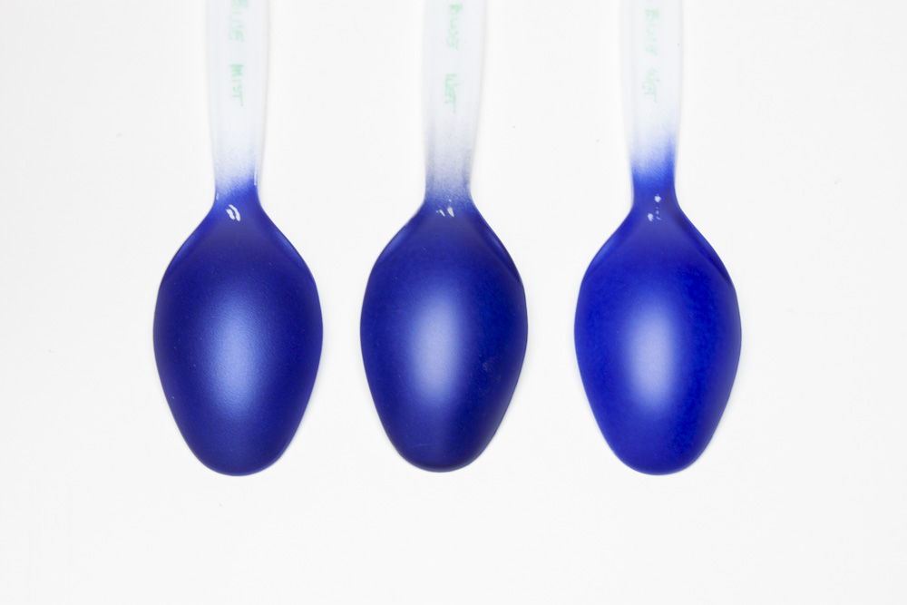

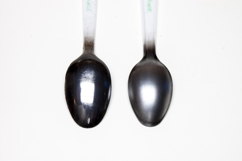

Sprayed with paint directly from the bottle (no thinner), the spoon on the left received mist coats and showed a little texture after drying. The center and right were sprayed with a wet coat and dried smooth.

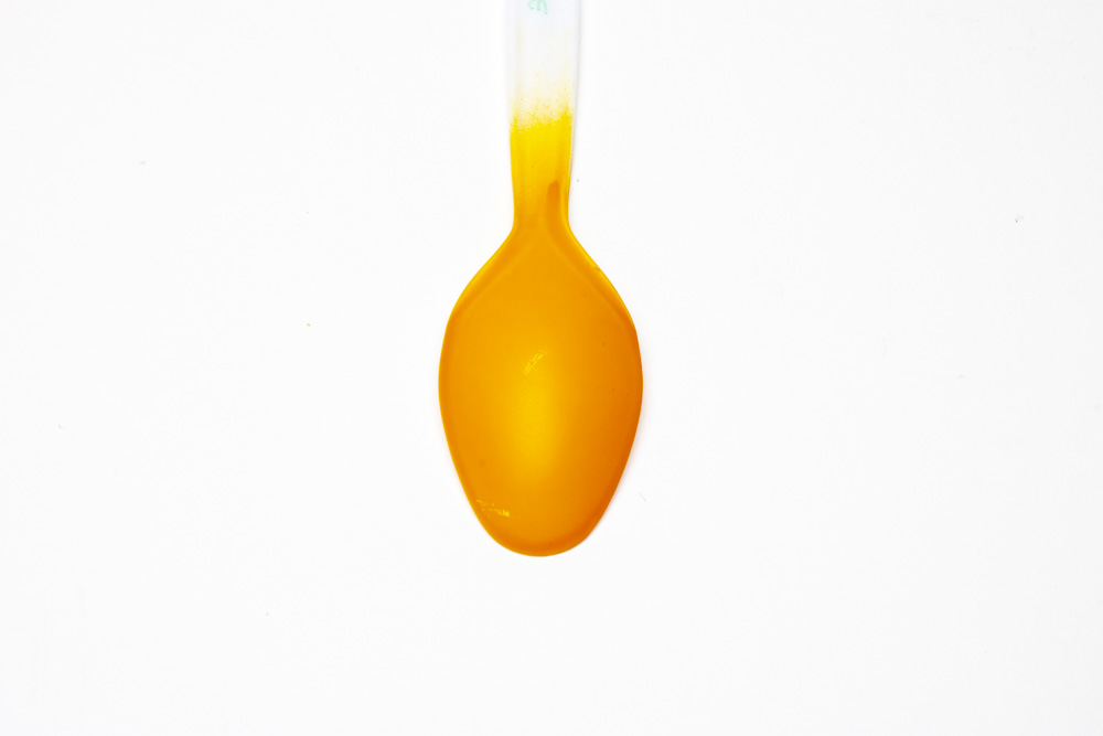

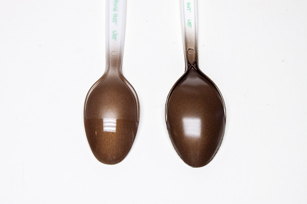

Here is Copper Brown Metallic (No. A.MIG-0356) thinned at 2:1 with the Cobra Acrylic Thinner (No. A.MIG-2260). The spoon on the left is over white, and the one on the right is over black. Notice the slight color difference.

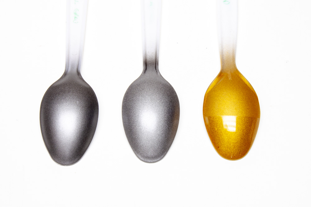

The metallic colors sprayed beautifully and gave an even finish. I used denatured alcohol to thin the Alcoa Aluminum (No. A.MIG-0345; center) and Mr. Leveling Thinner on the BBS Gold (No. A.MIG-0355; right).

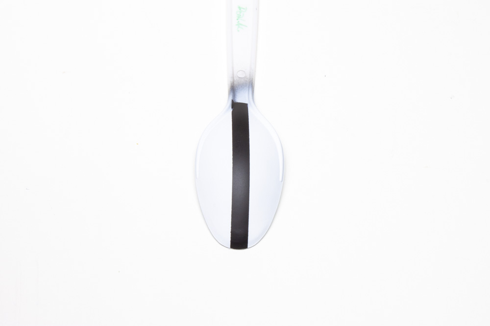

To test the coverage, I primed a spoon black and then painted it Pure White (No. A.MIG-0300). It didn’t take long to get a solid white coat.

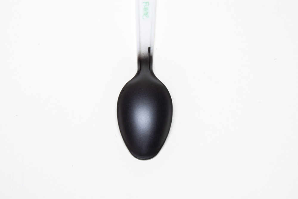

Cobra Motor Paints are meant mainly for airbrushing, so that was the focus of my tests, although I did try to hand-brush a couple of items, also. All the tests were done with a Paasche VL, No. 3 (.75mm) needle, and sprayed at about 15 psi.
Initially, I tried spraying paint straight from the jar on a primed spoon. After several light passes with some drying time between, I had a surface with a slight texture — not bad, but still noticeable. Next, I went with a light first pass but continued to build until I had a wet surface. This dried to a perfectly smooth finish. My third test was sprayed similarly to the second, but I left the spoon bare plastic to see if the paint reacted differently to the primed spoons. After drying overnight, I tried scratching the surface with my fingernails and found the finish quite durable, and no difference between the primed and unprimed samples.

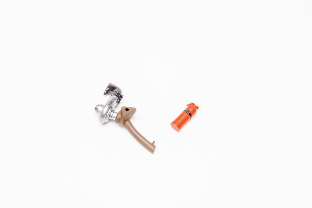

Brush-painting with Cobra Motor Paints is probably best kept to small, detail items. However, the paint’s self-leveling properties kept brush strokes to a minimum.
Hand-brushing
I only tried brush-painting a couple of smaller parts to see how well Cobra Motor Paints would work. The self-leveling chemistry minimized brush strokes. The red I brushed on the fire extinguisher and the exhaust color both covered well. The aluminum color took more work to get an even coat. All these colors are flat, so if your detail needs to be glossy — like the fire extinguisher — you will need to add a clear coat.

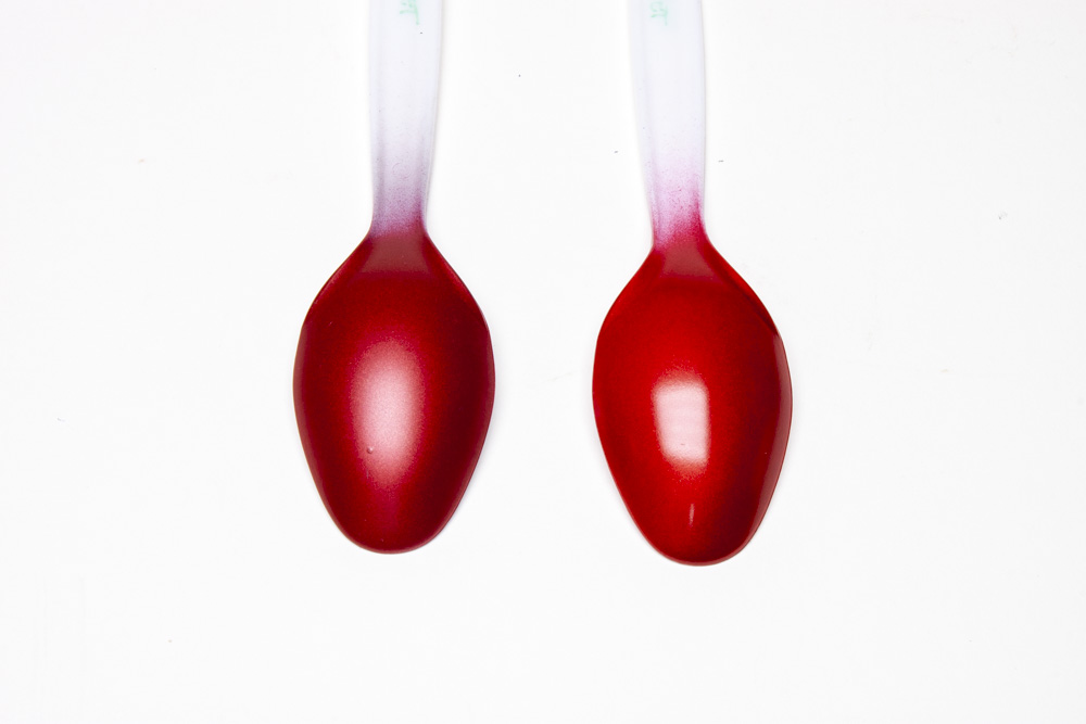

Because it’s a water-based acrylic, I tried thinning Cobra Motor Paints with water. It worked just fine and didn’t seem to leave the paint any less durable than the other examples.

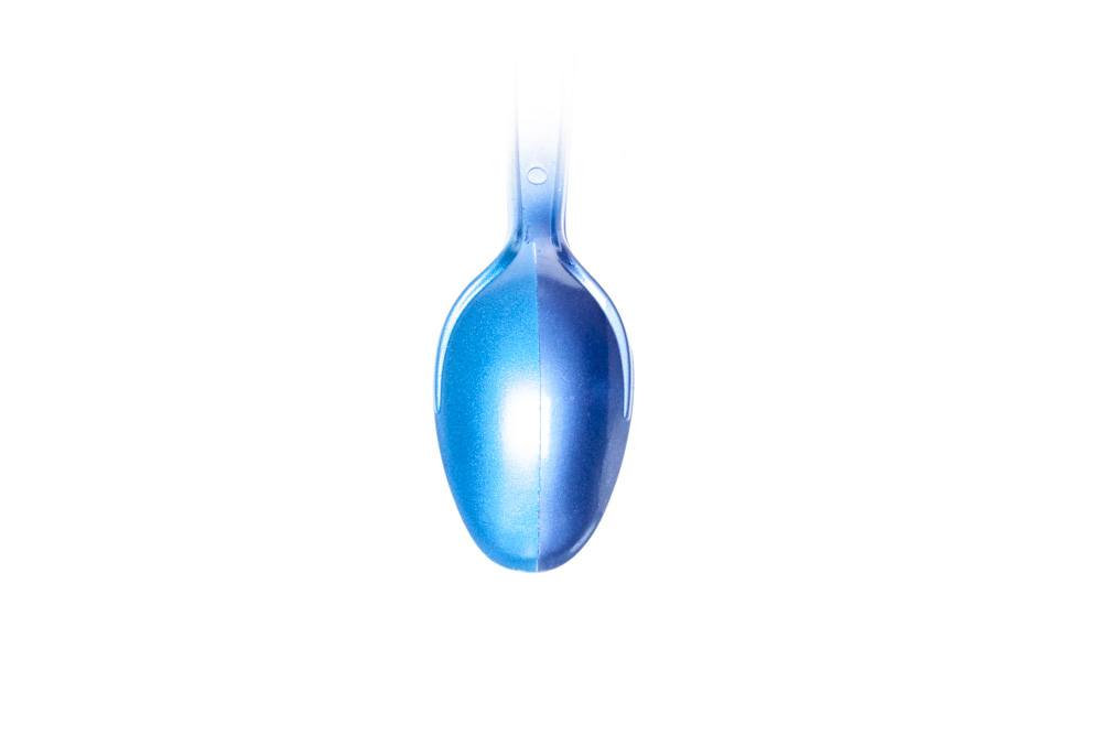

Comparing MCW Guardsman Blue (No. 6436; right) to the same color from Cobra (No. A.MIG-0350; left) shows a substantial difference in color. To my eye, the MCW is much closer to the actual color, the Cobra paint seems much too bright. However, paint chips would be required for a definitive answer.

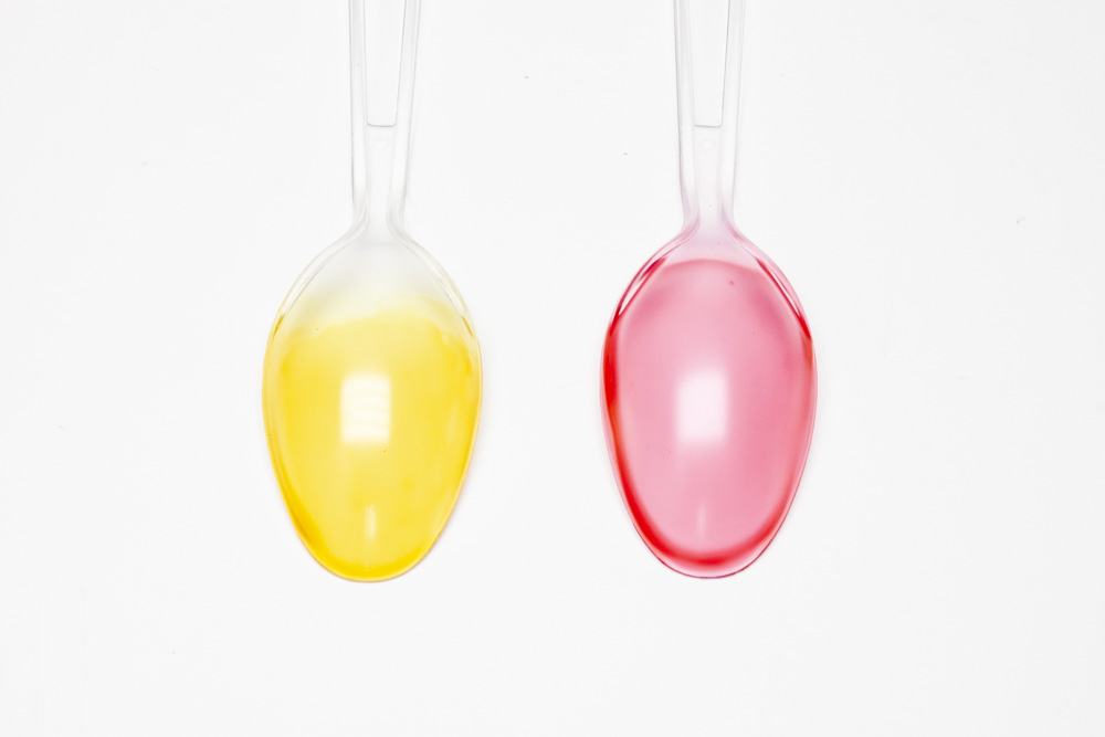

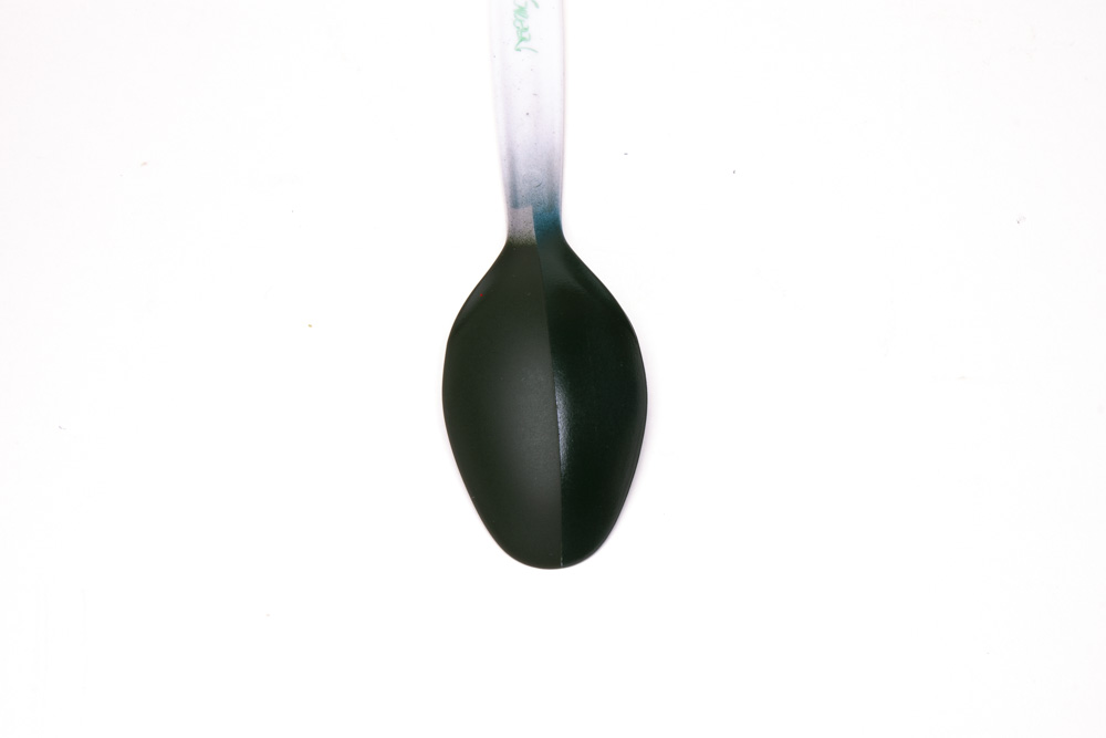

The transparent colors let me down. Granted, you probably won’t be using them on anything this large, but the Yellow Transparent (No. A.MIG-0358) and Red Transparent (No. A.MIG-0360) seemed to take quite a bit to build up proper color density.

Always a topic of debate, it is difficult to know, in many cases, if a paint truly matches a color it is purported to match. In the Cobra Motor Paints line, many of the colors are keyed to certain race cars or teams, so I thought it would be interesting to compare them to another respected brand. In this case, Model Car World, which has a reputation for color accuracy.
You can see a marked difference between the MCW and Cobra paints, especially in the Guardsman blue (used on the ’65 Shelby Cobra race cars). To my eye, the MCW is much closer to the real thing. The British racing dark green is closer in person than it appears in the photo, and I would hazard a guess that it looks different under the clear coat, too.

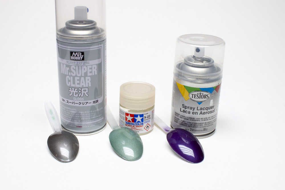

From left to right: Mineral Grau (No. A.MIG-0346), Metallic Turquoise (No. A.MIG-0349), and Racing Purple (No. A.MIG-0352) with the clear used over each. The metallic particles are very fine and not overpowering.

Ammo also makes an acrylic clear in the range called Crystal Glass (No. A.MIG-0357). The intended clear coat, though, is the 2K lacquer (No. A.MIG-2261). I have never used a 2K clear before, but I can see now why it seems to be the go-to for many top builders. The finish is incredible!
I followed the recommended mix of 2:1:1 clear/hardener/thinner and found that it was easy to use. However, be sure to use a properly filtered respirator with this stuff. A simple mask will not cut it.
My two favorite spray-can clears are Testors Lacquer and Mr. Super Clear. Both worked fine over the Cobra Motor Paints, as did Tamiya Clear (No. X-22) thinned with Mr. Leveling Thinner.

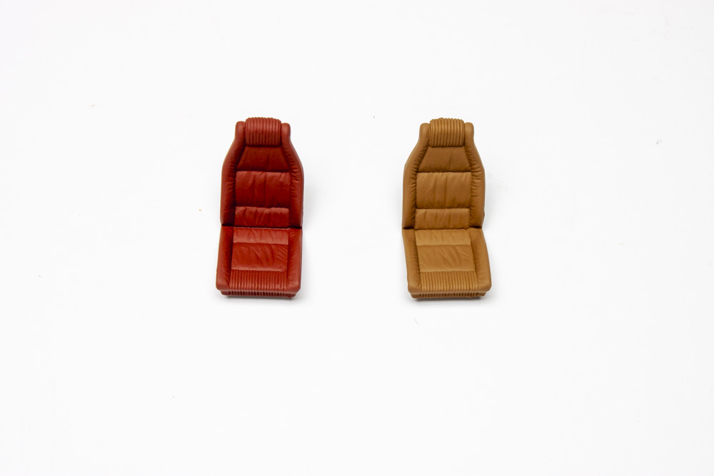

I grabbed a pair of seats from my spares box to test the Reddish Leather (No. A.MIG-0318) and Brown Leather (No. A.MIG-0319) colors for the interiors. As with the other paints in the range, the coverage was excellent, and none of the seat texture or detail was lost.

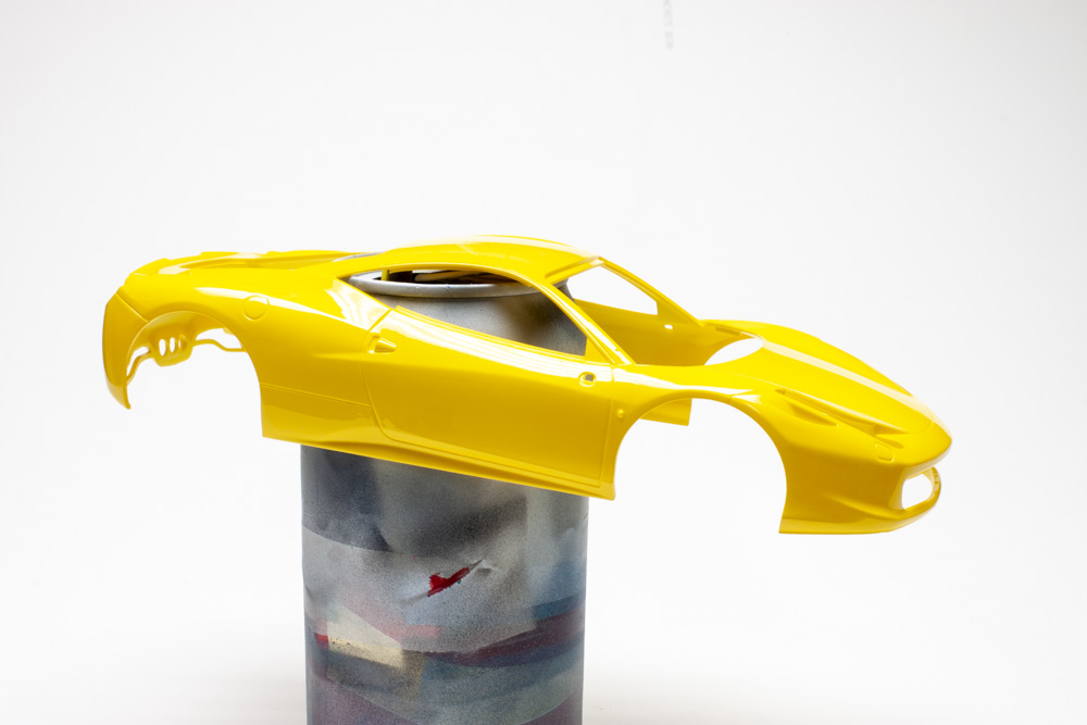

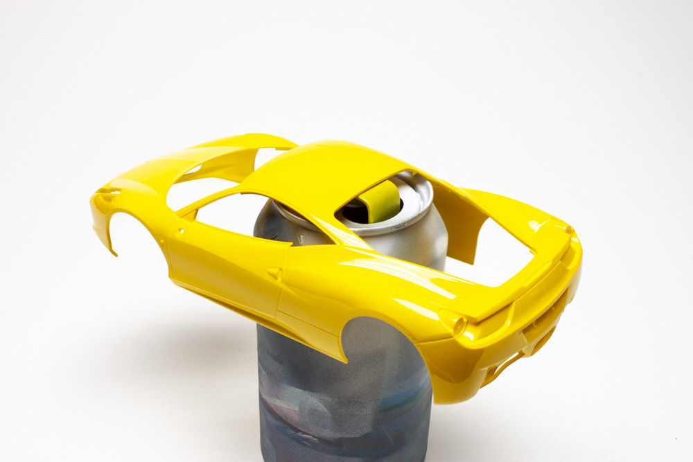

Spoons are a great way to test thinning ratios and application, but the real test is painting a body. This is Giallio Modena (No. A.MIG-0305), thinned about 3:2 paint/thinner with Mr. Leveling Thinner.
FSDWBF1023_16
I sprayed a light initial coat and followed with a second light coat sprayed perpendicular to the first. I repeated the process with successively heavier coats until I achieved an even, wet coat.
FSDWBF1023_17
After letting the body dry for several hours, I airbrushed the Clear Lacquer 2K (No. A.MIG-2261), following the recommended 2:1:1 clear/hardener/thinner ratio. It sprayed beautifully, and the finish is fantastic!
