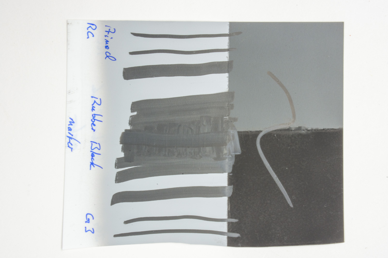

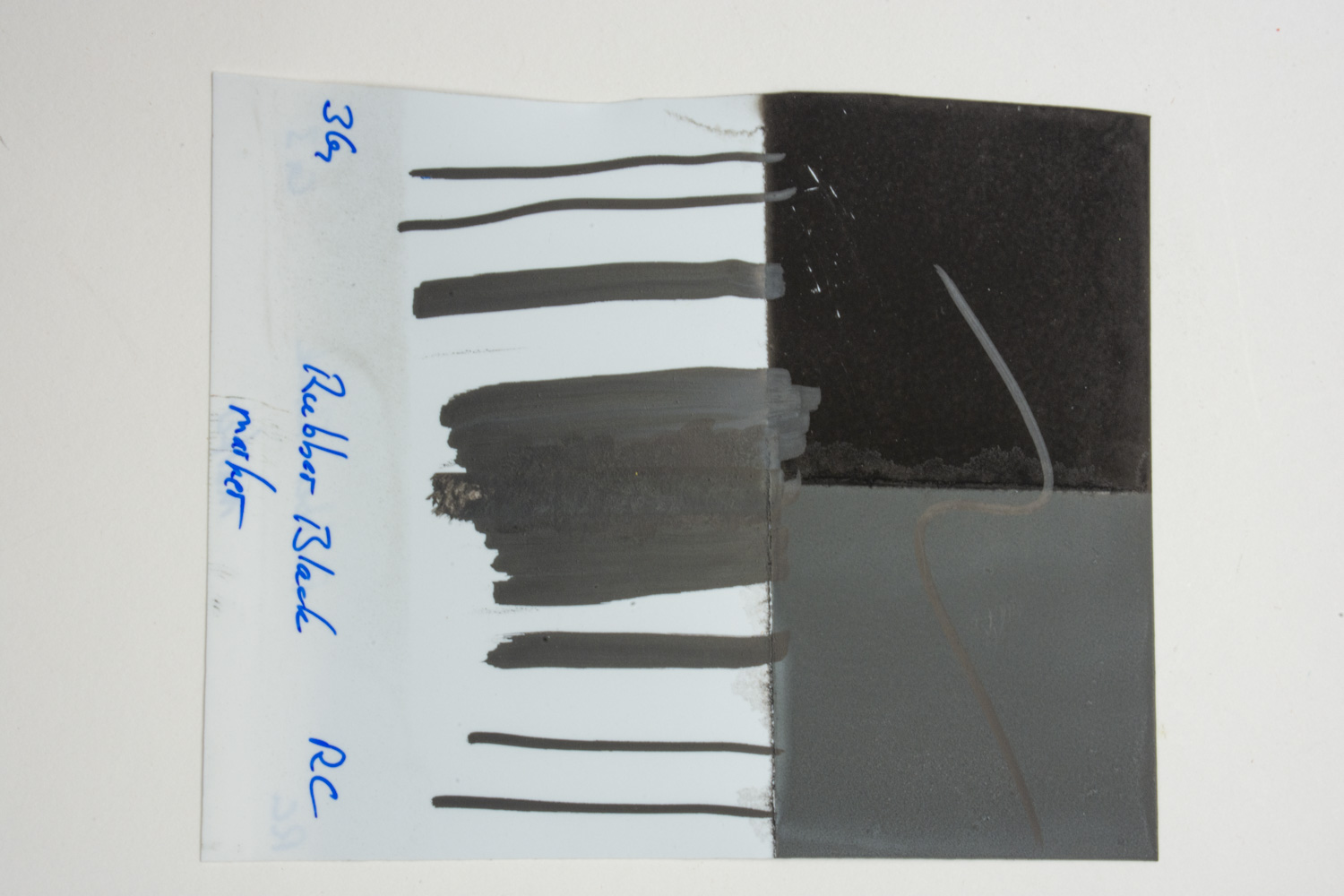

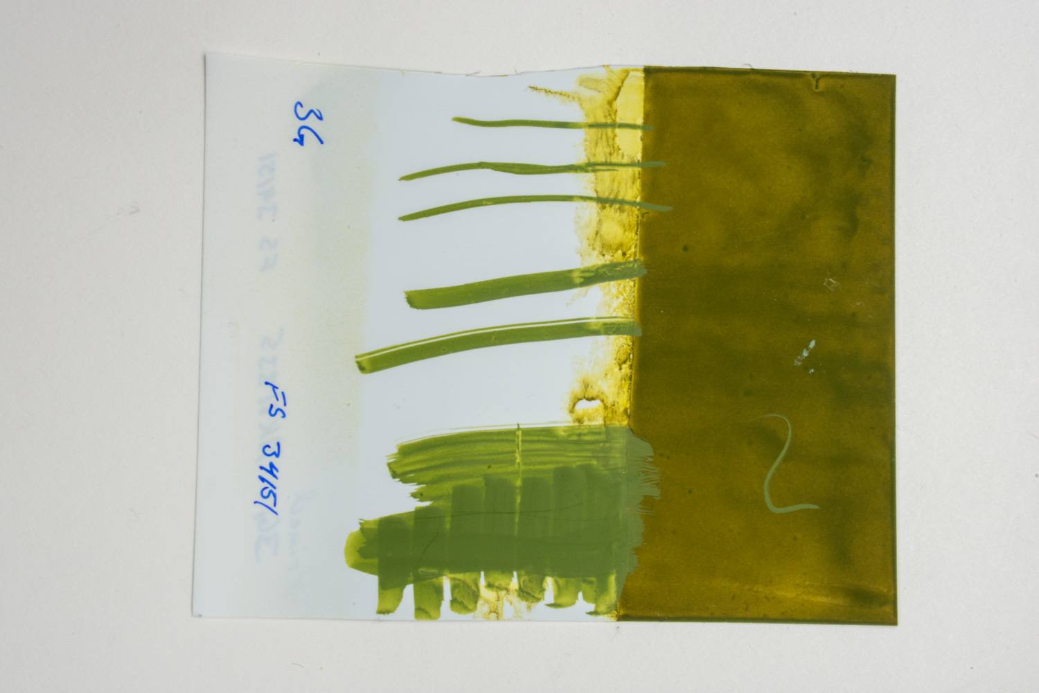

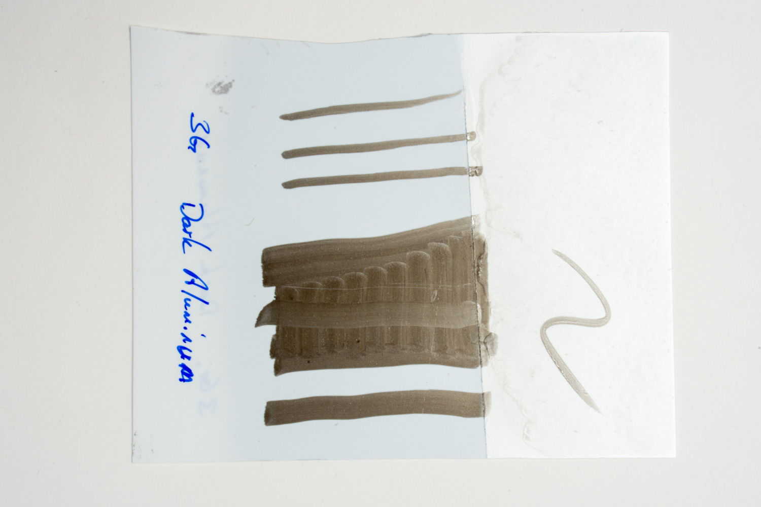

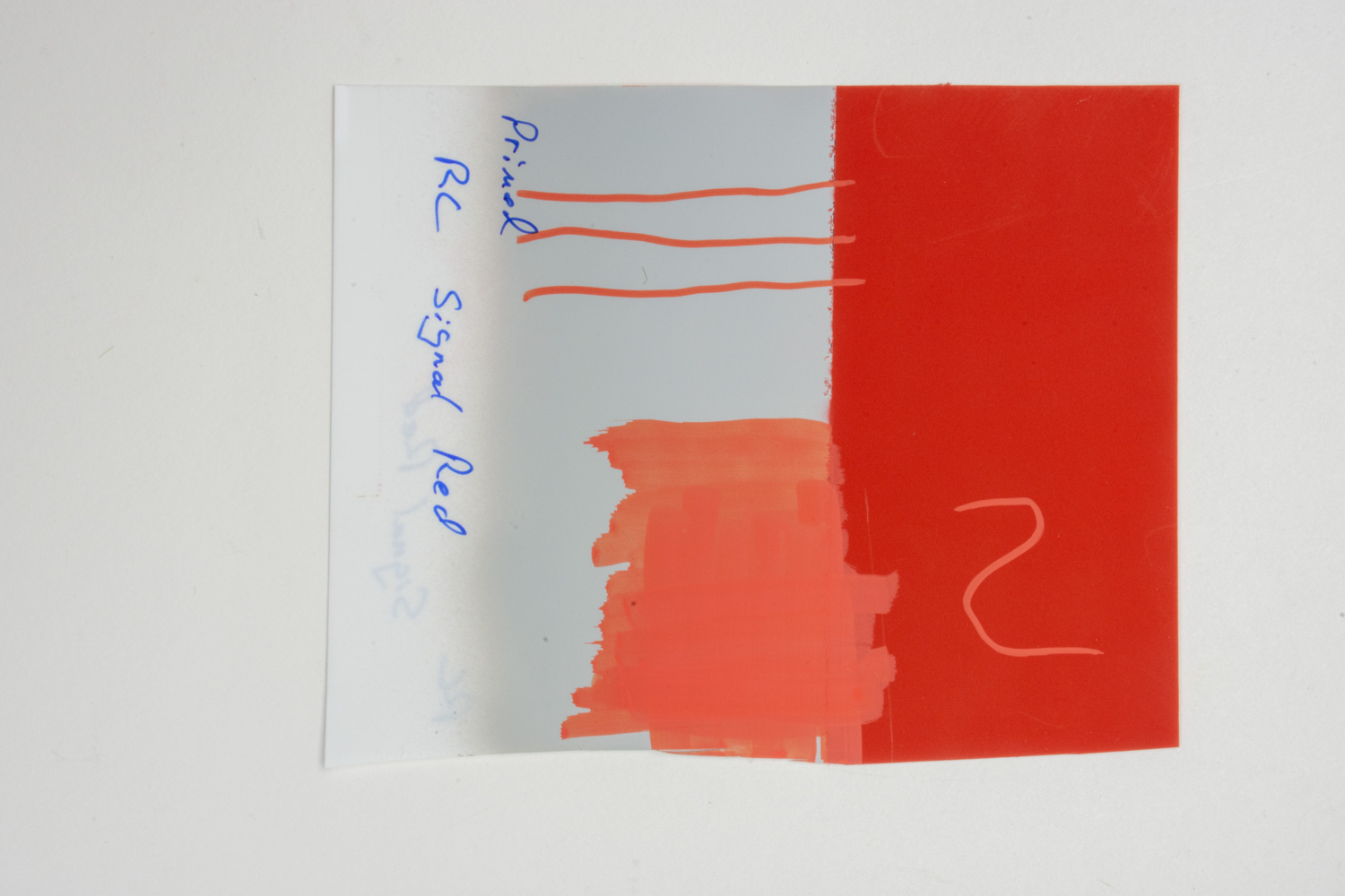

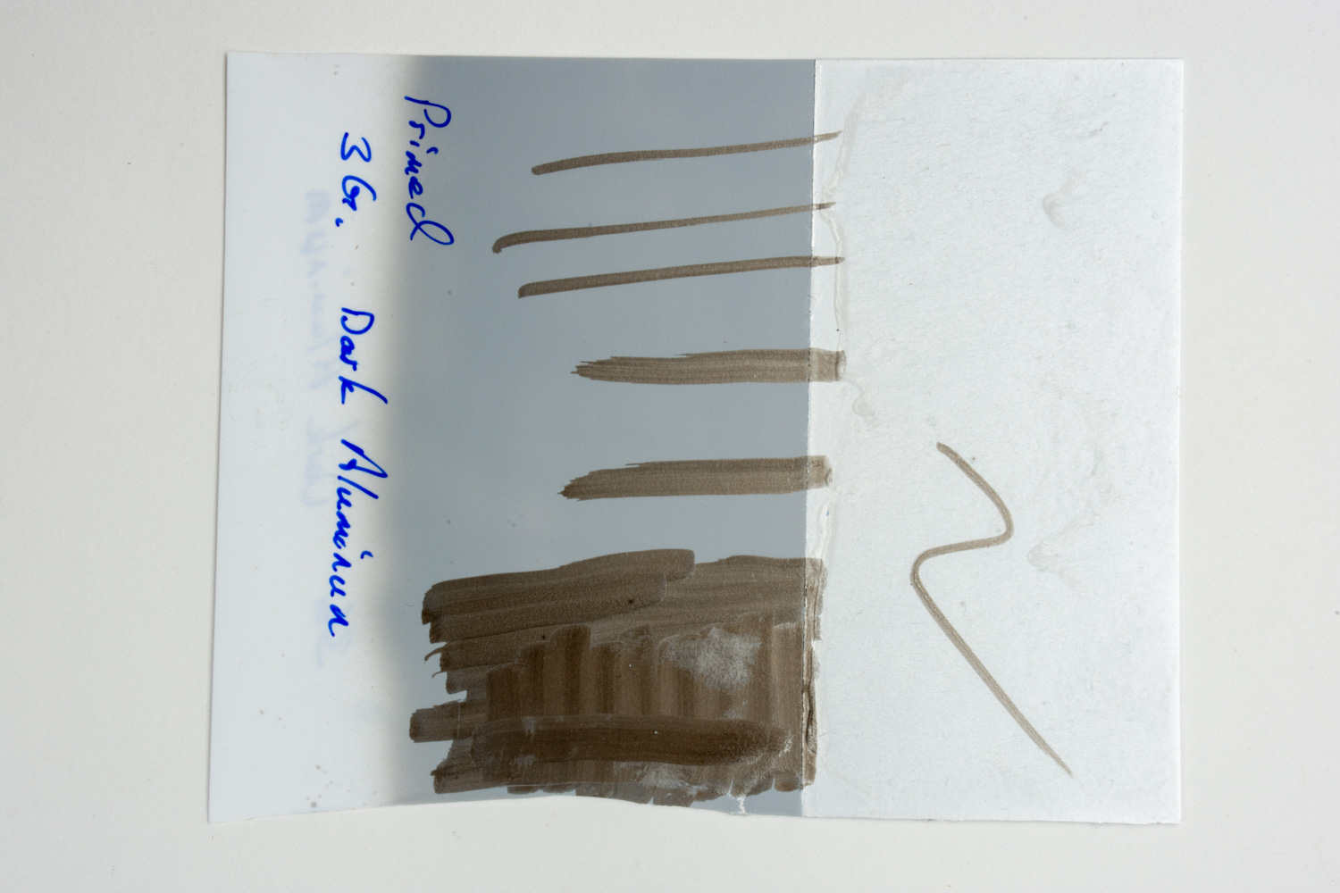

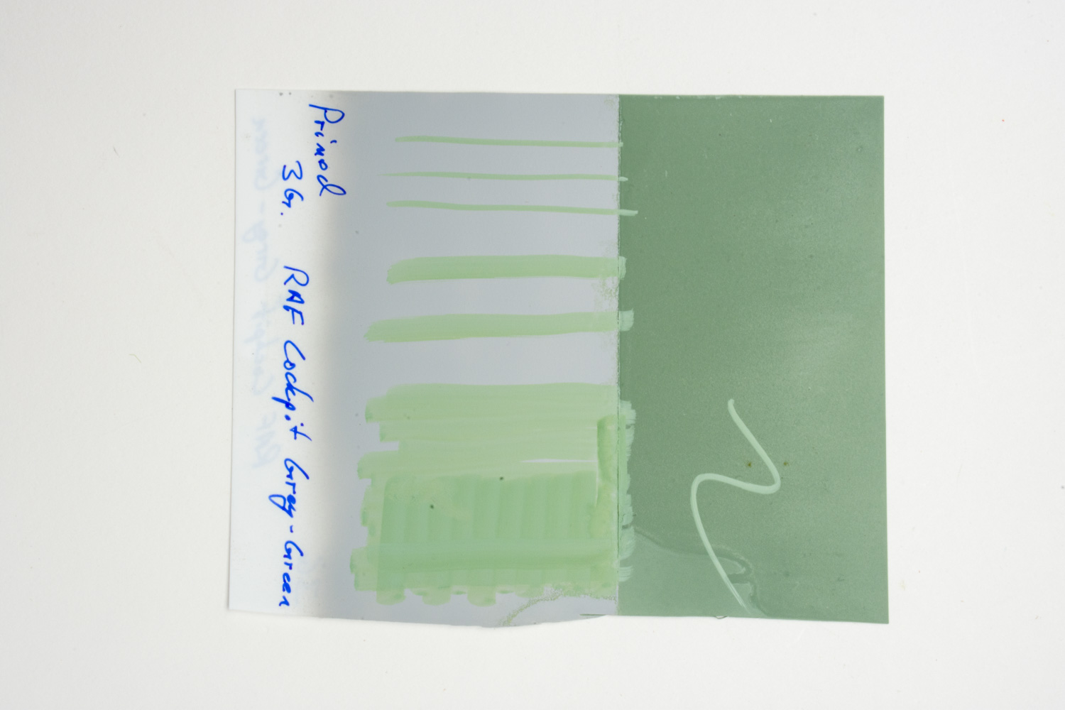

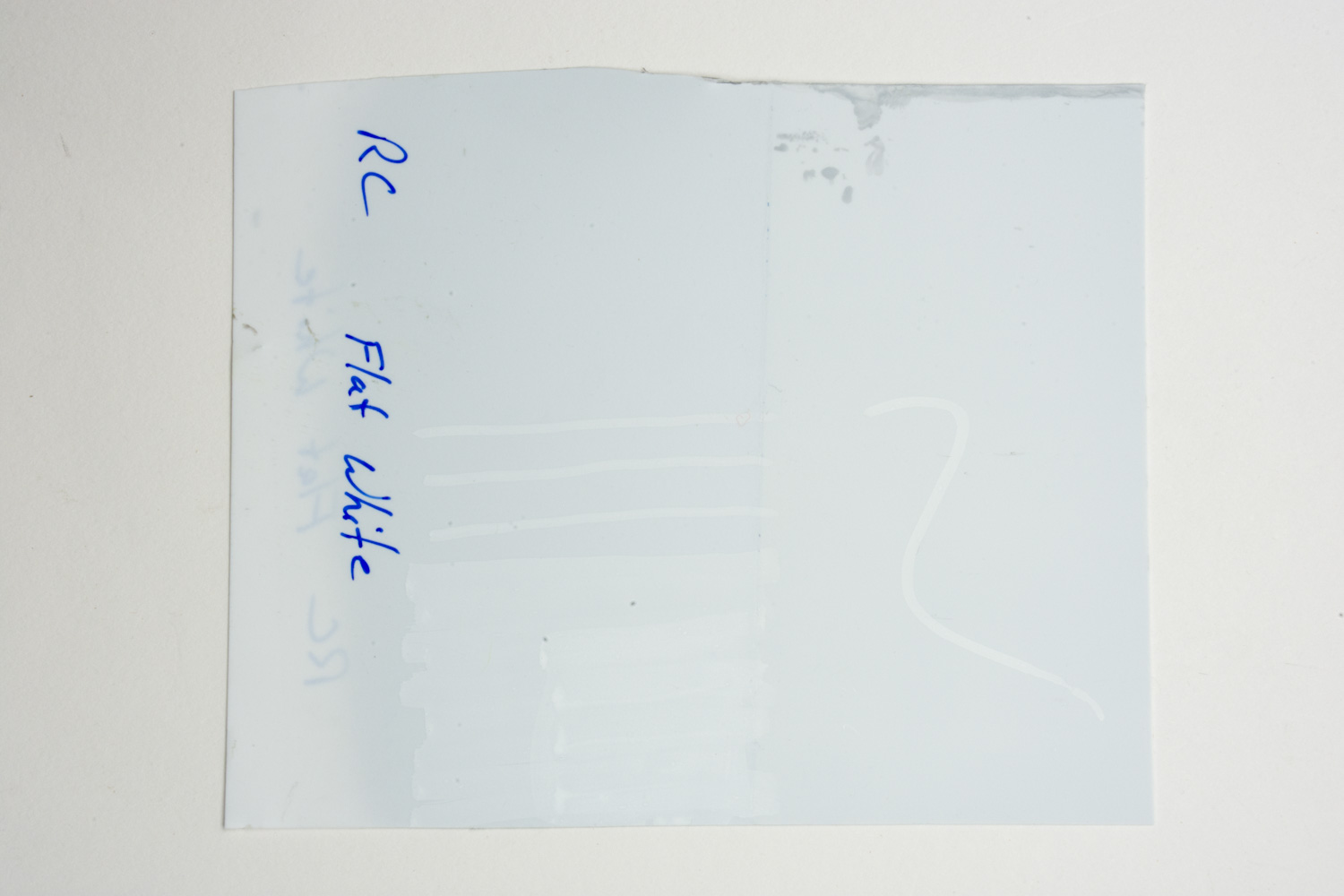

I made color chips from styrene sheet, planning to prime one side with Mr. Surfacer 1500 gray and leave the other side white, spray each side with Real Colors lacquer-based paint or the AK Interactive 3G equivalent of the marker color, and check for color match.
Painting the Real Colors swatches, I realized that while I always wash models to remove mold release, I hadn’t considered it necessary with the styrene sheet. Wrong!

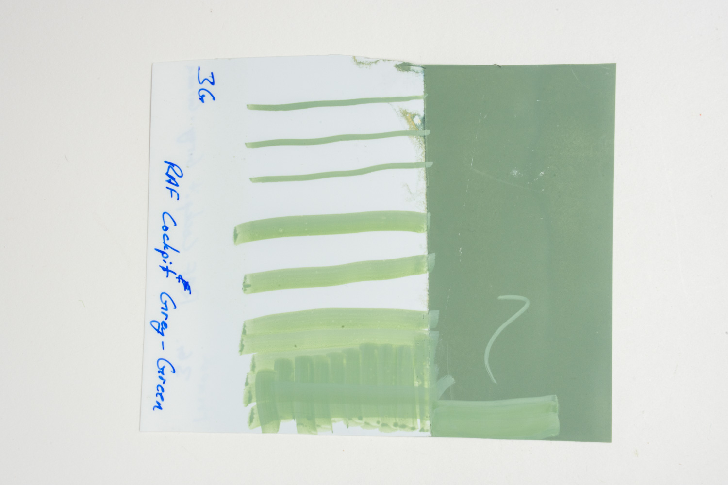

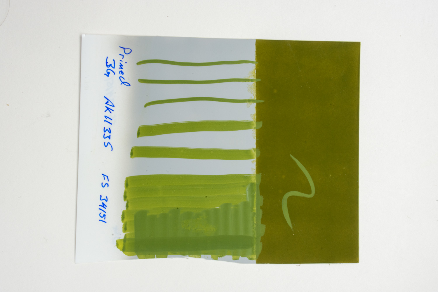

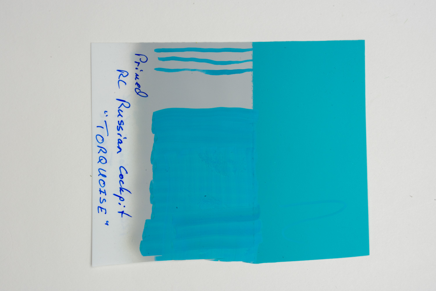

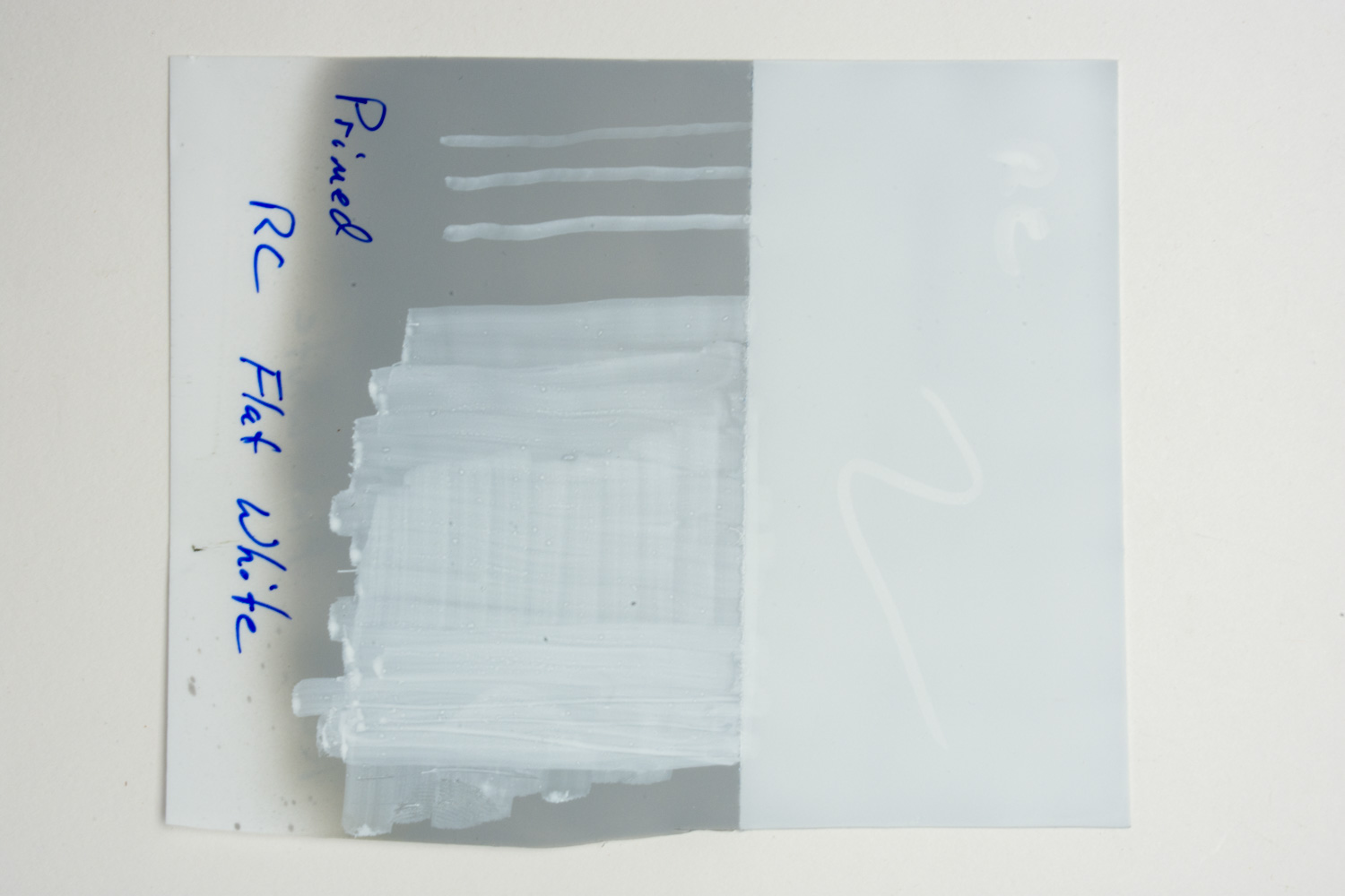

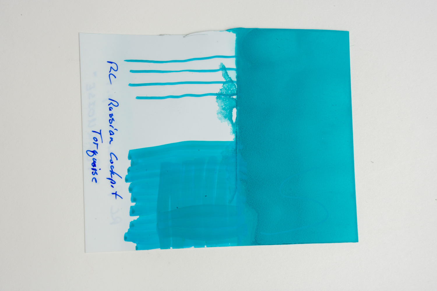

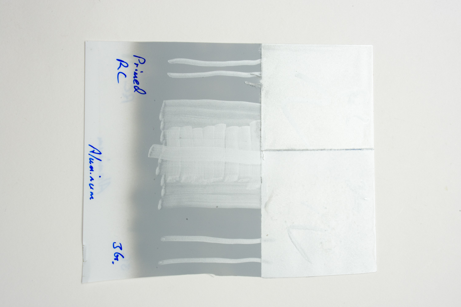

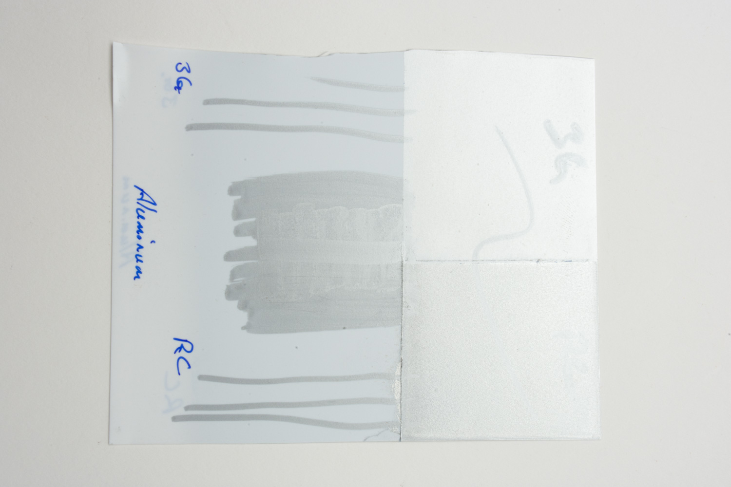

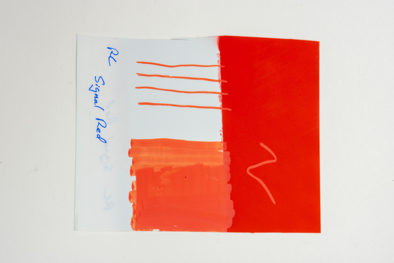

I had some mixing issues with the 3G formulas—I have yet to master the mystical ways of airbrushing acrylics, so there were some thinning issues that led to runs on a couple of my paint chips. Still, they were finally made, although they weren’t the prettiest specimens. I made chips for Real Colors Flat White (No. RC806), Russian Cockpit Turquoise (No. RC980), Signal Red RAL 3020 (No. RC811), side-by-side samples of Real Colors and 3G Aluminum (Nos. RC820 and AK11207), Rubber Black (Nos. 805 and AK11027), and 3G Dark Aluminum (No. AK11208), RAF Cockpit Grey-Green (No. AK11847), and Light Green FS34151 (No. AK11335).
The only time I have seen the colors from two paint lines from the same maker match goes all the way back to Aeromaster enamels and acrylics. The streak continues. Real Colors Aluminum is much darker than the 3G equivalent, and the reverse is true for Rubber Black. As you can see, all of the Real Colors Markers are either lighter or darker than the Real Colors or 3G equivalent, sometimes substantially so. The dark colors are more opaque and cover better, while the light colors need multiple coats, and the white remained semitranslucent after four coats.
