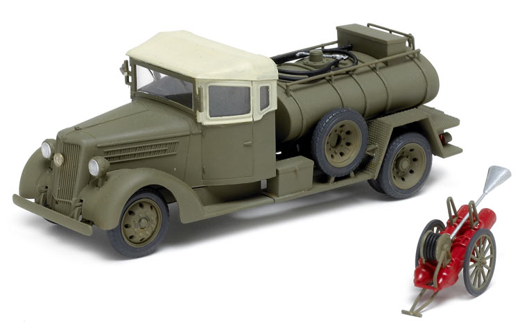

The box also contains an Isuzu TX40 fuel truck, a fire extinguisher, two ground crewmen, four fuel drums, and a 61/2" length of vinyl fuel hose.

Being inexperienced with military vehicles, I was pleased with the excellent fit and high level of detail in the truck. The fire extinguisher is quite delicate. I could not resist painting it red, even though the box art shows it in basic Army green. If you want to pose the Ki-45 being refueled, the fuel tank covers need removal, as the kit has no provision for tank access. A drawing shows the tank-cover locations.
