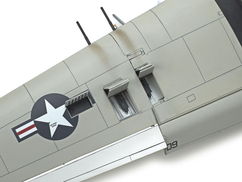

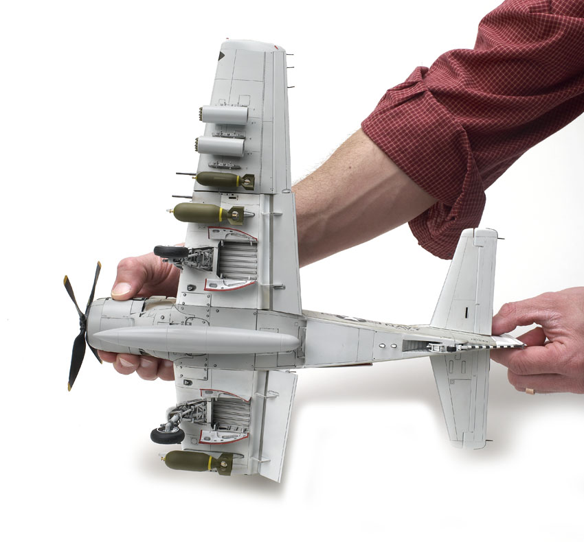

Besides a lot of interior detail, the kit features foldable wings, separate control surfaces, unloaded and compressed landing gear struts, open or closed cowl flaps, movable speed brakes, posable cannon ammunition doors, separately cast wheels and tires, positionable flaps, and a pair of drop tanks. No ordnance is included; it’s sold as a separate set (kit No. SWS03-M01).

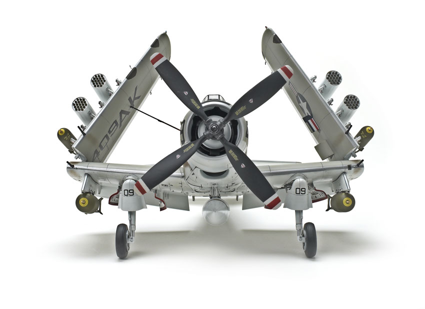

Building the wings includes more detail that will disappear inside. But you’ll want to install the spar and rib structures, wheel wells, and cannons. Don’t forget to poke through the recessed attachment points for the weapons pylons before closing the wing. While it is not readily apparent in the instructions, the folding wings are not just posable but operable! Follow the instructions carefully, and they’ll work. According to photos of the real aircraft, there’s a curved, metal-looking structure close to the rear hinge of each wing that is not present in the kit. I’m not sure what it is; maybe Zoukei-Mura didn’t understand it either and decided to leave it out.

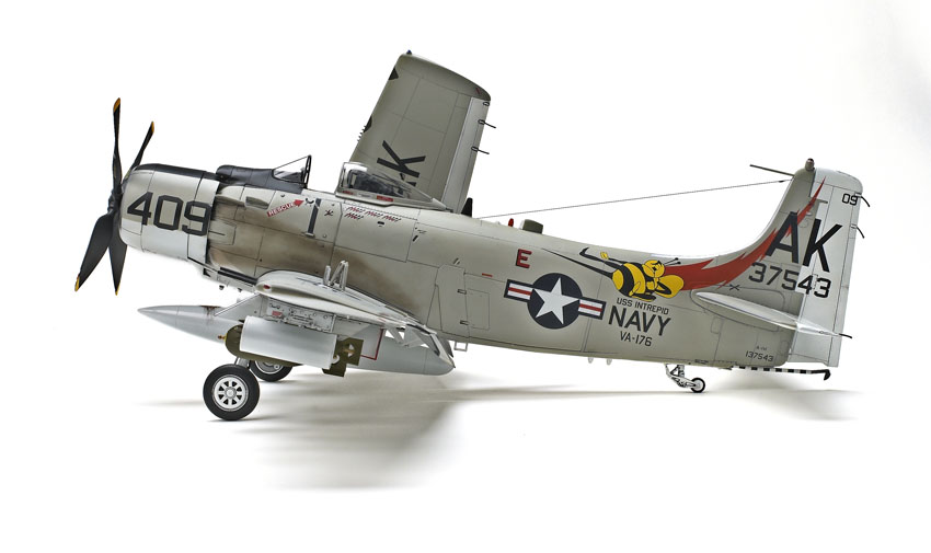

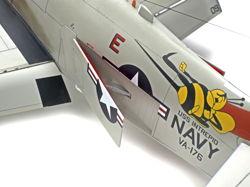

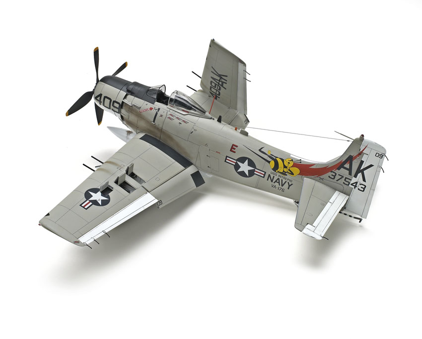

The instructions refer only to Vallejo and Mr. Color paints, but I painted with Testors Model Master gloss white and gloss light gull gray. I chose to model Lt. j.g. William Patton’s MiG-17 killer, Papoose 9 (AK 409). The decals were beautifully printed and applying them was trouble-free. After they dried, I carefully cut through the fuselage insignias so I could open the speed brakes. After detailing with a sludge wash of medium gray, I overcoated the light gull gray with a clear flat coat, leaving the white glossy.
Final assembly included mounting the control surfaces, landing gear, canopy, antennas, navigation lights, and ordnance. From the separate weapons set, I mounted four rocket pods and a pair each of 500-pound and 1,000-pound bombs from the ordnance set, along with a centerline fuel tank.
I spent 72 hours on the big Spad, building it out of the box. I would have needed more if I had installed all the interior stuff or used the photoetched-metal detail set.
Make room on your model shelf, ’cause she’s a biggie — 19" wingspan, 14" long. It’s a marvelous model and sure to turn heads at a club meeting. Zoukei-Mura has announced a U.S. Air Force “Sandy” version of this kit, and with some work, a Korean War “Able Dog” is possible, too.
